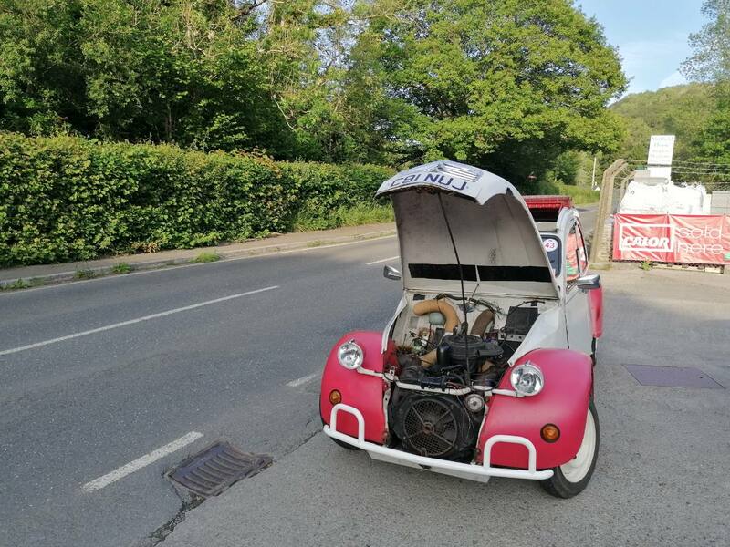

So I went to drive home in the 2CV and it refused to start. It oddly missed twice on the journey to the unit, but was then absolutely fine. Bit annoyed as it's booked in for MOT next week. No idea what's up with it. Had to drive home in the borrowed PT Cruiser instead.

Went back to the unit this evening. 2CV fault was just a failed connector. Re did that, washed the C5.
Feeling better, I drove the 2CV home. It went well*.
Clutch stopped disengaging properly. Marvellous! Managed to limp home. Old cars are gr-12.

Went up to the unit today. I was going to swap the 2CV for something else, having limped it there with minimal gearchanges, but then decided to investigate.
E3rEBgEXIAM9DjX?format=jpg&name=small
Pretty easy to see the issue once I looked - the two lower bellhousing nuts were loose! Explains why the clutch has started juddering as well. Did them up, all good. Quite why they were loose, I've no idea. Never had that happen before. I assume they must have been tight at some point between fitting that engine, driving to Croatia and back and now.
