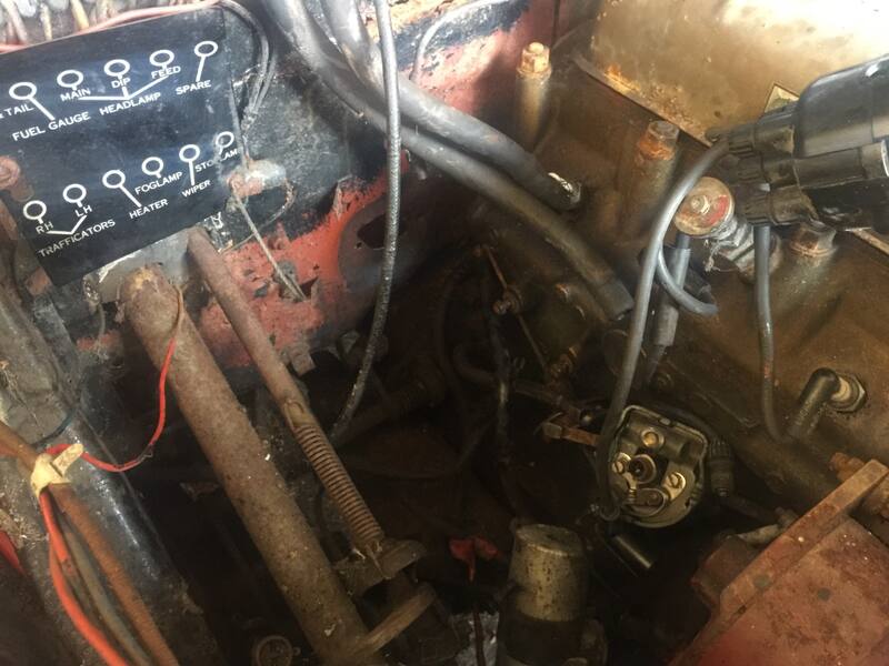

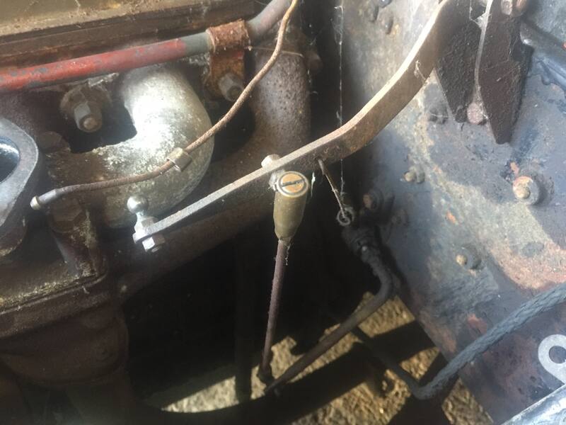

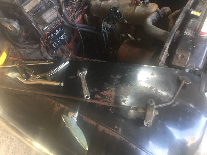

Nice weather today. Spent most of the morning fighting to remove the seized throttle linkage from the bulkhead.
Its only two nuts and bolts and two bolts that hold it on, trouble is that due to the angle of the accelerator pedal, and the tiny slot in the bulkhead for it to go through, it was clear that the whole linkage would have to be rotated upwards 90 degrees to stand any chance of getting it out. And even then I wasn’t sure if it was going to clear the steering column. It was obviously one of the first things Austin fitted to the body, almost certainly before it was dropped onto the chassis and running gear, and I’ve never had to remove one before.
To rotate the throttle linkage the required 90 degrees, lots of things had to be removed:
The main feed cable from the starter solenoid, the oil feed pipe to the gauge, both heater hoses, the handbrake cable, the coil, the wires to the headlight dip switch, basically everything that ran over the linkage.
The dip switch wires were particularly difficult to remove. The screws were too close to the bulkhead to get a screwdriver onto them, knowing how rusty they were. The only option was to remove the two screws holding the dip switch on, and push it into the cabin and tackle the three screws holding the terminals on once I’d got it hanging in the footwell where there was more space to work. However, as water had been running down the bulkhead for years, all over the dipswitch, both securing screws were extremely rusty. It took loads of penetrating oil and every trick I know to get the bastard things moving. Due to limited access by the side of the engine, it took probably 40 mins to get just this switch off and disconnected.
I don’t know if it works as I haven’t been able to test the lights yet, but surprisingly enough it isn’t seized, but I might as well strip and clean it while it’s out.
Both clips on the heater hoses were really rusty, I had to break one to get it off but the other I eventually managed to undo. Some very old, stagnant water which had been in the heater matrix dribbled out. The radiator appears to have been drained down. I think it’s actually a recon, and the fact the heater matrix was holding water must be a good sign.
You can see the linkage down there where it runs behind the engine.
Eventually, success! It just fitted.
You see that little aluminium bracket with the two holes? That’s fixed to the bulkhead and the steel tube is supposed to turn inside it. Not this one, it’s rusted solid. Going to take it into work where there’s better equipment and we should be able to free it off.

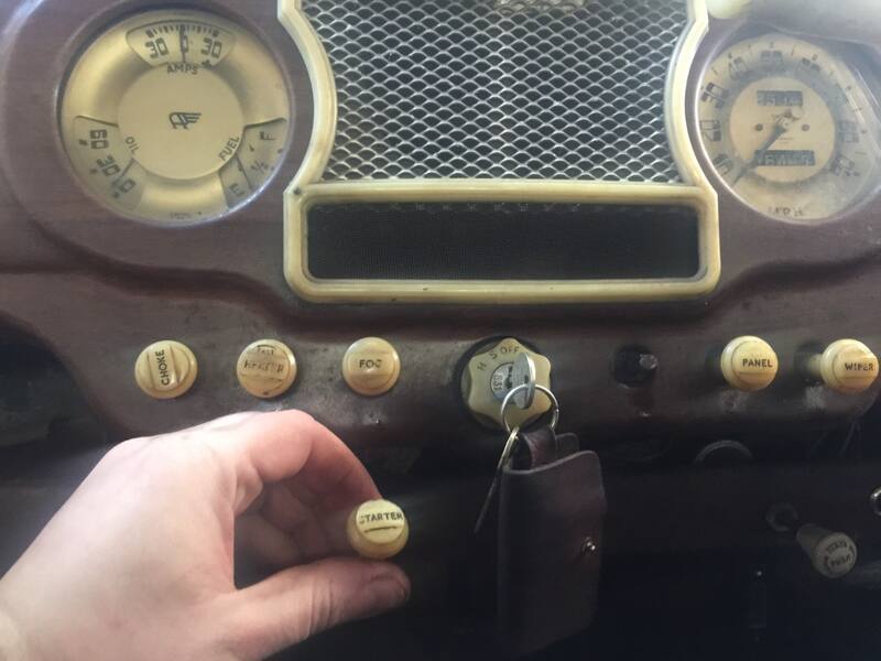

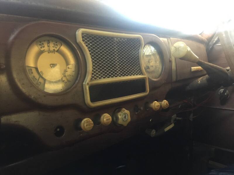

I’m still fighting to access the seized light switch, choke cable and instruments. They are hidden behind this dashboard facia panel, which is held in place by two screws, and six ultra fragile and unobtanium knobs. The knobs have little spring loaded plungers underneath you are supposed to depress with a small screwdriver or something. I’ve managed to get all of them moving but despite regularly blasting them with penetrating oil, I’ve only managed to get two of them to shift. The rest currently don’t want to know.
I don’t really want to wade in with tools as I’m liable to break the knobs, that really would be a last resort. I’ve sprayed a bit more penetrating oil on them and I’ll let it soak in for another week.
Maybe try very gentle heating with a hairdryer?
Good luck with the knobs, I don't envy you that task.  Your dashboard seems familiar...
That’s a good idea. I don’t own one, I don’t have the hair for it but I’ll see if I can borrow one!
Just go to Tesco or Asda, they're bound to have a cheap one available!
Along the same lines, when googling about Iverine it said one means of identifying it was to warm it with warm water(30-40C) and it releases a camphor smell(because it contains camphor); although having expended effort drying the car out you may not want to start pouring water everywhere.
Only just catching up with this thread; this kind of miraculous resurrection is pretty fitting on Easter Monday, Autoshite being my church and all that. Warm sentiments of congratulation and support from this callsign.
That interior is a thing of beauty. It must be such a nice place to sit. Has your Somerset got the same interior? Best of luck with the dash switches. Thinking of applying heat, what about a cloth soaked in hot water? It is just the heat you want, so you can wring a lot of the water out?
