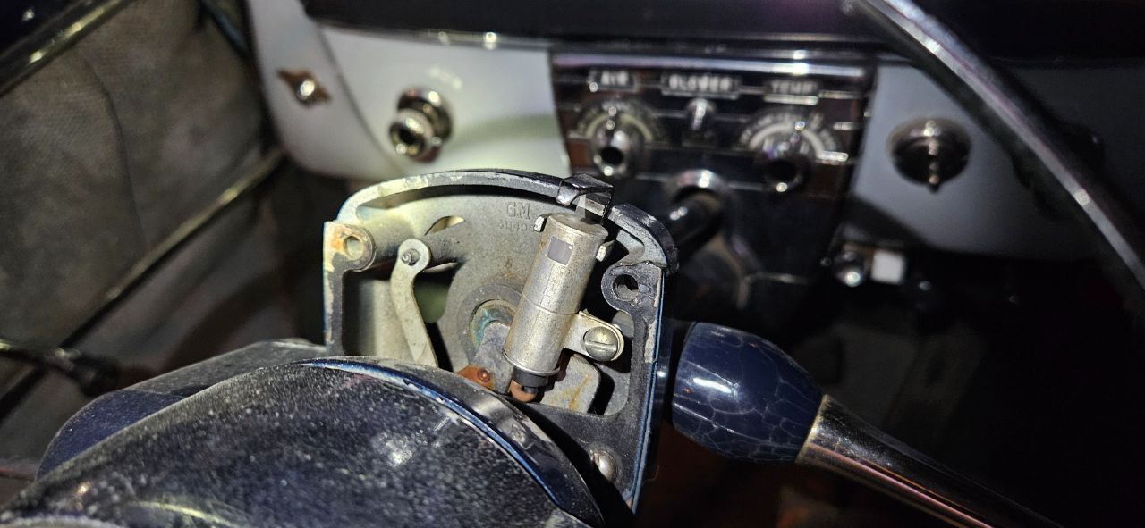

Washed it. Looks better. Barkeeper's Friend works quite well on tired chrome.
Noticed that the gearshift indicator bulb had burned out.
Dismantled that and replaced the bulb.
Returned to service. Much better.
Also replaced two bulbs in the dash (heater, ammeter) that had become flickery. Onward and upward.

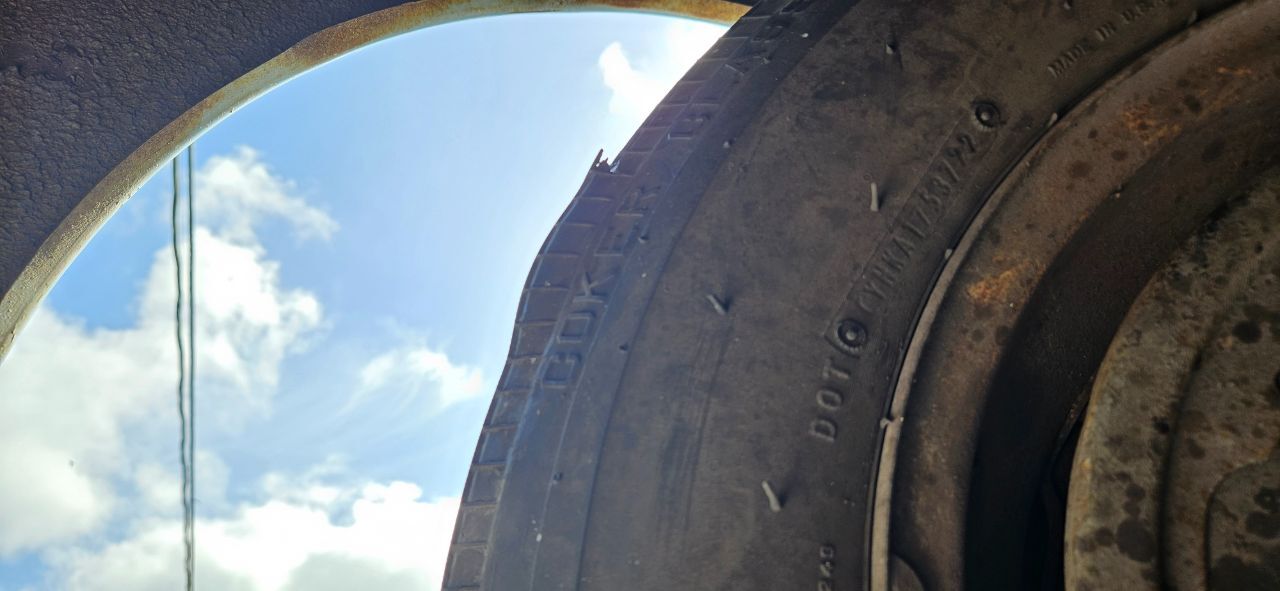

Went to adjust the brakes today.
I hit something very sharp. It sliced into the tire and luckily didn't blow out, but it's got a bad bulge in now.
Need to get a couple new tires for the front now. Mm $282 each + tax + s&h.
Super.

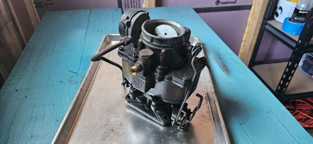

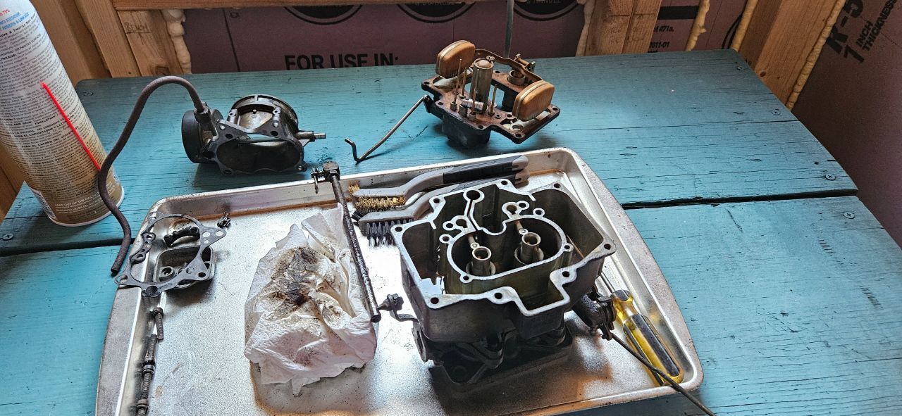

Carburetor time. This is a Carter WCD two barrel, subtype 720SA. Pretty standard for the era, with the model dating back to the late thirties.
It has two circuits per barrel, a low and a high speed. The low speed is adjustable via the needle valves on the front and the high speed circuits are ganged together from manifold vacuum, with the throttle position pushing the needles up out of the jets, so long as vacuum is strong enough to keep the plunger pulled down. Under heavy load where throttle position is light but vacuum is poor, the spring pushes the needles out to enrich the mixture.
That's all good and well but the needles weren't moving. They were stuck at maximum open all the time. So, apart came the carburetor, and an inspection was made.
A "what the" moment- there was a ball bearing in the bottom of the vacuum column. So, the vacuum was pulling the ball in tight and not allowing vacuum to pass.
.....why? No idea. Ball has been removed. I need to play with the lever arm position because it's ever so slightly stuttery at 10-13 inches of vacuum. However now on the highway the mixture is improved. The car runs warmer, so it might be too lean (the bias for that is adjustable, and it's set on the lean side right now) so I'll dial that in. The accelerator pump is nearly dead also, the leather cup is hard. I might have a go at that but I do need to get a new gasket set for it. Emissions and economy ahoy!
