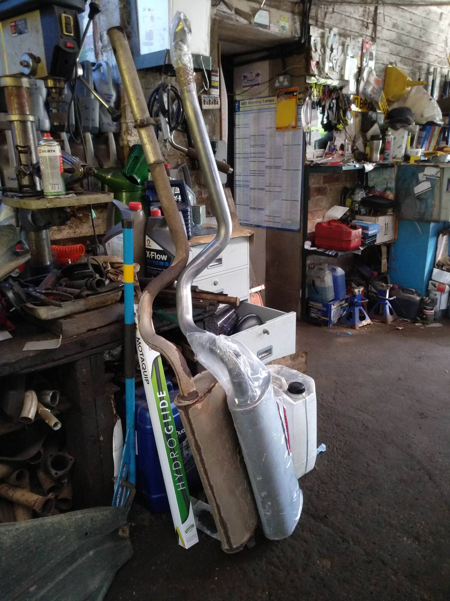

A quick inspection showed the rearmost hanger had snapped.
No worries, it's right at the end, so cable ties to the rescue (jubilee clip in place to prevent cable ties melting).
A quick look further along the exhaust shows the next hanger is also not attached, this isn't fixable with cable ties though, so ebay was perused and a new rear section ordered for £45.
Due to the unique way I manage my fleet this appeared to be the only car I had that was legal and I trusted to drive across the Pennines to Accrington this week. On the run over Saddleworth moor it started raining (it's the North of England, it usually rains) so I put the headlights on, or rather I pulled the headlight switch to turn them on. Nothing happened.

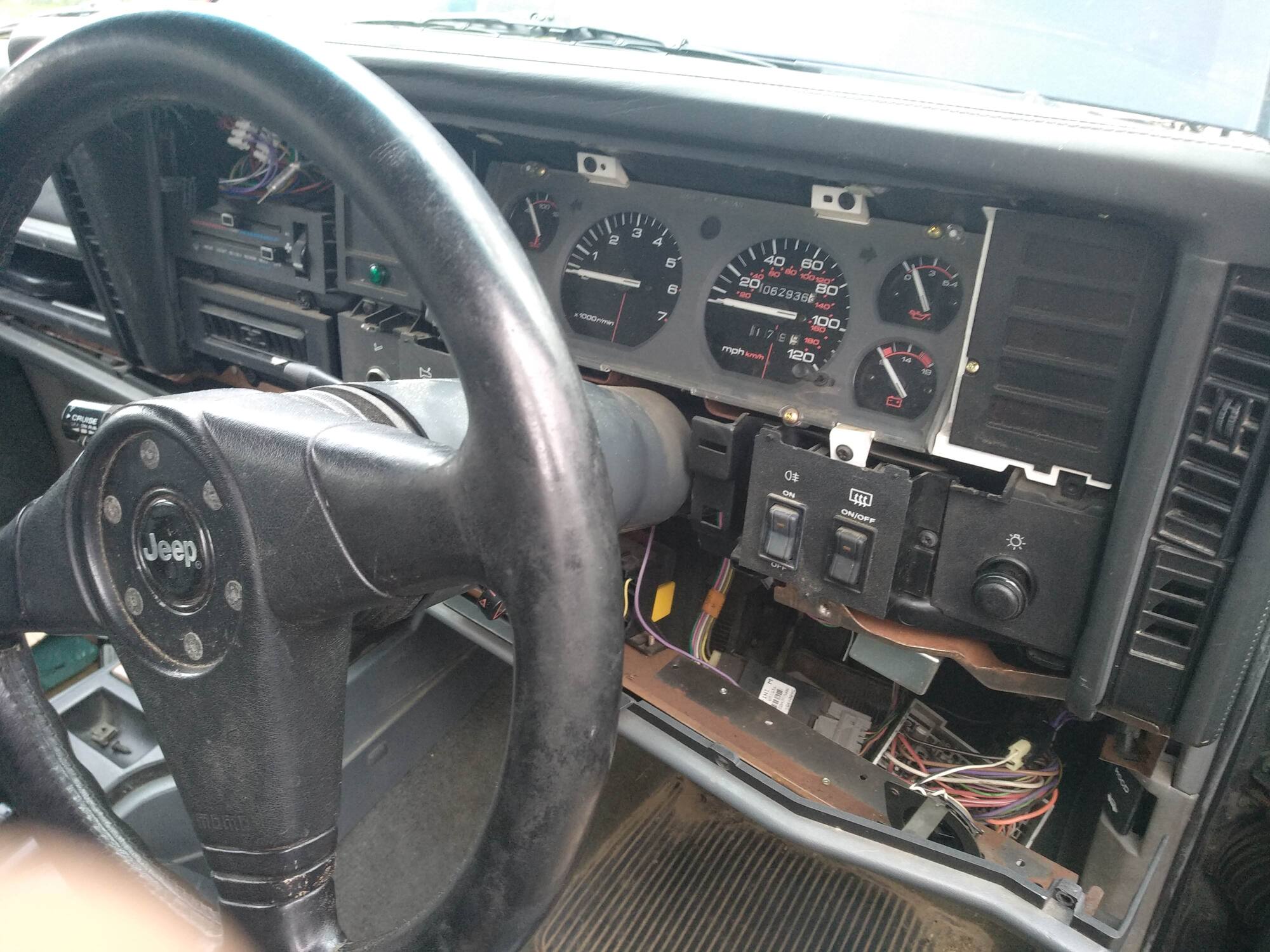

When I got off the motorway I had a quick investigation, the fuse was fine but no lights, bugger. I repeatedly jiggled the switch and got the sidelights on, briefly. These then went out and wouldn't turn back on again, double bugger.
I checked the sunset times and worked out that I might be able to get home before it got properly dark, worst case I stop somewhere comfy (services) when it gets dark and call the breakdown.

This morning I rang my friendly local(ish) garage and appointments were made for exhaust fixing and headlight analysis.
Old and new exhaust sections compared, and they look similar, so it looks like I ordered the correct part.
The exhaust was relatively straightforward, the rear hanger needed a touch of weld to make it secure but, all was done in reasonable time without much trouble.
Removing the headlight switch was rather fiddly, and involved removing part of the dash and rummaging behind it in a tight gap but eventually this was extricated and I could get the part number off the thing.
I wanted to confirm the part number as they changed the switches every couple of years, and I didn't want to order the wrong one.
Oooh look, some burny bits on the old switch, that'll be the problem, £32 switch ordered, it should* be here by next Tuesday.

Headlight switch arrived yesterday, and has been fitted. The headlights etc now work, which is nice.

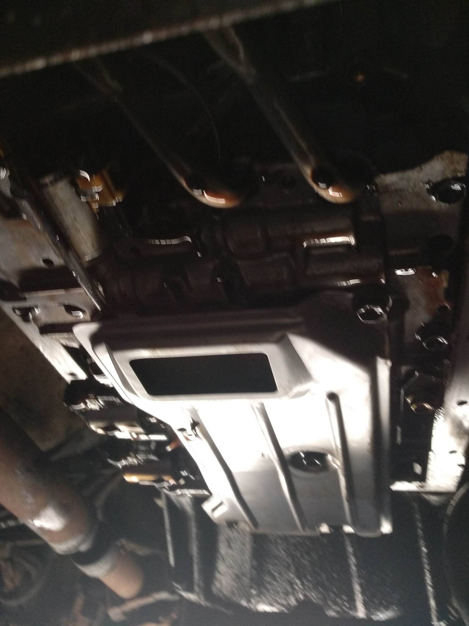

Then it was time to change gearbox and diff oils, again I forgot pics.
The ATF was drained, 3.5l of sludgey grey stuff came out, this was then followed by half an hour or so of battling with the sump pan as the dipstick tube is connected to the pan and needs to come out with it to remove the pan.
That was eventually wrestled out, cleaned, silicone removed from both surfaces, as there was no gasket in place.
A new filter, gasket and 4l or so of clean red ATF was put back in.

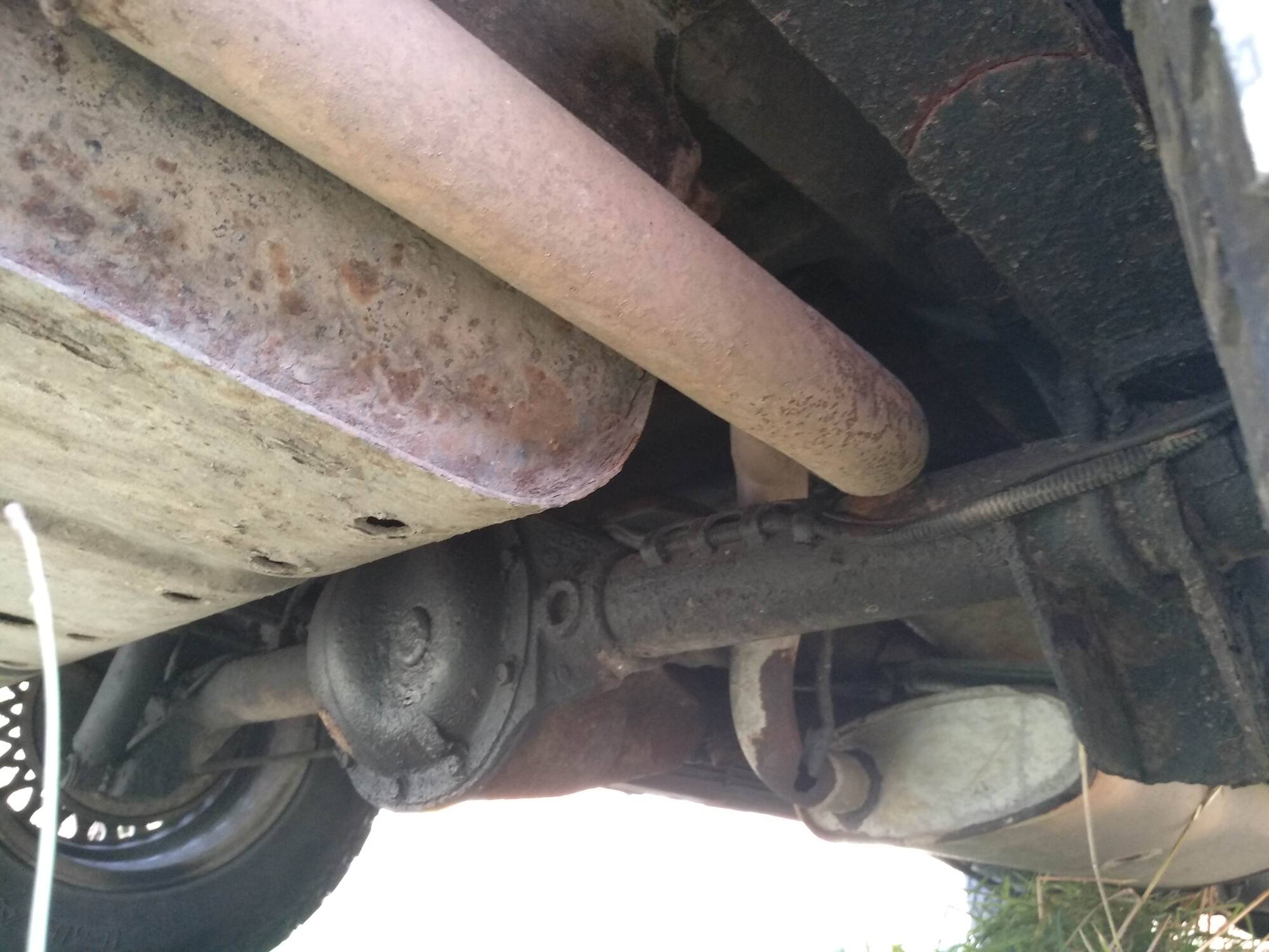

As is my norm, I forget to take pics until it's pretty much too late, so here's a bad pic of the gearbox oil filter in situ.

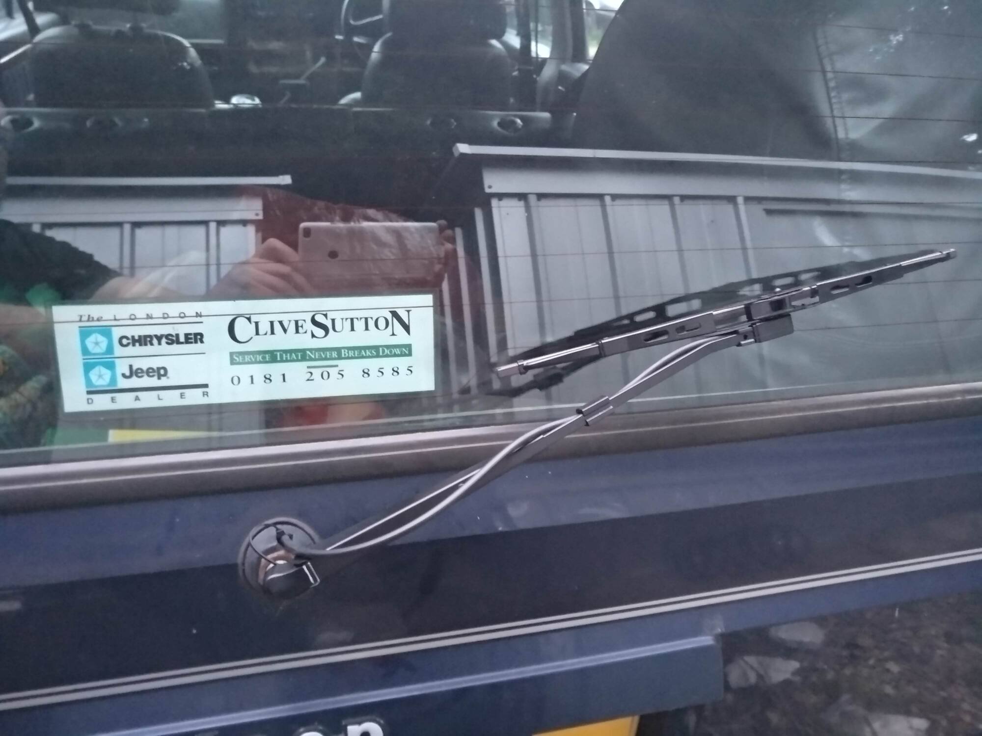

The more observant at Chumley might have noticed the lack of rear wiper … This has been rectified.
I've been avoiding buying one as the cheapest I could find was almost £30 with postage, and that's too expensive for a mingebag like me. However when I was looking for an ATF filter and gasket, the place that had them in stock (jeepy.com) also had the correct rear wiper for my jeep at a more reasonable £20. I've literally just been outside and taken that pic, isn't it terrible?

Love the early dash on yours, funny how the facelift basically tried to water down its character, same for the rear lights and tailgate
I really like the dash and weird (lack of) ergonomics on this.
In normal driving you can't really see the warning lights on the right as they're obscured by the tiny steering wheel, I hardly ever noticed the check engine light, making it easy to ignore for 6 months.
The steering wheel also obscure the only stalk, which controls cruise, wipers and lights. I have found myself trying to peer round the wheel to see if the cruise is set, or what the variable intermittent speed wipers were set to, either long pause, or not working.
That said I love the tiny steering wheel and think the dash gauges are just about perfect for a non-digital one, it has exactly the right amount of gauges for me and all clear and well positioned.
Speedo + revs - big.
Battery voltage, coolant temp, oil pressure and fuel - small
