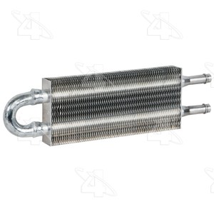

This is the £80 odd quid OEM power steering cooler pipes for my Mazda...
Now, on the Mazda 323 forum, I've seen suggestion of replacing it with a generic cooler like this.... Would it work?
Look up Moog's mx5 thread for a superb solution to this!
He used copper piping.
Yes it's only a long loop to store extra fluid and allow cooling.
Or do what I did with copper pipe for many pounds cheaper. Was just some 10mm pipe plus fuel hose and clamps.
Edit: just seen mr Touring has suggested it.
Or do what I’m about to do and bypass the fucker. Cars are designed with all conditions in mind. Unless your drifting in California it will prob be fine without it
Cheers for the tips, doubt I have Moog's skill in fashioning my own one and finding somewhere to mount it as well!
Looks like it would be quite easy to bypass with an extra bit of pipe. Probably a job to do in a bit if and when I replace the radiator.
regarding mx5s and steering fluid coolers, mazda deleted it from the car in ~1996 but reinstated in to the '98 model onwards.
when I owned avo (moogs current mx5) the cooler sprung a leak so I removed and bypassed it, this was not an issue except when auto testing and on track days where the fluid boiled over. for daily driving, I wouldn't worry too much.
