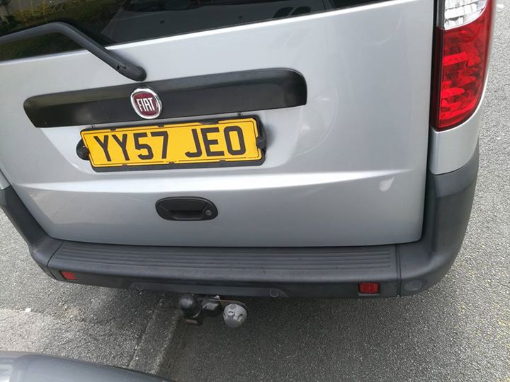

Cavcraft Posted July 12, 2017 Posted July 12, 2017 Why do some cars have these things on the number plates? Been bugging me for ages that.
