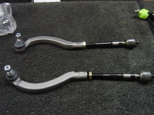

AMC Rebel Posted February 23, 2017 Posted February 23, 2017 My stupid question is "How the flip am I going to get the track rod end off the steering rack on my MG ZT-T ?" I don't have a gas axe or propane torch. So far I have tried Freeze N releaseVarious penetrating fluids (copious amounts)Heat from my wee plumbing blowlamp (which is all I have) I have considered trying to saw the locknut off but I'm not sure that would work without damaging the rack threads, and nor am I sure it would even help. Any cool ideas?
bub2006 Posted February 23, 2017 Posted February 23, 2017 Are you replacing the track rod end? If so slight thread damage won't matter. Remove lock nut by using a dremel with cutting disc as they can get in most spots. Failing that grinder through nut and knock it off. I've used both methods when replacing track rod end. AMC Rebel 1
Des Posted February 23, 2017 Posted February 23, 2017 My stupid question is "How the flip am I going to get the track rod end off the steering rack on my MG ZT-T ?"Put something underneath to act as an anvil, like an axle stand, block of wood or an anvil so you can leather the ignorance out of it with a hammer, attack the flats of the nut to shock it free. Mind you don't twat a clump out of the wheelarch. alf892 1

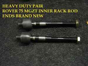

sierraman Posted February 23, 2017 Posted February 23, 2017 Unwind the axial rod out, they're only cheap anyway. By the time you've spent twatting the threads it'll be no good. You'll need the handcuff like things to wind it out the rack though. Either that or a stillson wrench might do it.
AMC Rebel Posted February 23, 2017 Posted February 23, 2017 These bits? s-l300.jpg Which end is the problem?No the outer ones - the silver curved bits in this pic - I never thought of removing the whole thing (inner and outer) though. It might be easier to get off on the bench/in a vice. How easily do the inners come out?
AMC Rebel Posted February 23, 2017 Posted February 23, 2017 You'll need the handcuff like things??? Excuse my ignorance
