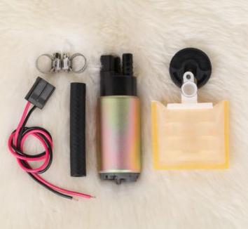

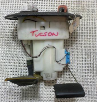

I think the fuel pump is failing in my OH's Tucson, when the car is low on fuel (low fuel light on, trip computer estimating 50 miles or less left) and you have been driving for longer than say 30 minutes the car starts surging. If you stop for about five-ten minutes it's fine again. Also if the car has the same low fuel level and you try and start it from cold it's fine, however if you go for a short drive and then try to start it again it turns over without firing the first couple of tries of the key. When the fuel tank is more than a quarter full you don't get any problems.
Assuming I am right in my fault diagnosis the next obvious step is changing the fuel pump, the fuel pump is an in tank job and looks like the first pic, from ebay I can buy replacements that say they will fit but they look like the second pic. Has anyone replaced a pump like this before? I'm assuming you can split the big white housing open and change the pump inside it?
