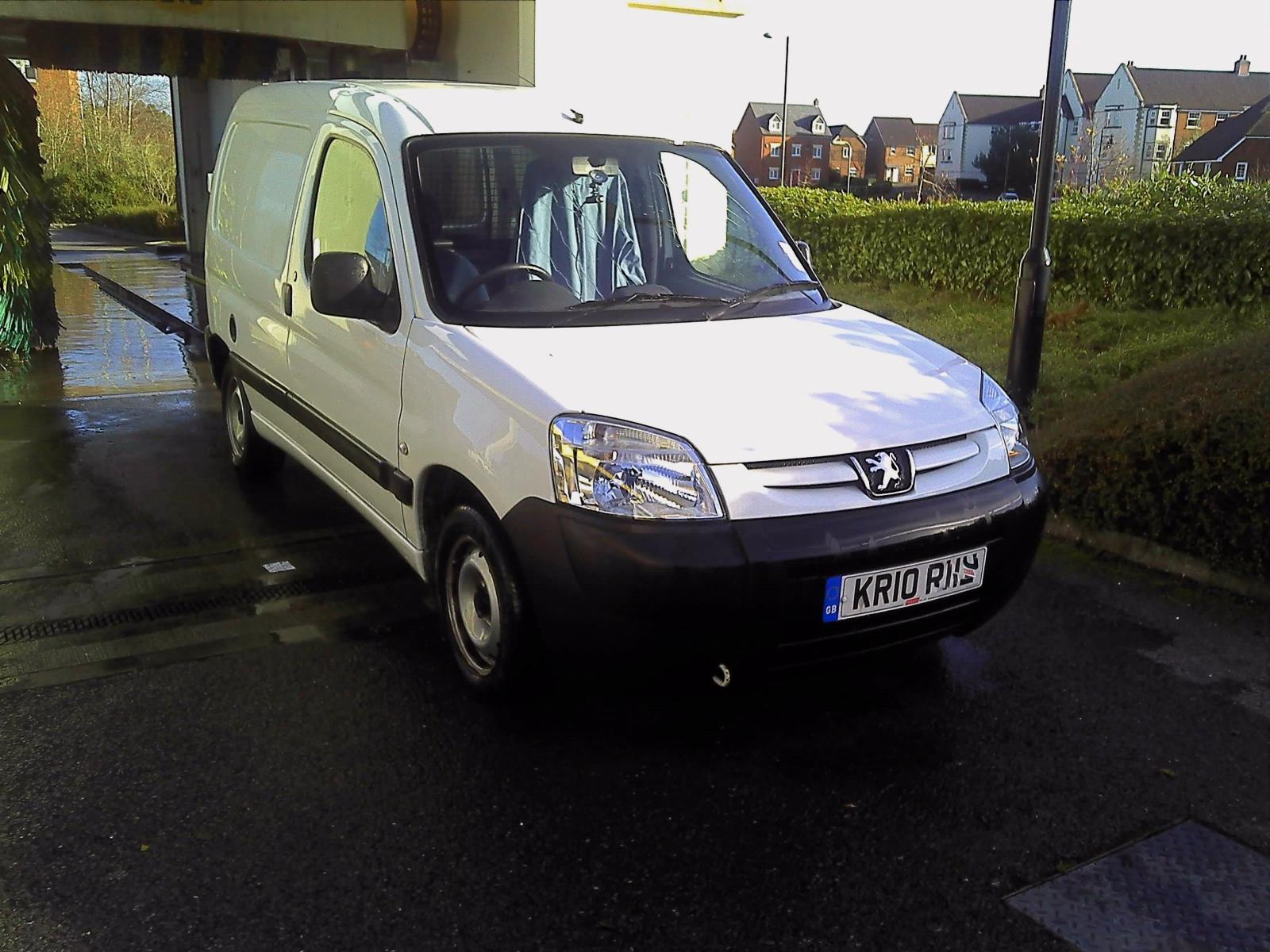

Alan_Green Posted January 5, 2015 Posted January 5, 2015 What is going on with my modern?1.6HDi Peugeot Partner Origin 600 van. 47,000 miles. Oil and filter changed every 12K. New turbo in Sept 2013 at a cost of £1,128 (paid by last company owner).Turbo has blown again today - just 15 months later.Been quoted £1,000 for new turbo/pipes/flush by local garage (SE prices). 2 Questions:Is £1,000 reasonable? Should I get rid once repaired?
Chas4545 Posted January 5, 2015 Posted January 5, 2015 Peugeot turbo failure second time , perhaps partially blocked oil feed pipe was not replaced first time, or lots of start stop driving without letting turbo spool down before switching off. All bollox of course, what do i know. Alan_Green 1
skattrd Posted January 5, 2015 Posted January 5, 2015 I'd say get a recon turbo and swap it yourself.... Then flog the thing. If it cost £1100 last time, and you've been quoted £1000 this time I'd say that's probably around the going rate.If you are going to get someone to do the work ask if they can use a recon turbo or get yours rebuilt, which would save a few quid. Alan_Green 1
