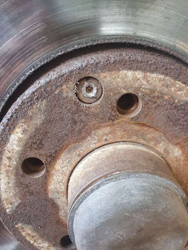

MrsDC informed me the other day that the Corolla was making a squeaking noise at the front the last time she drove it. But only when she turned left.
A quick spin round the block confirmed the basic facts of the matter. On left turns, it's quite alarming.
A bit of light clockwise pressure applied to the wheelnuts can also replicate the noise to a lesser extent.
With the wheel off...
Yeah, standard 25 year old grot but there's nothing amiss that I can see - plenty of meat on the pads, nothing rubbing or chafing, gaiters and boots all seem fine. No damage or fractures to the springs, no leaking from the shocks. Wheel nuts are tight (well, they were tight before I took the wheel off and now they're tight again).
It doesn't sound like a noisy wheel bearing or anything like that (I had plenty of that with the Lagunas, they just ate bearings); there's no sound at all when turning right, going straight or bouncing over the many speed bumps. No difference when brakes are applied. No vibration, just the squeal.
Nothing's been touched, except that the tracking was adjusted about two weeks ago by the place that fitted the new tyres.
I don't think they've done anything amiss, and I absolutely don't want to be that guy coming back mouthing about "Ever since you did the tracking..."
All I can think of is that the brake disc backing plate is pretty crunchy and bends quite easily - I wonder if it's been knocked and is now making contact with some part of the wheel, on left hand turns, or maybe some rusty bits have fallen down and got jammed between hub and disc?
Thing is, I don't see any witness marks that would suggest rubbing, though...
File under: annoying but hopefully not lethal.

Definitely sounds like a part of the backplate is touching the disc somewhere. Lateral forces mean it's not going to rub when there's no force on it when steering the opposite way. Bend it  back and carry on!

Do these have the little tangs on the brake pads, like Hondas? I can't remember, but that's what it sounds like. Usually only on the inner pad, and touches the disc and makes this noise when they need changed..
Edit.. yes,they do.. you may find a seized slide..

@Datsuncog Try the bush/bearing at the top of the strut.  Our vans sometimes start making weird noises which is silenced by putting a load of grease up there.

15 hours ago, Volksy said:
A mate came to me years ago complaining of a very similar thing. Turned out somehow she'd picked up a flattened coke can which had wedged in the bottom arm and scraped on the driveshaft when she turned right.
Not wanting to play a game of one-upmanship, but...
My wife's Corolla developed an intermittent metallic pinging sound at the front nearside wheel. Every time it would happen I'd get it home, wheel off and have a look. This went on for months.
Eventually it happened while I was driving in town. I had a couple of friends in the car, I apologised for the delay then swung the car into the nearest car park and had the wheel off. Couldn't find the fucking issue. It had been driving me mad. We'd had to swap cars as she was stressed about it being dangerous (and I'll drive anything).
I wasn't having it. I really got in there. Eventually I found a tiny pebble, about 5-6mm across lodged in one of the vents of the disc. Popped it out with a screwdriver, and not finding anything else I put the wheel back on and carried on. Never happened again, seems the pebble had found it's way in there and was finding it's way loose every now and then without managing to fall back out.
I told the mechanics I'd taken it to that I'd found the issue and we all agreed we'd never seen/heard of that happening and what a funny story.
Anyway, the next week at work my manager was complaining about the same thing on her almost new Polo. Her husband worked at the dealership and they'd had it back a few times and couldn't find the issue. The dealership were talking about trading the car in for a replacement as they couldn't work out what the issue could be. I told her it was a small pebble trapped in the vents of her brake disc. "Bet you £100 that's what it is." No idea why I was so confident, but I was right.
She thought I was a genius after that. Joke's on her, I'm an idiot!
