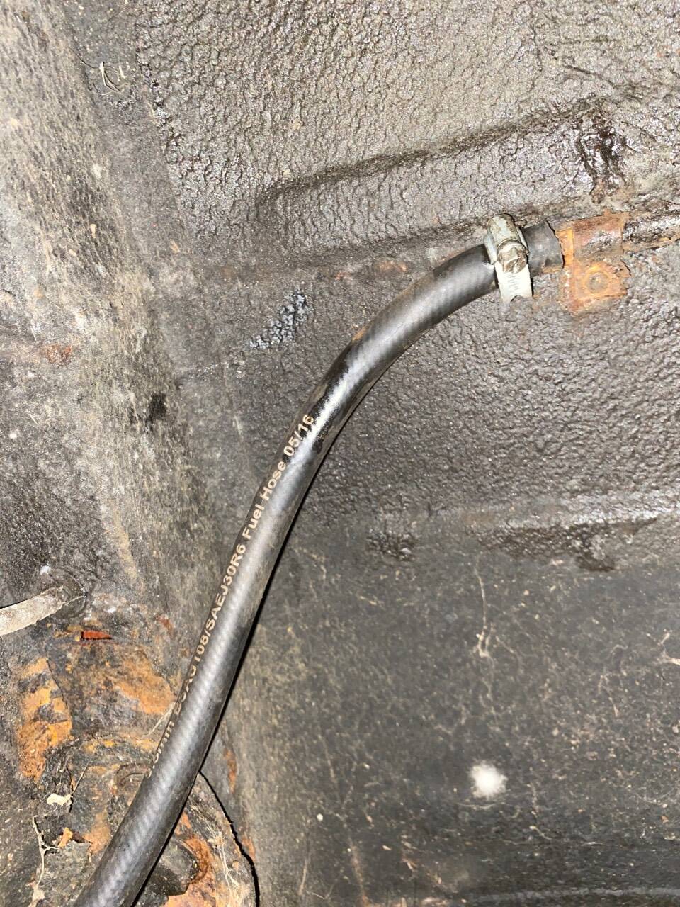

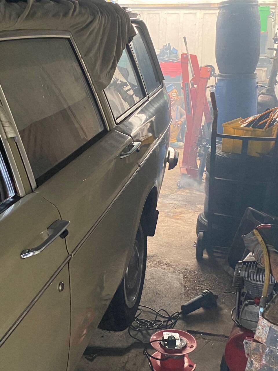

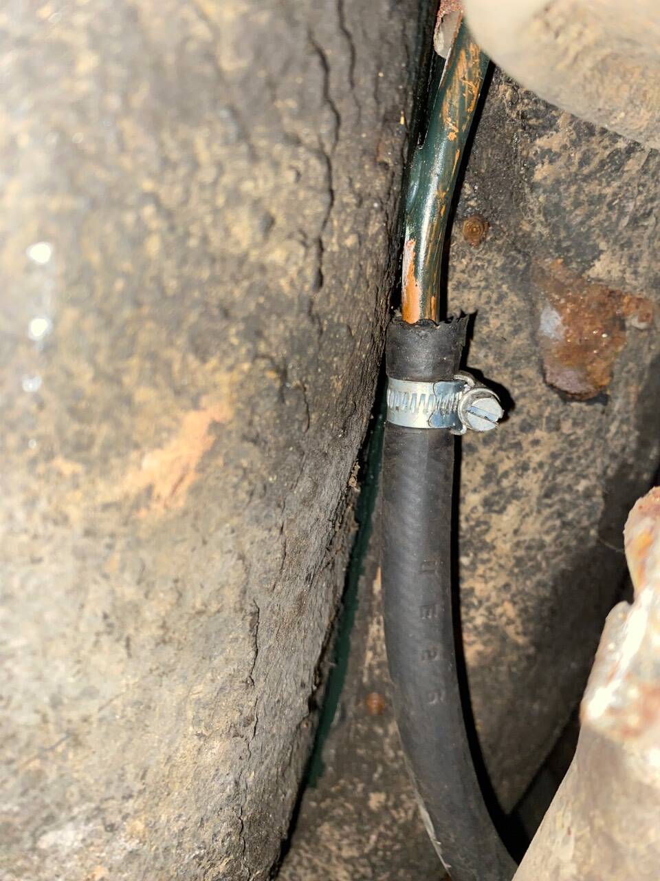

Finally found time to replace a corroded fuel pipe on the 145 today. A few months ago I removed the tank to clean and repair it and disturbed some of the existing steel pipe work near the rear axle. As this was corroded it immediately sprang a leak. Very annoying.
The corroded section was removed and a length of rubber fuel pipe clamped in to replace it. After priming the fuel system the 145 sprang into life first turn of the key and settled down to a nice idle.
I nearly gassed myself but I suppose that just adds to the giddy delirium you get when you finally fix something shite related!

Note that hose you've used isn't going to be a long term fix with ethanol in fuel these days.  You need something that's got the R9 rather than R6 suffix.  Though most stuff from mainstream motor factors these days will turn to powder in six months irrespective of what it's labelled as.
You're much safer buying from specialists such as these guys these days as they actually care what they're selling.
https://www.glencoeltd.co.uk/cohline-fuel-vacuum-hose/
That's the sort of job I'd find all sorts of excuses to leave for another day though, looks like the one end was quite a faff to get to.

I do need to stock up on ethanol friendly fuel hose, this will do as a temporary fix for now though. Accessibility wasn’t too bad once the back end was up on axle stands.

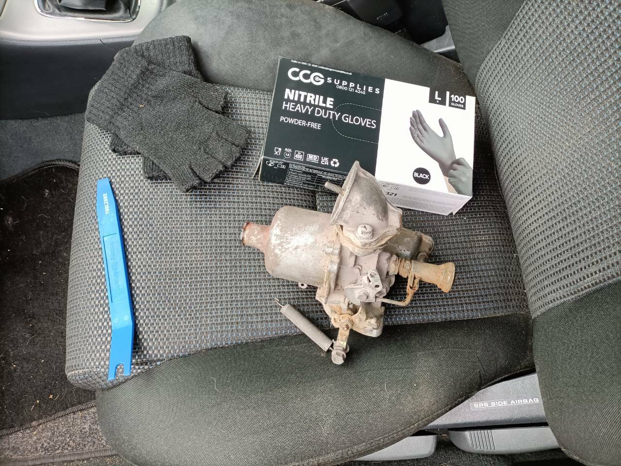

I went to an Autojumble today in Maidstone,to be honest I thought they didn't exist anymore but yep £3 entry to the indoor venue. It was quite busy and I spent some money.
I give you fingerless gloves £1,trim removal tool £2,box of nitriles £5 and a very respectable but grubby HS4 SU jetted for a 1300 A series for £12 (I will get this Morris Minor running properly).

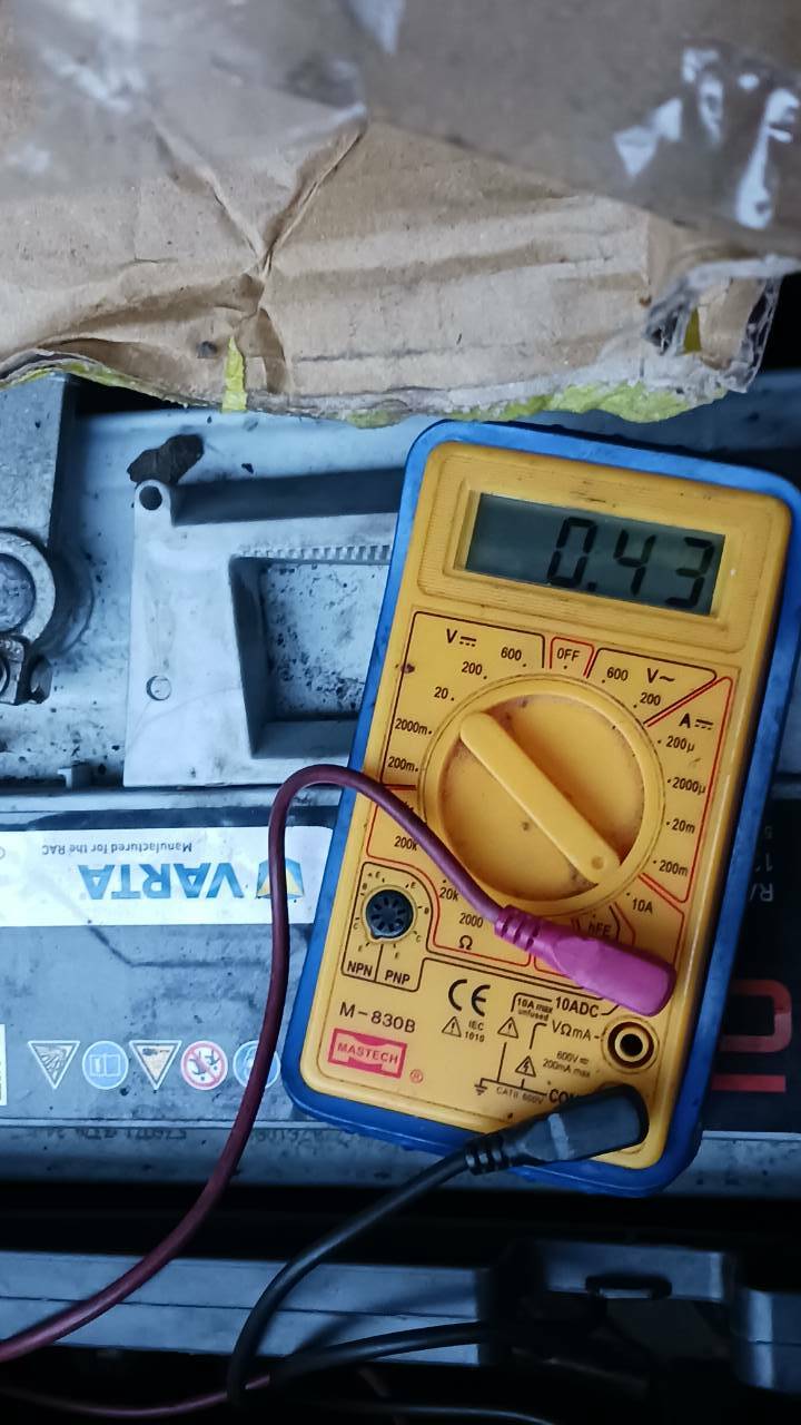

Went to start the Z4 earlier and it just clicked when I turned the key.  That's happened before when I've left it standing for a while, but I had the battery on an overnight charge on Friday night - OK I started it several times yesterday to move it around on the drive but it shouldn't have been enough to drain the battery.  So it's either a knackered battery (which it shouldn't be as it's a fairly new Varta) or a drain somewhere.  Got out the multimeter and
Hmm, that seems a bit excessive.  That was after waiting for several minutes for everything to shut down.  So I now have a parasitic drain to trace, which is always fun*.  I've disconnected the battery for now so at least I can start it next time I need to move it.
On a related note, I continue to be underwhelmed by the performance of my Noco GB40 jump starter.  It can't start the BMW even with the battery only partly discharged, so its claim to be able to start up to a 6-litre engine seems a tad optimistic.  It's well built and chunky but it's actually no better at starting cars than my £40 eBay special, and I have to use them both in tandem to start the Z4.

Take your Noco back.
Mine started the 520d with a very dead battery with no issues.
There’s some internet chat that Nocos aren’t that good as the failure rate seems high. Usually followed by stories of one guy starting 3 big block Chevys, a medium container ship and one of Saturn’s outer moons with his Noco.
Id be interested to hear what comes of your possible replacement Noco.

I've got one of those and it's proved invaluable on several occasions.  Just wondering if you've got a duff one.  Mine even survived the Vel Satis fire as it was in a plastic box in the boot.  Stank of smoke for bloody ages mind.
It'll start "lesser" cars no problem - it started the Toyota this afternoon, so it's not completely useless.  The two jump packs in tandem have always managed to start whatever I needed them to (even the Maxus) so it's not the end of the world.
