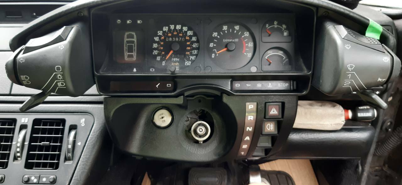

1 minute ago, Tadhg Tiogar said:
Avant, as in en avant, = forward.
Was it ever D for the UK market, or did the French get pressed into service?
We never had "D". It was always "A", regardless of whether Series 1 or 2.
I'm surprised they didn't have AR instead of R though...!
...because French.
*shrugs*

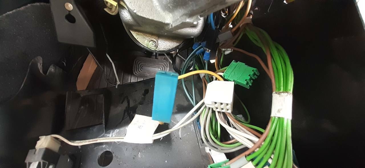

I really should do something about the heater fan and control transistor. Maybe next Saturday.

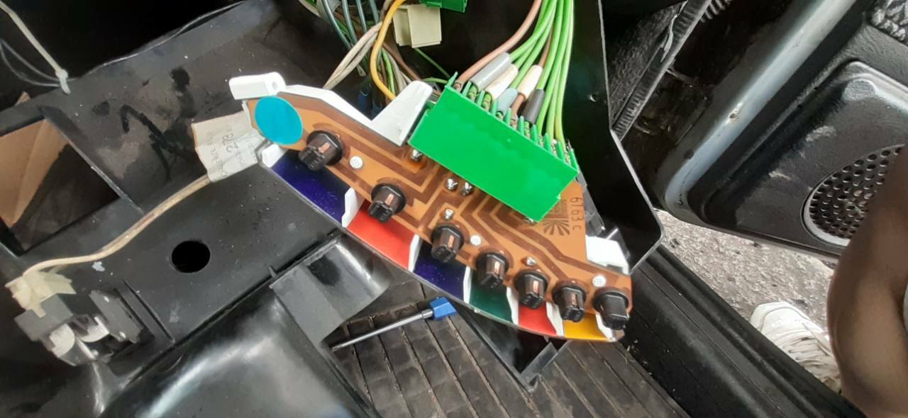

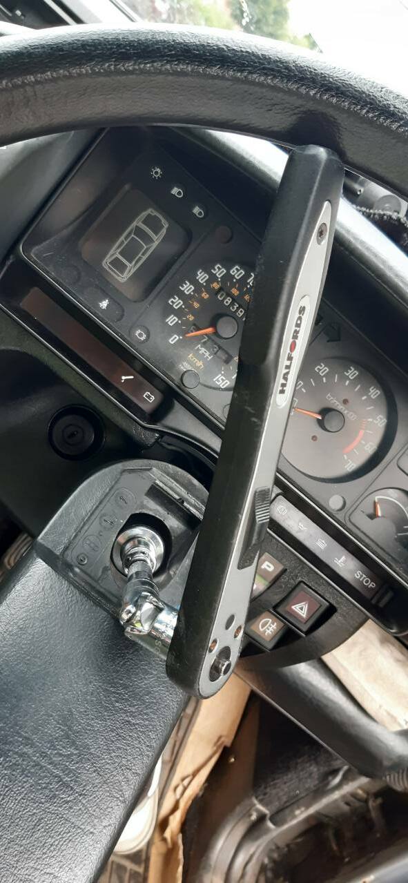

On 8/22/2021 at 7:21 AM, beko1987 said:
What's the unused bulb hole for? The secret mode? image.png.83678c24094380104b71dca82cee6dcc.png
No idea. Didn't notice until you pointed it out....!
EDIT: looked at it again. I think the unused hole is for additional backlighting, not that the indicator strip needs it since the bulb at the other end does the job of lighting up all the letters and numbers.
If I find out which strips on the PCB are negative and which are positive, then a conversion to LEDs is possible.

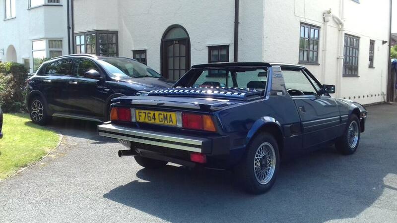

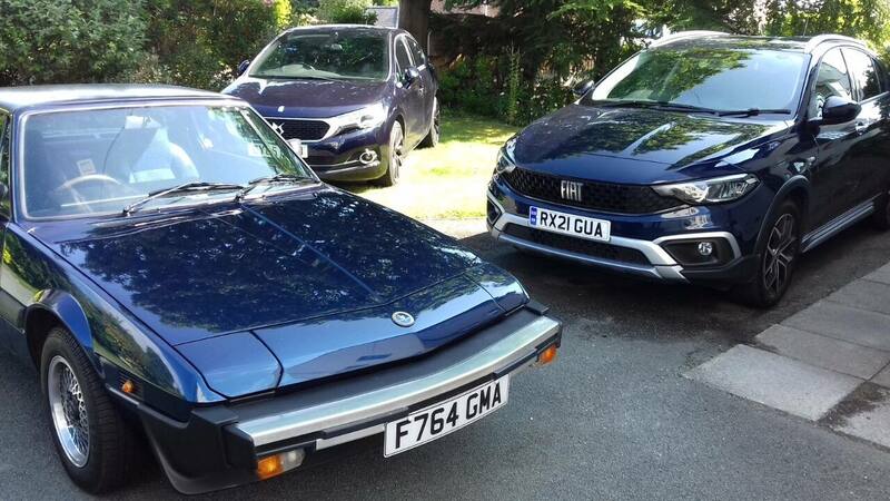

Sunny enough this afternoon to get the car out. Quick blast down the dual carriageway to marford and back through Gresford ( it’s original home) before having a long overdue vacuum ( spider webs and loads of silver birch seeds).

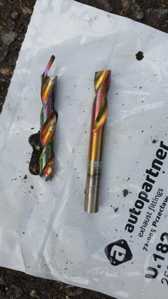

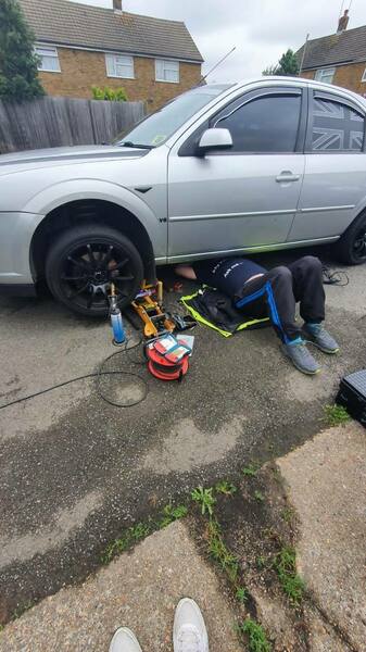

Today I did the gasket on the mondeo v6 , fortunately 1 fixing was nut and bolt, but other still stud and it was stuck solid,  chopped as much with disc cutter, the set about using many drill bits working up in sizes. It took ages, but got there in the end, ginger bearded one is missus brother, I christened his new drill(made it oily), and my son come down with his tools too help too..

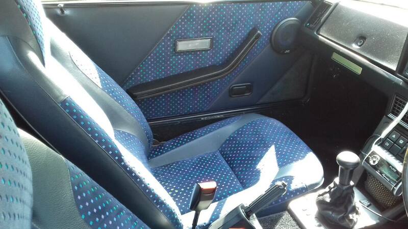

Can't be many GF's left with that seat material in such good condition!
Scroll past if u squeamish, though not that bad, drill the stud out the drill bit broke and my thumb 'kissed it's... it pumped blood out.. misses says it may need looking at that I said I need to finish the car, ran under the tap, kitchen roll and some out of date plaster, it throbbed like crazy, and it ran out... oh and I wacked my hand using drill punch...
Ouch! Small stuff like that always bleeds more than actual major injuries, then it mixes with the oil and you've got to do the full wash up covering everything in claret just to see wtf you've done,
No, there is a perfect one in the club with very low miles and perfect seats, but you can’t see them as they are under covers all the time. I have a spare set of seats in the fabric too, along with four door cards so that when I need to get them retrimmed I have the correct material. Most are done in leather or plain alcantara. I don’t think any cars with the  red pattern material still survive.
while you’re here @Barry Cade! the expansion tank was noticeably down on coolant ( below the central tube pressing). No visible marks in the garage and no leaking pipes. Heater matrix looks ok too. The only drip it’s had for years is from the automatic choke temperature thing.
after the run the tank was certainly pressurised as I released the cap after twenty minutes or so so the cap seems to be ok.
not sure what else to check for leaks?

X1/9s tend to find their own coolant level, and I've always found its just below the plastic tube bit in the reservoir.  Doesn't seem to matter if you fill it higher, they just seem to settle at that level. There is  a lot of coolant,  so quite a bit of expansion, so they just chuck out what they don't want. If you ever get the chance of a 1300 stainless tank, grab it as the plastic ones can split.
They really have to be bled carefully and in an order as this can cause the level to rise and fall.
Worst case scenario is the underfloor pipes, a BIG job but rare. Check the heater valve next to the clutch pedal as they can leak here but if you are getting pressure I wouldn't worry, just normal X1/9.. excersise the heater valve often because they sieze.. just move the temp lever back and onwards every few weeks.. most X1/9s have broken heater controls because people force them when the valve is stuck... someone really needs to get these 3D printed..

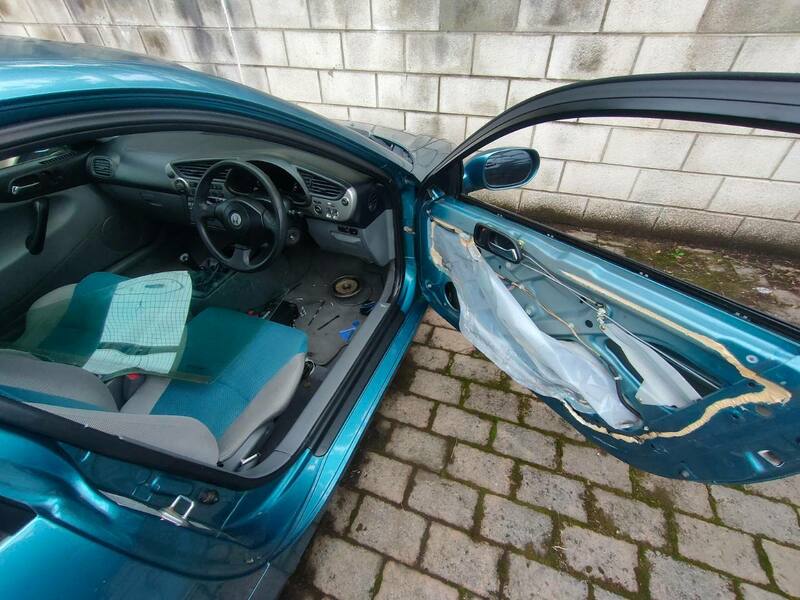

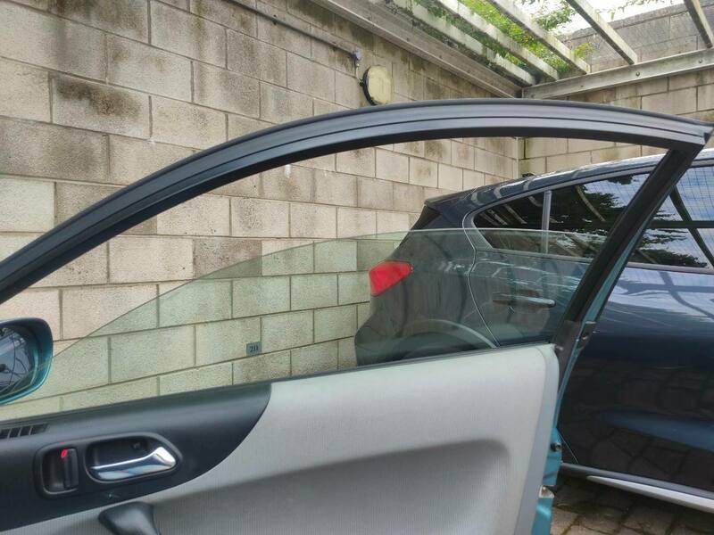

The Insight has been having some driver side window problems for a little while. Today picking up some emergency medicine for the boy I wound it down and it got stuck in this position.
The most common thing to fail is the switch. I took apart the dash and rebuilt the switch a couple of months back so it's probably not that. The next most common is the motor.
Took apart the window, removed the motor and runner and put the glass on wooden blocks. Now to see if I can diagnose and salvage
