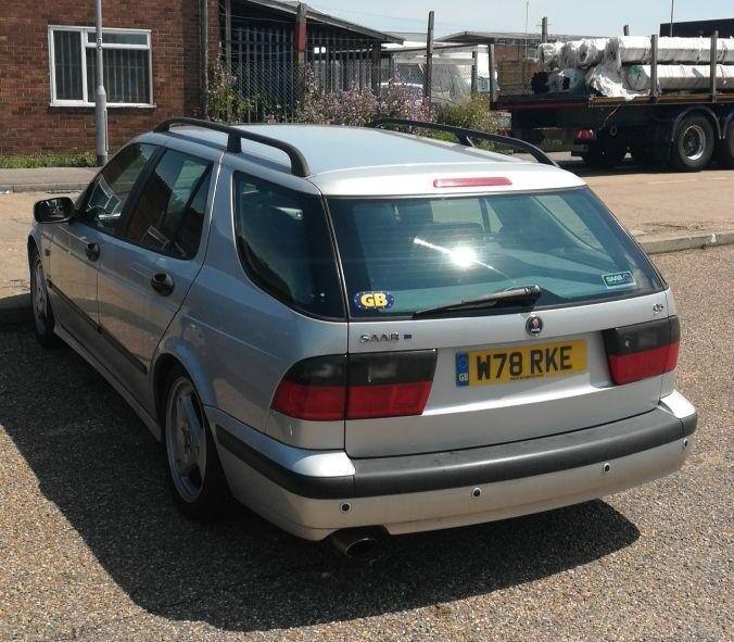

I've owned The Aero for four years today. It's turned out to be a lot better than I expected, especially considering I only paid £995 for it and never bothered to test drive it when I collected it:
Here's to the next four years :)
