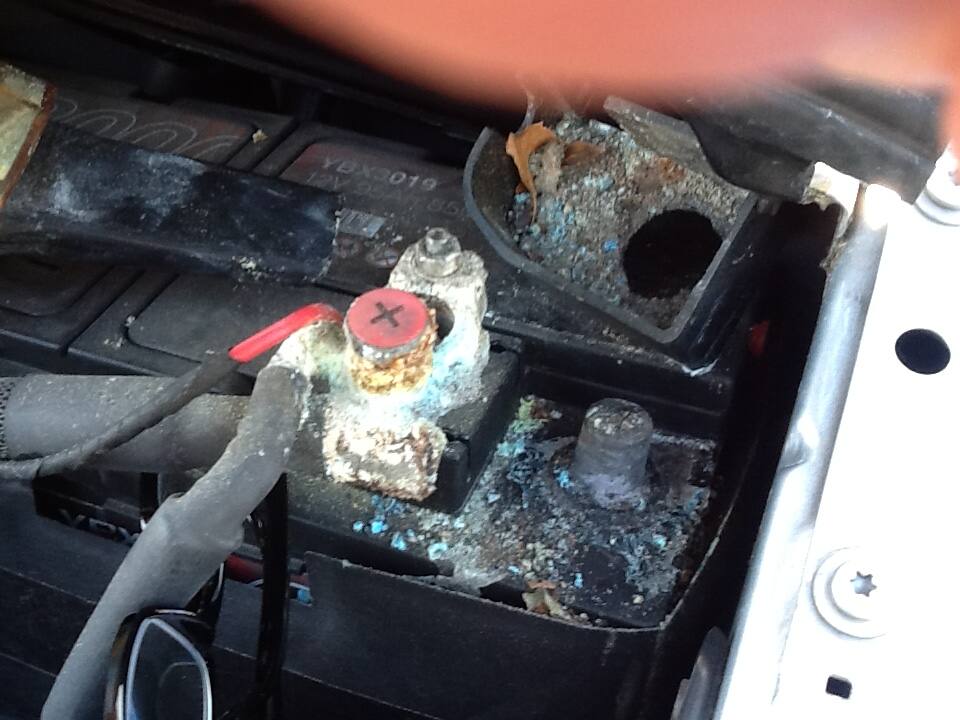

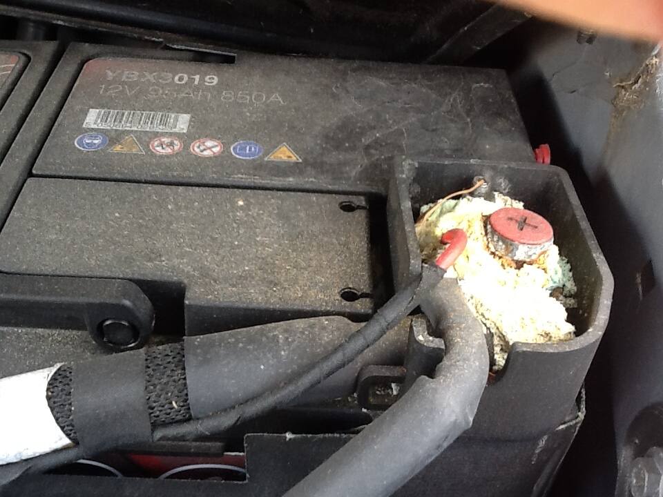

Battery double trouble. Corrolla battery fully charged on Thursday night flat by Sunday , damm . New lion battery from ECP £45 delivered .
I thought I may as well charge the van battery it's been parked for weeks and the charger was unpacked . The battery lives under a cover and I have not looked under it for years . It was a bit of luck really as the just out of guarantee yuasa battery has started to swell/expand/weep acid around the + terminal , dripping onto the battery tray . Sorted the rust on it and sprayed black . Varta silver battery £89.99 + delivery that can wait until I need the van for work again . image.thumb.jpeg.61e27106b6513f39f05c2c87b7924df5.jpegimage.thumb.jpeg.7954cd9e99724743468eb3fb6d44154f.jpegimage.thumb.jpeg.3d95cb7cafd35d03a1523f0c8c4b3d80.jpeg
Why is your "Green Fizz" purple?
@SiCyes it's a recycled pump spray , the "green fizz" cleaner was not fizzy not that green and not that good a cleaner!
its filled with Muc-Off motorcycle cleaner , which is a fantastic cleaner on most things house and car . Highly recommended by me . Got 5ltrs from a motorcycle shop called " Helmet City " made me chuckle.

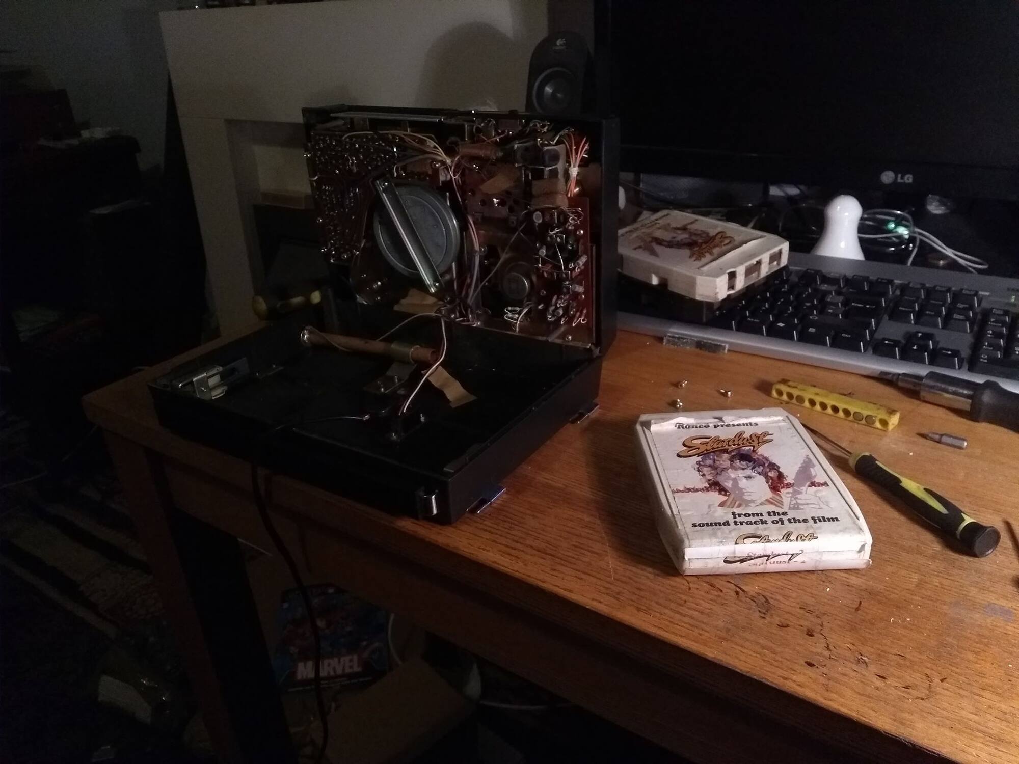

I've been fucking around with Not Cars for a change.
Firstly, this:
It's a 1973 Hitachi FM radtio/8-track stereo. The cart player wasn't working very well and all of my 8-tracks had fucked pressure pads. Getting into the things is fun*.
94883258_2988133067873456_626655085904003072_n.thumb.jpg.68a5dfc86f75ef4e7e7f8ef9b28a5096.jpg
Low density upholstering foam cut to size and fixed in place with two blobs of adhesive and a layer of tape on top seems to work.
95291710_600489187479301_5727498825208168448_n.thumb.jpg.6155916fed83eea2433851234fcc66ee.jpg
95029178_717179499084424_3272152020215136256_n.thumb.jpg.7c3db6d2a7dfbcbd46d2bf350fdd66c4.jpg
Replaced the belt and oiled some of the moving parts and cleaned/realigned the tape head. The big drivewheel drifts back and forth more than I think it should and the player runs slow, this might be because it's currently running a cassette player belt which is much narrower than the original and might not have the grip to spin such a large wheel. It could also be because the wheel is drifting backwards into the stop and dragging. Can't find a speed adjust screw on the motor so this is as good as it gets for now.

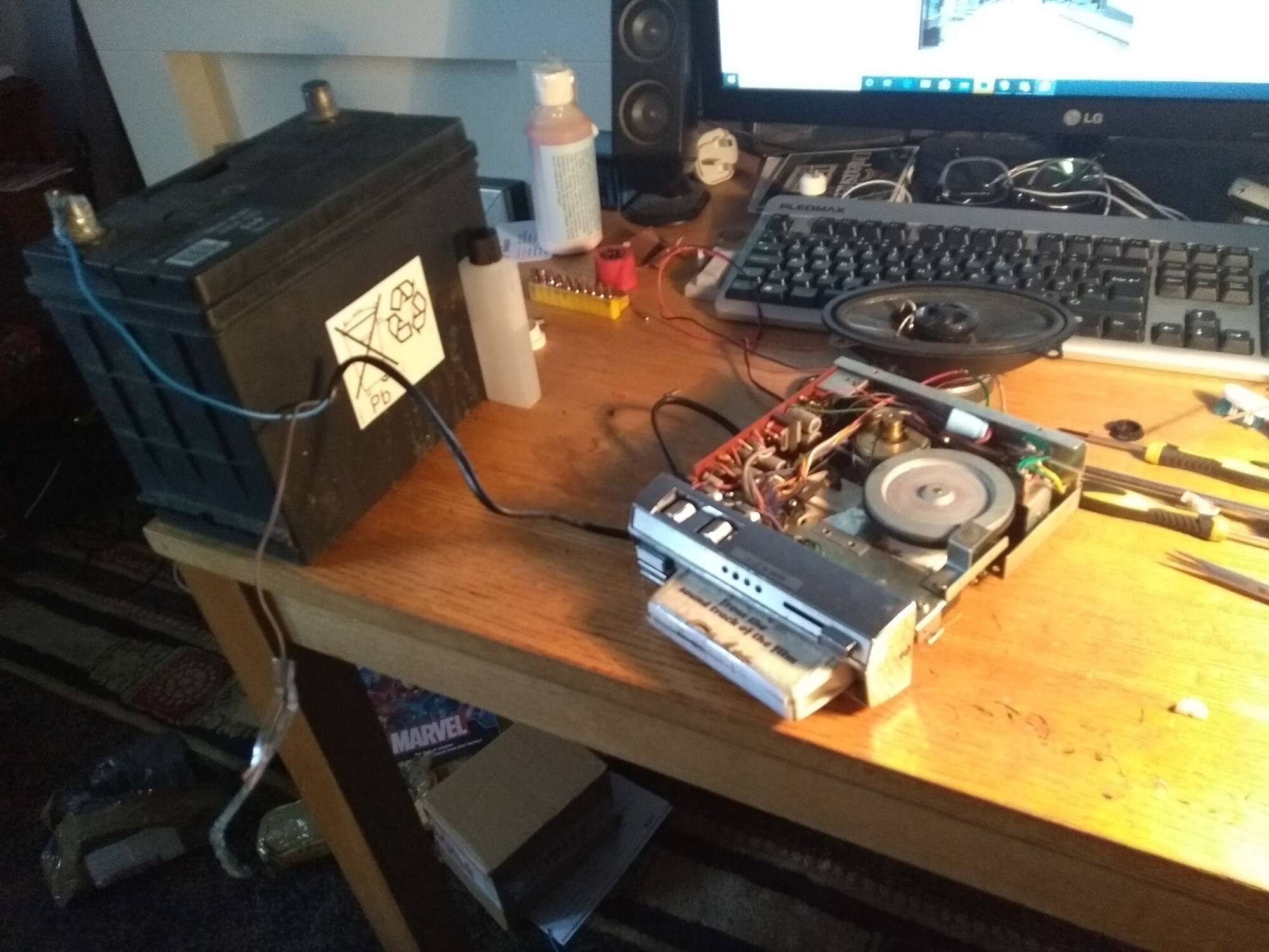

Next up was this 'in car' unit:
94706681_226922745408564_4186739518914691072_n.thumb.jpg.bd0dfa36602526ac5f9821cd29f9f4a3.jpg
95097739_694945851292335_183319799877599232_n.thumb.jpg.4939b2692f2c78f72f1364b512af36ce.jpg
This has a broken locating wheel which I'll need to replace somehow... Don't suppose anybody knows where I could acquire a 1cm diameter nylon wheel?

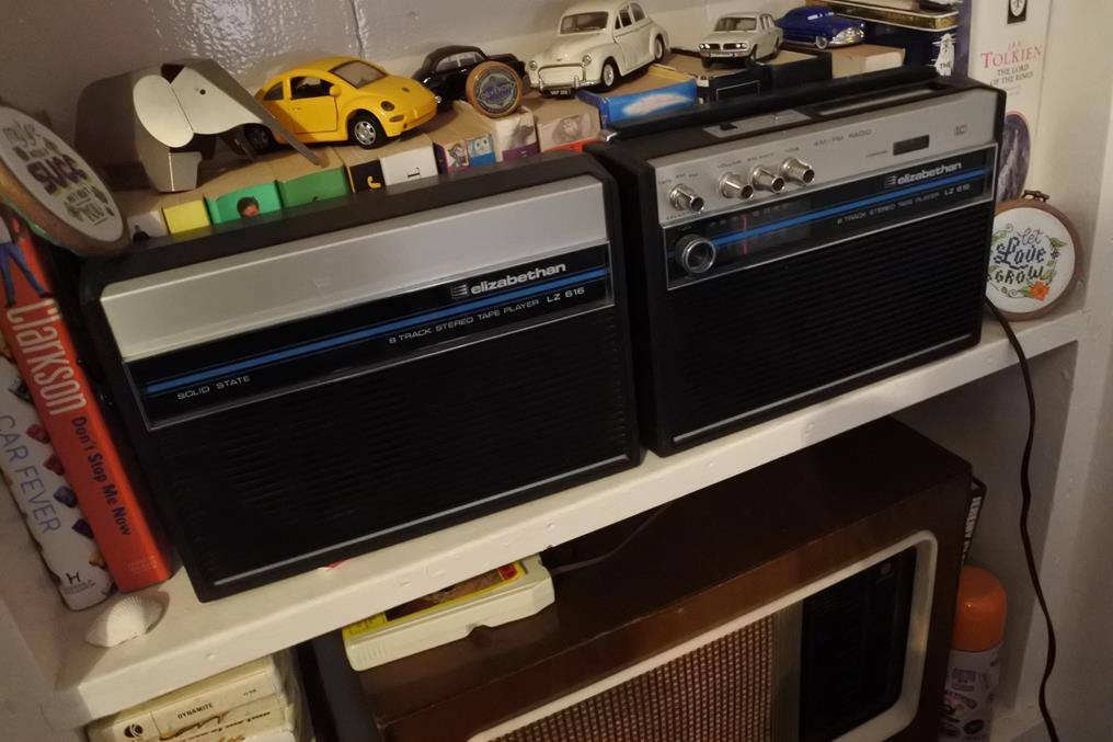

Both really sound exceptionally drive. The in car one also seems to be outputting in mono despite declaring itself to be stereo, not sure if somebody has jerry rigged the outputs as it does seem to be coming through very "hot" if you have the balance control centred.
8-Tracks seem to be universally fiddly and ungrateful things to work on.  I've been really lucky in that my player hasn't needed any attention so far beyond a good clean and the occasional alignment tweak.
Can it be solid? There's a few odd bits of nylon knocking about in the spares box, some might be about that diameter. Need to drill a concentric hole in the middle. WCPGW?
