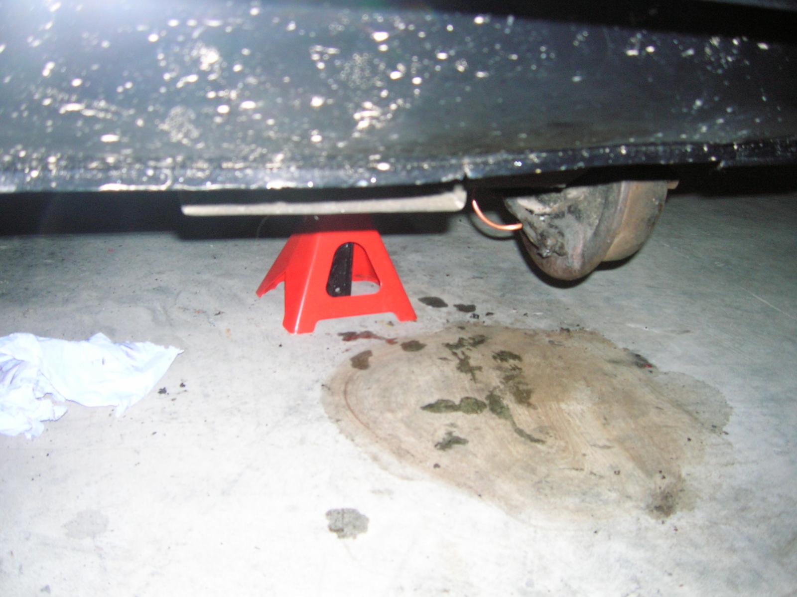

yesterday we went to the unit to spend a couple* of hours on the mini.
i say a couple of hours, when we arrived it was dinnertime, and we left at 8pm and it was dark...
we got the last brake pipe on, and then had a go at bleeding the brakes. i friggin' hate doin' friggin' brakes....
the Haynes book of lies says bleed the n/s front, o/s front, then n/s rear then o/s rear. the front brakes, no bother at all as they are new cylinders the back ones? HA HA HA HA!!! not a chance. coverd in shit and not touched since adam was a lad, those bleed nipples won't move.
bugger. shit arse wank, drat......
as we have both wheel cylinders and brake pipes in the box of bits, we had to change them too.
now, back to bleeding them brakes, go around the car, all done. but no brake peddle.
so, go around again. still no brake peddle.
OH FOR FOOOKS SAKE!!

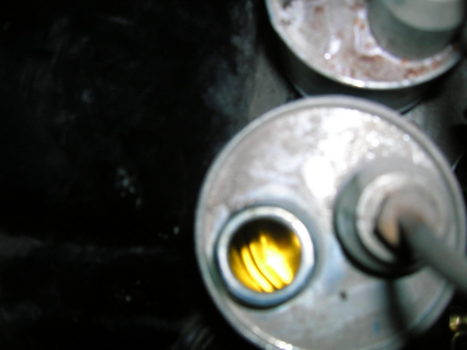

i don't think i've ever, ever sucessfully bled a cars brakes, even with the humourouly named "ezi-bleed" thing. this one is fastened to a tire and pressurises the brake master cylinder, and hopefully the rest of the brake system. (i don't think it does)

Feel your pain, MarvinsMom, hydraulics are a ballache.  Have you checked the flexi lines?  Given the state of the other stuff you've been dealing with, I wouldn't be surprised if they're completely knackered and no amount of bleeding will help you without replacing them.
The M11 was fucking terrible yesterday.  Especially on the bit around the Stansted turn-off.
It was indeed. My Mrs said its 'cause its mother's day. Being woken up with half a cup of cold tea slopped in the saucer obviously not good enough these days so they're taken out for a fucking good queue.
I was more than a little foolish myself, having filled up with lpg at St Neots I did an orbit of the m25, went to Maidstone and was startled when the Rover started spluttering at Cambridge. Onto petrol and it misfired like buggery which is not useful as they've taken the hard shoulder away. Just made it to the A14 services but need to get the carb working properly.
the front flexi's are new, the back ones.... less so!
we may yet end up changing those too, it could be that we were just trying to bleed them quick, more quickly than they need. certainly some of the brake fluid coming out was frothy in nature. what we need is to take more time with it.
the odd thing is that the peddle was soft as a soft thing with the first press, then it was firming right up.
we have got a pocket of air trapped somwhere, so i'm hoping that with further effort we will get all the air back out.
