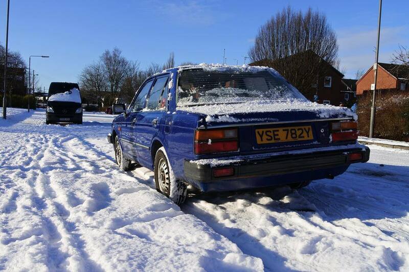

Celebratory snow:

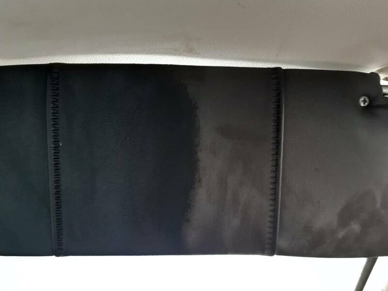

Bought a little mini head for the wet vax to do the seats and carpets, bringing the total spent on my VAX 6131 to £8 'cause a mate lent it to me and then replaced all his carpets with laminate...

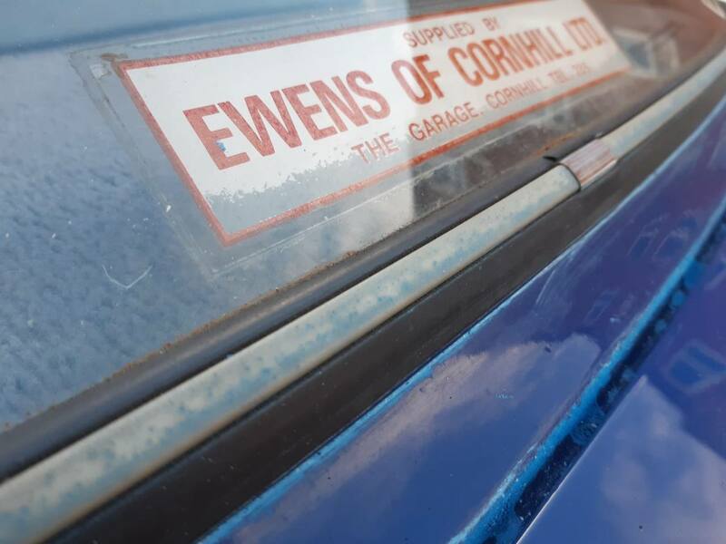

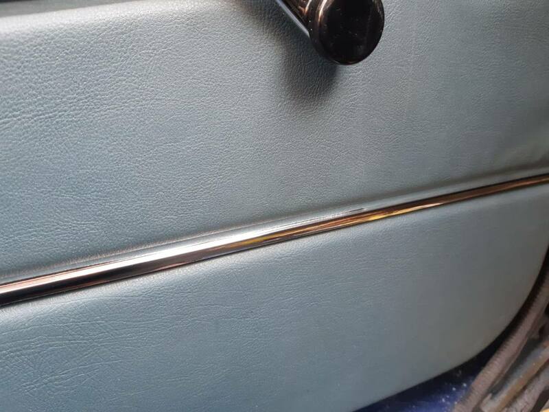

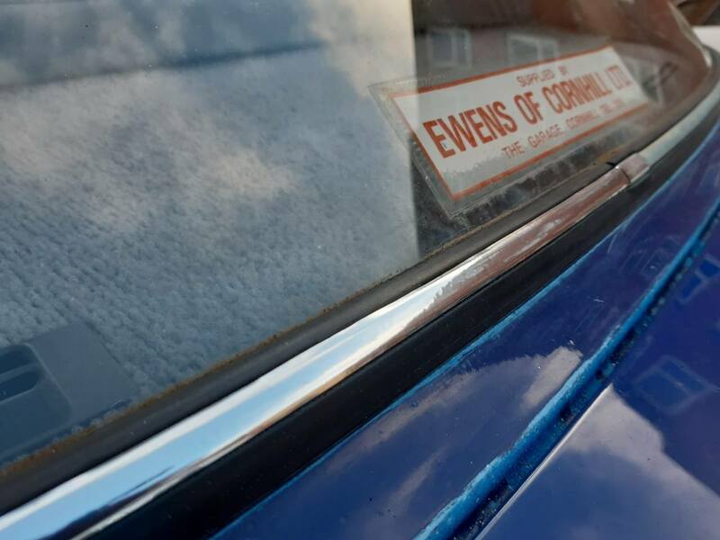

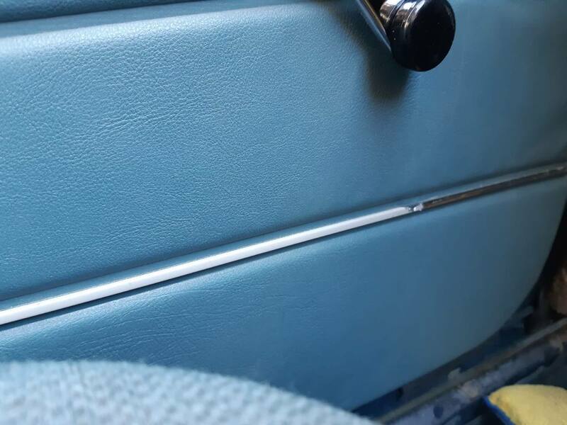

Then some experimentation with self adhesive chrome tape, as various bits of the car's original trim is deteriorating with age.
Sadly it's really not keen on corners...
  • captain_70s changed the title to Rusty Triumphs in Scotland - De-shittyfying - 16/02/21
Still looks eleventy-million times better though doesn’t it? Keep at it I say.
May need a heatgun/hairdryer to get it round the bendy bits? The wrapping wizards on yootoob seem to get stickyback plastic around impossible curves.
Aye heat gun will work wonders on the corners.
That chrome insert stuff isn't that expensive.  If the seals are good and the joiners are present, you can get the relevant profile from various suppliers and install it with screwdrivers and patience if you have to.  I tried aluminium tape myself on the Princess' rear screen trims that have no curves and while it looked good for a bit, it soon started peeling off in odd triangles.  Still, for interior trim it usually works a treat and what you've done on the door card looks great.

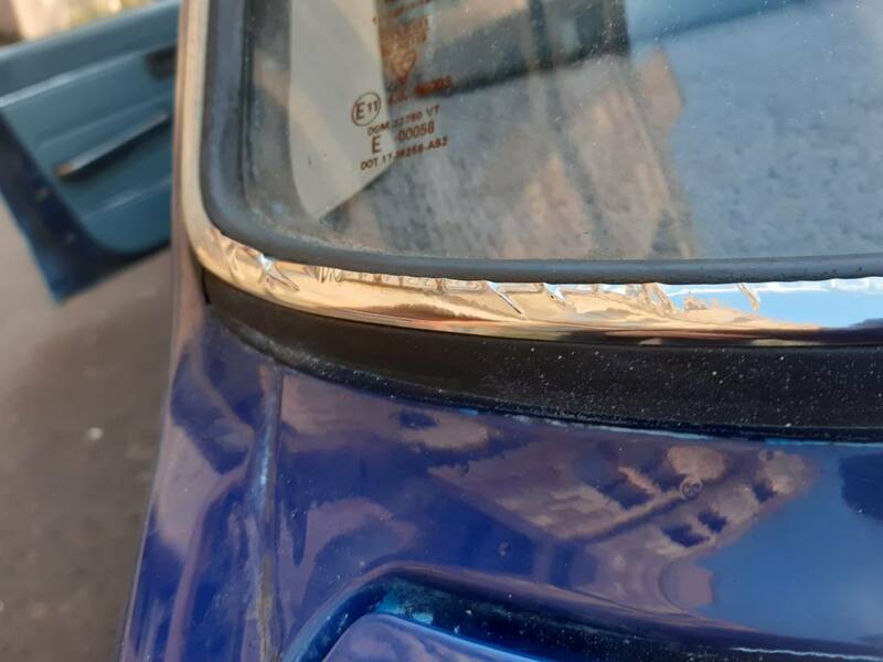

Rear screen seals are NLA and mine are shagged. I don't even want to go near it, just gonna' fill the cracks with Arbomast and pray for it.
Watching your Maestro videos recently and I'm going to have to do a similar water leak hunt. The boot is filling up with comedy levels of water and the rear screen looks like a greenhouse,  reckon most of it is from the rear light seals (foam, also shagged), that Butyl tape stuff you used looks like it could sort that...
Will try application of heat on next application of tape and see how it lasts. I've left one quarter of the rear screen done to see what it does when exposed to the elements.
I wonder if you could mask off the trim and use a chrome paint on the insert, it was a consideration on my front screen before the new seals were available through the club.  Never did try the idea out.  Only issue with the butyl tape is getting it off once you've put it on, foam is easier to deal with if you can get it in the correct size.  I bet the water getting in on yours is going to be some piddly little pinhole somewhere, it's amazing how much water gets in a car through such tiny hidden holes.

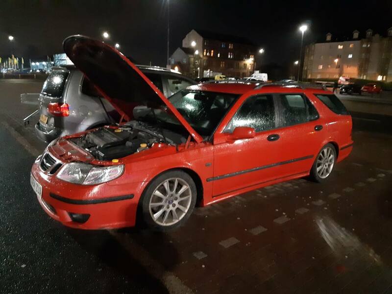

Saab has a new quirk whereby it seems you have to tug the key upwards a bit while turning it or it just cranks the starter and doesn't fire. Cheers for @320touringfor suggesting the solution, otherwise I'd still be stuck at Tesco...

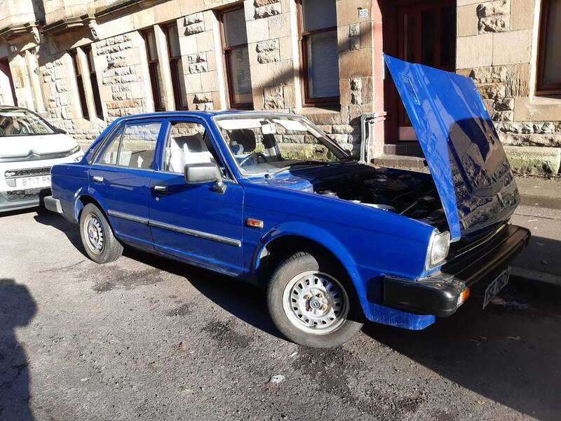

First sunny day for a while so went to try and diagnose the Acclaim's running issue.
153228736_10226410160099525_5690975707419938427_o.thumb.jpg.4bba295d45bc084cdb4572f163b9896c.jpg
Naturally the battery had gone flat again so I had to bump start the car down a hill to drive it round to the flat while it ran like arse. Once it was parked it stalled and the battery wouldn't restart it, so I swapped it's battery for a spare I had upstairs. Annoyingly this had Japanese standard terminals and one of the adaptor rings was missing, so ingenuity was applied.
152503152_770923956882467_8627152595094310663_n.thumb.jpg.d2a2412c604446ea55c8a3cb7cba9c97.jpg
I replaced the ignition control module, which did nothing.
I tried revving the car up and covering the intakes to try and suck any shite out, this also did nothing.
When trying to restart after stalling it kept backfiring through the carb and kicking and then immediately stopping dead like it was out of time. Checked the dizzy and that was tight and hadn't spun loose, so unscrewed the cap to have a look inside and found the issue.
The rotor arm had a good centimetre plus of slop on the shaft. The shaft itself was tight and the advance mech all seemed alright but the arm was loose as buggery. So I whipped out the spare from the boot that was known working when removed and... That was exactly the same. Somehow my dizzy shaft has worn in such a way the rotor arms won't hold true. I wedged a bit of thin carboard between the flat of the shaft and the rotor arm to test the theory and was rewarded with a car that would rev smoothly but not idle and was taching down far too slow.
It's hard to say if the lack of idle and slow return after revving is connected to the dizzy issue, I suspect I've just disturbed something in the throttle linkage while fucking about.
Gonna' try TIGing the dizzy shaft and file it down, 'cause I can only find one place that lists the dizzy as in stock and it's £150.

No good used dizzies available? Might be worth wobbing it rather than welding.
It might be possible to just glue the rotor arm to the shaft?
Also, that fresh paint job looks very BLU.
Don't all rotor arms have play in them like that? I wouldn't go welding it until its definately confirmed as an issue as it could ruin a perfectly fine dizzy
