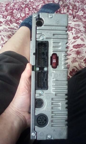

Ah. They aren't the same.
The new radio is just a normal style radio, my original one has a seperate amp. Speaking of which:
206009658_961161818006028_5791547472857161992_n.thumb.jpg.259479bb451b0cf5295069cb3d6e6d5a.jpg

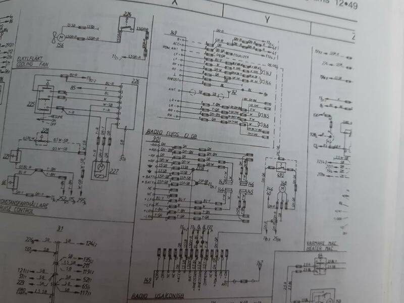

That top diagram shows how a radio setup usually looks. I don't have that, I have the bottom one. Which means that the DIN adaptor cable I bought...
203218765_1156867024827342_775948099417566303_n.thumb.jpg.8f9e89aac92fabfec28b3688bb228e2d.jpg
Also wrong, uses the same connector but the old style wiring layout. I think shared with late Volvo 240s...

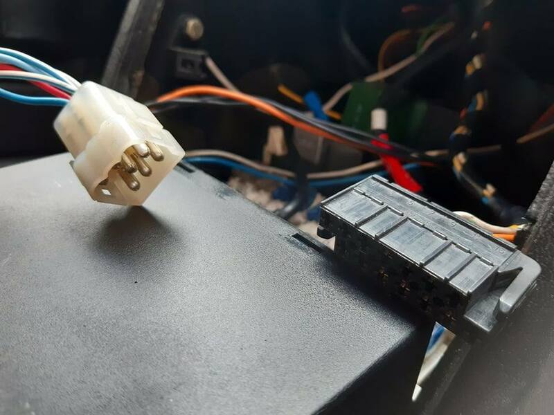

Essentially to get a functional radio I'll have to chop the amp connector off, which lives here:
204018670_314984173638553_387310266513856160_n.thumb.jpg.4c332ba6437113cc914b9c474c2c3cba.jpg
And reroute all the speaker wires up to the head unit in the dash. Then nick the power cables from the original loom head unit connection to power the radio itself.
Doable, but also means chopping the loom about and removing an easy ability to revert back to the stock radio is mine is repaired or whatever. Also needs about 3ft of cable to run from the amp area to the head unit area. In summary a complete fucking faff, not actually any easier than wiring in a stereo from scratch - Likely the next course of action.

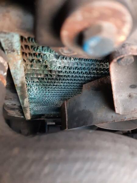

The Acclaim's radiator has also reached the end of it's serviceable life. It's been leaking for ages but now it's started getting quite warm on motorway runs.
It could be recored, but I'm looking into fitting a mk3 Polo rad, because @jaypee said I could have one for free. Which is a damn good price, and it's a bigger unit.

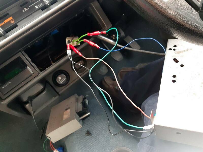

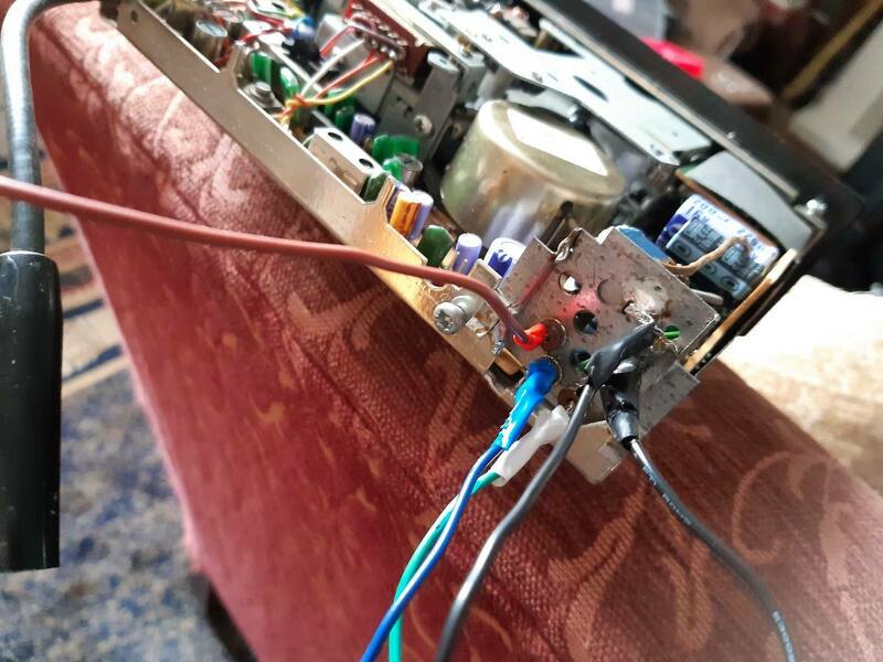

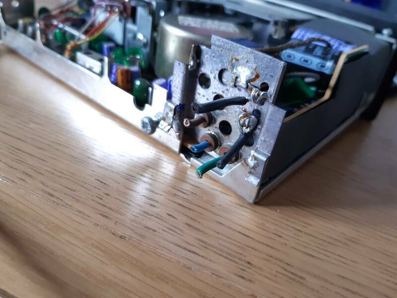

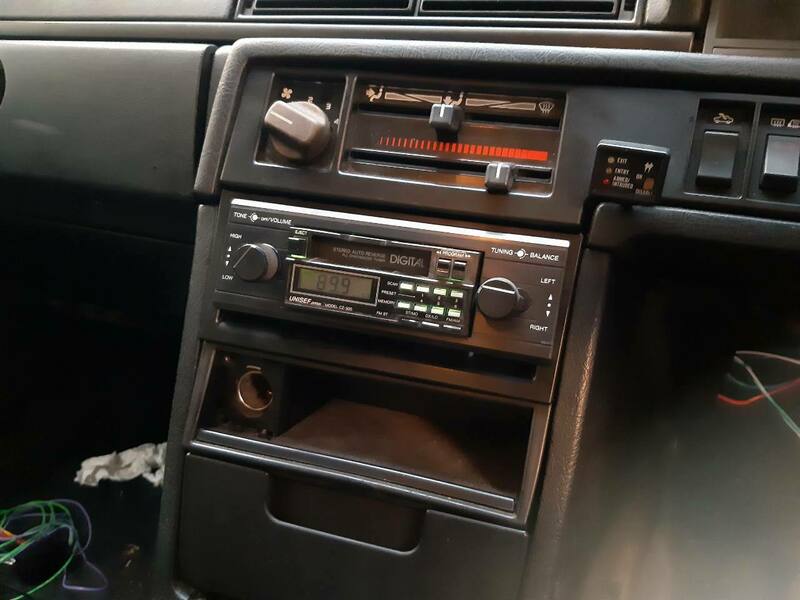

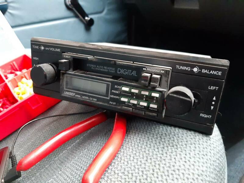

Radio solutions were sought and implemented.
I had a known working radio cassette in the Acclaim with pre butchered wiring, I also had a factory Acclaim radio cassette I'd never fitted because the wires had been cut really short.
So, the soldering iron was set loose and the cables lengthened. You don't get to see the soldering cause it was shit.
It was then installed into the Triumph with bullet connectors.
Not the neatest install, but it works...

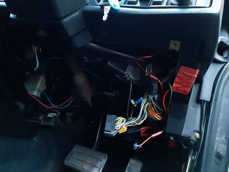

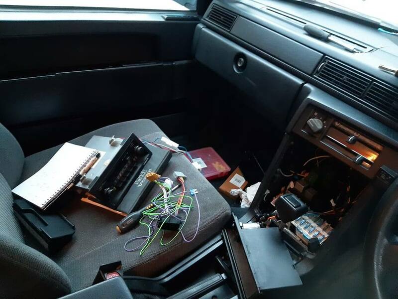

I then went about working out how to put the old unit in the Volvo.
Handily I discovered the solid core wire I'd bought was the perfect size for jamming securely into Volvo's connectors...
this was a boon as I'd planned on having to remove the door cards and run new wires. As it was I could just hack into the original loom at the amp plug for speaker connections and into the head unit plug for 12v and earth.
The head unit was wedged in with self adhesive sound deadening foam and the outer bit of the original factory surround.
Naturally the driver's front speaker is blown and sounds shit, but fuck it. It'll do for now.

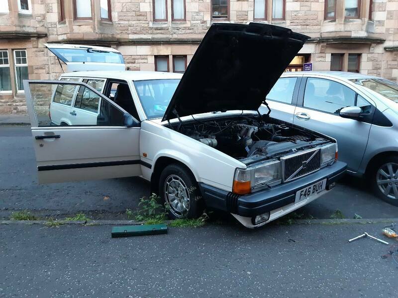

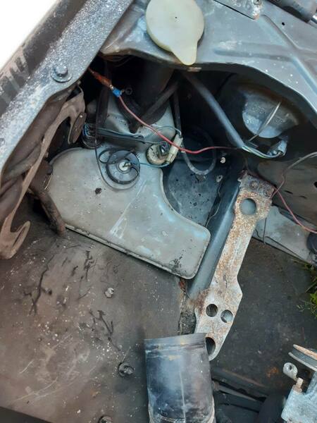

Stage 2. Earths.

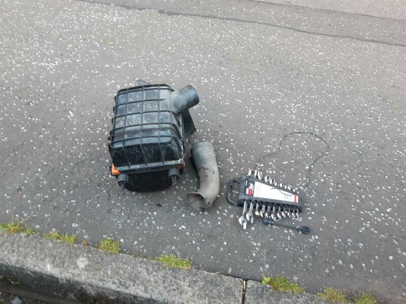

First to remove the (broken) airbox.
This reveals the washer bottle and motor.

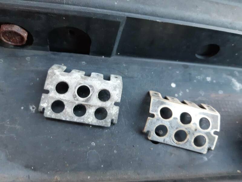

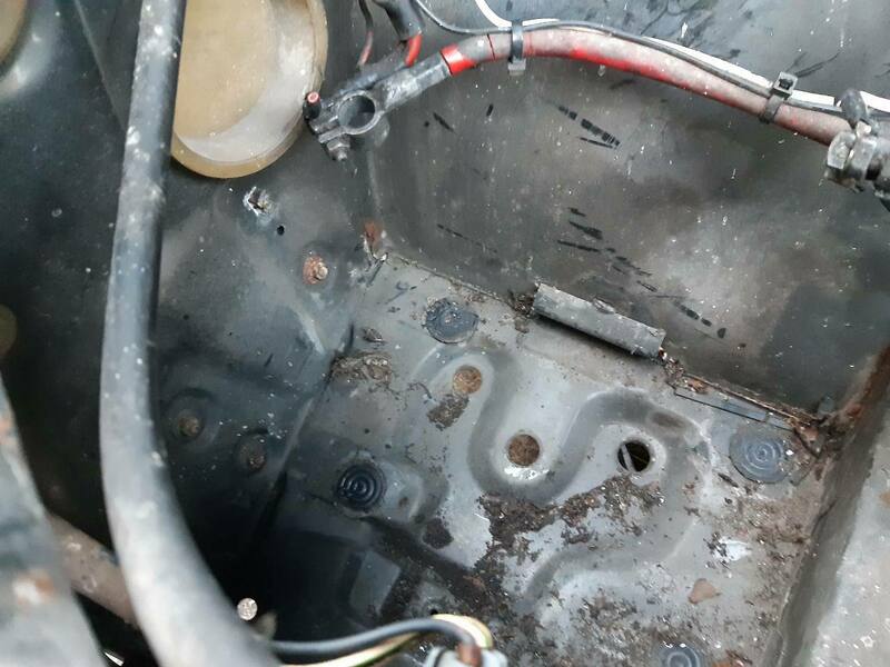

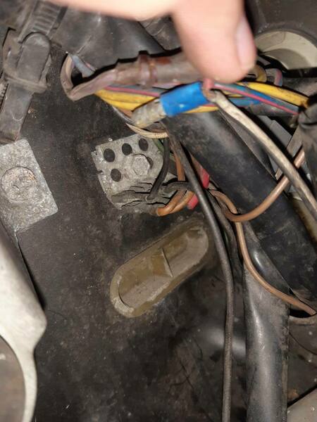

Tucked against the inner wing is this block of earth points:
looking fairly crusty, so removed and attacked with 250 grit sandpaper.
There was an identical block on the other side behind the battery which was cleaned in the same way. Observe the lack of holes under the battery tray, rare on a 740!

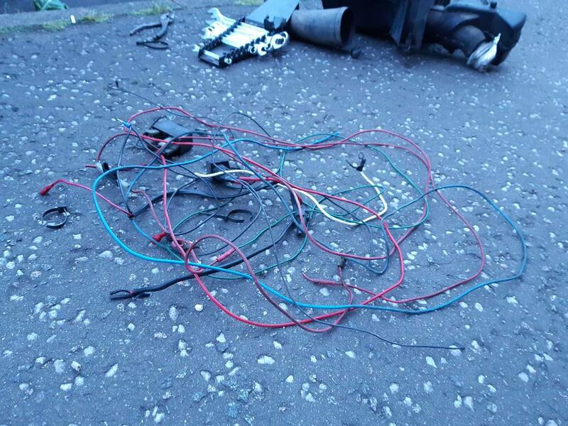

I also managed to remove some superfluous wiring...
That's 90% of the redundant alarm/beacon/radio wiring removed forwards of the bulkhead. Still plenty stretching through the cabin but that'll be a cunt to remove.
Overall result... No change. Still electrically senile. Bastard.
There are still multiple areas where wiring has been hacked in to for various ancillaries, so will require further prodding....
daft question, you did replace the crimps as they get crusty as fuck and are useless
Just wedged sandpaper down them 'cause it was getting dark. Ideally they need dunking in something corrosive or replacing. They are manky.
snip, strip, crimp, repeat umpteen times. decent set of crimping pliers and get it tight... mine cost me 3 quid 30 years ago lol
