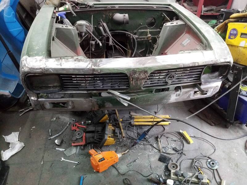

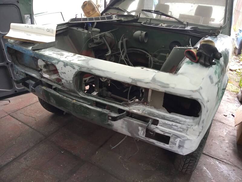

S0. To recap the car looked something like this a couple of weeks ago after significant prodding
It now looks like this:
116704237_921733224982501_64070118404163794_n.thumb.jpg.90e33d689d45062a924cd67969f5539c.jpg
Yup, first bunch of filler now on the passenger side and in the process of being sanded back. There is a lot of sanding to go mind, there should only be a tiny skim to even out the hammer marks by the time it's done... The driver's side still needs a couple of tweaks before it's ready for filler. Here is is pre-filler to prove it isn't sculpted from P38:
IMG_20200727_123759.jpg.c9cd772b36058d1efec91a0a7fa960e6.thumb.jpg.1d2bd50630337731773dd56373ef9029.jpg
A fairly important thing to note here is that because the metal left on the car was so corroded there was essentially nothing left to work from. The lower corners of the front wings were entirely misshaped filler, the headlight retaining structure was gone entirely, as were half the bumper mounts. All the new metal work has been made by @GingerNuttz from scratch and working from photos online because there was either nothing left or what was left was bodge...
It also appears that either there were a couple of varieties of front valance or that the tooling got so worn out the later cars were different to early ones...
The leading edges of the front chassis legs were also entirely replaced, as were several panels behind the valance - I cunningly failed to take any pictures.

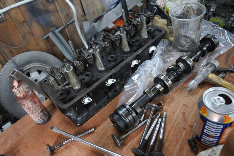

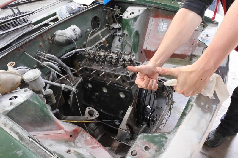

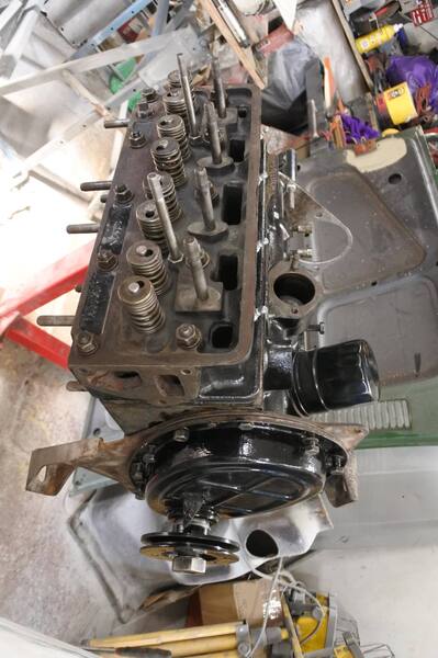

@GingerNuttz has rebuilt the cylinder head.
It has new valve guides fitted and a mixture of it's original valves and spares from @GingerNuttz's Herald re-lapped in. He's also removed a significant amount of casting flash and superfluous metalwork in the inlets for better air flow!
We pulled the cam out and found that there was some scoring to the end-most surface so it was swapped for the Herald's original cam as well, which also featured slightly more lift. We drenched it in assembly lube before fitting.
With that decided the gasket and front plate were fitted and the end float on the cam checked - We're in spec!

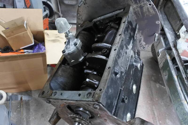

I checked the torques on all the main/big end caps and fitted the new oil pump. Then we checked the end float on the crank. It's within tolerance but not by a huge margin.

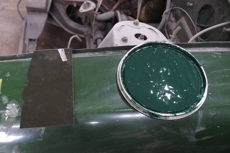

The paint arrived. It's labelled as "BRITISH RACING GREEN RAL6009" and is a putrid shade of very nearly brown and a consistency of water. GR9.
I'd ordered it straight to the workshop so the first time I actually saw it in person was today. It was just as horrible as it looked in pictures. So we went down to a local paint supplier and deliberated over swatches for far too long before picking an appropriate looking shade. They tap the code into the computer "it comes back as Leyland Brooklands Green". After all that we'd managed to pick out the exact colour the had been when it rolled out of the factory...
116434782_332119241530950_312120916462537109_n.thumb.jpg.39e4ddba17ccb7e795620bcada23472d.jpg
On the scrap plate to the left is the RAL6009, the paint on the tin lid is BL Brooklands and the paint on the car is... Something random it's been sprayed in the past. One thing is for sure and it's that it'll look ace in the proper colour!
By the time we got back from the paint shop it was packing up time so work shall continue tomorrow. I think the plan is to have the engine assembled so it doesn't get filled up with filler dust during the sanding marathon...

Nowt could be done about the crank end float, it's got the thickest washers available fitted, the market for 20tho over thrust washers will be emerging shortly!
Is it 15 thou ones that are fitted ?

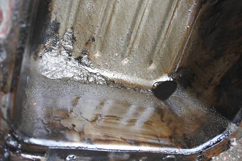

The Dolly's old sump has been marinating in petrol for the last fortnight to shift the sludge. Result being the oil can be wiped away leaving the metally goodness behind...
The good news is we have enough material in there to melt down and make a new oversize thrust washer.

Panning for gold autoshite style with a dolly sump full of petrol!

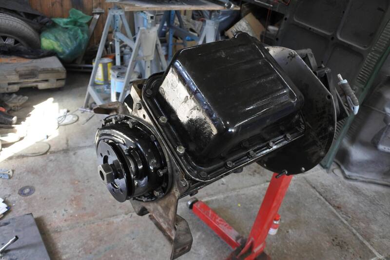

Back at it today.

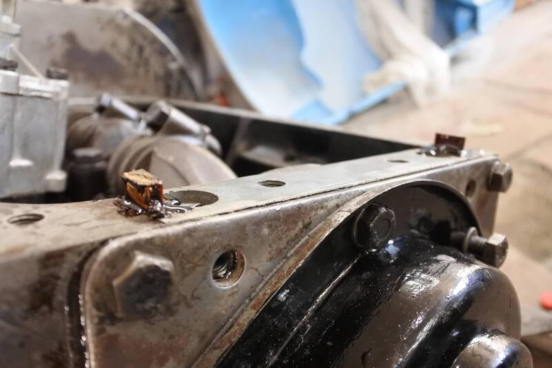

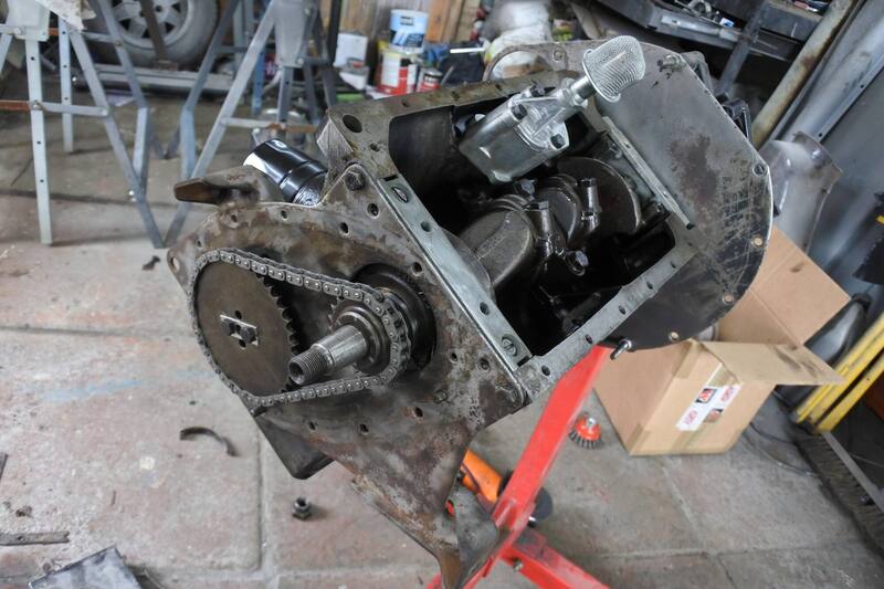

Timing chain is back on and in the correct place.

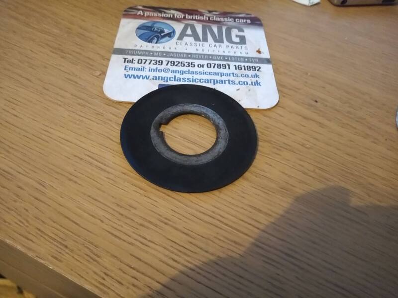

It was at this point we realised that the oil flinging washer from the Dolomite wouldn't fit this application because it's for the larger diameter crank... This was a "FOR FUCKSAKE" moment. Especially as I HAVE one the right size, on the engine in my basement. I just retrieved that tonight but won't be back at the car until next weekend.
116906633_578532326158118_4336952360794072776_n.thumb.jpg.a8cbc76c35546f5d8824893b217d8bc8.jpg
The timing cover was also sandblasted/wirewheeled and painted. The sump was cleaned and painted.
The thrust washers being 15 thou over is a concern in combination with the crank end float being so close to tolerance. The thrust washers are half moon shaped and sit on top of the crank at the end cap and take up the fore/aft slop in the crank, they can also prove to be a major Achilles' heel. They are intended to be a sacrificial wear item and as the gap increases will wear faster and faster, it isn't unheard of for these to work loose when towards the top end of the tolerance and to simply drop into the sump with catastrophic results for the bearings and crank surfaces.
Given the slop is already quite high and the washers are the largest currently available I'm going to have a 20 thou washer custom made. A minor expense that will allow the whole enterprise to last longer and minimise the risk of thrust washers making a bid for freedom - Especially with me doing city driving and using the clutch a lot. The replacement engine is already machined to the maximum degree so any damage/wear would essentially render it irreparable. I'm aiming for 60-80k of careful use, if it throws a thrust bearing at 6,000 miles and lunches the crank I'll not be impressed for the cost of a £30 part!?

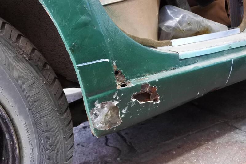

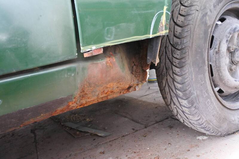

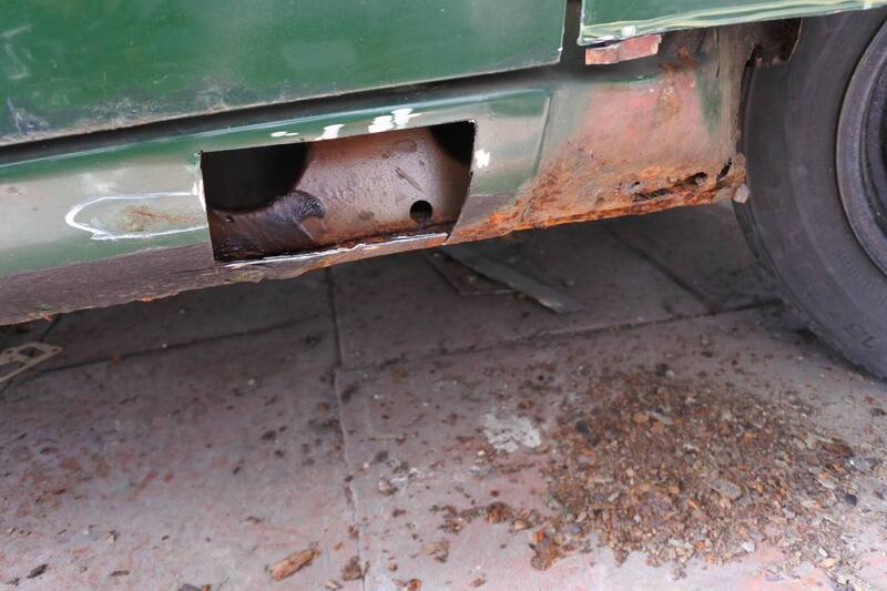

With the engine at a standstill awaiting parts we turned our attentions back to bodywork. In particular the bottom edge of the front wings are crusty...

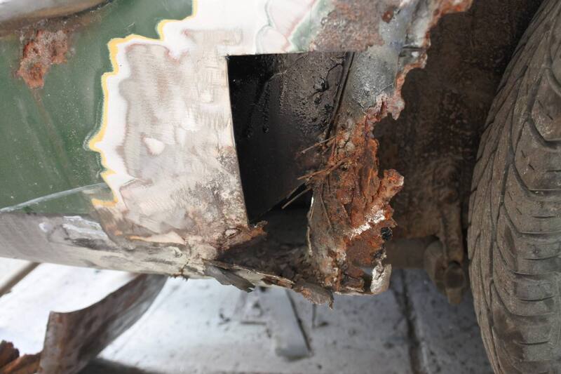

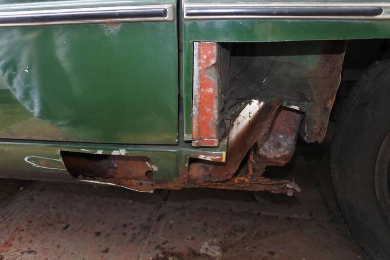

Cut away the bottom of the wing.
Traditional end of sill rust. I cut another hole in the sill a bit further along to see the extent of the damage.
Fucker's mint inside! The only major rot is the outer at the bottom where it joins the inner.

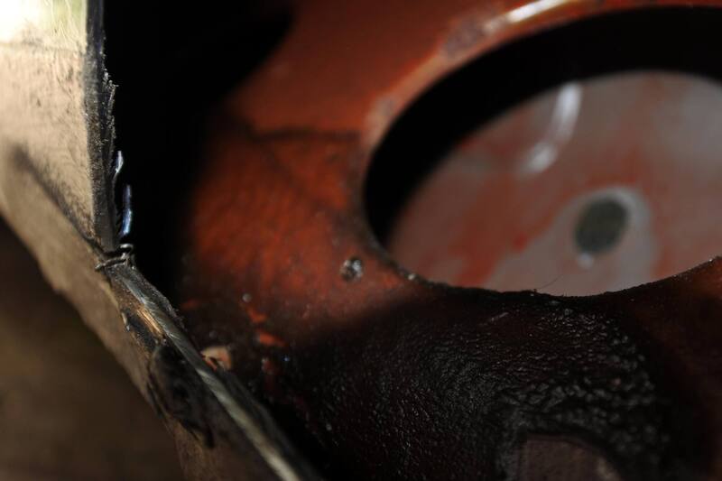

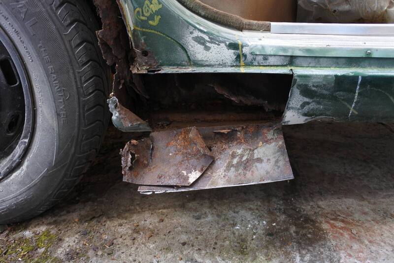

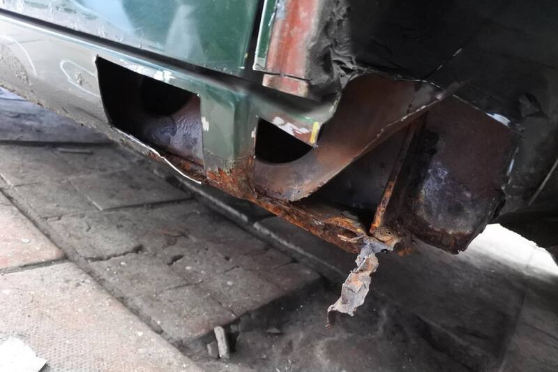

The jacking point however was fucked. These are a vertical box section with a plate at the bottom and they always catch mud and rot out. More wing was cut away to get at it...
At the right side of this picture you can see two remaining sides of the box section jacking point. The other two were torn off largely by hand!
There had already been a plate welded in to the leading edge of the inner arch, that was all cut out as well - Quite an impressive pile of bits.
We started making various bits for the jacking point and sills out of 2mm galv steel. The galvanisation proved such a fucker to weld to we resorted to grinding it all off. ? We're also going to make everything in duplicate, because the other side will be just as bad...
While down there @GingerNuttz let out a cry of "whaaaaaaat the fuck?" and pointed along to the sill repair I paid the local garage to do 3 years ago.
So, it appears that's a sheet of steel wrapped over the original sill, except at the wheel arch end where they've had to lop it off and stick in a flat plate, it's then all been smothered in filler. I dug out the receipt for a laugh. £220.
So we'll need two full outer sills. I looked up the price of the TDC panels and reeled off the prices to @GingerNuttz who made dismissive noises and threatened to go into the business of making them by hand while under-cutting the TDC and still making fat stacks.
This was the first day I've actually cut any bits off the car or made up any bits to go on it. It'll not be the last...
re: thrust washers.
as a serial big 6 fettler i know all abpout thse bellwanks dropping out.  the hot trick here is to pin them with a brass pin so they cant drop out when worn.
have a gander here, there be some excellent links. if youve got them out, its worth doing.
https://www.tr-register.co.uk/forums/index.php?/topic/30562-thrust-washer-pinning/
http://tr6.danielsonfamily.org/ThrustWashers.htm

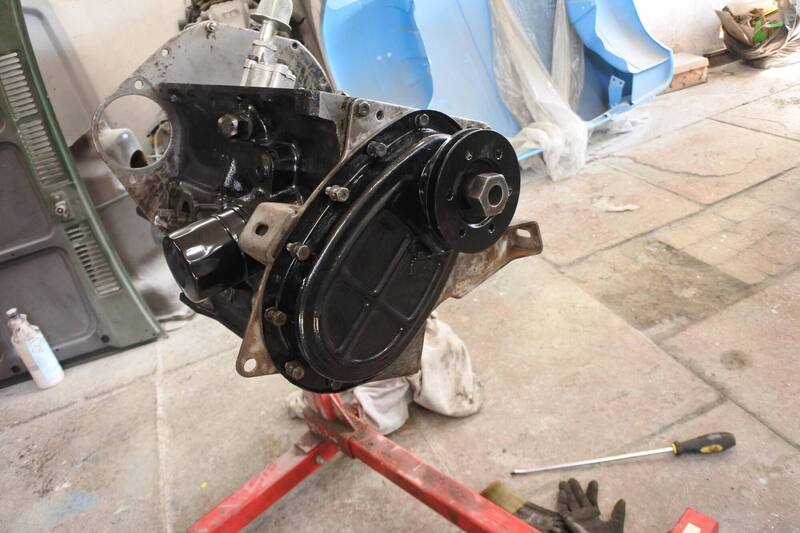

So, me, @GingerNuttz, @davidfowler2000 and @jaypee were involved with Dolly related shenanigans this weekend.
One major goal was to finish assembling the engine and shove it in the car so it could be sealed up away from grinding dust etc.
You know your car is high tech when it features wooden sealing blocks in the engine...
Mission accomplished! Big thanks to the whole crew for the aid in fitting it. The whole engine was lifted into the car and installed by hand because building the crane seemed like a faff...

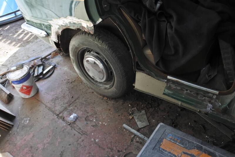

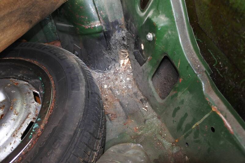

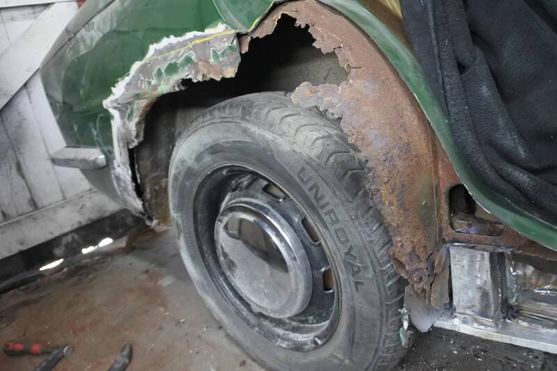

More digging in the bodywork occurred and bad things have been found.
So, the tail end of the sill was at least three patches deep, with another underneath and one around the back. The inner arch also had several layers of "repairs".
The arch under the riveted repair panel was even worse than the other side. Further prodding revealed...
The entire inner arch was crafted out of filler, over the untreated rust metal, it'd then been undersealed. It mostly pulled apart by hand...
The entire inner arch will need replacing, the top of the sill and the door jam above the wheel can go back in but were removed for access. The rear inner sill and reinforcing panel were both remade and welded in in an attempt to give the car some structural integrity before the door jam was cut away.
Oh, the boot floor is also fillered, and sections of the trailing edge of the arch seemed to be entirely made of weld...
You can't get panels for the inner arches, we considered buying something similar for another, more popular car, but they're mega money. I also really need another wheelarch repair panel for this side, naturally there are currently none for sale, regardless of price.
Every "repair" that has been carried out on this car has worsened it's condition to the extent it is now well beyond the point where anybody would bother saving it. Especially as it's a sub-Sprint car, the man hours involved will lead to resto costing several times the car's end value. Naturally work shall be continuing onwards despite the fact we never expected the car to be this bad...
