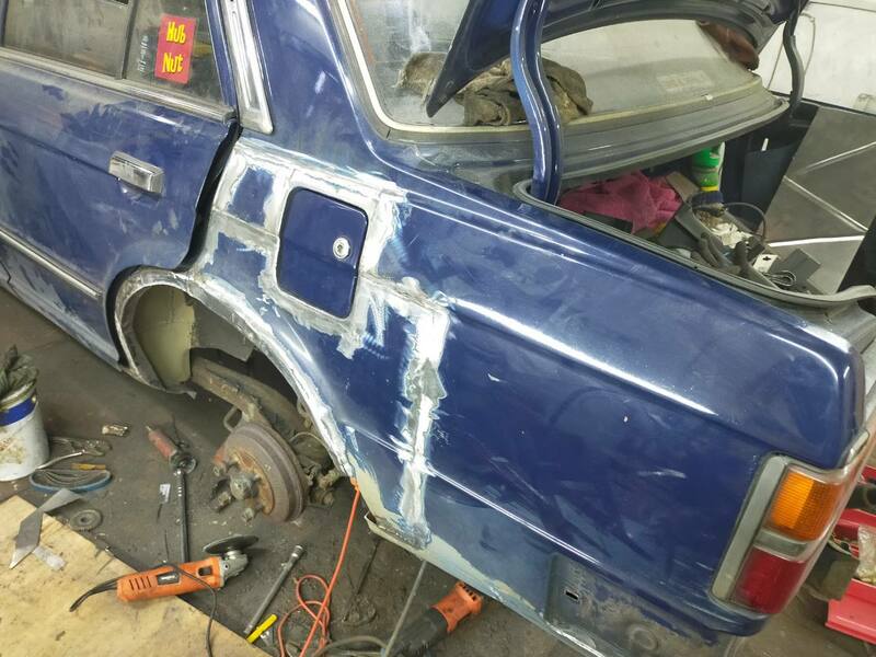

Drivers and passenger side floors were holed (passenger side had a .8 plate tacked in from the inside
Front inner wheel arches were a half inch of silicone over rust
Both front chassis legs were just patches over patches
Rear of the sills was gone from the jacking points right up into the boot floor
The inner sills were suspect and patched down the full length of the car
Both rear wheel arch tubs were rotten though into the boot
Centre crossmember was rotten at the outer edges
That was just from a cursory prodding, I imagine digging through the underseal would have led to much more grot. It'd have probably been easier to get it through an MOT due to the sheer volume of Tiger Seal and underseal that was holding it together just causing the MOT man's hammer to bounce off but it was properly rotten. Even bodging it wasn't worth the effort. It's now been flipped to somebody For £475 who thinks that the sill rust is the extent of it's issues...

Arch still needs some fine tuning but least it's steel 😂
Actual IRL metallic material.
If it doesn't have a name, it should be called Patches.  Descriptive for what you guys have had to do, and it's a good name for a dog :P
It really didn't look that bad at all in the photos, it's astonishing how little of it was really there.

That picture compared to one not long ago at all is very impressive as has all the graft you've put into these two.
From the times you'd taped bits up I knew it wouldn't be a pretty sight but didn't expect so much to be cornflakes. Top work for getting so stuck in so quickly!  My mate had one of these in about 2006 as a £50 daily beater, pale metallic green with a tan interior and the beginning of head gasket failure. It was quite nippy round town as I recall but too buzzy for any sustained 70mph trips.
It's the tape and poking filler through rust holes that's done this to the car.
There's a bit of fiberglass in the garage that's 2" thick with aluminium tape running through the middle of it  😂 They must have built it up in layers like a bloody cake
Bloody hell! like fuck me, seriously im in awe, at A just how fucked that was, and B for how quickly and well you have both managed un-fuck it

I think I worked out that the BOC cylinder is equivalent to 5 of those hobbyweld cylinder fills. The BOC bottle is a heavy fucker though and broke the back on welding trolley...
How it was supposed to be:
I'll probably move back to hobbyweld once I've done the Dolomite as I really don't intend to buy another car that requires a weldathon again. 😬
