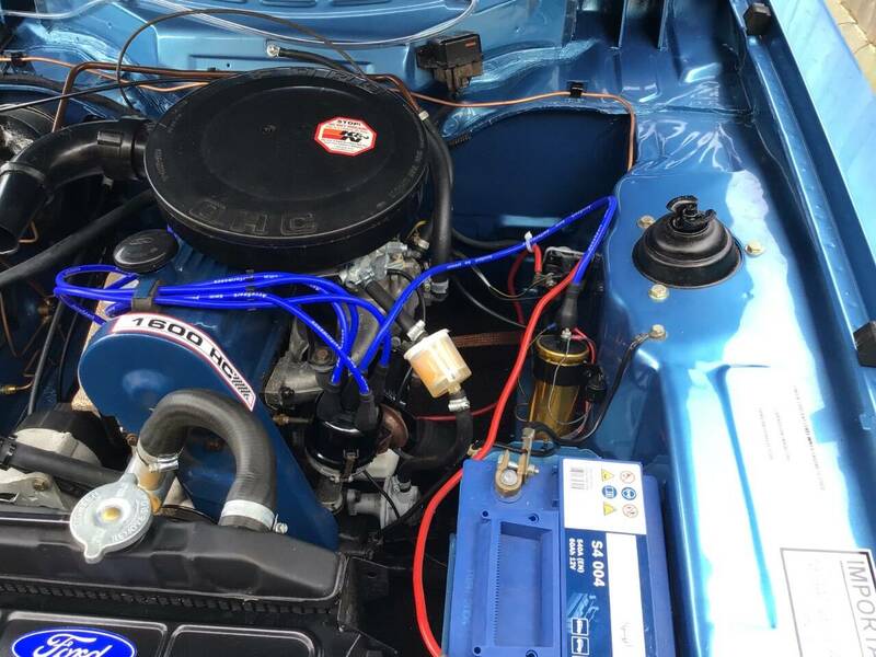

Did a bit on this today. Which isn’t easy at the moment as most of my tools etc are packed away!
All I’ve done is added a couple of extra earth leads.
The original one just bolts to a flat part of the lower engine block casting with a little spur off to the inner wing. It seems ok but it’s old now and it occurred to me that more can’t hurt and putting them in different places might make a better return path than trying to go through gaskets, bolt threads etc etc to get to the single factory one!
Firstly I’ve separated the original body inner wing connection, ground that down more to bare steel then cleaned the cable end and bolted it back tight.
The next extra earth is a big thick copper braid, which I’ve slipped on under one of the starter motor mount bolts then cleaned the paint off a patch of the inner wing next to the chassis leg where there was a convenient unused hole for a bolt already, then bolted them up tight.
The final extra is a short length of copper cable with insulation (actually intended for a Mini!) but it’s a nice thick piece of cable. I wanted this as close to the plugs as I could so it’s fitted between the lifting eye on the head and an unused hole one the bulkhead where some cars seem to have what looks like an earth attached anyway. Everything is cleaned to bare shiny metal and tightened down with a washer and spring washer.
You can just see them in the pic. I’ve also tied the comedy long king lead back for fear of it ending up in the fan blades if I don’t! I’ll make a tidier more permanent job of it later.
Fires up and runs well, and no signs of the hesitation and splutter either.
It could do with a bit more petrol in soon, but I think a longer road test might be called for. Which I might just about be able to get in before the road salt wankers start spreading that shit all over the place! Once that’s down I’ll be shut down for winter. As far as driving it goes anyway.

What a fabulous morning! Nice weather today and I’ve been a bit miserable lately so I decided to get the Crapi out for a quick run around.
First time I’ve really used it since doing the timing (I know I know, use it more you idiot!), but my god what a difference! It’s driving absolutely beautiful now! Silk smooth (for a Capri!) and absolutely no hesitation or bogging when pulling away or accelerating.
Only slight niggles are the tracking definitely needs doing, and the clutch cable is quite stiff, but it is brand new so I think with use it’ll free off. Other than its spot on. Everything works as it should.
Definitely picked my mood up anyway.
I didn’t go far, just a few laps of the estate at the end of road then a few runs up and down the main road a bit further and faster. Probably about 25 miles or so.
Certainly has given me my confidence in it back though! Before restoring it I’d gladly have relied on it and trusted it, but having been that heavily stripped and rebuilt your never really totally sure afterwards. Especially considering it was me that put it all together again!😆
Next time I’ll take it further. Try to find some nicer roads to stretch its legs on.
Anyway, amazing what a classic car does to brighten your mood!

Today I’ve (finally!) done something I meant to do ages back but have either not bothered or not found anywhere suitable…
The tracking is set!
I did it very very basically by eye on the drive a while back as it was clearly out and I just wanted it drivable enough that it was obviously not right. But today it got hooked up to one of those all singing all dancing jobbies at a local garage and set properly.
I actually managed to get it pretty damn good on one side, but considerably less so on the other. Decent effort by eye though.
So with that all done it went for a drive. It made a big difference!
You could feel it wondering on the road before and the steering wheel wasn’t centred when going straight (which is a pet peeve of mine) and it was definitely dragging a wheel slightly. It’s lovely now though. Much smoother and rolls along much freer.
With that done the intention is to start taking it further and more often.
It handled the heat of today’s weather perfectly too. Temperature gauge didn’t go over half the whole time. Which is reassuring.
