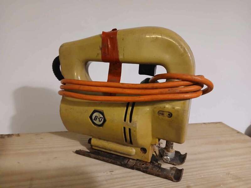

I was given free reign over the contents of the garden shed which had been largely untouched since Girlfriend_70's Grandad passed away suddenly and unexpectedly around 2008, the day after his wife was given the all clear after undergoing chemo for cancer. We suspect he knew he was ill but hadn't wanted to add to the stress during the whole situation and as he was the only one in the household who could drive for ferrying his wife to/from hospital. He was an electrician by trade, a keen tinkerer and he kept an immaculate garden. He'd come home from work at the local colliery and immediately get scrubbed up and change into a shirt and tie for wearing around the house. That sort of fella.
Unfortunately the shed roof was largely theoretical and held together by the remains of the felt. It was probably wetter in there than outside, and populated by the biggest spiders I've ever seen in the UK. I rescued a few plastic containers who's contents weren't completely destroyed, a Flymo strimmer and a couple of cantilever tool boxes full of... Stuff. Some of it rusted beyond use, some of it still decent but I need to sort through it... Also a couple of powertools that will probably kill me when I try to power them up, including this 1970s Black & Decker jigsaw...

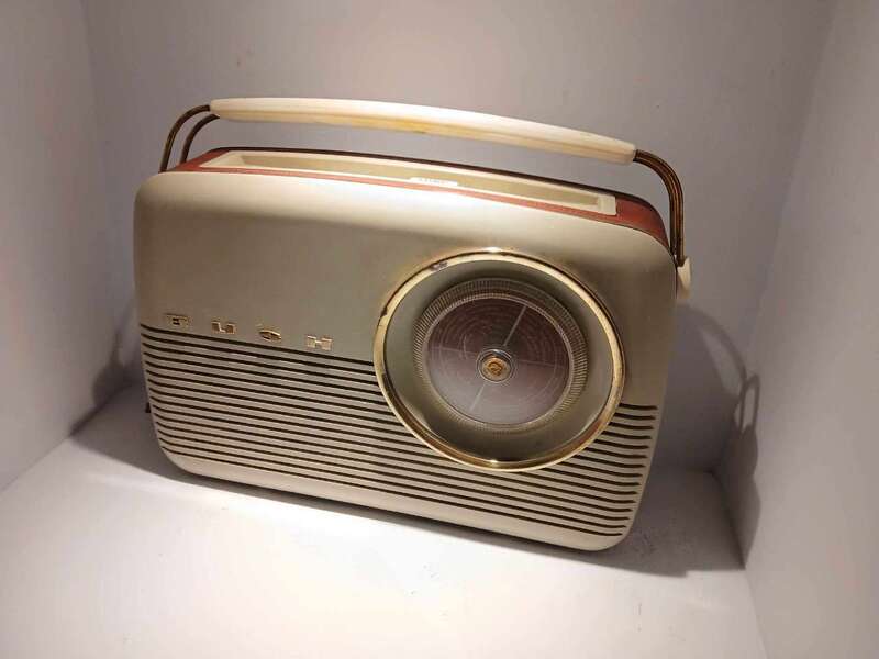

This Bush MB60 was in the attic, still works. Is an early one from '57/58.

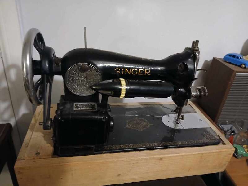

This Singer sewing machine was in the bottom of a cupboard - No idea what sort of era. Has an electric motor and foot pedal. Apparently it used to be on a trestle table back in the day but was reduced in size with a custom build box for practicality.

Teh internetz think the sewing machine is a Singer 15 but the serial number will confirm or deny.
Found the serial no. , you are correct!
It's a 1903 Singer 15K. The "K" signifying it was made in Kilbowie, the factory in Cyldebank just West of Glasgow.

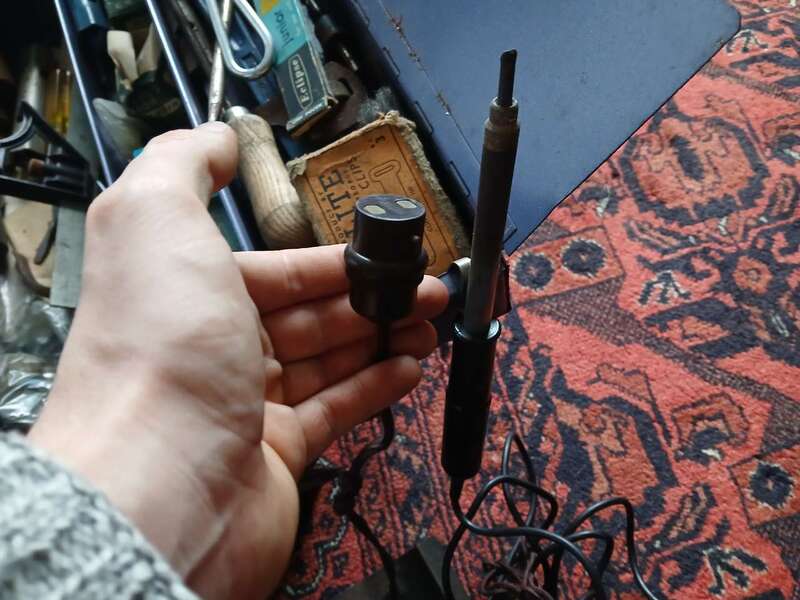

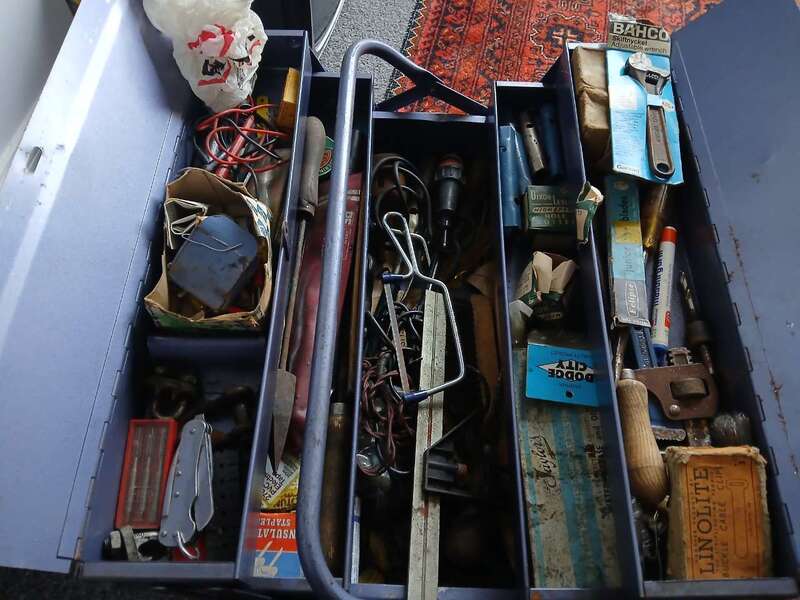

A frozen in time toolbox largely devoted to household wiring judging by the contents.

The Bush MB60 is a very nice save. I have owned just about every variant of the TR82, but never an MB60, they are quite rare.

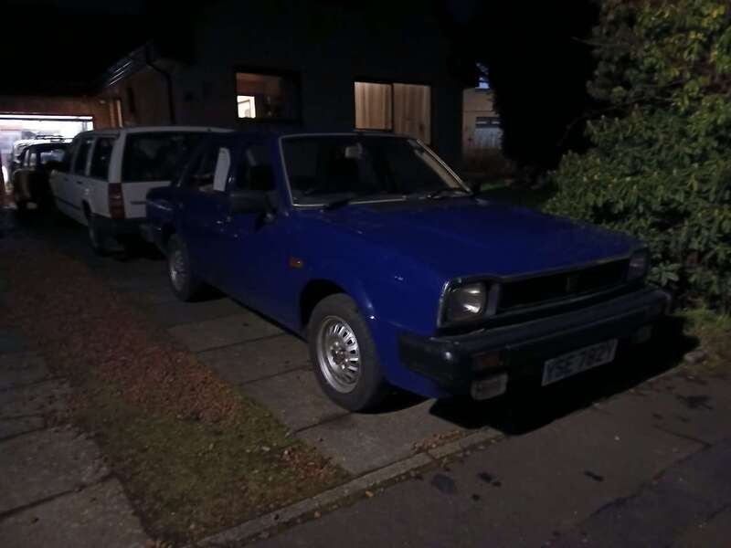

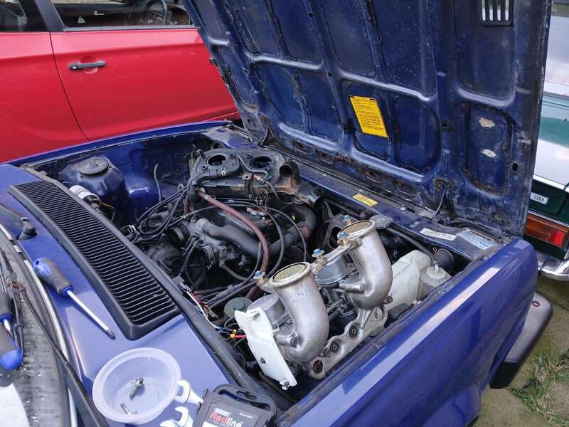

Volvo 740:
Died from lack of electricity last night. First the radio started playing up, then the dash lights got very dim and the rev counter went nuts, finally it started coughing as the fuel pumps started dying. An ideal moment of having to pull off a main road with no indicators and a coughing engine as the last vestiges of power drained away with a car right up my arse blaring the horn.
475811182_509715238391232_26065699081685106_n.thumb.jpg.3fc411b9f7d22001a4b119f9740f9f54.jpg
Had no tools as the car had been emptied of it's usual contents for house clearing duties. Called @juular and @MrsJuular for assistance and they supplied some batteries and a multimeter which confirmed car wasn't charging. Seemingly the charge warning light is also dead. Limped to @320touring and @jaypee's unit and borrowed their battery charger for a while.
Convoyed the 13 miles home using the POWER of 21w sidelights with @juular in front and @blackboilersuit tailing me in case of sudden electrical death. Just managed to make it without having to swap in another battery, the one in the car showing 11.8v.
The alternator is still spinning and connected by the two wires it has, so I assume it has just done a died. Shall do some prodding after work.

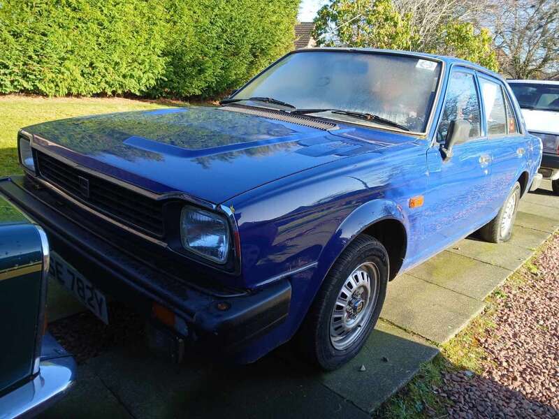

The Acclaim is also dead, as it has no carbs. This is likely to be the first car that gets fixed as I reckon I can have it back together this afternoon.
471959983_634563049103247_5418991088787445689_n.thumb.jpg.6c9018b594bedc43a7036c53e3c83c69.jpg

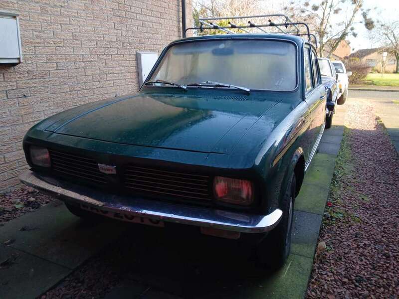

The Dolly drives up and down the driveway but the recored radiator is not fitted - Mainly to allow better access to the timing chain. Shall try and have a nose at this today as well...
475739386_991137526266799_389903182222359279_n.thumb.jpg.df92190e7dfbe2ba4316173e91a0cc42.jpg
These are identical symptoms to what my 940 did a while back - it was the alternator on mine. Gave up trying to source the correct repair parts and  went with the Polish company AS-PL's new offering - that worked OK* and I think the battery survived.
*I initially sourced a 'recon' alternator from a UK company and that was DOA.
Just FYI that the charge warning light is an important part of the charging circuit. If it doesn't work then the alternator field windings won't be excited and so won't properly start charging.
Would be worth checking that the bulb hasn't blown or the wires to it have failed.
I may be mis-rembering this but aren't the alternators on 740's fitted using rubber mountings and a separate little earth cable (engine block to back of alt body) that used to break and stop the charging and warning lamp function?
Seconded in the charge light bulb,I've read that many times as well,though I'm sure a pain to get at compared to the dolly it would be worth fitting a new or different bulb to see if it starts charging again.

On 07/02/2025 at 20:48, captain_70s said:
Man the sun still sets fast at this time of  year...
Anyways, first things first. I checked the bulb for the 740's battery warning light.
It's fine, illuminates with the ignition on but goes out when the car starts, connections to the alternator are fine, it isn't noisy. Assuming voltage regulator/bushing failure.
I set it aside as I'd like a functional car for the weekend, have no parts for the Volvo and have limited daylight...
Threw carbs at the Acclaim.
It runs, after a fashion. It'll still only idle on choke, although it isn't dying as soon as it drops under 1,500rpm like it was before.
You can drop it right down to 800rpm but it chuffs away like it's runing too rich.
Something definitely isn't quite right, I'll play about with the choke/throttle stops in daylight. Once you're driving it's fine, as seems to always be the case with the Acclaim...
These should have pilot jets yank so em out and blow through em with compressed air or replace em.
I had some bother with the pilot jets blocking until I put a better fuel filter in it the Herald so if you have a see through plastic filter before these remove it and fit a canned fuel filter under the car at the tank, makes a huge diff.
Pilots are for tick over up to 30% throttle on Keihin carbs so it might be your issue.
