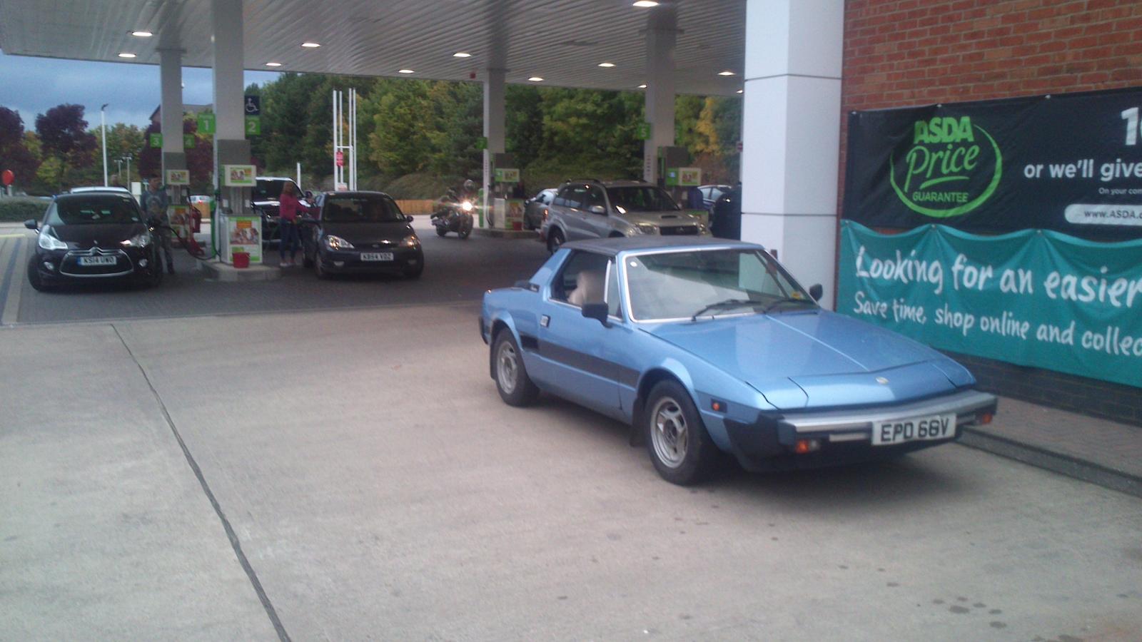

After talking shite for half an hour, and the insistence I took a gallon of fuel,a bottle of water for me and one for the car, a packet of cookies and directions to the M6 I departed, with a rather rough running,rough looking X1/9. Headed towards Coventry in search of fuel I hit the rush hour traffic... which is ever so slightly worse that we get up here. The X started getting tetchy, threataning to stall every time I let off the throttle and generally jumping around. After a cut out on a very busy roundabout and a restart which almost made me religious, I thought better of dicing with the traffic and pulled in at a fuel station, where it died about 20 yards from the pumps, and this time would not restart. I rolled it back and got out the tools.
Timing set with a little extra advance, points cleaned and regapped and the carb jets cleaned and blown through It started and idled beautifully., so I filled up at the pumps=40 quid of Asda's finest and took a fuel station shot.
