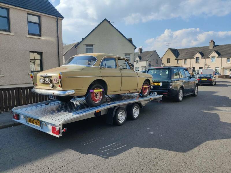

So, the Amazon has been waiting patiently at Mrs Juular's mum's house while I finished off the 240 and got it shifted out into the front driveway, which is reserved for cars that behave themselves.
@dome bought a Porsche locally that required a trailer to collect. This helpfully coincided with me being able to make space in my garden for a project. He very generously agreed to tag on another transport mission, which meant that I wouldn't have to arrange my own trailer hire, extra numberplates, and the small obstacle of learning how to actually tow a trailer. What an absolute legend. The stars were aligned!
The Porsche was successfully offloaded at @dome HQ with the help of @Tickman and @Supernaut
It reminds me how much I want a 924 at some point.  There's something so right about the shape of these, the popup headlights, the wheels and the epic glass boot.  Here's the courtesy link to the thread:
After a quick pie-based lunch, we headed to Bonnybridge. With the help of @Supernaut we got the Amazon loaded up, with generous amounts of duct tape to stop the bonnet flying off on the motorway.
And dropped off.
