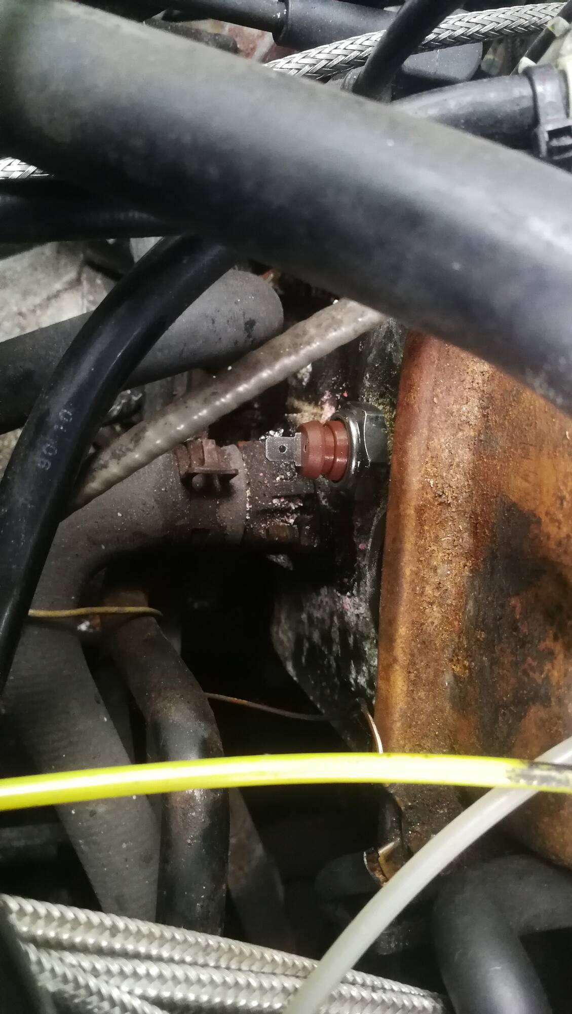

First thing up was to try and sort the oil pressure buzzer which went off above 2.5k rpm.
Previously we had applied voltage to it from the battery and it solved it. This suggested the sensor was FUBAR.
The high pressure sensor is located on the top of the oil cooler at the front of the engine.
As can be seen it is :
a) handily* placed between the dizzy and the warm up regulator.
b) not in its first flush of youth.
it's a 24mm, but the spade connection sticks up so you can't get a ratchet into the socket. The solution was to bend the spade connection over. The socket then slides on and the ratchet can be applied.
Twas not looking good.
The new one went in no problem. Screwed it in by hand, and then nipped it up with a shifting spanner. I didn't have a 24mm spanner, and access is tight because of the radiator.

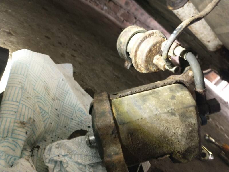

A scant* month and a bit later, some actual effort was made to find out what fuel pump was fitted.
First things first, the golf was pushed til the passengers side was close to the garage wallIMG-20210327-WA0006.thumb.jpg.70177d5516f1351ad540009bd6bb13aa.jpg
My arse looks good in those troos 🤣

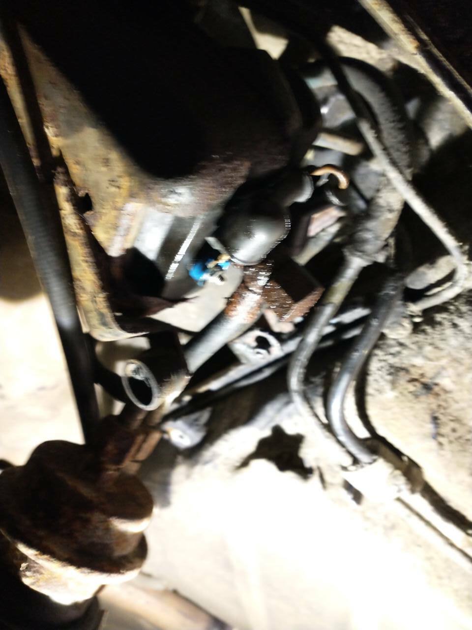

Then it was time to hunt the quarry..
Tucked up next to the fuel tank and the rear axle.. all the connections looked original.
Young @Skizzer Audi fuel pump swap video for his Audi was most useful in informing the approach taken..
The cage holding the pump has a couple of rubber bobbins that isolate it from the car body to reduce vibrations. One was completely sheared. The other is intact. The cage came away cleanly.
The connections were another thing entirely.
The inlet from the tank is only held on with a jubilee clip, but the fuel line was so old and hardened, it needed water pump pliers to twist it off.
The front connection is a 19mm nut that holds a banjo fitting on to take the high pressure
Some jiggery pokery and persuasion later,  and we had the pump hanging down so we could get at the high pressure connection easier.
Now it's removed, I can get the new pump and bobbins ordered.

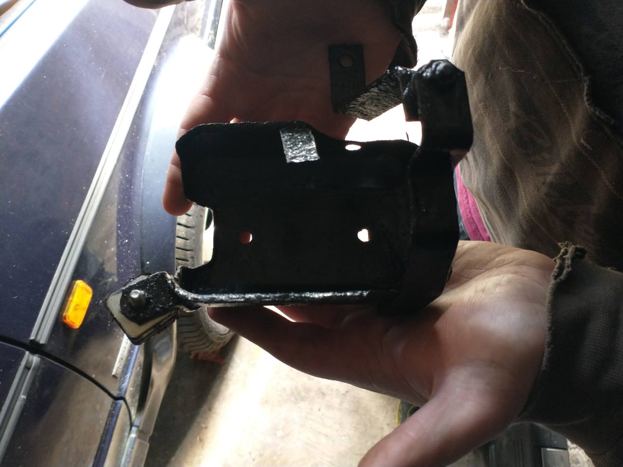

We fitted the new fuel pump.
Here we see the new fuel pump wrapped up in the foam insulated, laughing mightily at the old Bosch pump..
IMG_20210411_120038874.thumb.jpg.02d8bf3ad54e0b4f3bf22690f50b8fc2.jpgIMG_20210411_120043184.thumb.jpg.47e2380c13ef8c025f51f2bdcba150c9.jpg
hark at the refurbished* (vactan and a quick skoosh of paint) cradle, including new bobbin mounts.
This was all cobbled together and re-fitted.

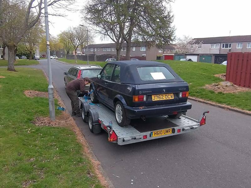

SVM assist was booked for this morning.
At the allotted hour, @davidfowler2000 rolled up with the chrailer. Many thanks to him for giving up the day off, and providing the towcar/pilot duties.
I'll allow him to provid the economy update!/
@Supernaut helped with the loading. Cheers to him for the assistance
Despite getting the car running on Saturday the fuel pump appears to have decided to die.. thankfully it's light enough to shove.
Strapped down and off we go

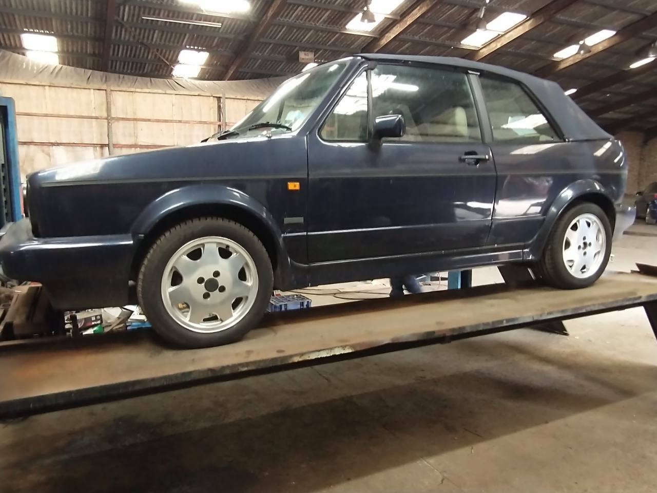

Once down at the secret @Mk2 Craig golfporium, it was up on the ramp to get a list of worked figured out.
IMG_20220425_115232779.thumb.jpg.7ed5fd25b5bdd894e852ef2b19ab5f8c.jpgIMG_20220425_120937854.thumb.jpg.04f0184faea38d2ac66c9aaad5739a81.jpg
happily, it looks a pretty solid little car!
IMG_20220425_115927115.thumb.jpg.74a42bc5e520774df7f925b1229e74b6.jpgIMG_20220425_115934485.thumb.jpg.34b333db0f2d0630625c50ce00284ae8.jpgIMG_20220425_120007528.thumb.jpg.b9ae9829998ca4fb8897adb13b171db6.jpgIMG_20220425_120013105.thumb.jpg.1b4334e5c57403e57fee926bfe0199bb.jpg
as you can see, a backbox is on the list!
now it is just a waiting game for the work to be identified and done.

Time for an update on this.
@Mk2 Craig has had an absolute war with this old thing.  Initially the plan was to get it running correctly and in for an MOT. Estimate was a week.
This was back in April.
We collected it on Tuesday 2nd Aug.
I'd just like to thank Craig for his determination and patience in getting this into much better shape. An absolute gent.
What did he do?
Protect new fuel tank with underbody stone chip
Paint filler neck
Replace rubber fuel lines
Fit new fuel tank
10 litres of fuel
Replace rear wheel cylinders
Install brake flexi hoses
Clean up brake drums and shoes and adjust handbrake
Rebuild metering head
Rebuild warm up reg and unblock gauze filters and get working correctly
Install new fuel filter
Installed new starter, as original starter was  intermittent.
Strip and unseize wiper motor.
Tidy up fuse box (replaced connectors on earth terminals)
Re-wired front left indicators due to corroded wiring
Immobiliser failed causing fuel pump and starter to be inoperative, removed immobiliser
Installed an indicator stalk due to left hand indicator not functioning as it should
Installed a horn relay and wiper relay
Fitted second hand back box
There were plenty of delays  - waiting on warm up reg and metering head rebuild kits, waiting on an ultrasonic cleaner for cleaning parts, then the MOT tester had covid.
Throughout all this, Craig kept me up to date with progress and costs.

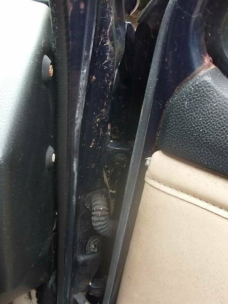

Today was mainly spent cleaning the mould etc off the interior.. the joys of convertible ownership in Scotland 😭
IMG_20220808_190003872.thumb.jpg.78f4512a30fefacdec82b270998a32cd.jpgIMG_20220808_180006743.thumb.jpg.03c4af120e84930da1d33c3b06004e76.jpg
thankfully it comes off ok with antibacterial wipes.
The door shuts were done too

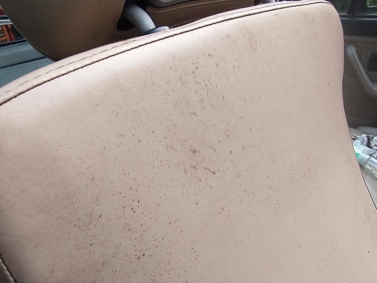

The interior was next up.

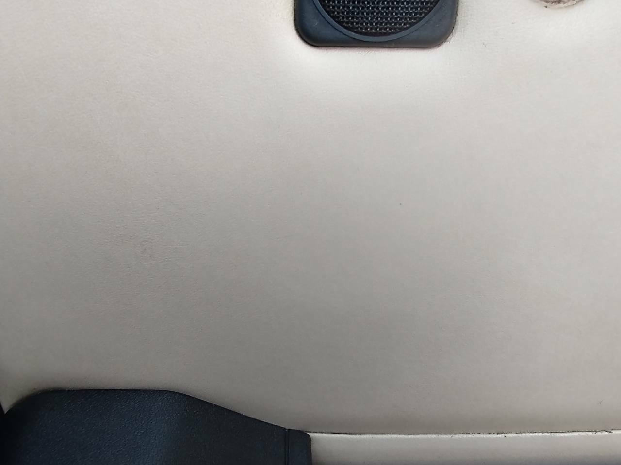

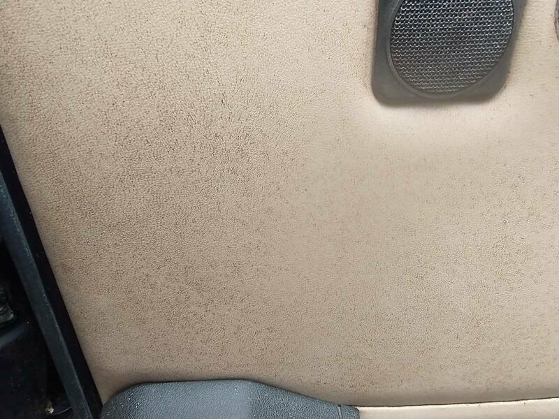

 13 years of sitting had not been kind, and the light tan trim was pretty dirty.
The door cards and seats had markings and mould on them.
Thankfully this came off with a brush and some cleaner.

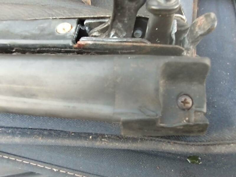

A seal was tidies up on the hood and screwed into place. Thanks to @dome for his help.
