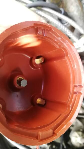

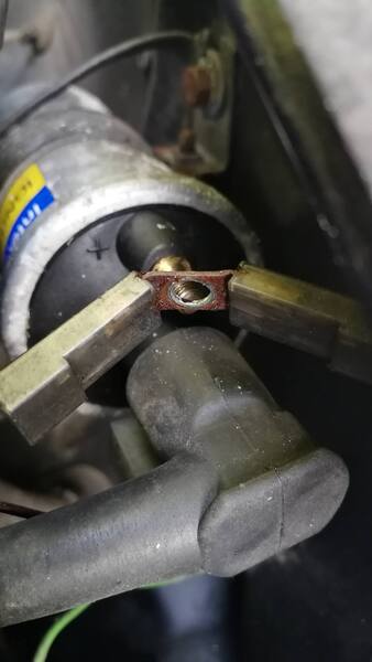

First up, new rotor arm and cap were fitted - definitely better than what was on the car..

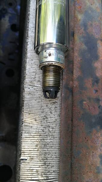

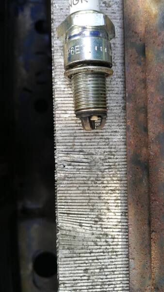

I also took the opportunity to pull and clean the plugs.
Two looked good
Two looked wet and rich

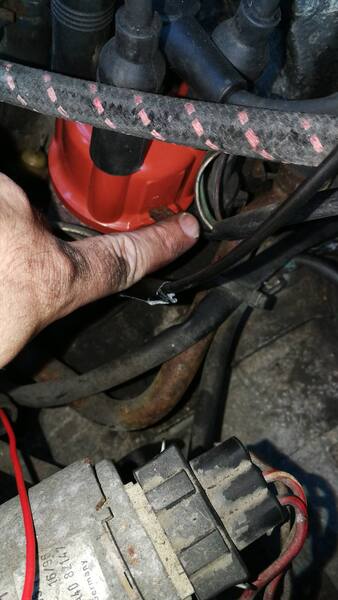

First up was to check on the coil - I cleaned up the contacts

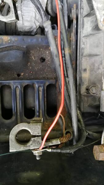

Then moved onto the main earth lead
IMG_20190820_180524.thumb.jpg.c10c690aa6ee5b196c59a006b410f6a7.jpgIMG_20190820_180529.thumb.jpg.37d293f961068ff533bd1bd946b0e6e9.jpg
It had a new earth lead fitted when the starter and timing belt were done. Cleaning up the contact points helped re the starting, but didn't fix the missfire.

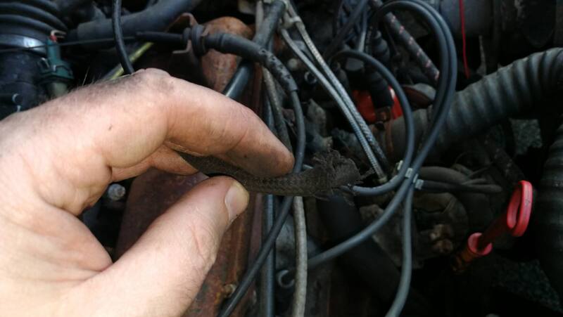

Next up was the vacuum advance pipe on the dizzy
This will need replacement - but I managed to get it to seal better.

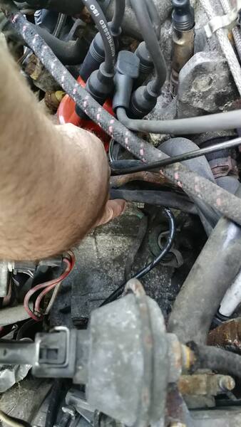

Last thing to try on the ignition side was to disconnect the ignition amplifier that feeds into the dizzy.
This turned out to stop the car from starting at all - so it was obviously sending a signal, and the dizzy was responding correctly.

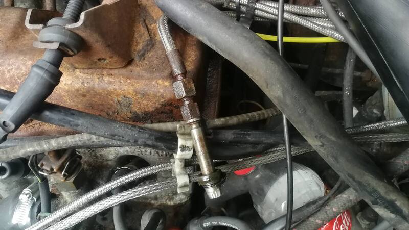

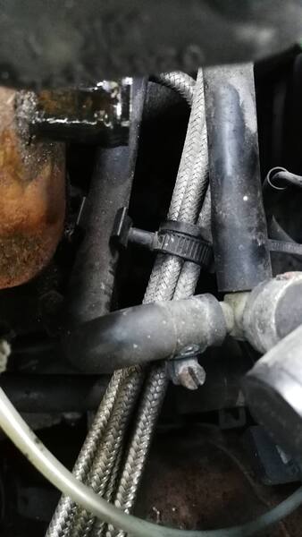

First up - time to check the injector that was suspected of not firing.  Tracing the line from the metering head, it was #4 that was potentially at fault.
The initial task was to take reference pictures before removing loads of vacuum pipes to allow access.
IMG_20190824_170739.thumb.jpg.9e075b40a21031d42351b74972dc614a.jpgIMG_20190824_170749.thumb.jpg.d267546e66c31539854dd4f1469cb4e8.jpg
then we removed the 2 pipes from the inlet boot, the pipe from the bottom of the air box and the throttle cable.
This didn't yield enough room, so the inlet pipe had to be detached and removed completely.
This done, you could see the quarry.

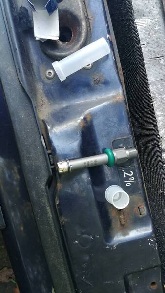

The injectors are just an interference fit - with the seals ensuring they are located properly.
We loosened the line for #4 At the metering head so we had slack in the line, later removing the line completely from the metering head to allow us to angle and pull the injector out.
With some levering via a screwdriver, and some patience, we were rewarded with the view below.

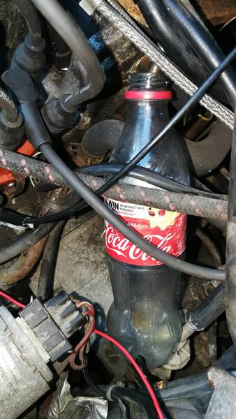

Time to rig up a test setup and see what happens (after we rebuilt the inlet and the vac system!)
The bottle remained empty regardless of the amount of cranking.
So it looks like that injector is duff.

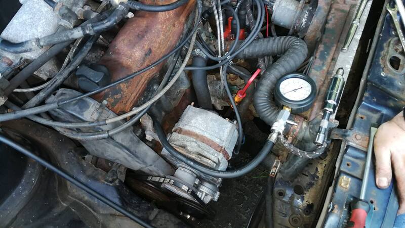

Crack out the compression tester!
All cylinders recorded between 150-160 psi dry, so we know the headgasket is good.

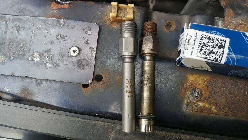

Today was the day to tackle the injector on this:
Locate injector and apply remonstrating fluid
Place 12/14mm spanners on appropriate unions and unscrew
Marvel at the fact its the WRONG FUCKING INJECTOR
The top thread is too large for the line connection, so I have had to message the vendor and ask to return the injector for a refund or swap.

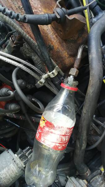

The new injector was prepared and fitted, then placed in a flowchamber(TM) to observe if any flow
After significant cranking, farkall came through ( stuff in the base of the bottle was already there).

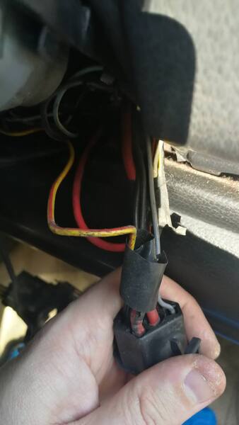

The ignition switch was also proving temperamental - removing and refitting the connector at the back helped, and also helped me find where the immobilizer is wired* in.

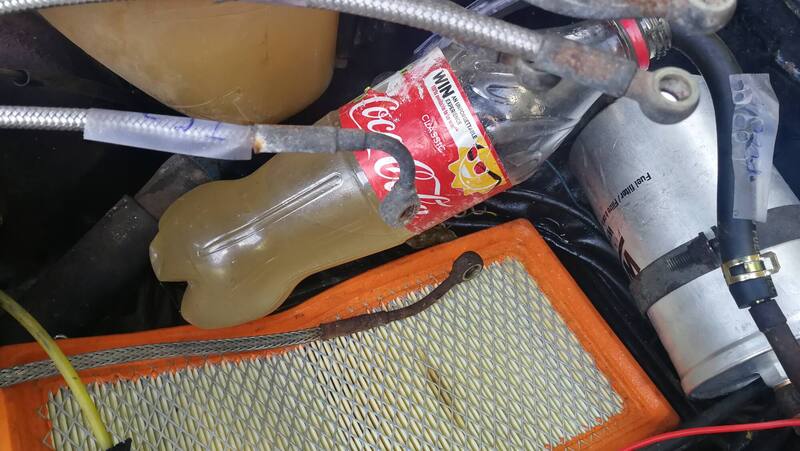

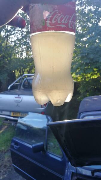

In the meantime, I tested to see if the fuel flow from tank to the metering head was ok..
This was about 3 seconds cranking - suggesting the main and lift pumps are acting ok.
The fuel, on the other hand...
Bearing in mind it has done approx 380 miles, and had at least 3 lots of fresh fuel (partial tanks) during those miles.
