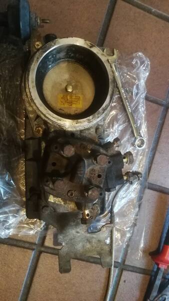

Any ideas where to start with cleaning it out?
I can see two screws that come out to release the metering head from the base unit, so that should let me get to the fuelling pin.
Removing the fuelling pin would be next, then I wonder if I can flush out the metering head?

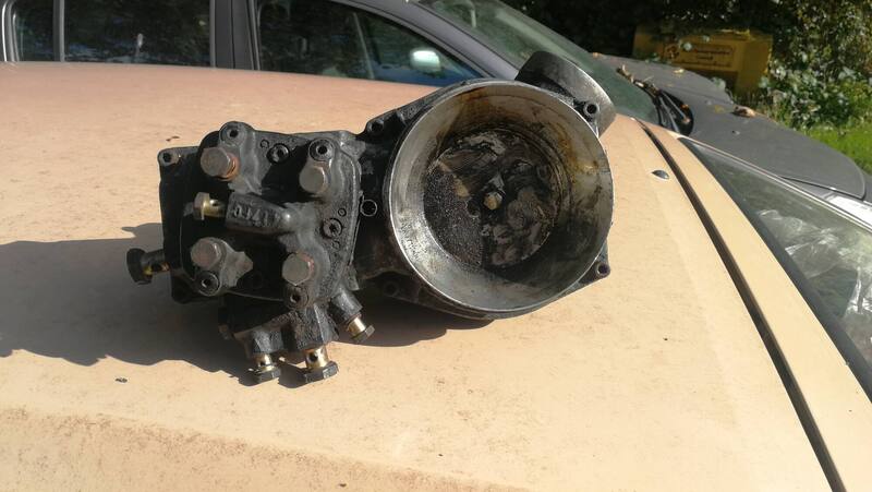

Drew another 10L of shanner fuel out this today, and noticed that the fuel pumps seemed sporadic. I wonder if the fuel pump relay is shot? A new one is £15 or so, so significantly less than a replacement metering head.

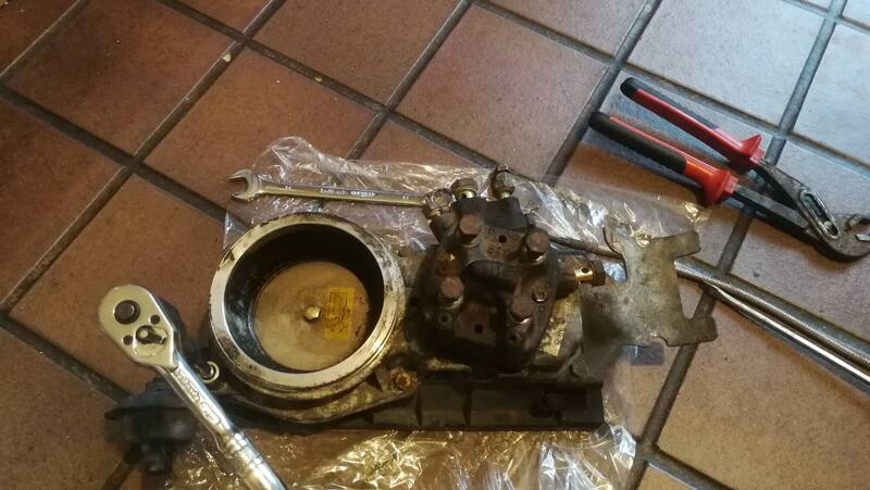

Did some initial investigation/teardown on the metering head.
I separated the fuel unit from the airbox (6x10mm bolts) as below
This revealed 2 things :
1. I can't feel any resistance from the metering pin when moving the arm
2. I have no idea how to get the unit off the metal base. I can only see 2 screws, but they seem to hold the unit together. Do I need to undo them to reach the pin?
A video of the pin /arm in action
Any help or thoughts would be much appreciated.

Is that the cast iron distribution block on the metering unit? If so, I had one on V8 Merc years ago that had some very odd/mysterious fuelling faults - mainly that it over-fuelled like mad and then failed it's MOT on emissions! The pin inside was well and truly stuck and I had to get a later unit which was an alloy block, then the car ran perfectly. So, I would tentatively say that it is fucked :) but don't take my word for it as I am a well known cock head.

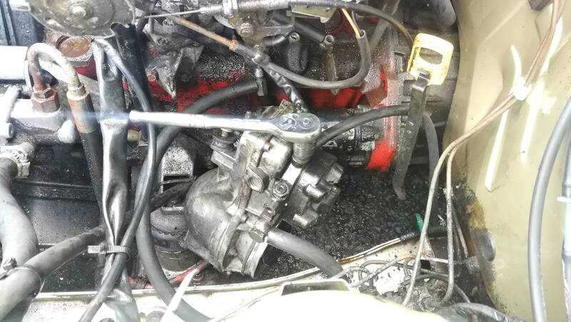

This is the Volvo unit. Despite different part numbers, it has all the ports in the right place and takes the bolts from the golf one no bother.
I got the bolts all swapped over and fitted the unit to the car
You can see how the Volvo bolts look considerably less crusty than the golf ones

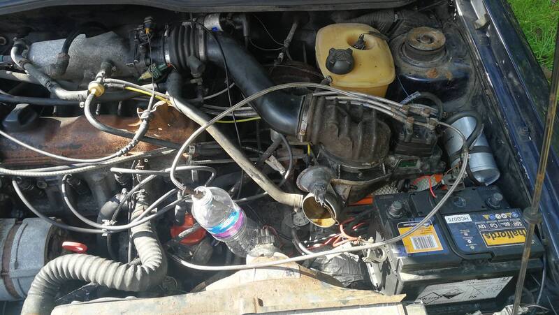

With it all fitted and tightened up (including injector 4 in a test bottle) ...
We got...
Nothing.
There was no fuel in the test bottle, and I could only hear the pumps running intermittently.
Time to turn my attention to the fuel pump relay. Logic being that the metering head needs to be able to provide 75psi to the injectors to get them to open.
The lack of any fuel in the test bottle suggests we are not getting sufficient fuel pressure at the metering head.
This could be either due to the fuel relay being intermittent, or the main pump not providing pressure.

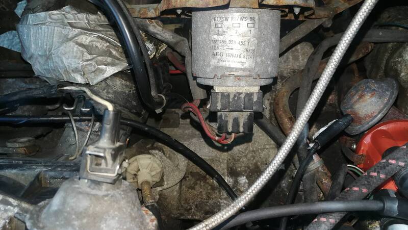

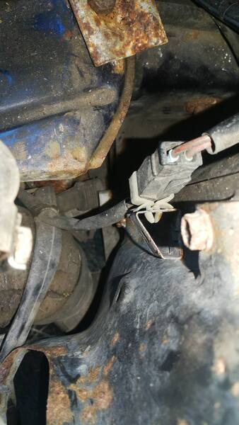

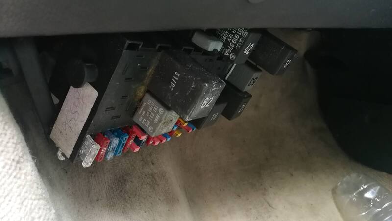

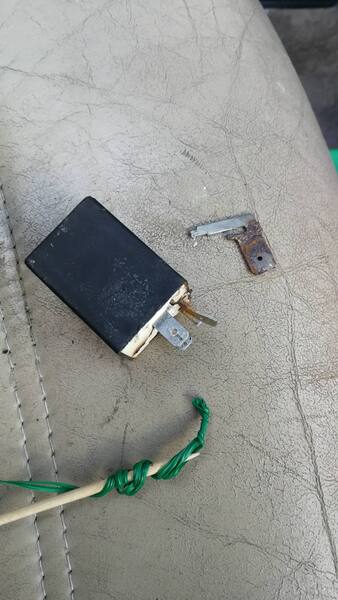

Tucked up in the passenger footwell, the relay is easy* to reach.

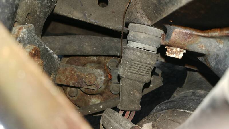

Initial inspection showed signs of rusting - never good
After some gentle persuasion with a screwdriver, the relay was out
Time to order a new one then.
As a final hurrah, it also decided that it'd like to make some horrible noises when the starter tried to engage..
I think the battery may just be getting tired.

I think thats a ce2 fuse board, they're not too bad, nothing fancy inside them just brass plates that funnel the electrons. If the relay pins are rusty then it suggests there been water in the fuse box - I would definitely investigate this further as it'll give you grief down the line. If i remember right, the CE1 type has round pins on the connectors on the back. CE2 has flat blades pins. All connectors just unplug and should* only fit back in the right place, so you can remove the fuse box from the car. I'd definitely take a handful of pictures before unplugging everything though,
I think that is a fancy relay with electronics inside it to cut the fuel pump off at a certain RPM, as a type of rev limiter. This will make it MUCH more susceptible to any dampness.
A #63 relay is a none-rev-limiter type. Less to go wrong. You can just bridge the two fat terminals out with a bit of wire or a switch for now.
The metering head off the volvo might fit, but it will be calibrated incorrectly for the engine. Perhaps useful to practice stripping one down and for parts.

Sounds like I can pull the fusebox off and give it a right good clean then.
Can then get a new fuel relay and see how we go

The fusebox is a much more likely candidate than the metering head or immobiliser, in my view. And much easier/cheaper to replace and therefore eliminate from enquiries, at least.
Aye, the fusebox/dead fuel pump relay are chief suspects.
Once I get to it, they'll be first priority:)

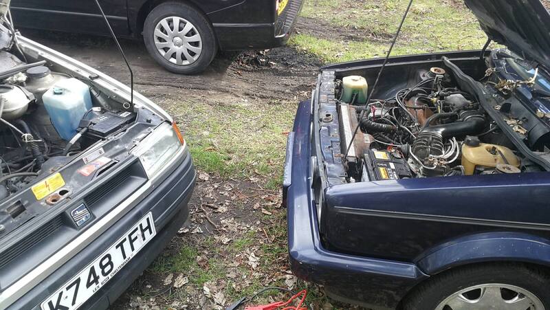

Then, with a little assistance from another VAG member of the fleet, up she fired.
After a bit of time to steady the idle, she trundled round onto the hardstanding, so I can start working on it.

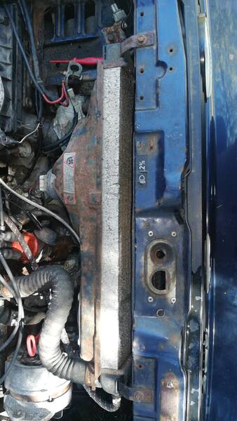

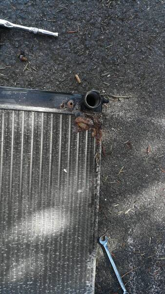

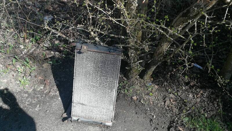

I had a look at the radiator in the car today, and it doesn't look a complex job to remove.
It looks like the new radiator is correct too.IMG_20200402_190222.thumb.jpg.d0ea892b3afe2a49a6e88e18bcb9b710.jpg
I have a day off from work tomorrow so hoping to fit the rad...
Today it was time for an epic battle - Man Vs Radiator!

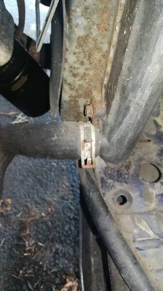

First up was identifying the foes:
The temp sender
The fan connector
The top hose clamp
The bottom hose clamp
And the two top mounts

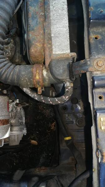

I worked my way methodically round these simple challenges whilst the coolant drained, and the rad was ready to come out.

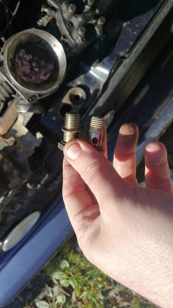

Except it wasn't.. these sneaky fuckers were holding it in..
After they were removed, it was a great success!
Time to strip the fan shroud off so I can clean and paint it:
Found some evidence that the rad has been sleeping for a while..

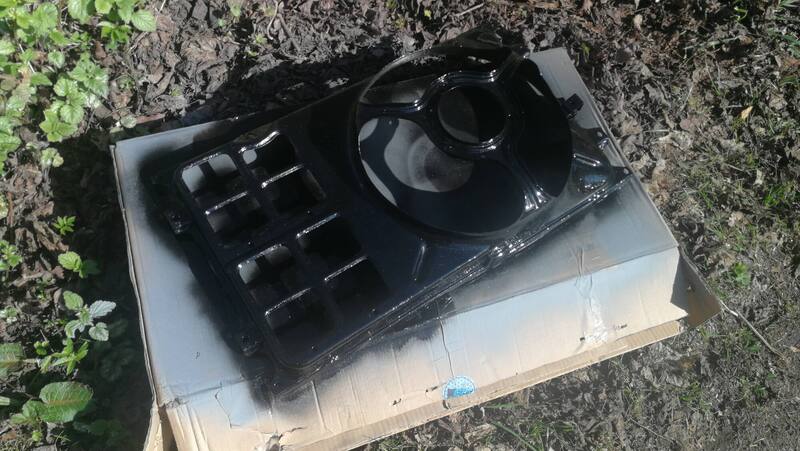

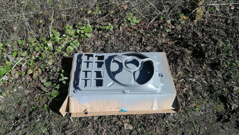

The fan shroud was wire brushed and some primer applied
Then, once dry it was time for a couple of coats of black

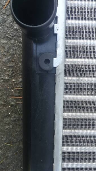

Whilst that dried, I tapped out the shroud mounts on the new rad.
This was easily done using a mounting bolt - the plastic was fairly soft.
