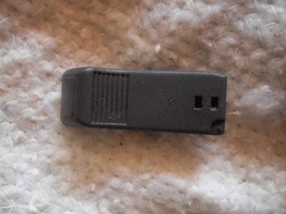

My 405 has a slightly iffy drivers door lock (because Peugeot).  When you unlock you often need to turn it a bit then turn it again before the central locking catches.  A couple of times it has really failed to work and I've had to climb in through the passenger door.
Today I tried to fix it and dismantled the doorcard, access was still crap so I applied a small cable tie to a pivot that appeared loose (to no effect) and sprayed lots of chain lube type spray which appeared to help a bit in that it now doesn't feel like the key might snap.  Unfortunately the door pin came off the threaded wire wotsit, it goes back on but just pulls off if pulled up to try and unlock the door.  Does anyone know a way to fix it back on?  I could do with an extra one too as the passenger side pin was missing when I bought the car.  An actual fix for the locking would also be handy.
I have tried and failed many times with those hateful things. Once they have been apart they never work again in my hamfisted experience!
Yep. 405 lock buttons are disposable as far as I am aware.
Probably obsolete from Peugeot.
Helpful.

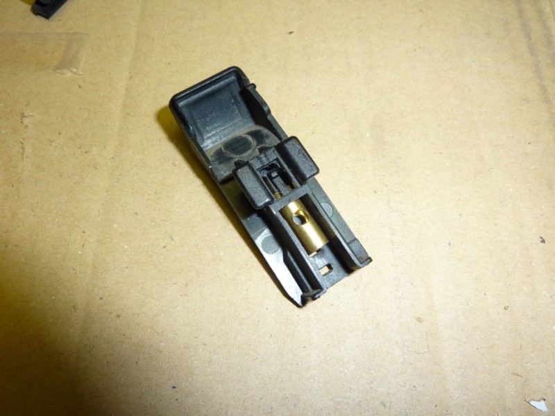

Aye Rich, there are two methods.
1 - The official method.
The lock lifter button is coloured to the interior of the car:
This is in turn attached to a clip:
Which breaks. If it is still available from Pug/Cit then it's part number 9159.54. Used on 405 ph1 & 2, 806 and Citroen Evasion.

2. Autoshite method.
Gut a chocolate block connector.
http://www.forum-405.com/t26166-tuto-reparer-les-boutons-de-verrouillage-des-portes

Aye Rich, there are two methods.1 - The official method.The lock lifter button is coloured to the interior of the car:attachicon.giffgc504s-960.jpgThis is in turn attached to a clip:attachicon.gifRemKompKrokobil.jpgWhich breaks. If it is still available from Pug/Cit then it's part number 9159.54. Used on 405 ph1 & 2, 806 and Citroen Evasion.http://forum-auto.caradisiac.com/pole-technique/mecanique-electronique/sujet431608.htm2. Autoshite method.Gut a chocolate block connector.attachicon.gifp1020213.jpghttp://www.forum-405.com/t26166-tuto-reparer-les-boutons-de-verrouillage-des-portes(Having typed that all out, I've a feeling I've answered this question before???)Edit to add:Looked up Pug Servicebox and they are showing at a mere 50 eurocent each including Irish VAT (23%) from the dealer. Couldn't log into the Pug Servicebox account with Autoshite credentials as it came up with "Your country is not configured, please contact your administrator. ([email protected])" bollocks. Logged into Citroen Servicebox with Autoshite credentials and it was quoting a whopping 89p each inc UK VAT. That's twice the bloody price! They really are farting in your general direction. Also all the buttons and surrounds are showing NFP, so down the scrappy for them.If you want me to get you some, I can post them with the other stuff.
Fantastic, I'll try that. I'm embarrassed that I've never thought of that!
