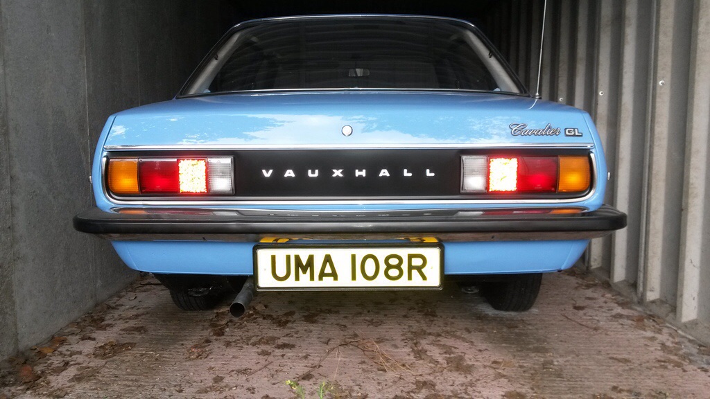

The other day, mention was made of cars having the section of rear panel between the back lights painted matt black to make them look sporty (not sure which thread). The only car I can think of is the Dolly Sprint, I know lots of different cars had this feature, but what were they?
My bro learnt to drive (in 1987) in a 1978 Golf 1100 GL. Unlike the povvo-spec cars, it had a useless piece of plastic behind the number plate, between the rear lights.
e.g. like this 1979 GLS:
So whilst not painted or sporty, it was a trim feature that distinguished it as somehow more upmarket.
