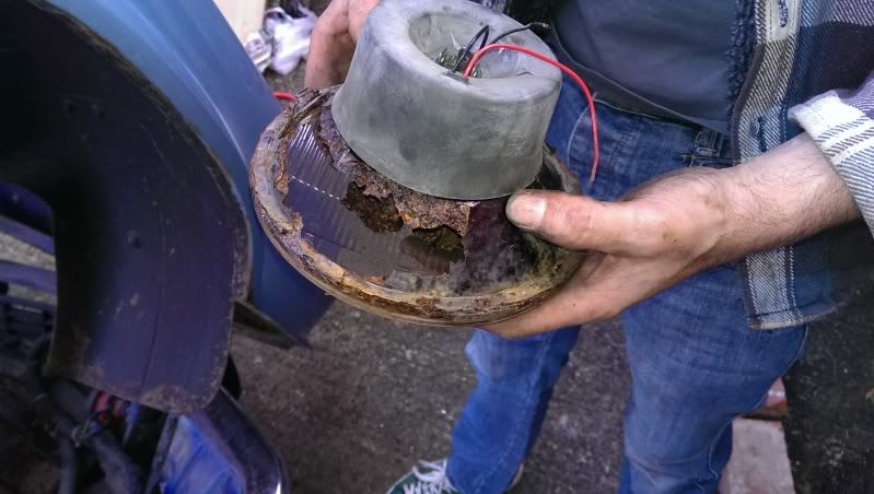

HillmanImp Posted September 27, 2013 Posted September 27, 2013 Ta for the tips on the seats. I am probably going to try to mend the seat bracket as best I can anyhow but if it doesn't work I will have to take it without the seat. However there are a few other things I need to sort first. I suspect that this is an MOT fail......
