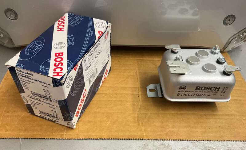

LightBulbFun Posted October 30, 2024 Author Posted October 30, 2024 speaking of electrical gubbins, the electric regulator arrived, and thankfully is what it showed in the listing pictures https://www.ebay.co.uk/itm/295927581581 which I was a bit aprehensive about since the part number actually written in the listing is different to the one we need/is shown in the pictures, but thankfully I need not have worried the correct part for me showed up although it did confirm my initial suspicions that the battery B+ spade connectors are chunky 9.5mm things, and the rest of the spade connectors are normal 6.3mm affairs I was not sure on this front since I thought the B+ one looked chunky but I was not sure without reference if it was overly large, or if all the other ones where overly small (say 4.8mm connectors) ill have to get some 9.5mm spade connectors then and locate where the B+ wire is on the old regulator according to the wiring diagrams B+ should be a brown wire, but the only brown wire in this shot seems to be a short loop of some kind, so thats something to look into (the red with the fuse is D+ the brown and yellow above it is the charging light, and yellow bottom right is DF, so I suspect the read terminal top *right* might be the B+ im looking for, but ill have to investigate) that reminds me slightly embarrassing question, but for cleaning up mating surfaces, for example the regulator grounds through its bolted connection to the chassis, and i'd like to ensure a good connection, whats grit sandpaper should I use to clean it up? (when I got REV back in 2021 I did get a large selection of sandpaper cuz I figured there would be a fair amount of cleaning up crusty connections/surfaces etc!) egg, Dyslexic Viking and Rust Collector 3

Mr Pastry Posted October 30, 2024 Posted October 30, 2024 17 minutes ago, LightBulbFun said: whats grit sandpaper should I use to clean it up? ( Purely depends on how rusty it is and what you happen to have available! Start with a fine grade and see what it does. LightBulbFun 1

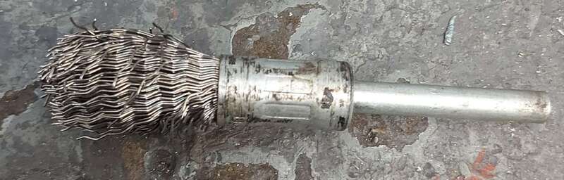

Snake Charmer Posted October 30, 2024 Posted October 30, 2024 30 minutes ago, LightBulbFun said: of cleaning up crusty connections/surfaces I quite often use a rotary wire brush ( pointed decoking type) for ring terminals PK screwed into chassis or body. LightBulbFun, Sheefag and Rust Collector 1 2
Dyslexic Viking Posted October 30, 2024 Posted October 30, 2024 1 hour ago, Snake Charmer said: I quite often use a rotary wire brush ( pointed decoking type) for ring terminals PK screwed into chassis or body. Just wear protection when using these in case a metal thread comes loose, losing an eye is no fun. Scruffy Bodger 1

Zelandeth Posted October 30, 2024 Posted October 30, 2024 3 hours ago, LightBulbFun said: speaking of electrical gubbins, the electric regulator arrived, and thankfully is what it showed in the listing pictures https://www.ebay.co.uk/itm/295927581581 which I was a bit aprehensive about since the part number actually written in the listing is different to the one we need/is shown in the pictures, but thankfully I need not have worried the correct part for me showed up although it did confirm my initial suspicions that the battery B+ spade connectors are chunky 9.5mm things, and the rest of the spade connectors are normal 6.3mm affairs I was not sure on this front since I thought the B+ one looked chunky but I was not sure without reference if it was overly large, or if all the other ones where overly small (say 4.8mm connectors) ill have to get some 9.5mm spade connectors then and locate where the B+ wire is on the old regulator according to the wiring diagrams B+ should be a brown wire, but the only brown wire in this shot seems to be a short loop of some kind, so thats something to look into (the red with the fuse is D+ the brown and yellow above it is the charging light, and yellow bottom right is DF, so I suspect the read terminal top *right* might be the B+ im looking for, but ill have to investigate) that reminds me slightly embarrassing question, but for cleaning up mating surfaces, for example the regulator grounds through its bolted connection to the chassis, and i'd like to ensure a good connection, whats grit sandpaper should I use to clean it up? (when I got REV back in 2021 I did get a large selection of sandpaper cuz I figured there would be a fair amount of cleaning up crusty connections/surfaces etc!) Assuming your wiring matches mine, I think I posted an annotated diagram of what goes to which terminals last page. These are my usual go to for cleaning up terminals and the like: https://www.toolstation.com/abrasive-clean-up-roll/p58309 Think it's actually intended for deburring copper pipe, but being a fairly thin strip makes it less cumbersome than trying to get a big sheet in there. Not saying it's the best solution, just what I've found works for me. Also ideal for cleaning up crusty hose barbs and such. Just wish the strips weren't such a bugger to find in the UK (they're way more common in the US). LightBulbFun, Snake Charmer and egg 2 1
