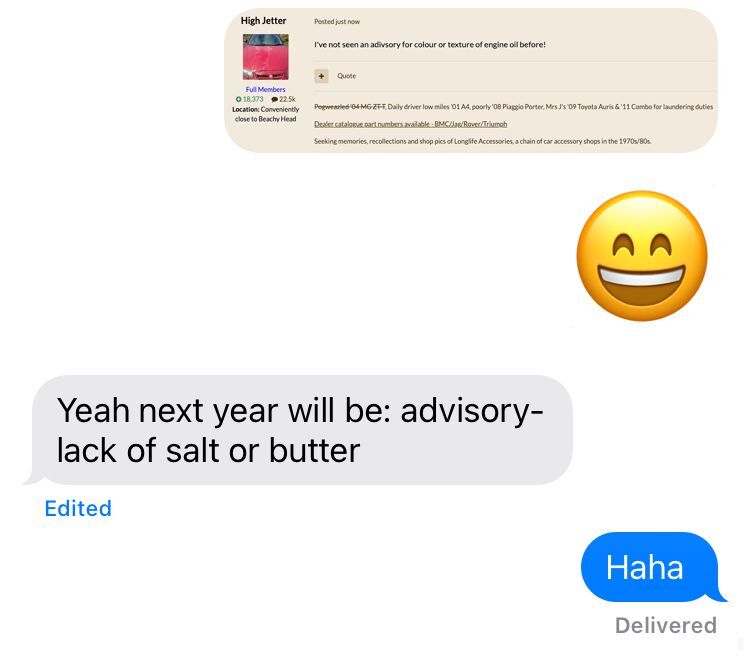

LightBulbFun Posted May 13 Author Posted May 13 10 minutes ago, High Jetter said: I've not seen an adivsory for colour or texture of engine oil before! my brothers response LOL High Jetter and lesapandre 1 1
