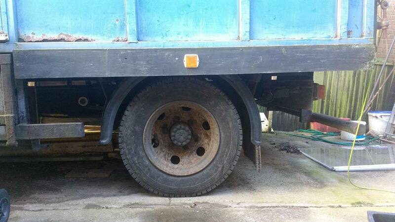

One bit of actual news is that the truck is now back on its wheels, sitting on springs that give more or less the right ride height.
I took the 'new' springs to Midland Motor springs in Notts and asked them to increase the camber from 3.5" to 5.5". They did that, charging me £150 for the job.  I then brought the springs home and waited till @cobblers was really desperate for his axle stands back, before I fitted em in the pissing rain, almost squashing my leg to f*** under the axle while i was on. To my huge relief they look much more like it, a decent few inches of clearance between the tyre and the arch, and some decent curvature remaining in the springs under static load. I've still got quite a lot of bongo car mags in the back as well although I have got rid of about half of the full stash so far.

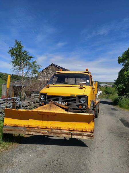

Not entirely horsebollocks related, but a couple of months ago the snowplough over the hill posted on FB that their snowplough had been vandalised - two windows smashed and the fuel tank punctured.
May be an image of outdoors
May be an image of 1 person
I pointed @Mr_Bo11ox at the post and he straightaway volunteered some spare glass he had.  With a bit of too-ing and fro-ing @task very kindly picked up the glass when he was on his way up for visit chez_L1 the other week, and we took it along.
Despite this being 'baby' bertha, it's a beast.  Thanks again to Boll and Task for stepping up to help out a random community service.
in a plot twist, it was actually terry bollocks that broke the windows in the first place while trying to nick the windscreen
Here's a bonus action shot or two
May be an image of vehicle, snow, tree and road
May be an image of road, snow and tree
Was nice to meet @Mr_Bo11ox to grab the glass, twice 😃
Snowplough is certainly a beast, it was interesting to talk about their upcoming plough-endeavour too. Decent guys.

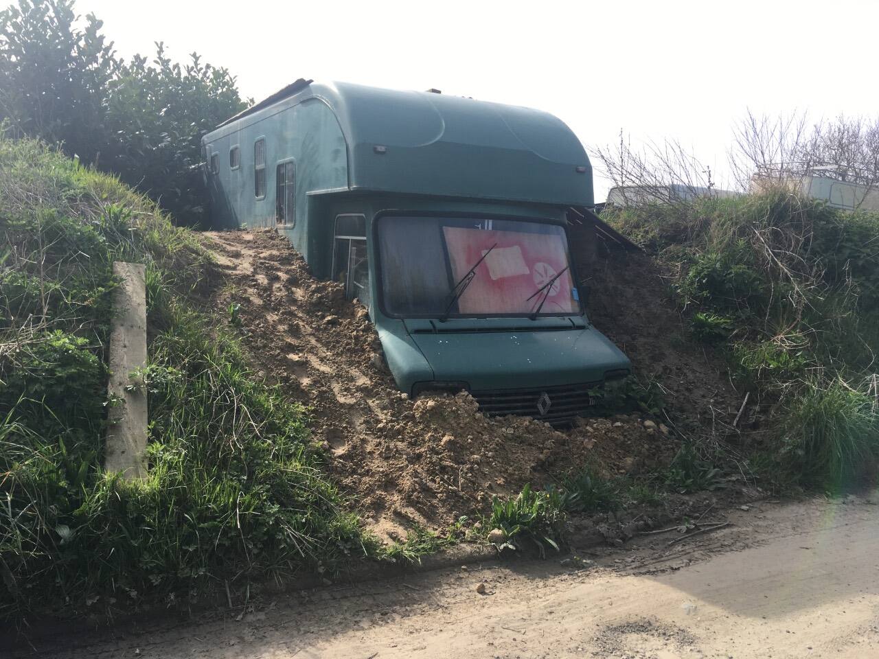

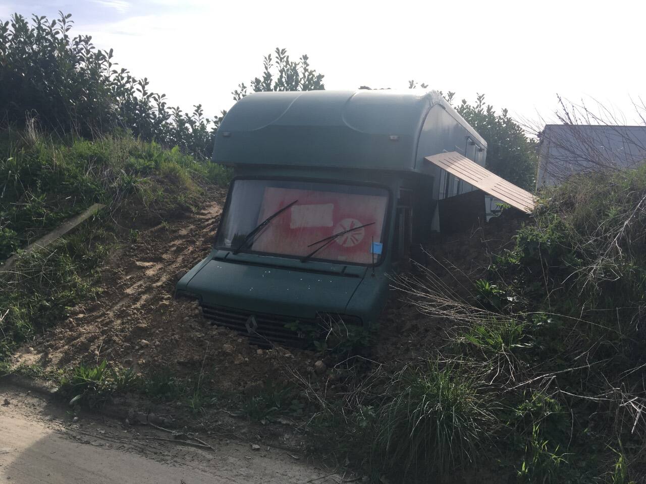

GR8 4 SPEAR PARTS. Spotted this morning while engaging in a bit of harmless trespassing
Burying it is one way to stop it wobbling around in the wind I suppose.
