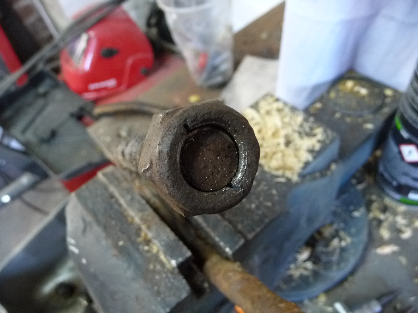

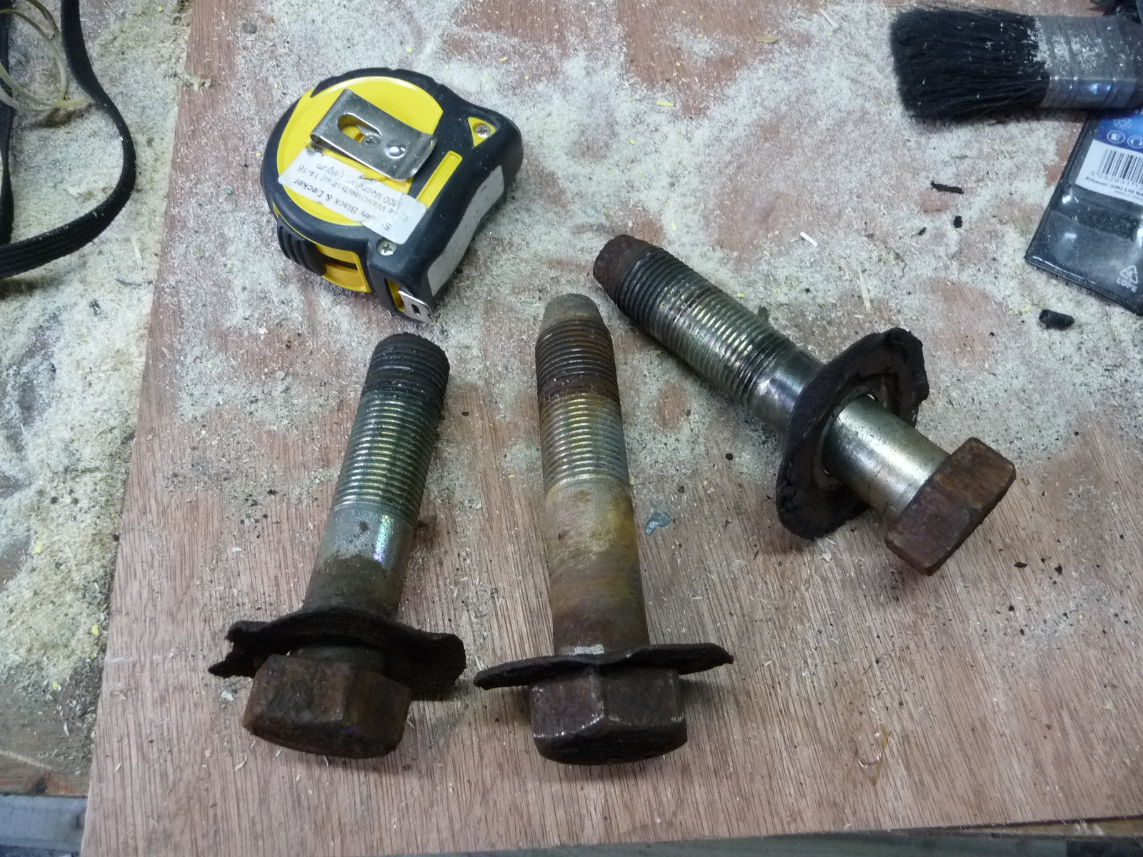

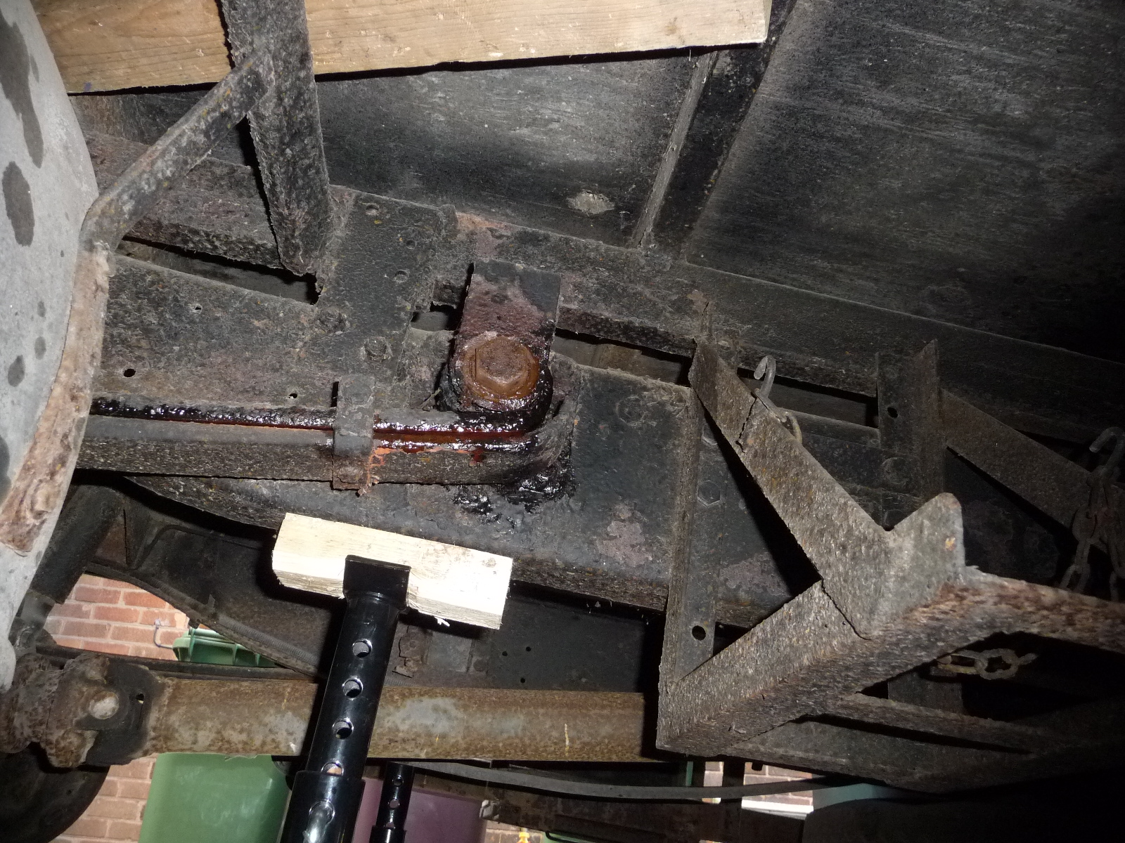

The big difficulty really was getting the spring bolts undone. Theyre an M24 thread, you need a 36mm socket to get em and afer 30 years sitting there, theyre FRIGGIN TIGHT!!!! also the U-bolts needed loosening and the lower shocker bolts. I spent a day workign on undoing all these one at a time before trying to actually lower the axle and detach the springs.
I bought a tin of plus gas and gave them a repeated soaking for a few days before having a go at them.
The only way I was gonna get these was with the torque multiplier doofer. Its got a reaction arm on which needs to react against something solid as the force on it is colossal.
I tried various combinations of blocks of wood etc and eventually got a set-up that worked. With those in place I was able to crak those bolts and work them back and forth till they were turning nicely.
Lots of hammers and levers!!!

Eventually I was ready to try and drop the axle sowith the jack under the diff I removed the 2 aft bolts
That allowed me to lower the axle onto two little axle stands with some shaped wooden blocks on the top
Locking tabs are a bit sad-looking, might need to replace those
got a piece of timber under the nose of the diff in case it got any ideas about dropping down
A bit more tugging and wrestling and we had these!!!

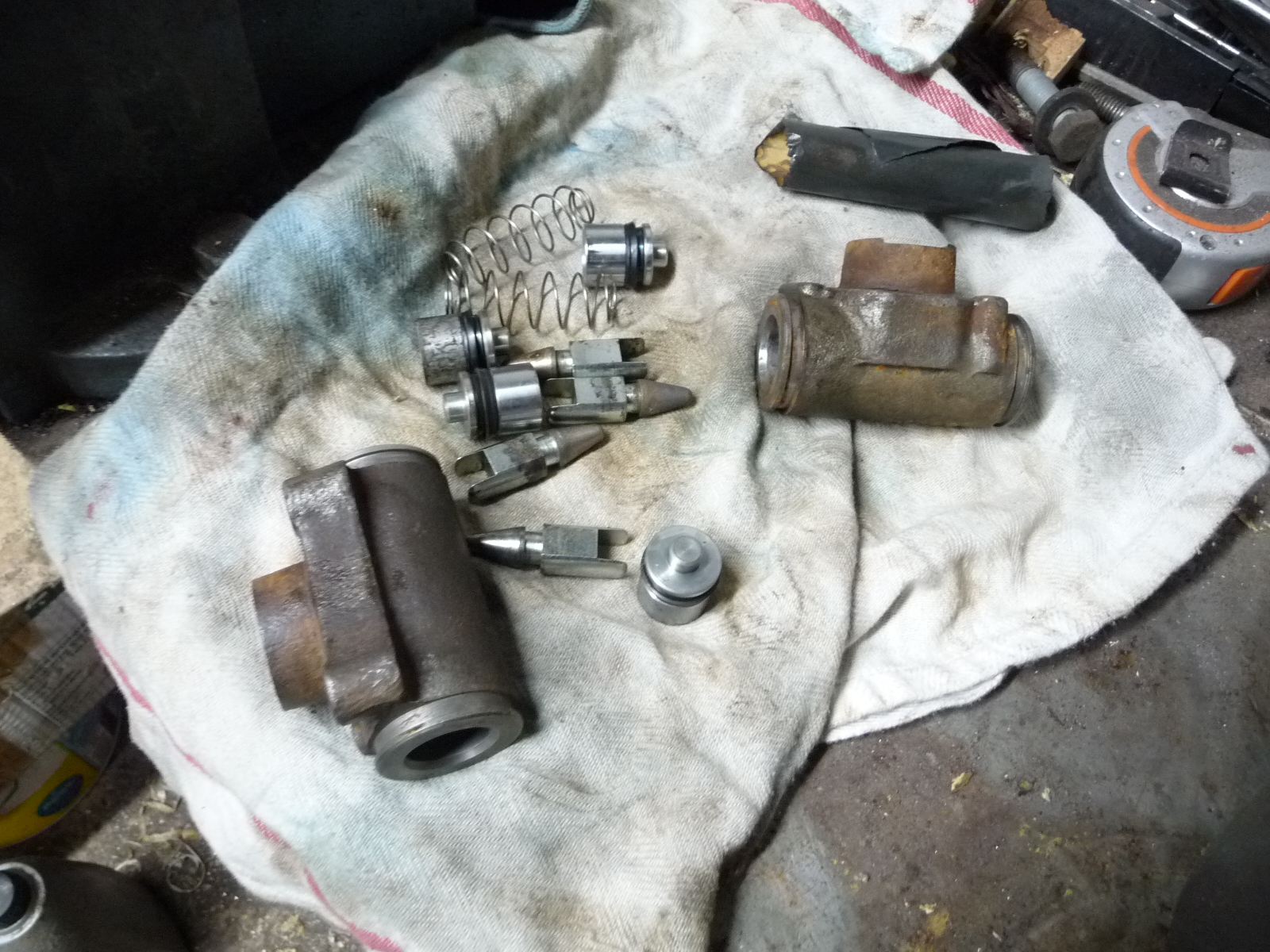

overhauling the rear wheel cyls:
Got a rebuild kit off Past parts, 2 new stainless bleed nipples off eBay, and I even found some new (oddball imperial thread) bolts and spring washers to fasten them on with. Gave the bores a good polish with 600grit paper and WD-40 - they were not quite as perfect as i thought they were but not bad, i think they will seal up OK.

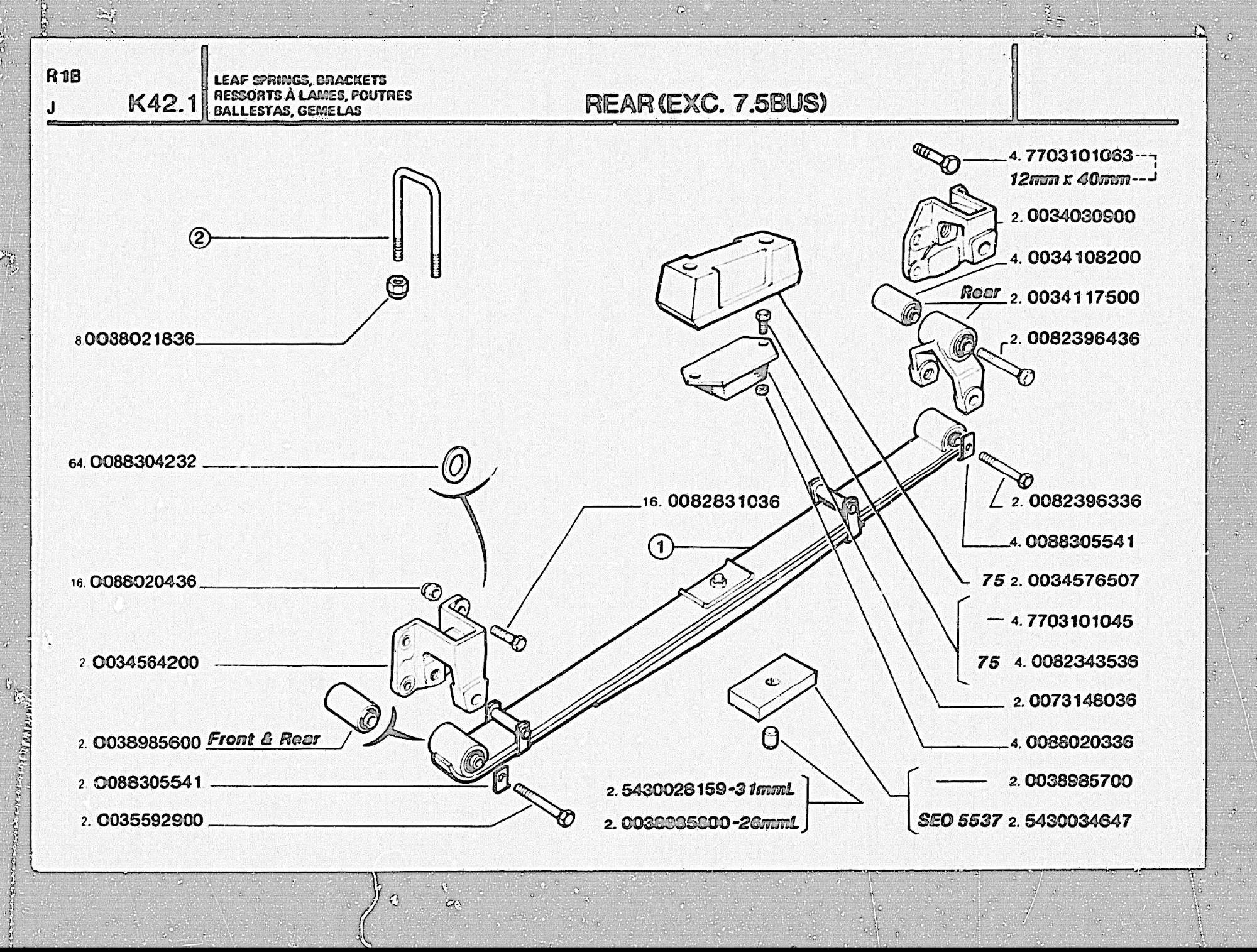

Stupid question from a leaf spring idiot.  Would it be possible to fit some sort of spacer to raise the ride height, I.e some daft shiz the Greenlaners do to their Suzuki SJ’s to make them Godzilla height?  My knowledge is based entirely on Edd China spunking Mikes wedge on an SJ that failed on structural rot.
Maybe there should be a spacer that has been removed in the past by someone looking for that low rider look for their horse box?  Snoop Dogg perhaps...
Lift blocks are commonly used, but they won't help the fact that the spring is bent past flat when the truck isn't even loaded.
Leaf springs shouldn't generally bend as far as that and it's probably not good for them, so there's definitely something amiss here. Also VOSA etc see a flat spring and their monacle pops out.
It’s all very odd. I‘ve never seen new leaf springs as flat looking as those ones before, I can’t help but wonder if something major has been lost in translation, IE they’ve basically just remade the old ones, faults and all.
I could be talking complete crap and/or totally wrong but as I alludes to earlier in terms of leaf springs I thought there were two failure modes, physically broken/fractured leaves and all sagged out like these original ones were. In terms of how you fix this I thought it was more a case of retempering them in a jig rather than replacing leaves?
Or am I talking utter shite?
the one number I have got out of them was that their 'specification' says the spring should have 4" of camber (curvature) unloaded, which I think it does have.  But on its own thats pretty meaningless I think. I guess that does mean theres only 4" of suspension travel till the things are flat. I'm guessing that the springs should be capable of at least taking the full payload of the truck before theyre flattened.
If the axle weight is 1800kg (half the truck weight of 3600kg) then theyre on 900kg per spring static load, plus roughly 1000kg per spring payload. So you could say under static load with the truck empty, the spring should be roughly halfway through its travel, certainly no more than that anyway!!!! I'm totally guessing at this lot but it seems plausible.
Your guestimations sound entirely plausible, if anything conservative given that the axle weight of the rear axle will be greater than the front.
I’m sure that you’ve spent hours more looking at brochures and stuff than the 10mins I’ve been googling on my phone but it’s interesting that the chassis cab in the brochure here https://hooniverse.com/the-carchive-the-dodge-50-series-trucks/

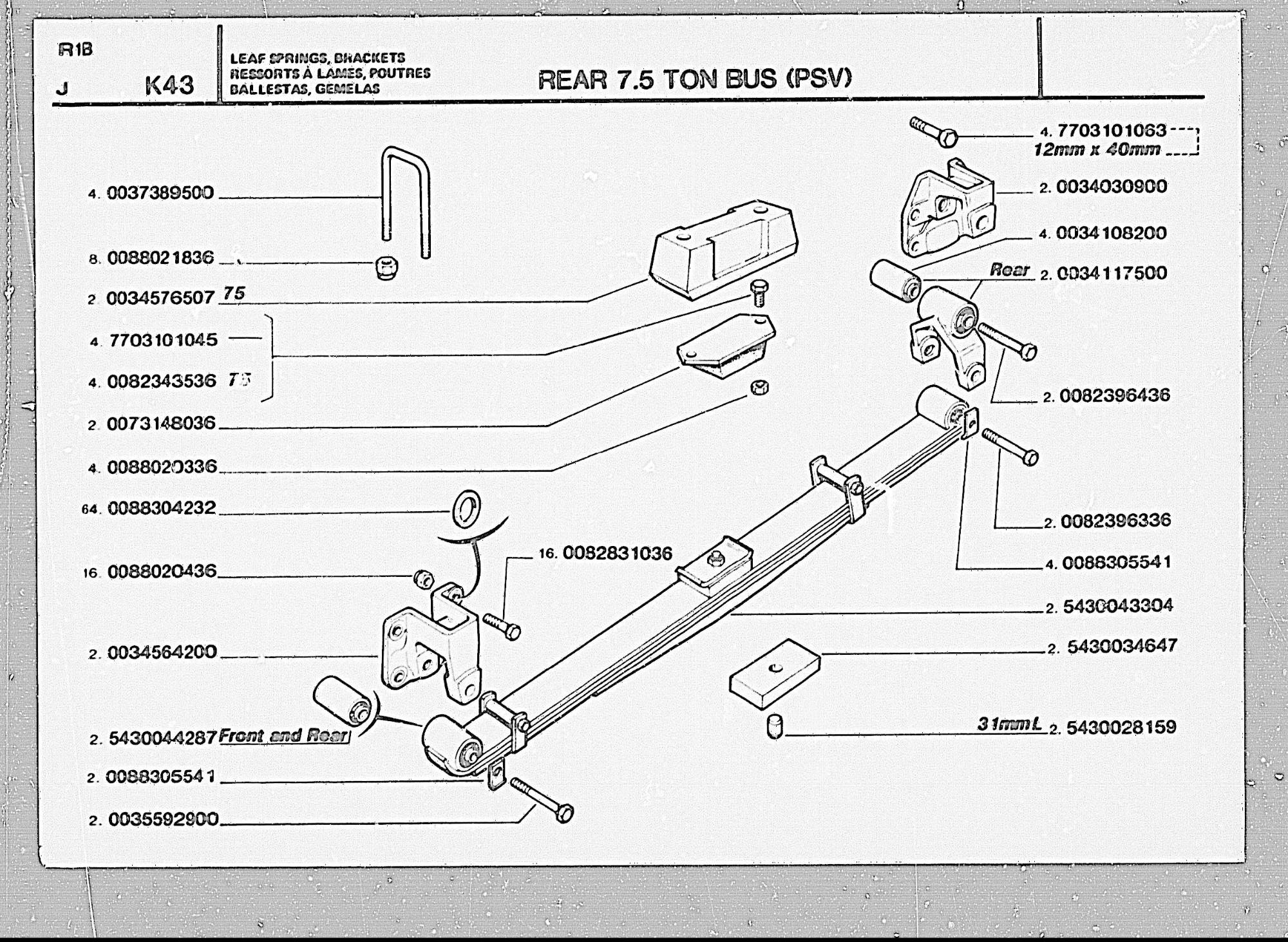

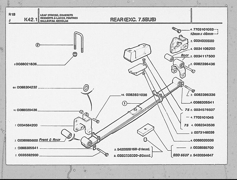

clearly has a lot more leaves than your springs which does lead me to fear your truck might have suffered a broken spring and been fitted with smaller springs off a lighter weight 50.
yeah thats interesting, I hadn't spotted that. I did have a look at the parts catalogues and the 5.6 tonners appear to have a 3-leaf spring but they do have a unique part number so its possible that it should have more leafs. I think I will take some soundings on the Dodge 50 FB page
