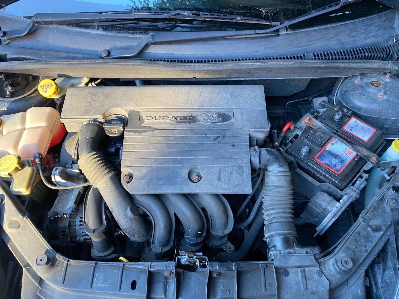

  1. Another SMOLL update on the Fiesta from t’auction. I put on my brave pants and decided to tackle the blue smoke issue with this one. I’d pre-empted that the air filter and plugs were going to be absolutely gopping. I was not disappointed. That’s some serious neglect, the air filter is fucked! The plugs were terrible, this is after I’d cleaned the plug threads of oil, they were all absolutely saturated - I’d say the rocker cover gasket’s given up. So after a quick set of new parts, it was time to sort this once and for all. Armed with a can of Wynn’s stop smoke snake oil, I poured the gloop into a warm engine (which was more responsive after I’d replaced the air filter - what are the chances?!) and then I let it do it’s thing. After 10 minutes of running, this is at idle. I’d call that a win. It still produces a bit of condensation but the blue smoke has virtually all gone. I’m hoping it’ll scrape an emissions test and then we will be good to go for a year. MOT booked for December 4th at 10am!

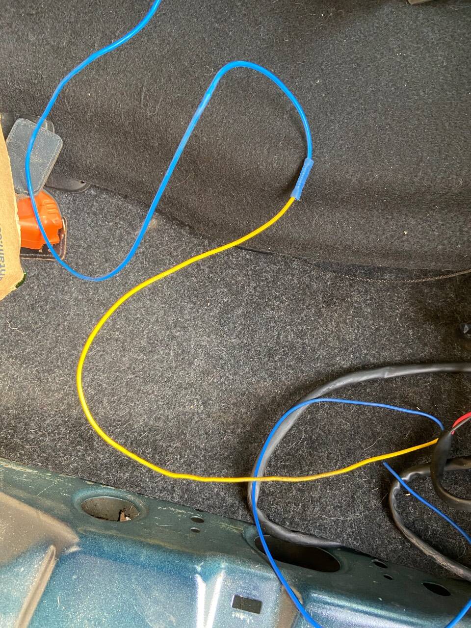

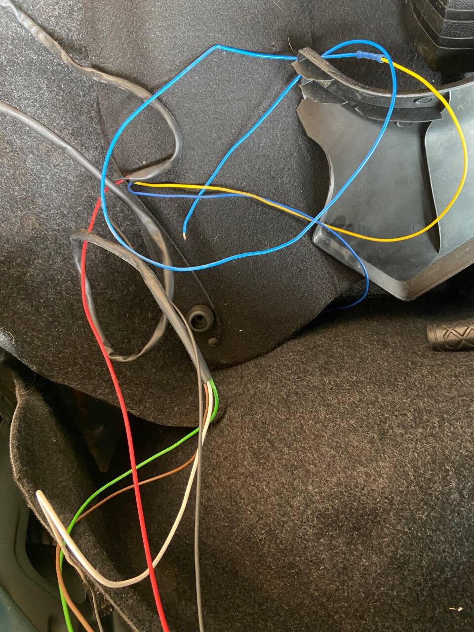

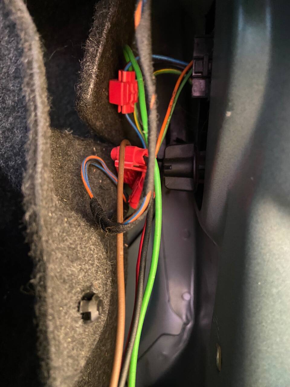

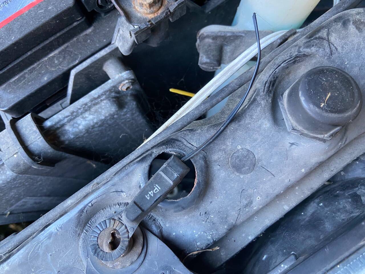

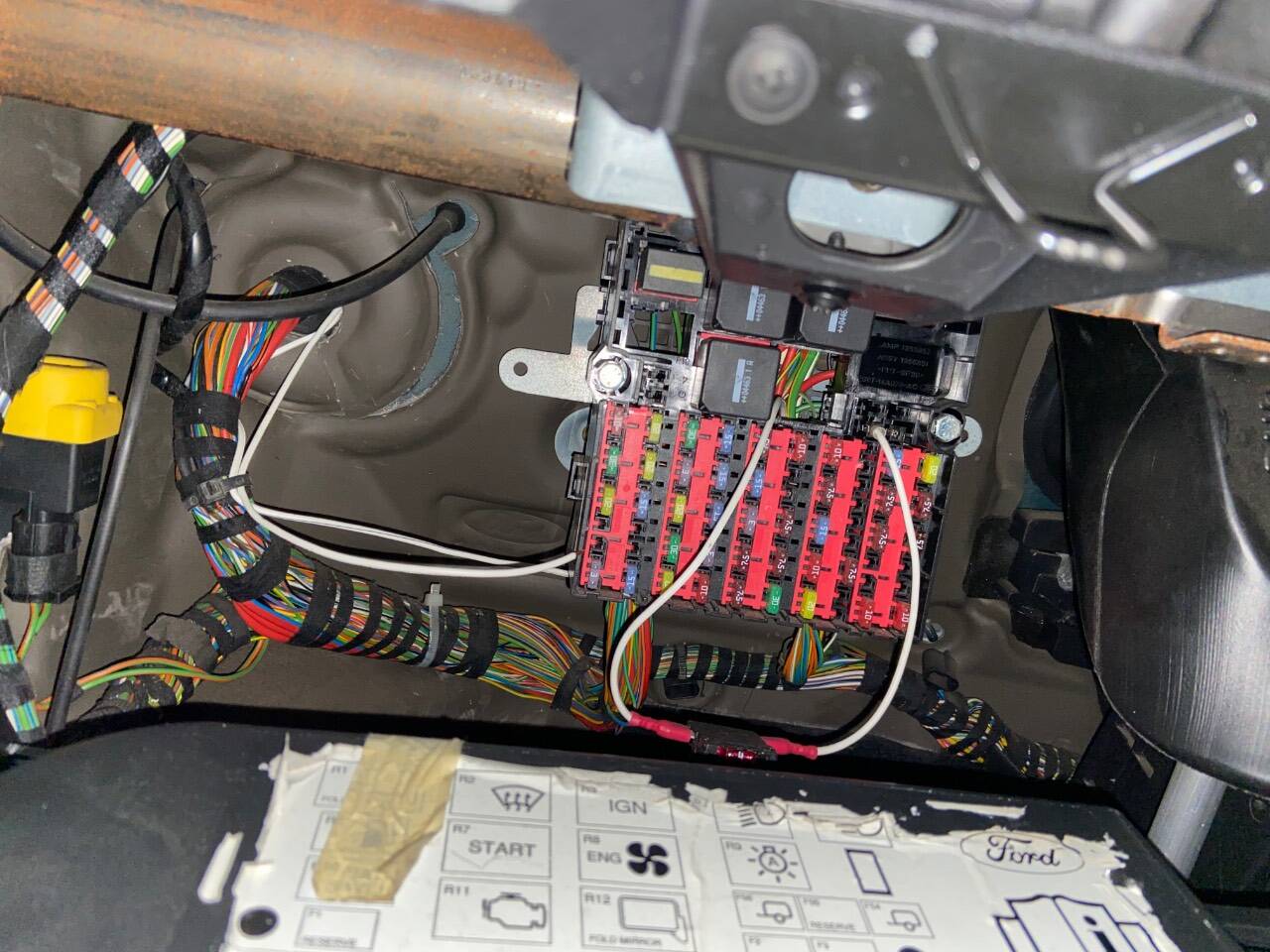

  3. More progress on the Fiesta today. I decided to tackle the towbar wiring on this beast. A quality* installation of the wiring. A rat’s nest looks more appealing than this madman’s work. Ok, so this is the O/S rear lamp - all wiring present and correct, even though scotchlocks of doom have been applied in this instance. Here is the offending loose wire, which on closer inspection the yellow is the wire for the left hand indicator. Coupled with the length of the wire, this is likely the wire going to that. It seems that when Keith removed his 73” SUBWOOFAH and MEGGER SAHND INSTOWL from the boot, he’s knocked the wire off. Let’s have a look at the other side. Bingo. That’s where the wire’s come from then. Fixed. I pushed dad’s trailer round to the back and connected things up. Because the trailer hasn’t been on the road for 20+ years, I’d imagined all the wires to be corroded and bulbs not working. But no. Lights came back to life with the exception of……the left hand indicator. FML. I don’t know what Keith has done but no dice on the wire. Unless I’ve not put the scotchlock together properly. I’ll sort it another day and if it fails the MOT for it then I’ll ask nicely if the tester could sort it out for me, he’s good like that. More worryingly, when I was running the car for the trailer wiring faffing, there is a few wisps of blue smoke coming from the back, and on closer inspection it does seem it’s burning a bit of oil. I think this is the reason why it was at the auction now, Keith has absolutely ragged the bollocks off it and flogged it on. A bit of a shitty thing to do but I guess I’ll have to deal with it at the MOT. I’m hoping it’ll just scrape the emissions. As long as I can get a year out of it, I’ll be very happy. What I may do is stick some smoke additive in before the test and fingers crossed it’ll do enough to make it through. I did check the PCV valve out of curiosity and it rattles so that’s working according to the interwebs. The hose going to the valve had a huge split in it, so I’ve expertly* repaired it with tape. This may be a contributing issue towards the smoke? I also took the air filter off and it’s absolutely fucking filthy so I’ll order up a new filter along with some plugs and a tin of snake jollop for the journey to the MOT place. I won’t lie, I’ll be quite upset if it fails. Poor little car deserves a second chance on the road IMHO and it’s absolutely ideal for what I need it to do, especially with the towbar.

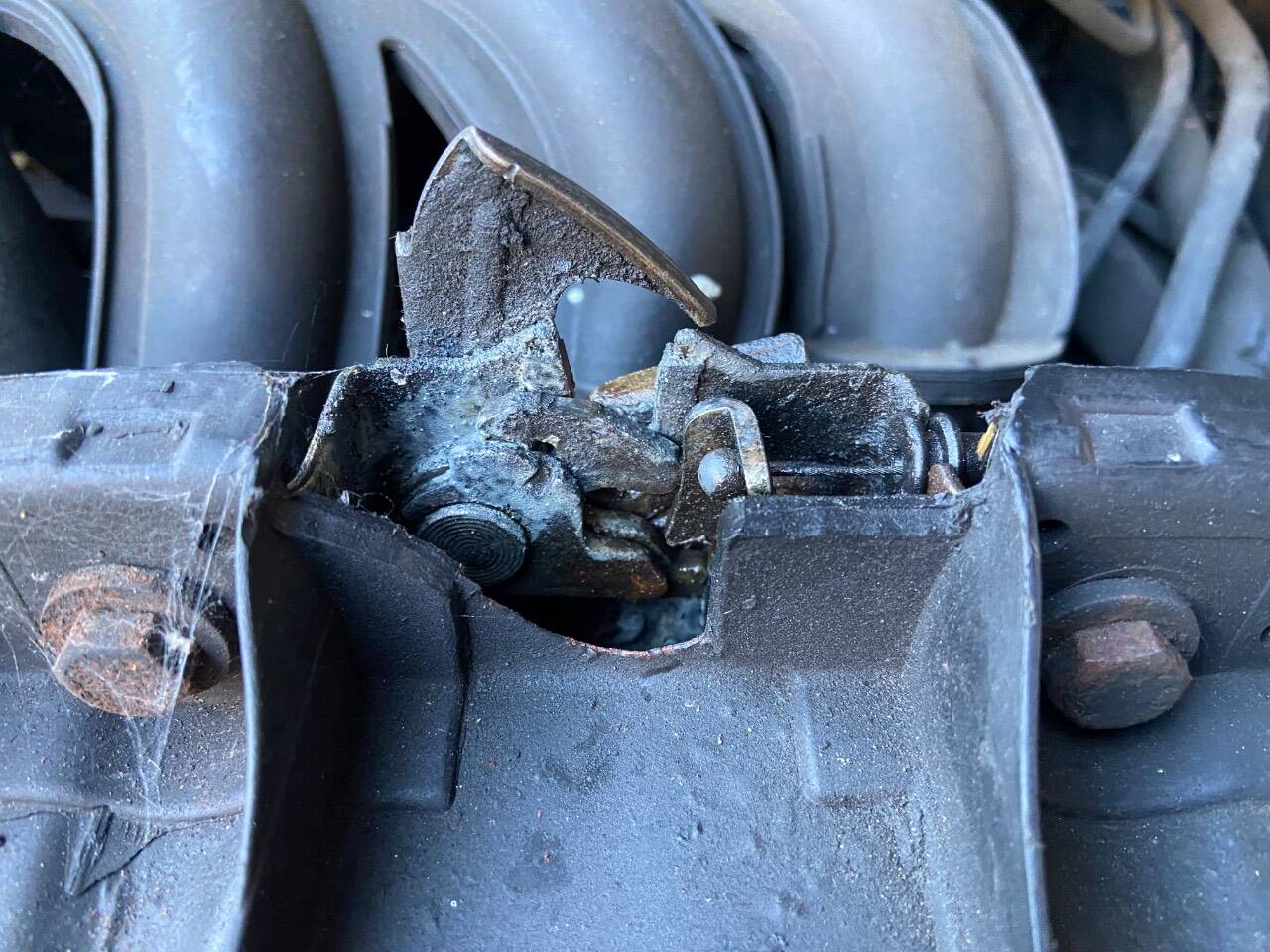

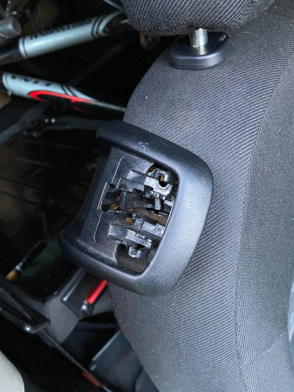

  4. Another SMOLL update on the ORKSHUN FIND Fiesta. First job was to sort out the buggered bonnet latch. Unhelpfully, my local scrappers has just had a mahoosive clearout of old vehicles, many of which were Fiestas. There were just two of my shape left there and one of them yielded the bonnet latch we were after. New one on the right. Spot the difference? The spring for the release mechanism is completely missing on the old one. That may have something to do with the issue. Parts swapped over and a bit of latch adjustment and hey presto, the bonnet opens and shuts as it should. It’s also a good job I took the bolts from the donor car as the sizes were completely different on mine. A quick check over on the car and a blown sidelight bulb on the front passenger side was attended to and rectified. What else? The drivers seat latch was broken which is common on these. Thankfully the bay of E came to the rescue and for just £9 I had a pair of latches in my hand. Only fitted the drivers one as the passenger one is still operational. If it ain’t broke and all that…. And now the seat tilts and shuts like a good’un. Lastly, my OCD was killing me and I had to do something about the lack of TRIMZ on this fine machine. Again, the bay to the rescue and I actually bought the trims that were pictured on here in the last segment of this journey. Just £10 and the last piece of the puzzle gets fitted. There’s a broken clip on the drivers front but I’ll throw a cable tie on it to stop it doing the falling offs. BETTER. There is one more job before it’s MOT, to sort out the towbar wiring as someone has cut a wire in the back and is laying in the boot. Might have been from a fancy sound system but I think it’s probably the indicator buzzer or something. Who knows. More next time.

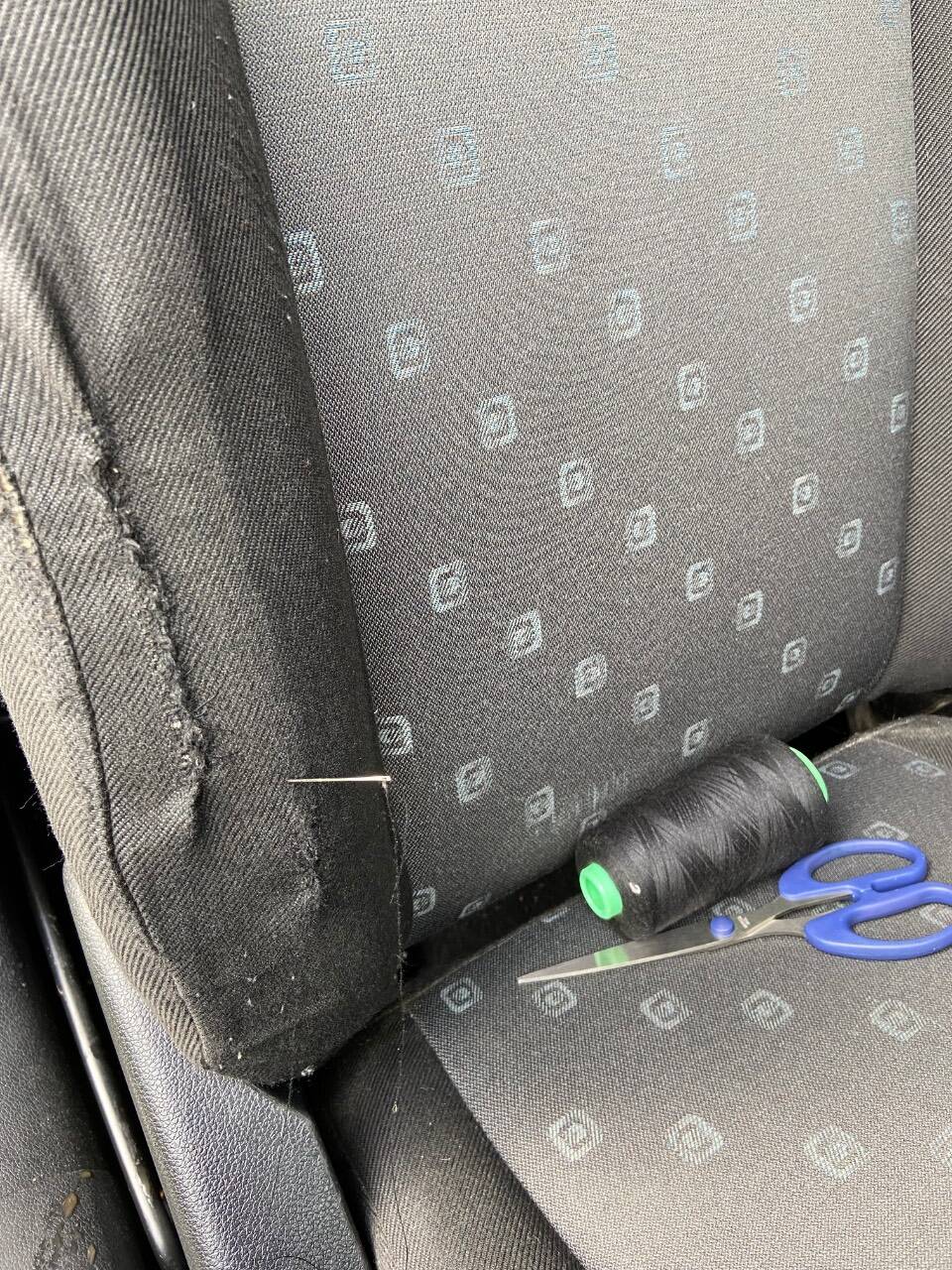

  6. A SMOLL update on the Auction-find Fiesta. Whilst it was having a snooze, I got bored and attempted to sort any gremlins out that I had found. First up, the drivers seat fabric was torn on the bolster with a smaller hole next to it for good measure. A quick needle and thread session later and it’s better. I’m not a seamstress but that’s not a bad job I think. I’ve found out it’s also great for storing all your worldly possessions (well, some of them.) Further de-snagging - it had no brake or clutch pedal rubbers which is an instant MOT fail IIRC. A quick trip to the bay of E sorted me a brand new pair for under £4. I was astonished when they plopped through the postbox the very next day, that’s amazing delivery make no mistake. Bunged them on and they fit like a glove. Unlike O.J. Simpson’s. I’m after a set of these hubcaps if anyone’s got a set going spare? Has to be these ones as they are TEH SEX. Ford really know how to make a good set of trims. Not just of this era of Fiesta, take a look at the Escorts, Mondeos with the GLX swirly trims. Fucking peachy. Bonnet up and let’s have a look at that catch. It will release, but very very slightly. It doesn’t seem to feel as free as it should. Verdict: FUKD. Get a new one, greengartside. So just assessing the engine bay in general. Nice and tidy, and looks honest for 99k miles. Not su…..WAIT, what’s that? A white wire? Hmm, let’s have a look then. Speaker wire! Someone’s been bodging! It came from down near the N/S headlamp & the horn. Both of those work though, and the wire was chopped at that end. Let’s follow it and see where it goes. The fuck is this bodgery? I’ve already removed one side of the earth wire by this point. I also found this cut gubbins atop the headlamp screw point. So I carefully* removed this fire waiting to happen and disposed of it in a sensible black bin manner. I kept the fuse holder though because hoarder. All I can surmise is that the speaker wire led to one of those LED light bars that Nicky or Luke like putting on the front of their cars to make them look like a Transformer, or a Hyundai. Fair play that they actually used proper spade connectors, and not twisted the wires together and taped them like someone used to do 20 years ago. I did that with fucking stereos 😳 - I think this would also explain why there are no wheeltrims with it. Nicky or Luke fitted some 17 INCH SICK RIMZ I guess and chucked the trims away. Anyway, more updates as and when and all that.
