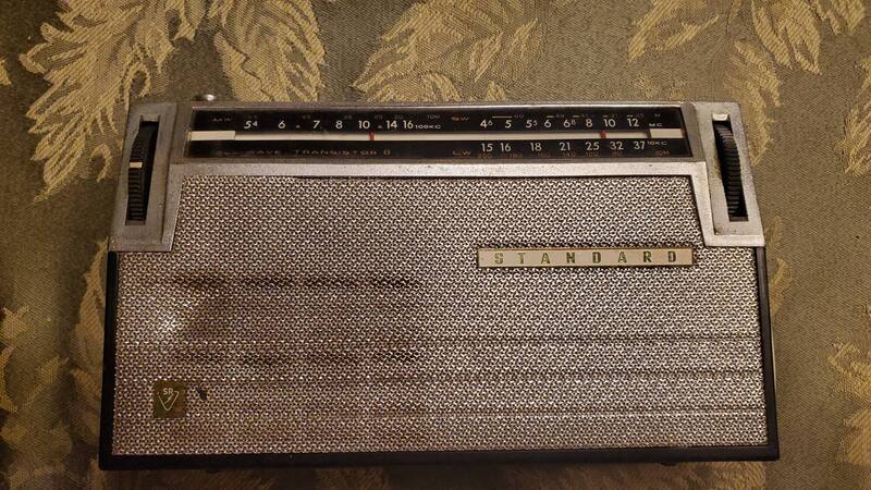

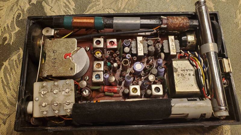

My father brought this little transistor radio with him from the UK when he came visit last; it's been all over the world, has some old brochures from some defunct airline in the back (Fly TREK - Johannesburg) but over the years it's fallen silent. It used to be used in his Sprite, so the last time it was in regular use was maybe 1980.
I taped up the battery holder and liberated some pops and crackles from the speaker from the volume dial and wave switches. Good sign there, the output stage is alive as well as the IF oscillator... Had a bit of a go at it with an alignment tool and managed to get a few local stations out of it. Needs a full rebuild but this is the radioshite version of "first start after years in a barn". Quite pleased with that really. It's also got the early NASA problem of "tin whiskers", where the germanium transistors are in little metal pots coated in pure tin to stop them rusting. However pure tin, left to its own devices starts growing tiny crystalline filaments from the surfaces and these cause short circuits if they grow far enough to touch the gubbins inside. Still, it'll live again. All the important bits still work.
Phil

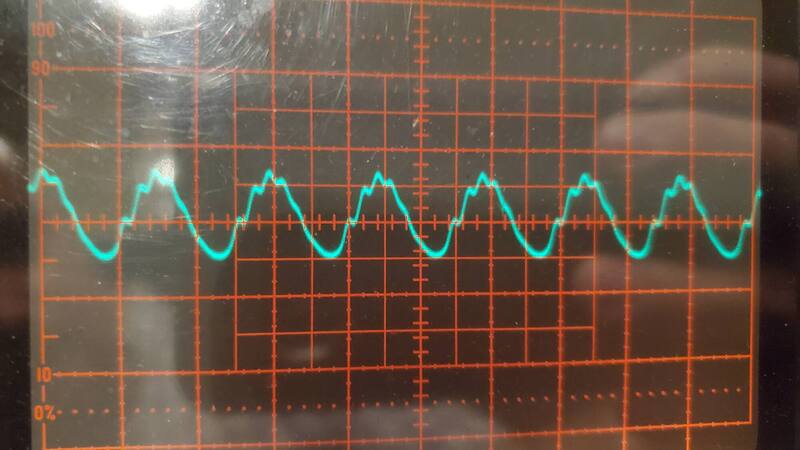

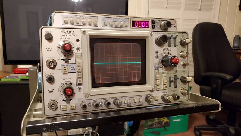

Edit: Warmed up an oscilloscope that's not much younger than the radio last night to have a poke around inside the radio.
Started at the IF and mixer- got a ringing capacitance somewhere.
That has the effect of making the audio sound distorted, which it does. However, poking about I twisted the board slightly in the radio and it suddenly became much more loud and clear for a moment so there's definitely a broken trace or dry solder joint somewhere on it. I'll have to pull the board and check. Already on the way to being repaired.
Phil
needs more vacuum tubes and a 90V B+ battery made out of pure unobtanium :mrgreen:
(still very cool to see tho :) )
Nah, nothing wrong with an early 60's transistor set- particularly if you figure that was made by the company that became Marantz.
I always loved the smell of the inside of old radios, they had an odd but strangely alluring odour. Maybe it's just me and I really am weird? Also 'cap-guns' wonderful pong :)

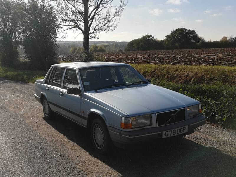

Streetwise re-windscreened on Tuesday following vandal attack, and as an added bonus I now have a green sun strip too.
Took it for a long drive to celebrate getting it back on the road again.
