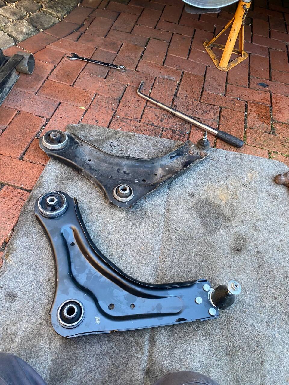

Replaced the NS wishbone on the ‘gooner today. I’d been putting it off as the bolts are super tight and I didn’t want to end up with an immobile car for a week with the job half done or something. With a 2ft scaffold tube the bolts were eventually cracked off and the wishbone replaced.
The rear bush looked pretty knackered so replacement was overdue!

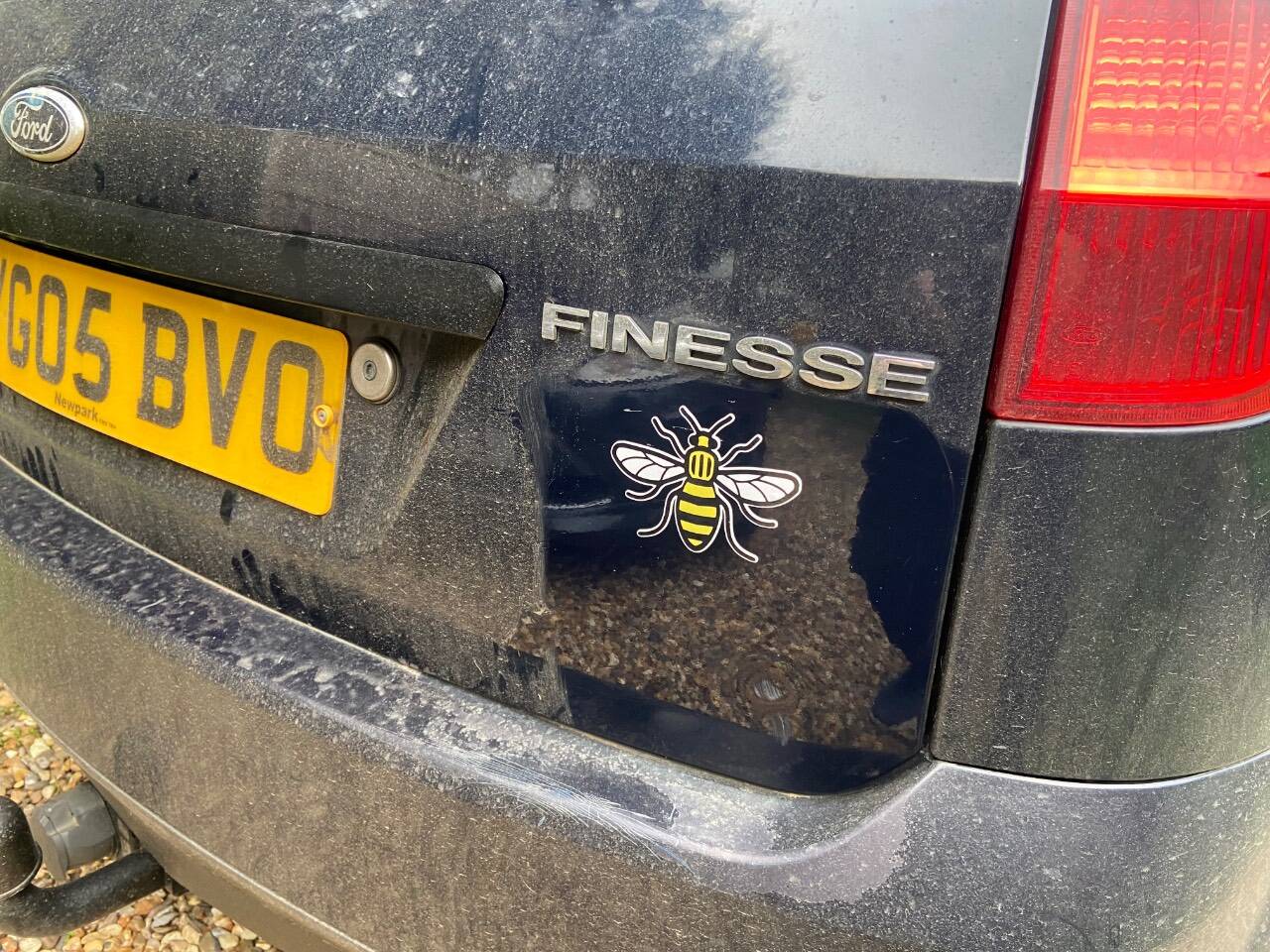

The auction find Fiesta is still going strong…
…..I decided to treat the old girl to some instant 10,000bhp modifications.
Yes, it is a shitbox and it identifies as a Manchester Bee.
I had a small issue with the EML coming on after some heavy downpours. Apparently there’s an issue with the engine wiring loom chafing the block and the most vulnerable point is the wiring loom for the crank sensor. Water got into it, killed the rev counter and popped the light on. A quick five minute session with the OBD Scanner (that I found in a scrap car at the scrapyard) cleared the code and it’s never came back. The rev counter did die briefly then came back and all is well. I’m now typing this and realised I forgot to get a section of crank sensor wiring from a car at the yard this morning.

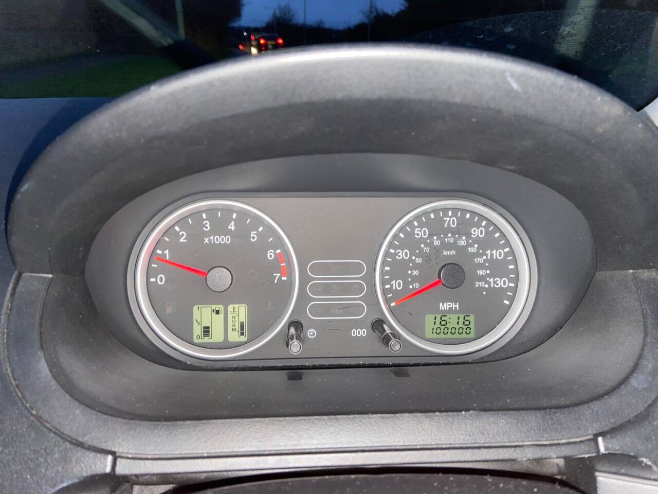

Oh and this happened yesterday.
Welcome to the 100k Club! Badge of honour duly awarded. Well done little car.

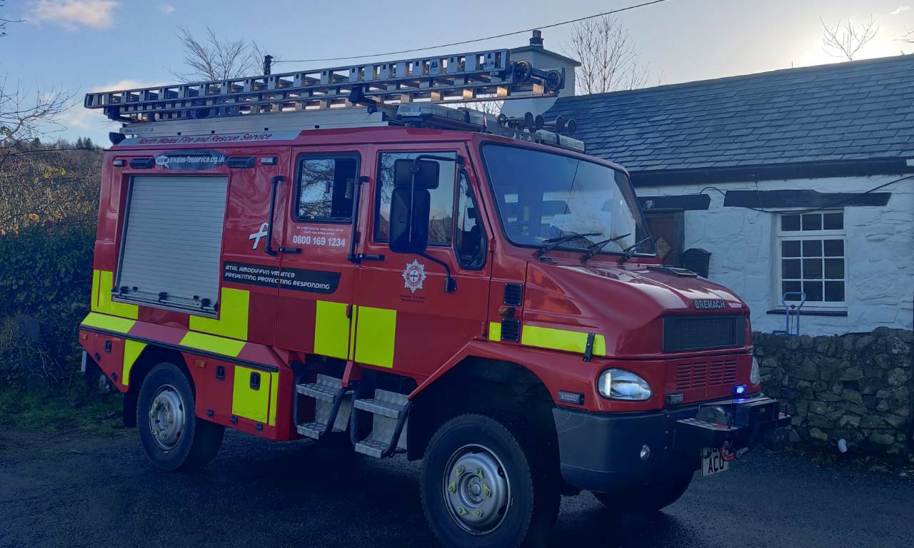

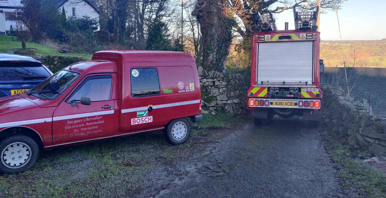

Finally a nice sunny day here so I had a run out in the C15.
Got home to find this outside my house.
Nobody hurt fortunately, the neighbours' flue liner had failed and filled the upstairs of their house with smoke. Good practice for the driver getting something that size down a narrow twisty lane.

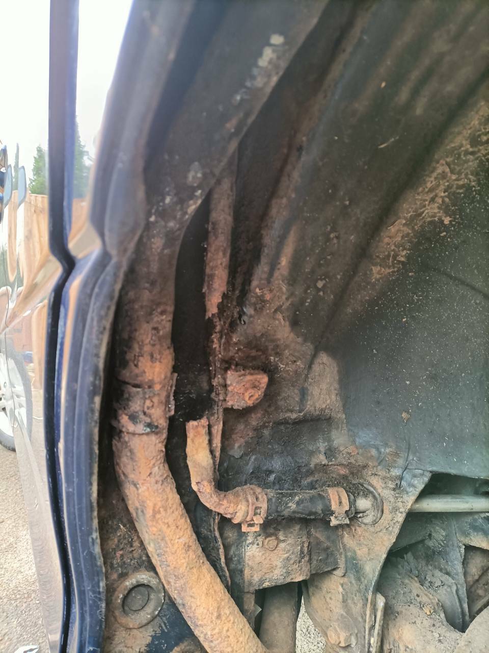

The sister in law's Previa with the rotten fuel filler neck (arch liner retaining all the road crud) is fixed.
A shout out to V6 autoparts off of that there eBay who delivered a perfectly fitting pattern replacement part in under 24 hours via DHL for a quite reasonable £89.
Zinc anode painted followed by much Gravitex stone chip then topped off with lashings of waxoyl should see it outlast the car.

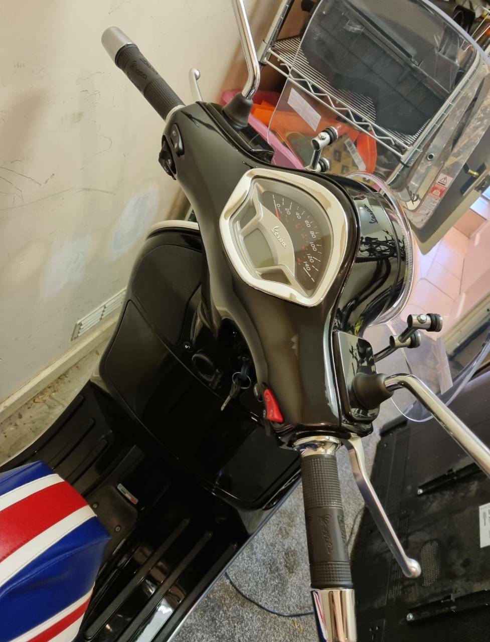

Been busy getting the motorbike out of its cocoon.
We had the house, garage and shed rewired so wanted the bike safe from damage and theft whilst we moved out for the duration.

Bloody hell - having driven up the lane to your house I can only say "rather them than me"!

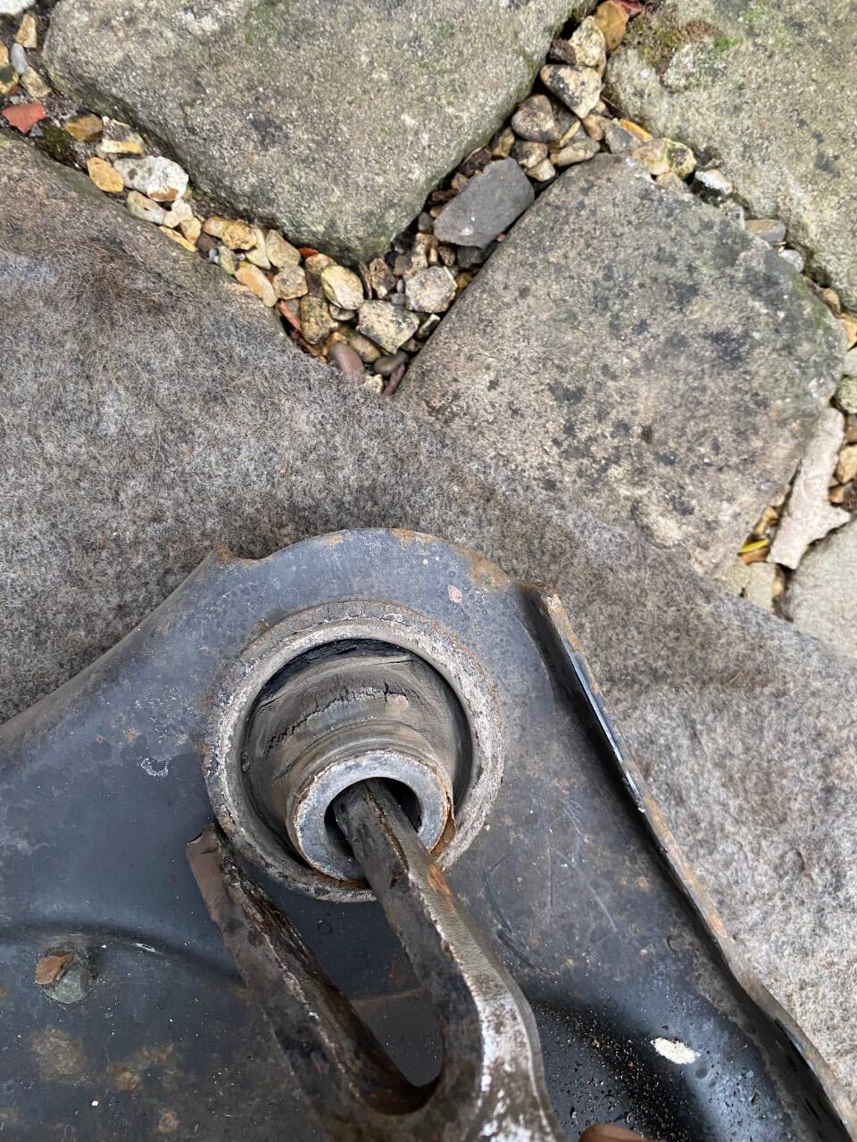

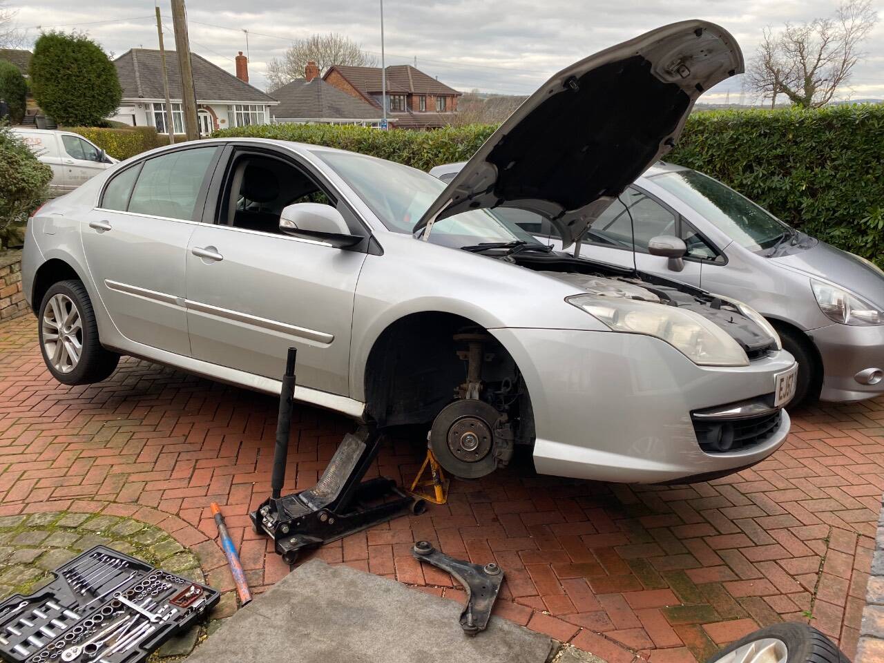

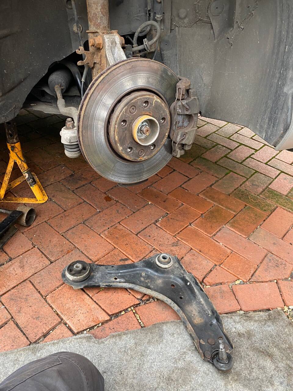

After the success of the N/S  Laguna wishbone replacement I got cracking with the O/S.
its always nice to see an obvious failure point when replacing a part. Oddly the front bush had failed on this side, on the other it was the rear bush that had split.

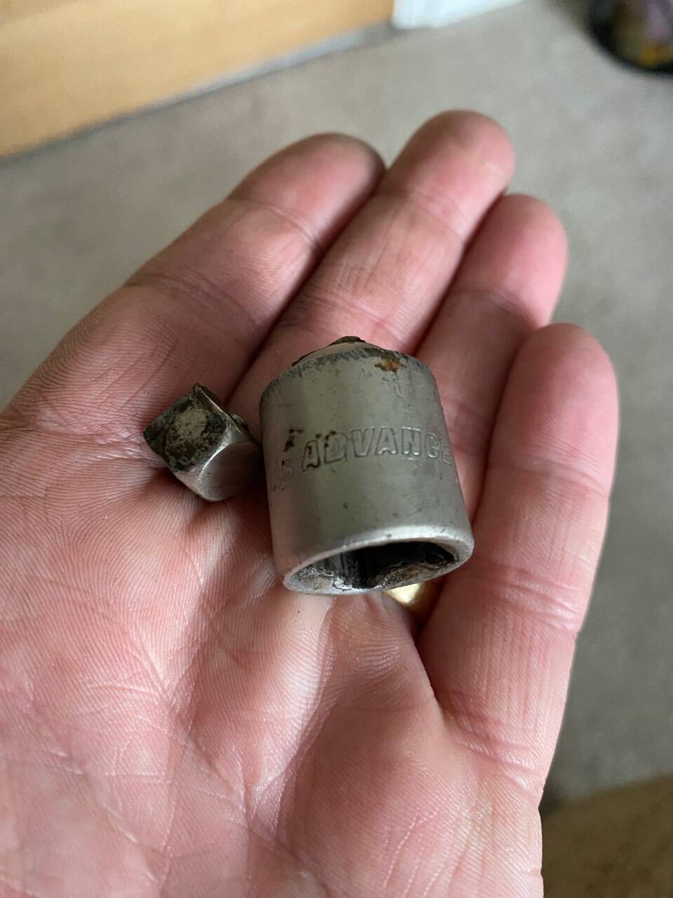

I managed to break my 1/2 to 3/8 adaptor but I should be able to get a replacement FOC from Halfrauds.

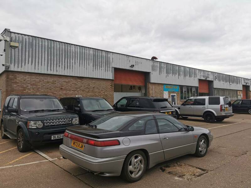

Had the Saab valeted today, at a nearby place which actually takes card.
£28 well spent.

That's a good idea, they're consumables really. I don't know if an impact one would be stronger in max torque but it would probably break more suddenly and send your knuckles into something hard and sharp

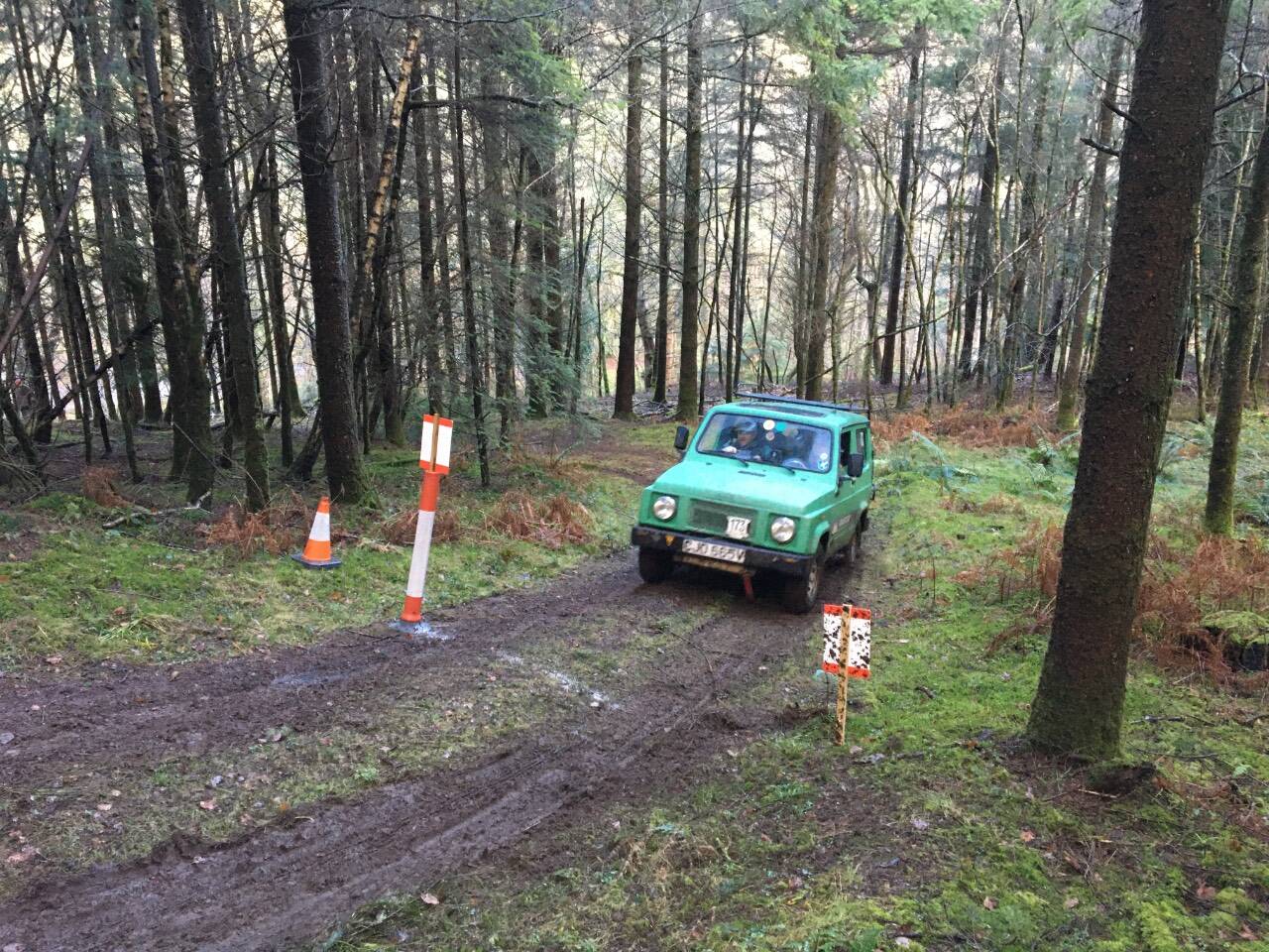

Caught sight of @groovylee tackling the hills on this years Exeter Trial.
Amazing! Thanks for the great pic!I was so gutted with that hill, we were celebrating getting up the main slope at the start, and sort of didn't realise there was more to come 😅
The rest of the trial went well, right up until Simms where we snapped a halfshaft and destroyed the diff. A *quick change of both and we went on to finish 💪IMG-20240107-WA0014.thumb.jpg.81fca1c2f285b7fa58f2eb194d3d6c32.jpg

A good effort changing the diff and half shaft. Are you claiming a medal?
it was an interesting one where you spun to a halt. You seemed to have too much wheelspin, and may have been better off easing up to get some grip as it was pretty slippery there. Easy to say though as it all happens so quickly and the brain can be a bit fogged, having driven through the night. At least it was a dry run, although with a fixed roof over your head, and I presume a heater, you’re going to be much better placed than many if it was raining.
