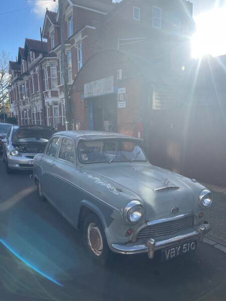

After having trouble finding someone who’d be willing to change my rear window seal on my Austin someone recommended I try Wimbledon Park garage in Portsmouth, which was a delight to visit, it really was a proper old school garage, I had a good long chat with Graham the owner about his business and it turns out he’s been there since 1969 and whilst he wasn’t able to assist in changing the seal he gave me the number of another garage Pete’s place who have booked me in for next Tuesday. Very happy
Sunday it was bloody cold and tried to open the passanger window, though not frozen it went crack and wouldn't open, so tonight I spent my 30 min break stripping it down, then was too cold and went inside back too work... #tisbitfreshouttherelad
