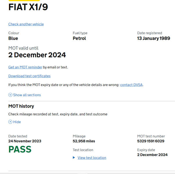

MOT'd for another 12 months. It will however need new rubber in the new year.

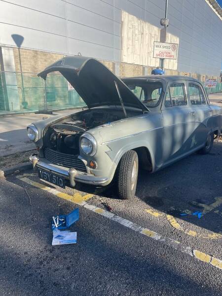

Huge thanks to @Talbot for taking time out of your Saturday morning to help get my Austin stopping again! It’s honestly really appreciated. It turns out it had new copper lines just before I bought it but one had been rubbing on a coolant line and rubbed through causing the leak also the person who fitted the new pipes managed to chip the edge off of one before even fitting it so I’ll be going over and checking all the rest in the not too distant future, either way it’s all fixed now and it’s really nice to have it back
Looks like they didn't double flare the failed pipe, definitely worth going over the rest and redoing it all if they've made the same mistake on all the other ones.
I made that mistake once.  Fortunately I noticed before I fitted the pipe to the car...

Not only had the flares not been made as a double flares, and hence the tube had split, but the pipe from the 4-way to the NSF had been in contact with a steel oil pipe on the engine and had worn all the way through.  Also the bends had all been hand-bent, so one of the tight ones into the union was folded almost flat.
Pretty crap install really.  Replacement pipe has double flares both ends, bends formed with a tube bender, and most importantly isn't rubbing!
