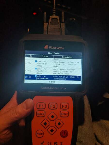

The fuel gauge is twitching around a bit so I suspect something is up. Presumably the steppers just need resoldering rather than replacing? Screen has lines but it's not actually bad enough to be too much of a problem tbh. At least not a priority.
I need to get some petrol asap which should get things up to temperature. Then I can read the live data and see if it gets to 90c+.
Fixed the remote central locking by replacing the batteries and resyncing the fobs. Ignition lock isn't the best. Doesn't always clunk off, so leaving things alive. Likewise the battery seems a bit weak. I'll see what spare batteries I've got that I can persuade to fit.
Naturally a 19yr old Audi has stored codes. They all cleared apart from the alarm siren error. I'm not bothered about that really as I rather not have the car siren going off during the middle of the night.
Engine codes are ones I need to watch to see if they come back. Maybe it needs a (commonly failing) Diverter Valve. Not sure how hard these are to get to, but it wasn't terrible on my 2.0TFSi MK2 I had. Rich mixture maybe if the thermostat isn't allowing the engine up to temperature.
Unfortunately the clusters in them are a bit more complex and finicky than the Ford ones so I don't touch them, we always send them away. I usually do the Ford ones myself if customer is on a budget as they're straightforward. But when sent away they see to and rebuild everything as long as it's one of the reputable companies. One of our customers sent his away for the LCD to be done cheaply but that meant the rest was ignored and then the stepper motors and immobiliser element went wrong so it had to be rebuilt again.
As far as I know the stepper motors aren't soldered in, they just clip in and they go faulty eventually so need to be changed.
Rebuild prices depend on the issues I think, unfortunately you've got all 3 there - stepper motors, immobiliser and LCD.
The P1570 will almost certainly be related to the dash. I've seen them time and time again, they'll just randomly refuse to start, if you come back a few hours later sometimes they'll then be a ok for a little while or even months.
ECU testing charge £170 + shipping + vat so around £230 all in but they allegedly see to everything.
Probably not the news you want to hear unfortunately having just bought it but it's not really ruinously expensive nor particularly major.
Just a word of caution - take the fuel reading with a pinch of salt and probably carry a can around until you know how accurate it is. They tend to either over read or go dead which is not ideal for fuel! Although the temp gauge could be under reading so it's not impossible for them to go faulty and under read instead
The initial price of £120 I was getting mixed up with the Ford ones having had a quick look.
Alarm codes are probably an issue with a switch or sensor somewhere so someone has just unplugged it. Not a biggie!
I'd agree with what you say about the engine codes as well.
Edit just to add - before condemning the diverter valve make sure all the vacuum lines are ok. They're an absolute bastard for deteriorating on the 1.8T and it's usually worth doing all of them in one go. Any actual loss of performance? Although I suppose that's hard to tell when you've only just bought it. A smoke test would be the quickest way. The fact you've got the rich code could also suggest it's overcompensating due to an induction or boost leak.
It's fine, I'll probably have a go at fixing it myself. Probably just some duff solder joints on most of it. Displays aren't expensive but they're a minor fault. Steppers should be easy to do. I reckon probably just solder joints or broken wires too.
I don't think it over reads as just put 20litres in and it's still under half way. This time I put super in to see if it makes any difference. Longer term it'll only be getting 95 though.
if the gauge is twitching (and it's a stepper) it won't be the stepper motor, it will just be the solder joints from the PCB to the loom connector, it usually is - putting a tiny pin through a cheap PCB with lead free solder and a load of wires hanging off it to wobble it about is an absolute recipe for cracked joints.
I've not done that particular cluster but I've had some similar era TT ones in and they had  moving coil motors for the fuel and temp (from memory) so it could be baggy joints to the motors, but if it is one of those, it's a right pain to get the needles back on in the correct place.
Steppers are easy.
The LCDs are £8 from china and absolutely "OK". Not bad to solder on but make sure you have leaded solder, flux and some solder wick.
Steppers are easy.
Doh 🤦 yeah - solder joints on the main loom connector!
