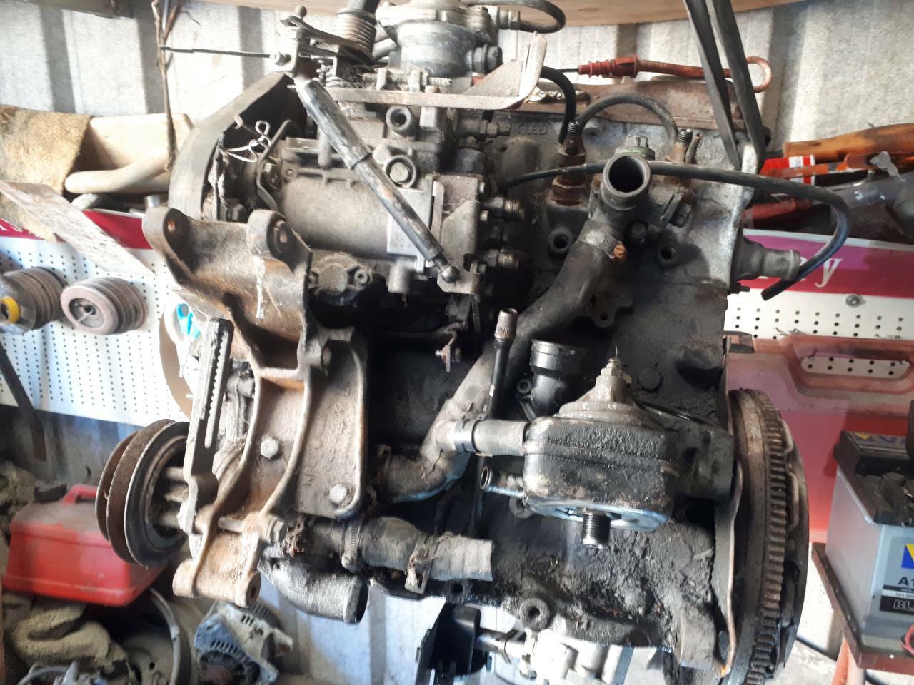

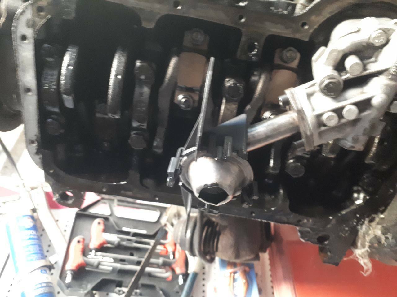

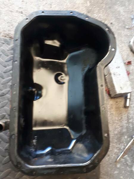

This was a engine that came with a scrap Mk2 Golf I bought a while back for spares.
It came with three diesel engines,two 1.9 turbodiesel that were scrap unfortunately, and this 1.6 turbodiesel, even though it had been left outside I managed to turn it over with a prybar on the ring gear.
I stuck it in the shed and said I'll try and get it going someday.
A few weeks ago I decided to have a tinker with it,drained the lumpy oil and a few litres of water out of the sump.
Dropped the sump and the bottom end was surprisingly clean,the same under the rocker cover,was expecting it to be choked up with the black death.
The oil pump was seized from being filled with water as the oil filter housing was missing,but one from the 1.9 block wasn't and fitted a treat.

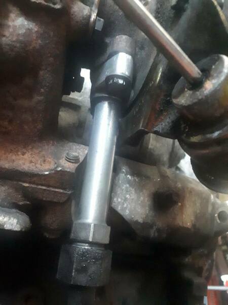

Next was to sort out an oil feed pipe to the turbo,the 1.9 oil filter housing won't bolt to the 1.6 block,so I tapped out a 1.8 petrol housing to fit the oil feed banjo bolt into it.
Next,the 1.6 turbo was seized solid,but the 1.9 wasn't,plus the exhaust I have wouldn't suit the 1.6 only the 1.9,so decided to see if I could bolt the 1.9 turbo and manifold to the 1.6 head.
It went straight on,but the oil return pipe was different.

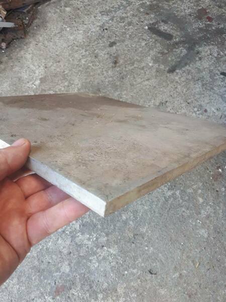

Some thick aluminium plate.

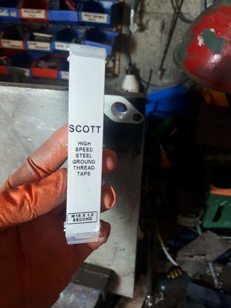

Mark out the shape needed.
Drill and tap.
Now,I could use the 1.6 oil return pipe on the 1.9 turbo.
Had to remove a wee bit of material from the manifold to clear the pipe,but only a minimal amount.
Lots of other small jobs were needed,such as swap over the clutch and pressure plate as the one on the 1.6 wouldn't suit my gearbox,checking the timing and just generally getting it ready to try and fire it up.
Today was the day.....Will it run or had I wasted a load of hours and effort on a no hoper piece of scrap??
Lots of tinkering,bleading,checking,bleading,twatting the lazy starter,bleading,heating the glow plugs,flattening the batteries later.......
The fucker only fired up!!
:mrgreen:
Didn't run it for too long as no water and an oil leak but it runs.
Chuffed.
Plan is to build it into an rough old Mk 2 GTI 3 door  shell I have knocking about.

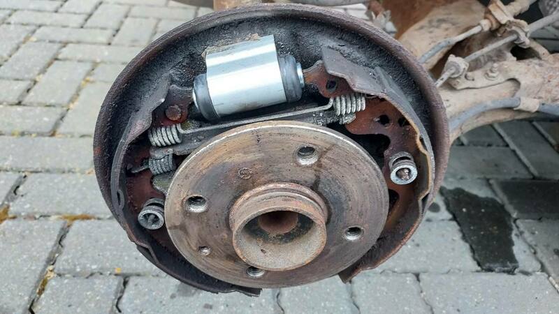

19 hours ago, wuvvum said:
Guess who will be fitting a new front to rear brake pipe on their 107 this weekend for that exact reason?
My 2011 107 had all new brake lines two years ago just before I bought it. Another common foible then.

Thanks,I really wasn't sure it would run.
It took ages to get it turning over freely with a ratchet on the crankshaft,but plenty of ATF down the bores got it turning smoothly,then I figured I had a chance.

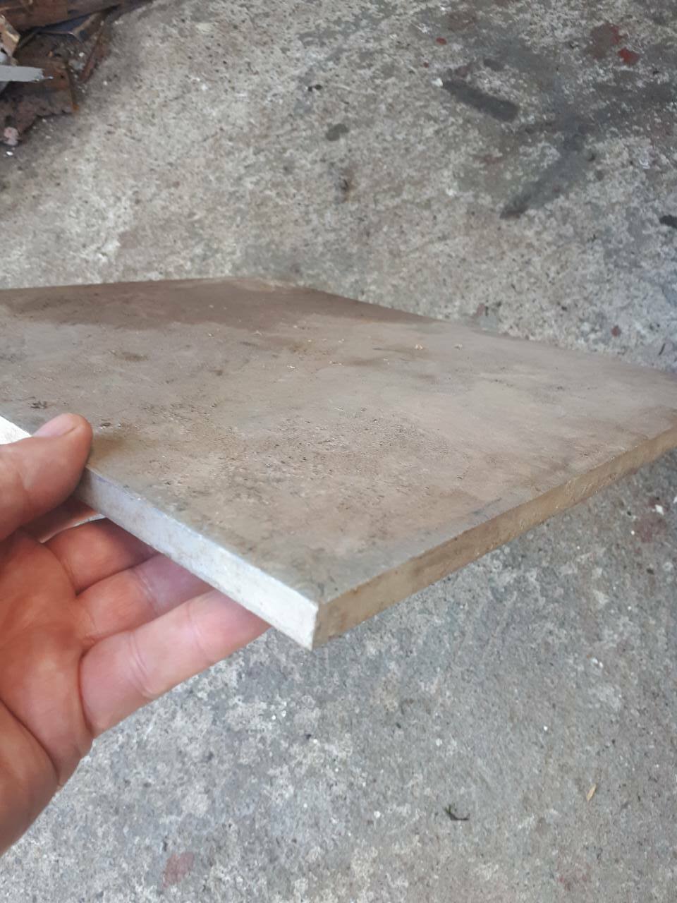

More Saab weldage. This was the most complex bit (OSF wing/inner wing) where multiple panels meet, and there are curves and swage lines to deal with.
Inner wing first, chop chop
20220520_110043
Luckily I made a template of the shape before it fell apart. Joggled and a return formed for the trim to grip onto
20220520_121136
Then cut out the bottom of the wing including the lip it welds to as it was rotten, so had to form a new one, this looking from underneath
20220520_135006
And looking down from under the bonnet
20220520_135025
It may not be clear what I've done here but there's now another plate behind the inner wing repair so it's double skinned, this is actually to form the wheelarch lip but thought I might as well go right up to my cut
20220520_144802
Next I made this guy
20220520_160043
Which is now the bottom of the wing
20220520_162324
Typically as I was welding this I ran out of gas, just a small panel to make the rest of the lower wing and I'll be finished. Lip is there to weld this section to

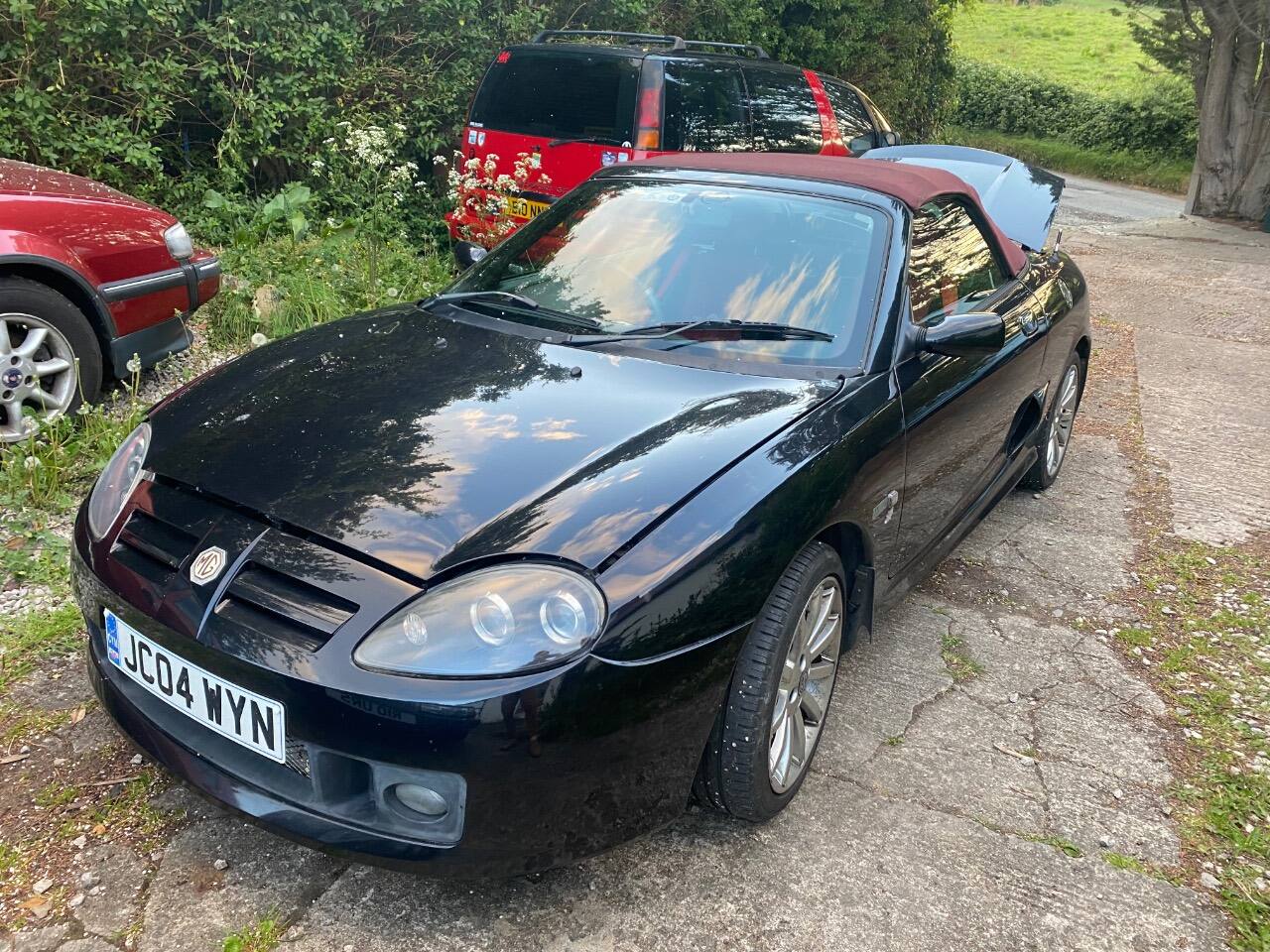

MoT on the MG is due beginning of next month, drove past the MoT place on my way home from work to pop in and see the chap who does them and asked how busy he was. Got a few spaces tomorrow was his reply, as he was backing a Rover 45 off his ramp.
So I foolishly booked it in tomorrow. It was pissing with rain which unveils issue one. The wiper linkeage balljoint has popped off, and only the drivers wiper works. That’s a fail.
The kids are in bed, so Come on then let’s be aving you…
Its somewhere behind that lot, but a temporary fix has clearly been rigged and failed before. It’s not my first rodeo with temporary fixes for broken wiper ball joints, so and elaborate system of zip ties later and my repair should hold for a couple of weeks so I can get the bits. To be honest as long as it holds through the MoT that’s fine with me!
Next guaranteed fail is that the passenger door doesn’t operate from the inside, thankfully that’s just a case of fiddling with the handle and tightening everything up.
So that’s the two simple fails done, can’t see anything else obvious. Which means it’ll fail ok something major no doubt! It’s only done 1700 miles ish since the last mot… so hopefully it goes ok!

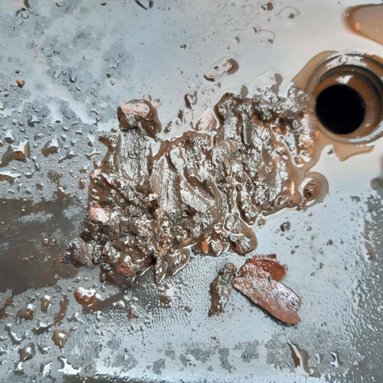

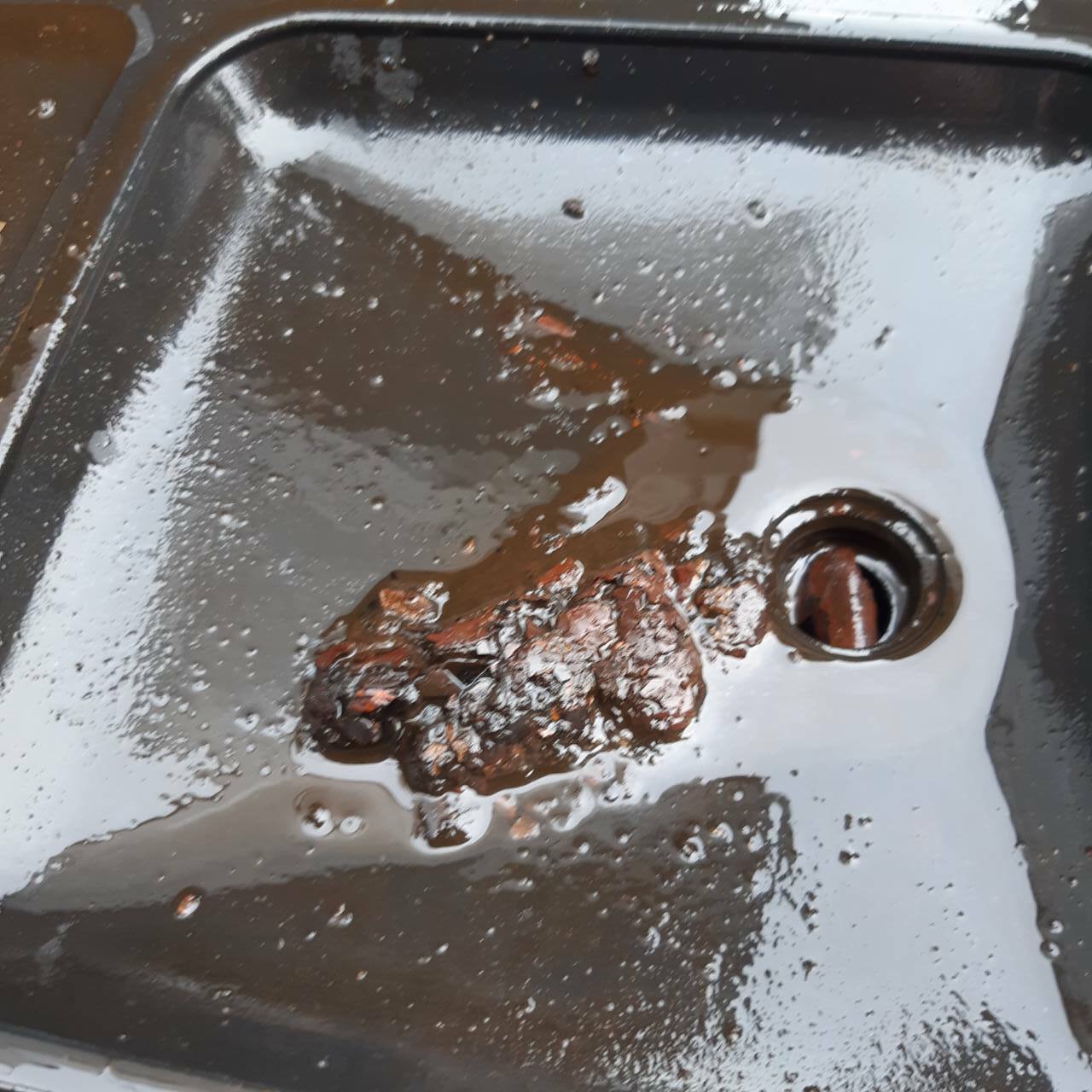

This came out when I drained the coolant on the Zetor tractor I am working on. Has anyone experienced anything worse?
