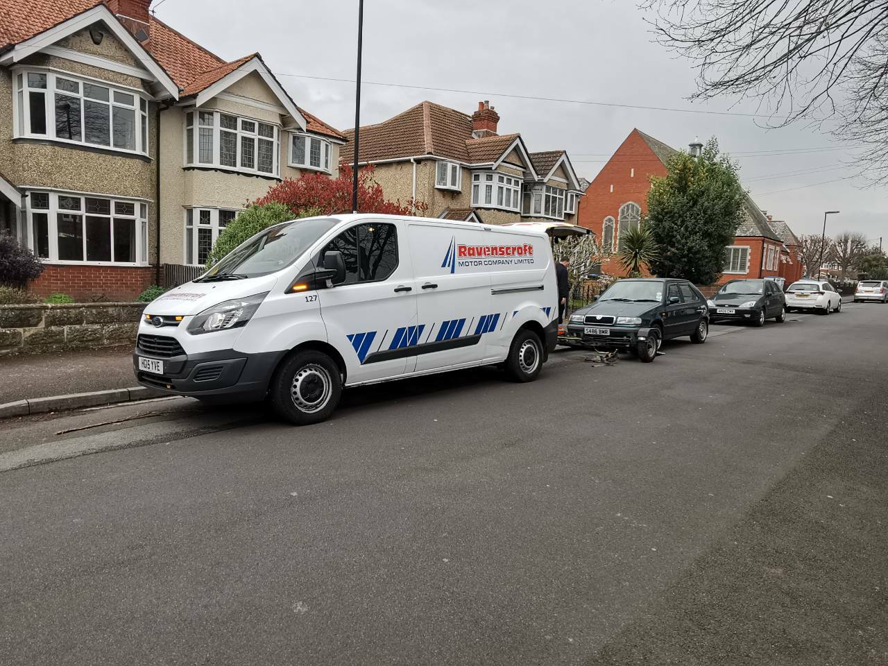

14 hours ago, Yoss said:
Ironically, at least I think it's ironic, it's a very misunderstood word, no more than 16 hours after Favorit passed its test Felicia FTP'd.
Mrs Yoss left for work at 6.30 this morning. It's my day off but I still like to take the dog for an early walk, but not quite that early but ten minutes later the phone rings. Felicia has just died three quarters of the way to work. It turns over but no signs of life. So I jump up and in to Favorit. By the time I arrive a passer by has helped Lorraine push it in to a parking space, fortunately it's one of the few areas en route that has unrestricted parking.
So I dropped her off at work and decided it was too early so went home again, it's only about two miles away. Went back and had a look mid morning. Cheap code reader says no. I suspect lack of spark. Can't do any thing here but can't phone breakdown services as I said I'd pick Lorraine up when she'd finished and you never know how long these things take so I went home again.
Then spent some time tidying the garage up as it was obvious I was going to have to get the Triumph out.
Called breakdown after lunch. They took about an hour which isn't too bad these days and he came to the same conclusion as me so we A framed it home. Actually it's more of a T frame.
IMG_20220329_162335_edit_863860921215058.thumb.jpg.6b87438a564a43adf3595abbd4454671.jpg
Once I got it home I have confirmed there is no spark. The rotor arm and dizzy cap don't look great but I wouldn't have thought they would cause sudden and immediate FTP. My guess would be the coil. I've already had to replace that once, about seven years ago, but it's kind of expected these days that replacement parts are shit and never last as long as the originals.
Anybody have any other ideas of what causes sudden loss of spark? Is there anything obvious I'm overlooking.
