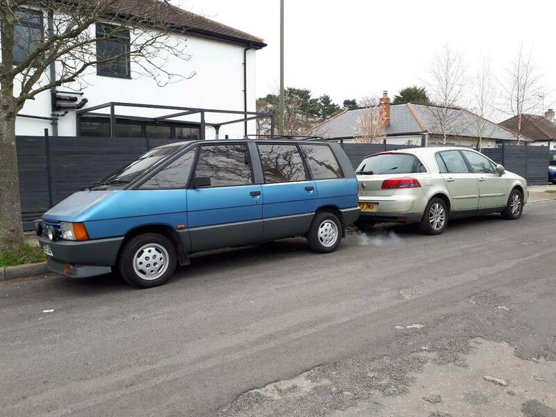

The above comment is academic now as this morning it decided to self-immolate.  Electrical fire whilst parked up.
Source of it was the boot, and I can only assume some wiring in the leccy handbrake or something else set it off.  Very strange and it was fine last night when I drove past it in the Xedos.  No one was hurt and no other vehicles involved, so that's something.  Off it goes on Friday for scrap as it's completely fucked.  Glad I haven't got any insurance shite to deal with.

Sad times! That looks roughly like the handbrake module. It'll be one of the few things still powered on with the ignition off, so plausible. Also full of grease, so a stalled/failed motor from a relay that is stuck on I guess could get hot, grease leak in and then a spark from the motor turning ignite it.

Mental is the word. Just glad it didn't happen two weeks ago whilst in Normandy.  So I consider myself lucky.

Initially I thought it was one of 13 ECUs these things probably have, but never mind.  Back to running older stuff until the outer London ULEZ forces me to buy newer or run a W123 or something as a daily.

The handbrake module is an ECU in its own right to be fair!

Indeed, it had a decent innings and what a way to go.  16 previous owners on the V5, and I'd guess 13 of those are shiters.
Scrap man has offered me £500 for it.  Unbelievable.
