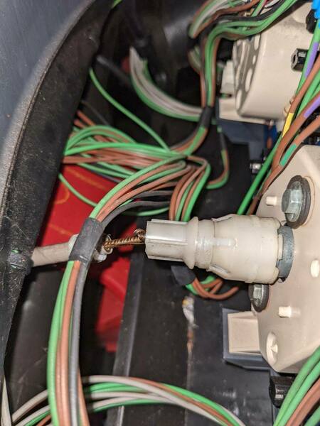

If it's the same as the Mk I there are two cables - one that comes up from the gearbox and a coupler just on the engine side of the bulkhead, so the bit you need to thread through is only about a foot long.
Of course the bit that's snapped on mine is at the gearbox end, which disappears down the back of the engine, connecting to the gearbox somewhere I can't even find by touch, never mind see.
Both marks use two piece systems, but the mk.1 cable is different to the mk.2 apparently. Chevronics differentiates between the two at least.

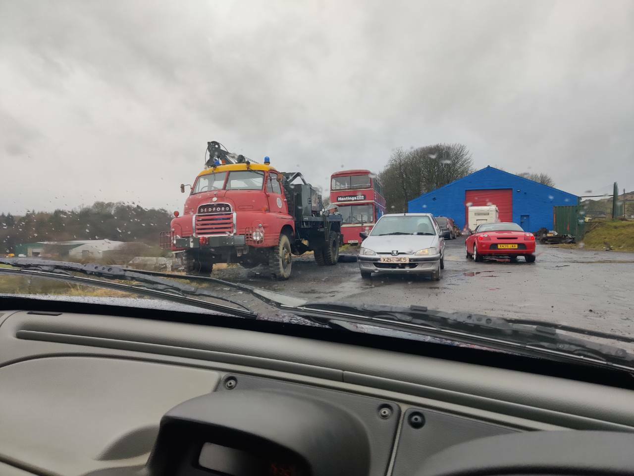

How much shite can you get at one unit?IMG_20220223_155233.thumb.jpg.ce52554152daf33bf2962878e7085dad.jpgIMG-20220223-WA0013.thumb.jpeg.ebd6990b3448bb1e1ba7fda2c461fbaa.jpeg
Is that an Atlantean or a Fleetline?
Taken from @Split_Pin on the old WhatsApp.
"I can't see the plate well but it looks like a PUA-W registered Roe Bodied Atlantean that would have started life with South Yorkshire PTE."

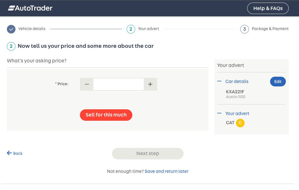

I sadly cant help much for accident claims and HPI stuff
my focus is the DVLA and what data I can get out of it for Invacar research :) (so stuff like keeper changes, registration mark changes, any scrapped markers, chassis numbers and engine numbers etc!)
stuff like accident damage etc would be recorded outside the DVLA (apart from any insurance markers, but my fancy tool does not spit those out)
but you can find those if you start to make an advert on Auto trader when you shove the reg in, it will tell you if it has any insurance category markers against it :)

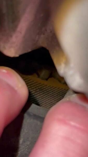

The warning triangle cover in the boot is broken and rattles around. As usual with this age VAG, it's full of crap thin plastic. In this case it's snapped off and no easy way to fix. Perfect time for a reusable cable tie.
Next up was the glovebox. The lid falls off when you open it. Hinge is broken - TADIS. Removal of the glovebox was 5x 8mm bolts.
The hinge breaks because the soft close damper siezes up and puts too much load on the hinge+lid. Of course the design being too weak is another shit point too.
I paid twice the price for the "better" repair kit. Tbh I can't see it was much better than cheaper kits and won't bother again.
Hinges came out by knocking these pins out.
Bodge kit is essentially a bent bit of metal that you screw self tappers into the plastic underneath.
The internet suggests making a hole in the back to put lube down.
I then took it apart to see how it worked. Basically it's a tube with a seal in. At this point I realised making a hole in it is stupid as it looses the damping effect. Oh well, at least it won't break again.
I stuck lube down it anyway and put it all back together.
Glove box then just pops back in. Interesting to note how easy it is to access most of the blend flap arms. On many cars are a nightmare.

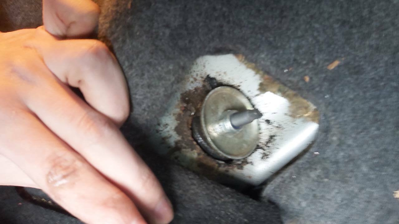

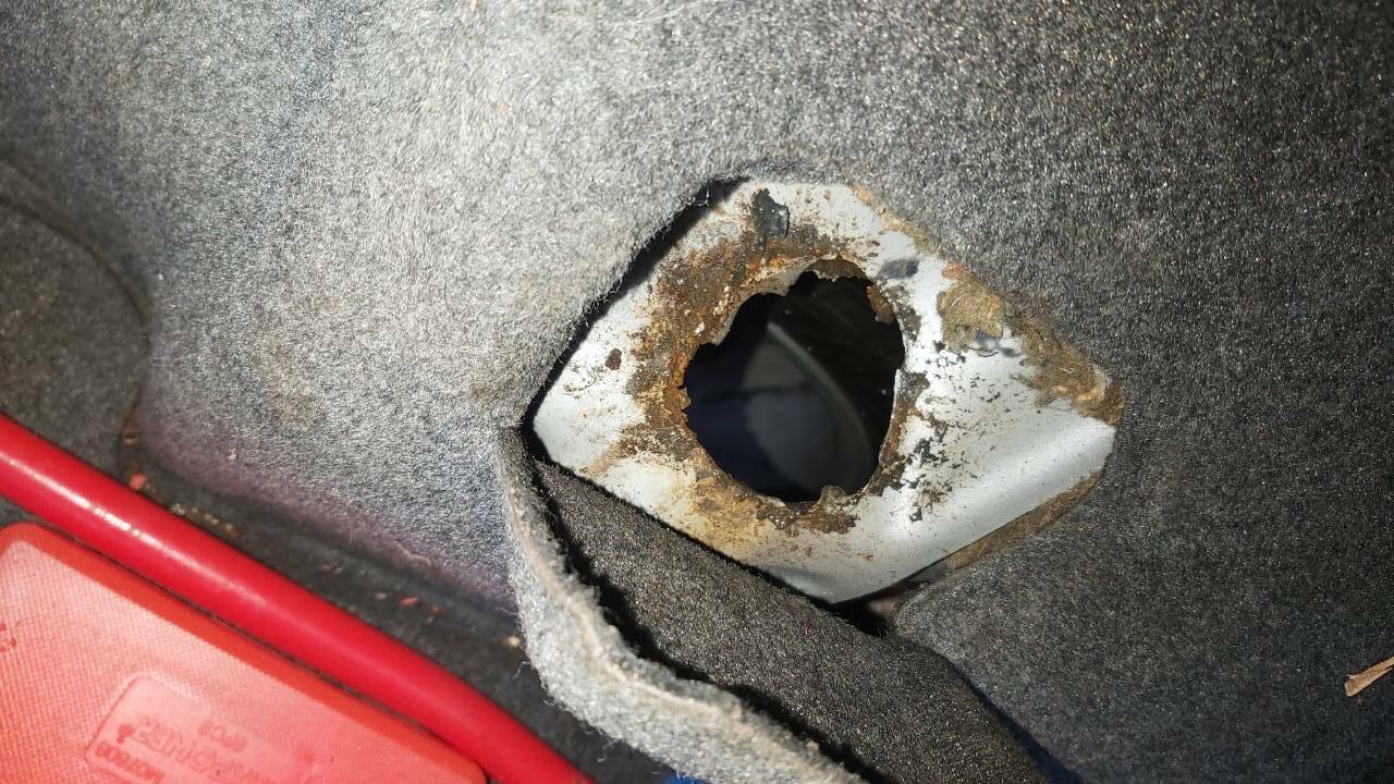

The rusty shock mount on my Saab appears to have lost its rust, removed the shock to stop it doing more damage and bounced my way home :(
despair1.thumb.jpg.05eabb06bea85448f0e91810d0325538.jpgdespair2.thumb.jpg.aeb131adb2b598302285136e03b0d5c6.jpg
