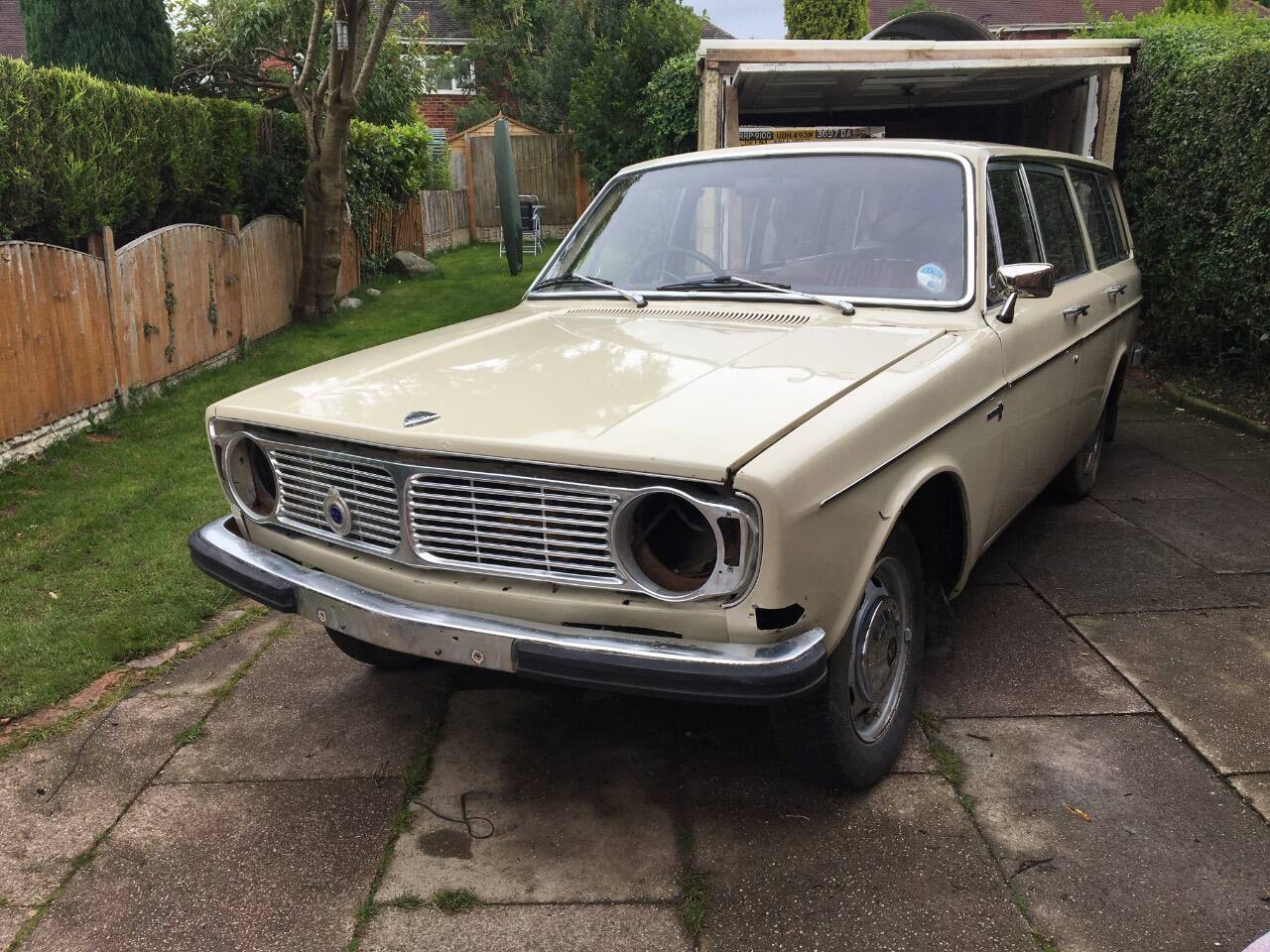

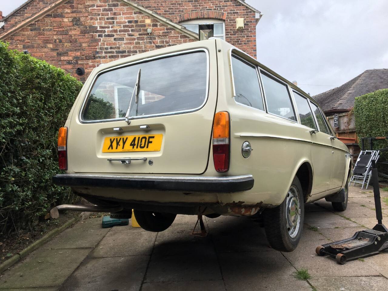

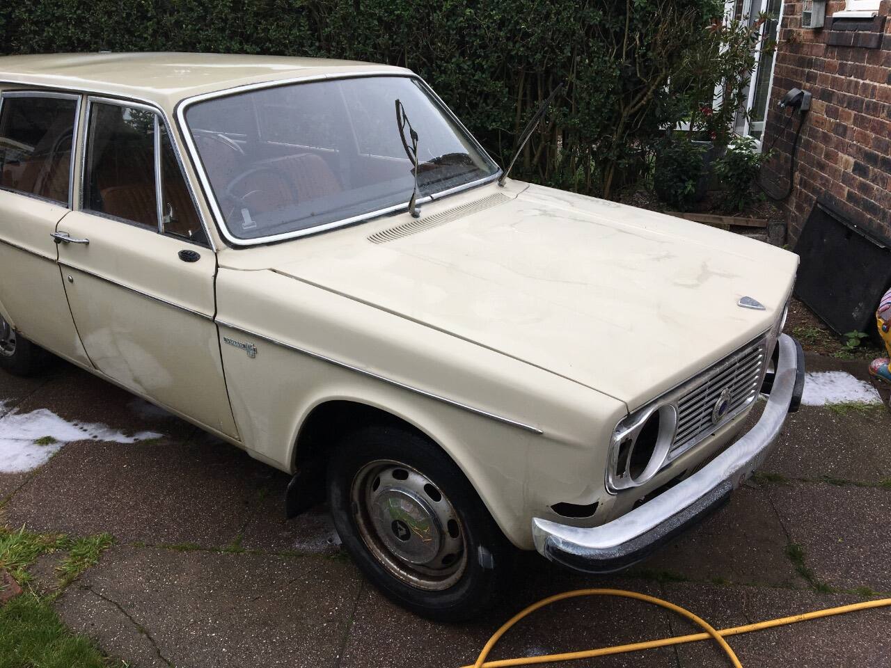

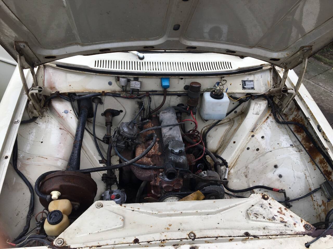

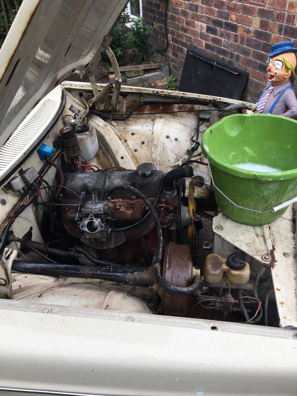

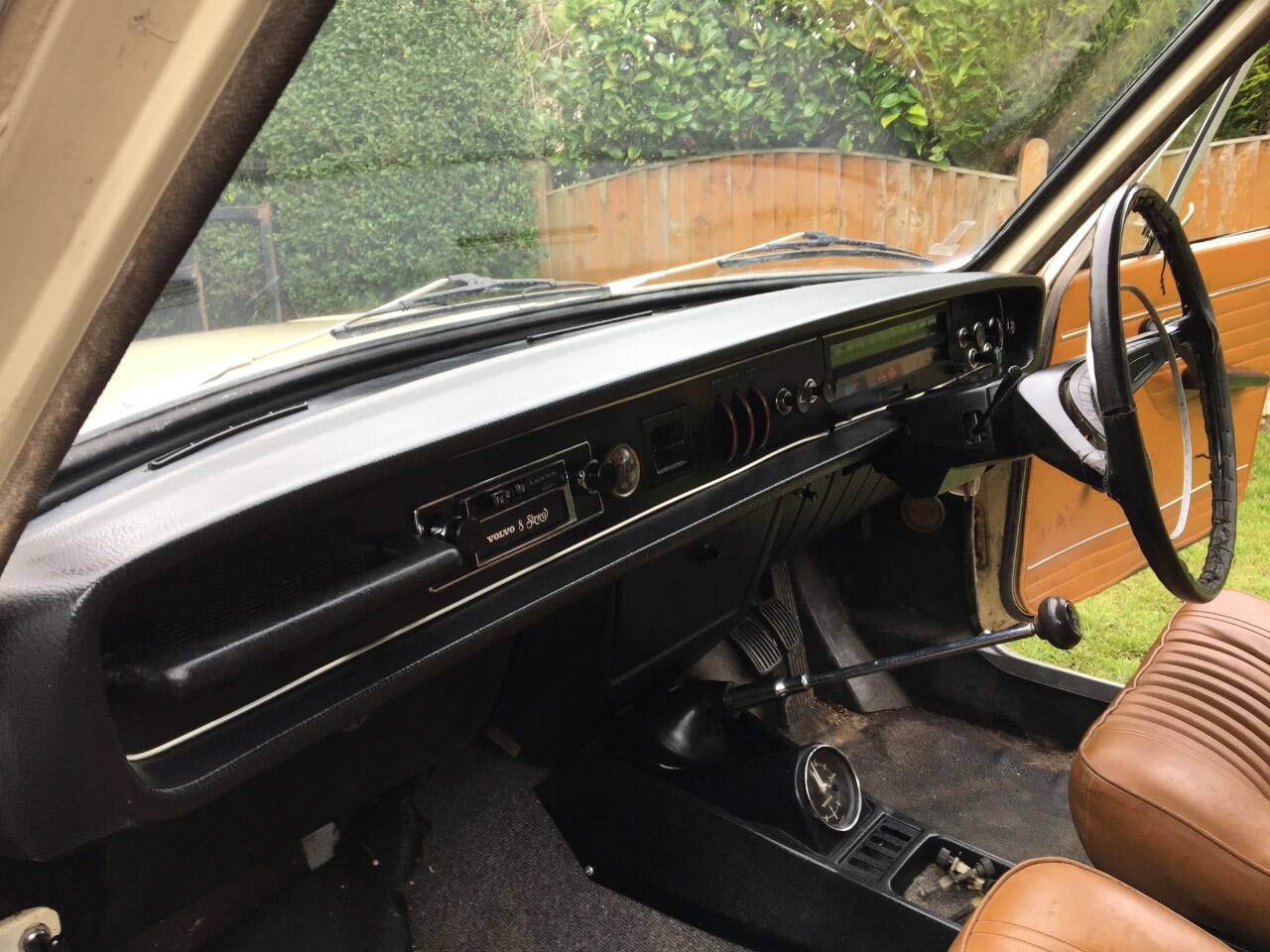

After seeing XBOLLOXs efforts polishing his aircraft carrier I was inspired to use some G3 on my Volvo.
Its had a semi OK blow over at some point and it’s hard to get a decent shine but it does look loads better, I can really picture myself cruising around in it now.  I gave the dusty engine bay a wash and used some “Cherry sheen” on the dash.
Quite rewarding and made me forget about the fuck-ton of welding the body needs. The shiny roof now shows off the dents made by the POs kids walking on it that won’t quite pop out, maybe I need a sink plunger on it.
I've found the washer pump had karked it so after digging around in the garage I found an Allegro item. The Volvo pump is built into the washer reservoir cap and after removing it I found the allegro's mounting holes lined up perfectly with the existing holes in the cap, a couple of rivets and the screen jets were back in business!
Talking of Allegro bits, the TEX wing mirrors appear to be typical BL generic items, obv the wanky bases these use have deformed so one mirror won't stay on and the other is easily knocked off. I find these soon die a death once you start messing with them so I might try and find some proper Volvo ones.

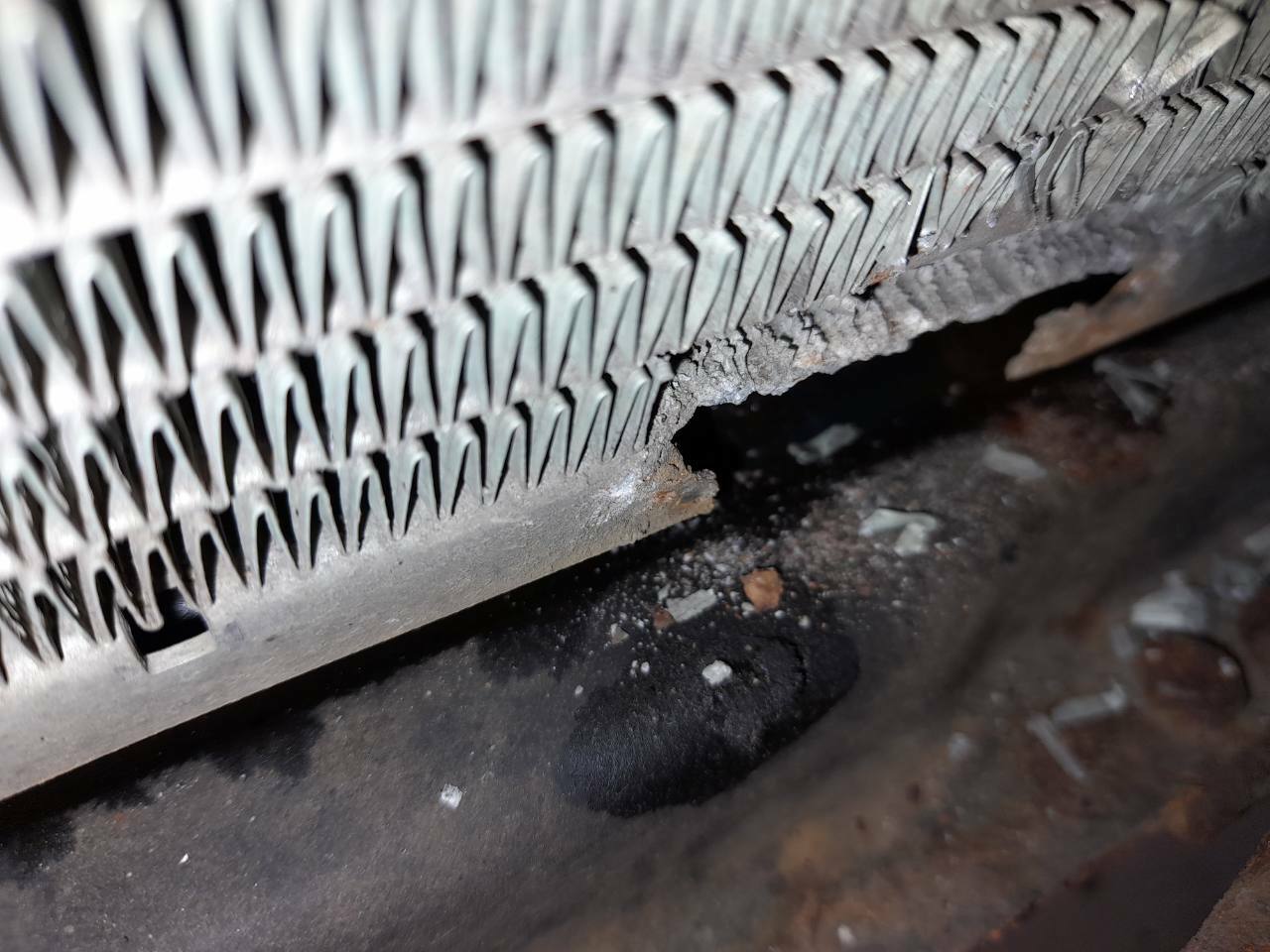

I took it for a blast up and down the M876 as it was overheating only on long motorway inclines ad 70-75mph, as if the cooling system couldn't keep up. The temperature barely moved off the 90 degree mark the whole way. It was definitely the radiator. The big hole you see here:
was actually the bottom flange where the fan mounts but it was so corroded it had snapped off. I ran some water through the old radiator just to see and it came out the bottom port pretty slowly so it was clearly corroded up inside.
MOT is less than a month so I'm glad overall this has been a very inexpensive fix.

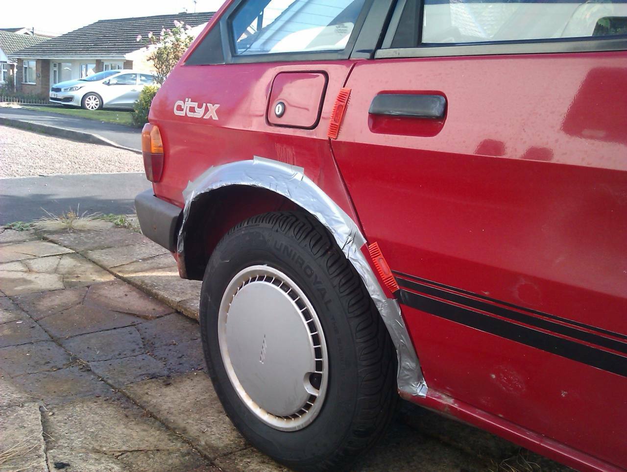

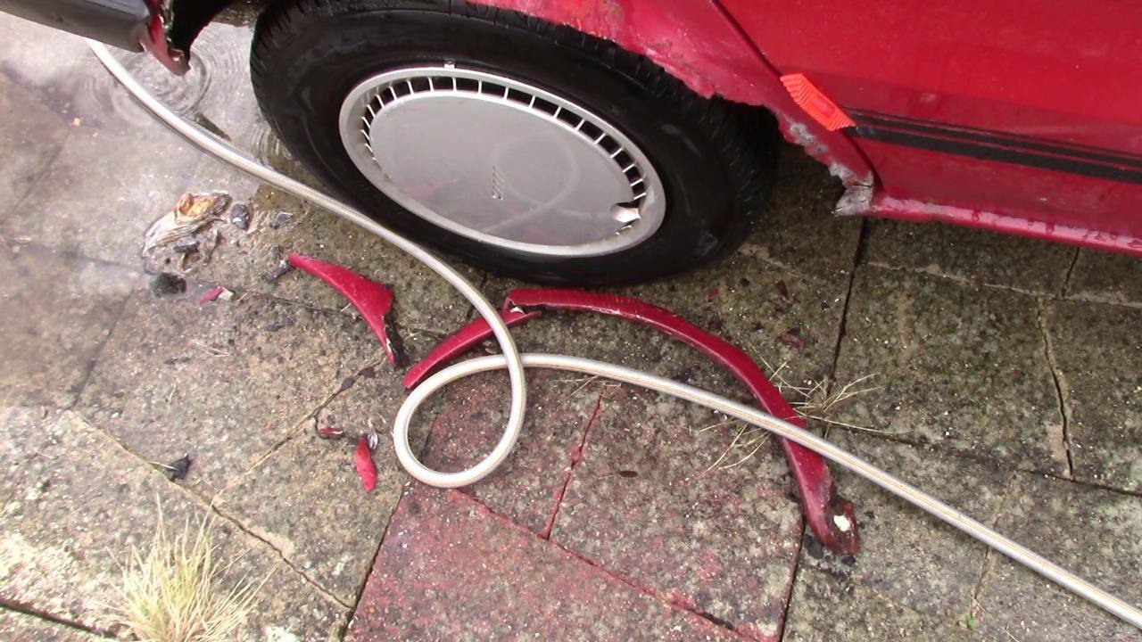

Welding gas and grinder is arriving this week, so it's typical the arch fell off today.  Passenger side is making a bid for freedom too but still has just enough structure left to keep it on.
Back when that used to happen more regularly they'd call that the repair
I'm only disappointed I didn't have red duct tape so I could have done it professionally :P

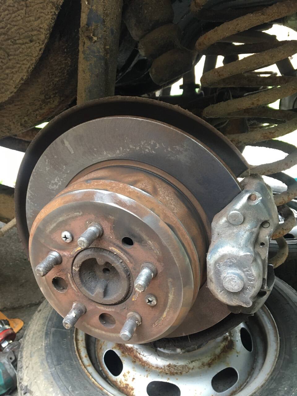

More Voleing today with some action on the brakes. I jacked the rear up, put it on stands and removed the wheels, hoping to get the calipers off for a good clean up. Unfortunately I couldn’t get the bolts out so I had to settle with removing the pads and giving those a bit of attention. The callipers appear to be reasonably new, the pistons slide in and out nicely and are very shiny, possibly stainless- either way I was pretty pleased as I was expecting them to both be seized and in need of a rebuild.
These have slightly weird double split circuit brakes witch are a total mare to bleed, especially from an empty system. I did my best to get the air out but totallY failed on the first attempt. I think it needs to be pressure bled, I did have a GUNSONS EASY BLEED but I think I binned it after a brake fluid explosion while attempting to bleed the brakes on a Morris Oxford years ago. It’s a job for another day I think.
The handbrake works fine so all that was left was to tidy up the rust on the discs as best I could with a wire brush.

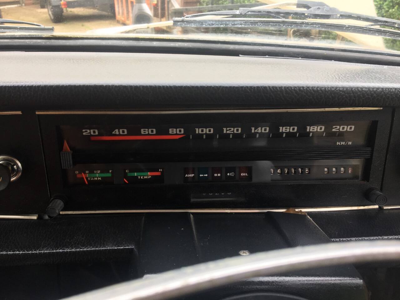

OBV with the back end in the air I fired it up, stuck it in gear and went for a “drive” It’s the first time I’ve seen the strip speedo in action and it looks amazing!

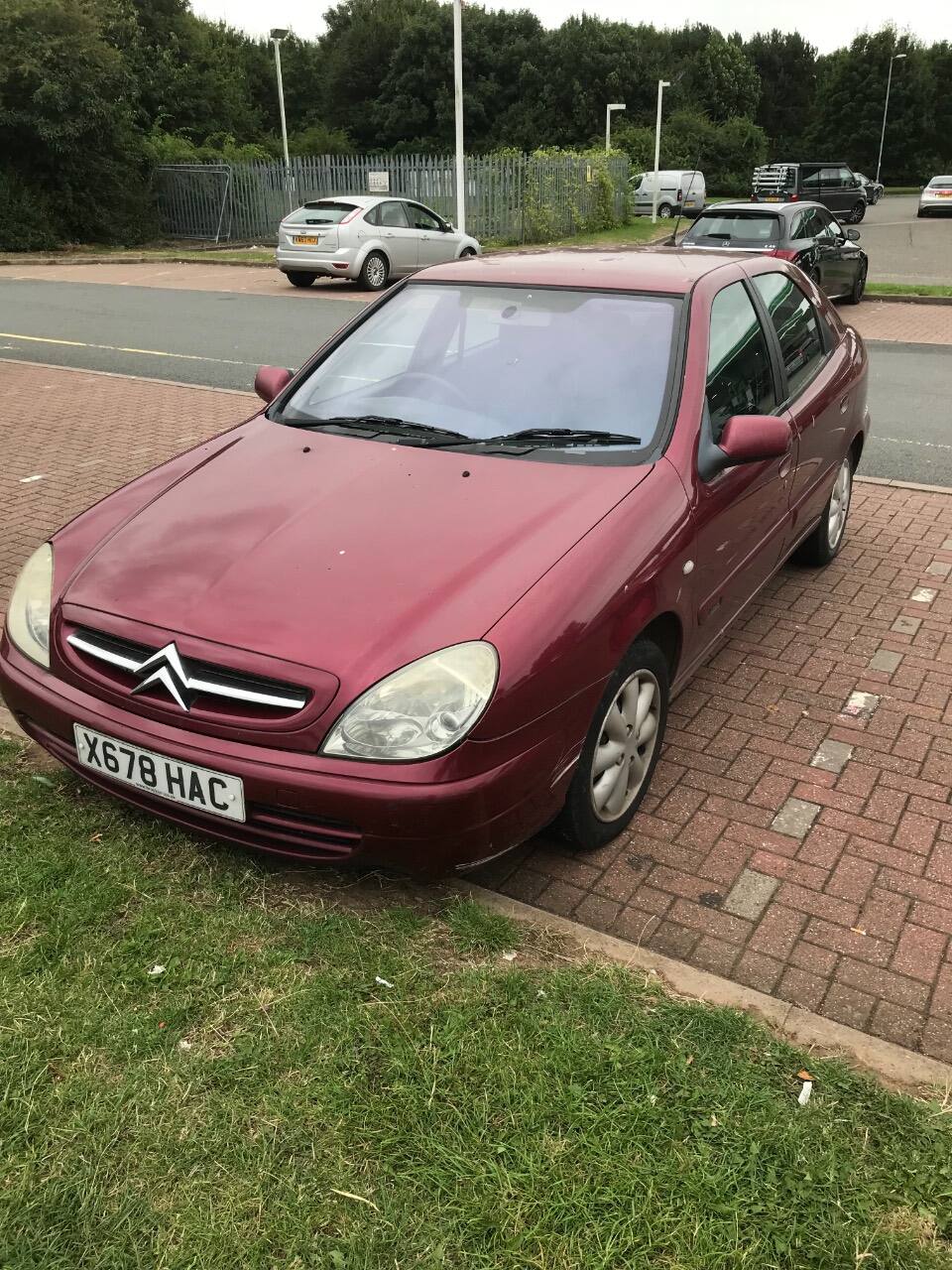

Thank you @Scruffy Bodger . Xsara is now delivered to the giffer!  No pez shot because I forgot.  The reason?
Phwoar.
Took one at Warwick though.
12/10 would shite again.
Phwoar.
What a beautiful car!
(biased but no one else will say it... You've got to own one to know 😉
