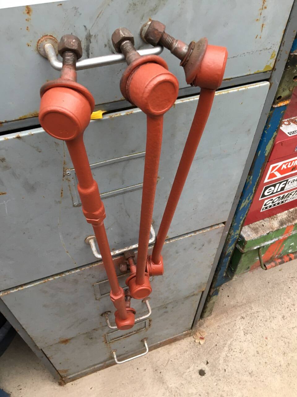

I’m working towards getting my Volvo 145 steering serviceable and today had lots of fun using a knotwheel in my grinder to remove scale (scale sounds better than rust) from the spindles and steering arms before treating them to red oxide primer and Hammerite top coat. I was going to buy a tin of black Hammerite but after seeing the price I dug around in the garage and found dark green, which will do the job nicely. All the ball joint rubber covers are split and need replacement, I’ve never replaced them before, is there a place that sells them separately?

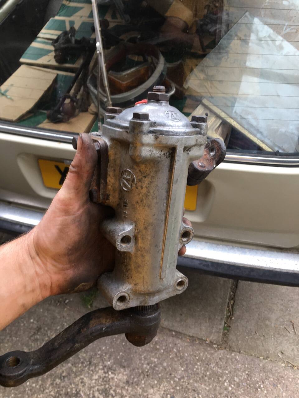

Moving on, the broken bolts that were seized into the donor steering box were finally removed with heat and sheer brute force and after a cleanup it’s ready to fit. There’s virtually no wear in the box but while ducking about with it I messed the adjustment up meaning it now needs to be  properly set again. I’ve watched a few YouTube videos and it seems pretty straightforward. I could just swap the pitman arm over the box that I already have fitted but it looks like a massive ball ache so I’m planning on just swapping the whole steering box over.

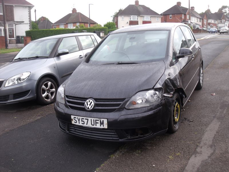

Someone's left me an accident damaged Golf Plus.  Unfortunately it's right across my driveway so the Rover and Saxo are blocked in. ☹️ Presumably the rest of the empty road was an unsuitable spot for its abandonment.image.png.52da4f2d7a6a170d50fc831e74096607.png
I suppose I should have gone out and found out what was going on during the two hours that someone was sitting in it but I thought they might have broken down and were waiting to be recovered. I've checked online and although it has an MOT the tax expired April 1st, which may be why it wasn't left on the road. Interestingly the last V5C was issued two days ago, a coincidence? I don't know anyone immature enough to dump a car across my driveway but who knows what goes on in the minds of men and it's certainly aroused my suspicions. 👿

Have you got a friend with a heavy vehicle like a hilux or other large (heavy) pickup or van?
I'd get it dragged just far enough so it's not blocking you in.

Unfortunately not. I'll see if anyone comes back for it tomorrow, if not I'll have to see about getting it moved.
I think I have a bag of them you're welcome to take what you need from? I can post them up to you and then send back what you don't use? I bought a bag of twenty or fifty or something about 5 years ago.
I'll check in the morning.
EDIT - yes I do still have them, PM me if you like and I'll post them up to you. its a bag of small, medium and large ball joint dust covers including retaining clips, there are probably 15 or so left in a mixture of sizes. Use what you need and send back what you dont.

To be honest I'd call the police.  An untaxed car blocking your access to the highway should be of interest.

If you're having trouble, cars with no numberplates disappear a lot faster, just let the local council know.

The mystery of the abandoned Golf appears to have been solved as the owner(?) has come round to ask if it'll be OK to leave it where it is until they can get a recovery truck, which is what they were trying to do yesterday. Apparently it was involved in an accident which damaged the wheel. suspension and, from the sound of it,  possibly the steering. Hopefully they'll be back to collect it later.

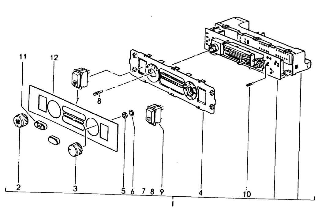

The rheostat - is that still a word? Appears to have packed up on the 944. The blower works, but only on speed 4. Porsche sent me this less than dynamic illustration, the bit I'd guess that I want appears not to be numbered, but second from the right. Does anyone know any more than me? The Parts Advisor told me that he'd never even sat in a 944...430503282_Screenshot2021-06-22at16_57_55.thumb.png.b4253b1eac7f2cd7d10d3a0d7101a9d3.png
Rheostat to me means variable resistor. The bit between nos 11 &3 looks like a knob, no offence. The rheostat will be electrickerly connected to the blower switch, possible in the housing on the far right. (Me only once, in a LHD with lurid black and white check seats IIRC)

Can't speak for the 944 but usually the setup with heater blowers is that the switch is indeed just a multi-pole switch.  The actual resistor (or resistors if there are more than two speeds available) are usually mounted elsewhere, commonly on or inside the blower housing.  Maximum speed usually works by completely bypassing the resistor network, so even if the resistor fails generally full speed will still work.  So given you've got off and 4, I'd tend to be looking at the resistor pack.
I'd be looking for a diagram of the blower housing and seeing if it's visible there.
EDIT: Just did a quick Google for photos of the blower housing...Without doing a more in-depth analysis and never having worked on one of these cars, this I would expect to be the resistor pack.
Edit to the edit:
Yep!  Linky...
A rheostat is a variable resistor, usually wirewound, to take a fairly high current.  But is your fan speed control a rotary switch?  If 2 is the knob for the fan speed, 8 would be the bulb that fits inside the knob. Follow the dotted line through the panel (with numbers for fan speed) onto the square thing with the spindle sticking out of it. That square thing would be the switch that connects to a resistor pack.  If one or more of those resistors goes open circuit,  the speed control goes wrong  except for the fastest speed.
Resistor pack:    https://www.ebay.co.uk/itm/162918455066

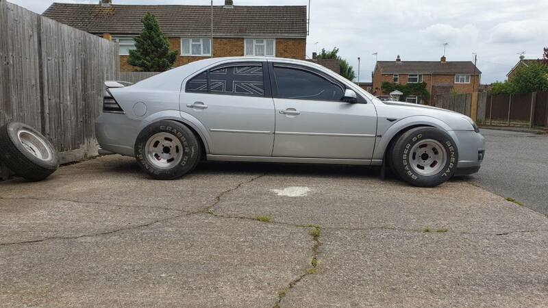

Been round deceased uncle in law place to check all ok, dodgy estate and decided I'd remove the dads weller wheels from bedroom,  shame I can't find the 4th... we belive its in garage.
