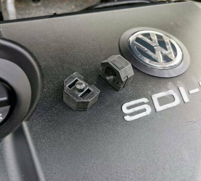

These are the top mounting blocks for the radiator.  Odd setup, but they locate into the top of the radiator and a bolt then runs down through the slam panel into the well on the top of the block, trapping the radiator.  It's all a bit odd and I imagine is designed with deformation in mind for crash safety.  The blocks in this case we're both long gone and the radiator was floating around held in only by the pipework.
With it properly mounted you can see how far it had dropped back.

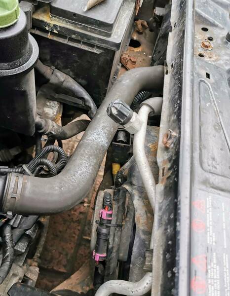

The top radiator hose was previously rubbing on the fan shroud.
Good couple of inches clearance now.
On the other side the shroud had cut a deep gouge into this air conditioning line.
Over an inch clearance there now too.
I'm not 100% convinced it's going to stay put so I'll need to keep an eye on it.  Whole setup just feels a bit flimsy to me.  Though I guess there is just an element of modern car design there,
This is how they sit once in place with the bolt tightened down.
Just looks like something is missing to me!

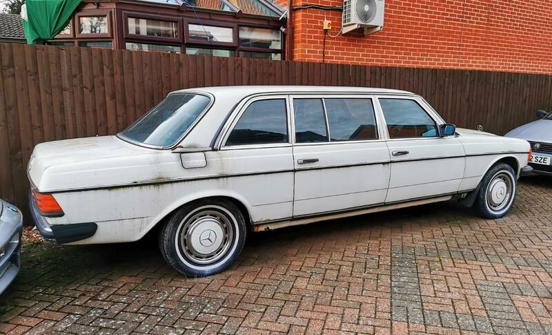

This afternoon I had arranged to take a look at that W123 limo for the owner.  I was offering nothing beyond an impartial and to my knowledge reasonable appraisal.
My initial reaction on pulling up was "Oh she's crusty."
Though after a bit of a walk round and a bit of a crawl around underneath I've realised she's far less of a lost cause than I initially thought.  Let's list the grot.

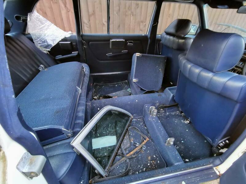

Yep.  The reason this car came off the road originally is that some bastards nicked it to break for parts.  The car was recovered before they got far through stripping anything, having only taken the seats apart in the back.  However they made a bloody mess getting into the steering lock.
They also smashed one of the limo specific windows.
Though as you can see, by some miracle the owner managed to get hold of a replacement.  If I don't do anything else I'll get that installed to get the car weatherproof again.
I think that film has actually been doing a good job of keeping the weather out as the upholstery is in fine shape and there was only a little bit of water in the footwell, no rust or mould which would point at long term damp issues.
While it's in bits all of the rear seating is there i think so just needs bolting back together.

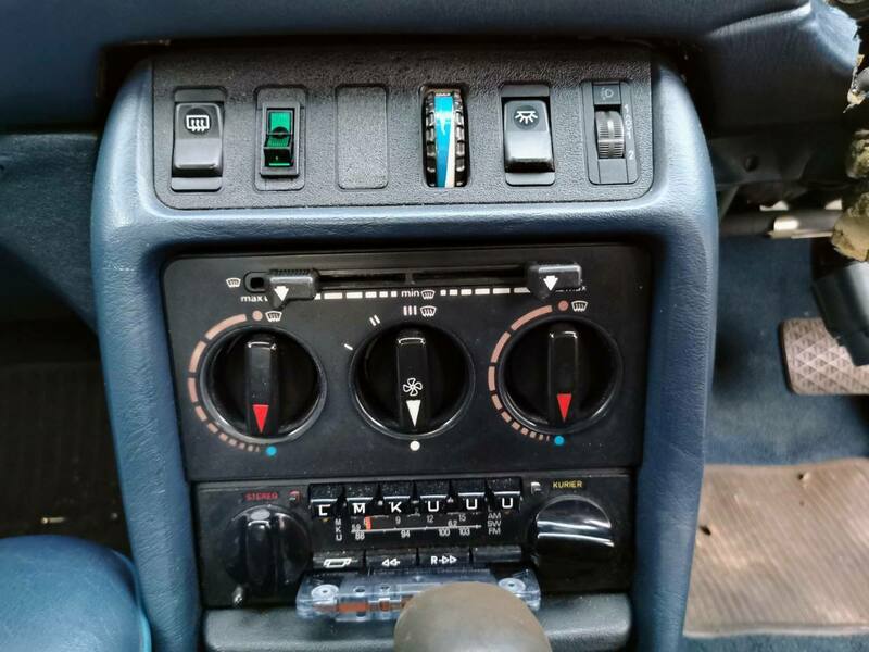

Yes, I want to know what the green switch does.
The air conditioning definitely still has gas in, though I'm sure it will need to be recharged - and I'll bet this is still running R22 (or maybe even R12!) so will need to be converted.  On the "plus" side, the dash needs to come out anyway...

That green switch wouldn't be an aircon switch? It looks like a foreign switch fitted into a hole blank, (like the one to its right.)  Perhaps to replace a broken switch.  It has a light in it. I cannot see an aircon switch with the heater controls. What is that blue "variable resistor" to the right?

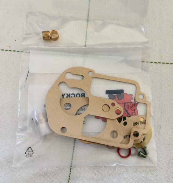

[] Carb overhaul kit: £50 #

That seems at least a couple of grand overpriced to me.  Especially as they even state in the and that it's been resprayed (so who knows what's hiding under there?) and has been used as a wedding car...why was it put away in 2009?  Also, black interior...seems more of a funeral wagon than wedding car.  It's been repainted white...is that a Mercedes shade?  If not good luck matching it if you need to touch anything in.  Seems to be a conspicuous absence of any halfway decent photos of either interior or exterior to me!  Who at that end of the market doesn't take two minutes to actually pull the car out through the open workshop door to get photos in daylight from more than two feet away.
I'm just immediately wary of anything that's been a wedding wagon as when I was helping at the hotel we saw a lot of them and they were some of the most shonky pieces of end-of-life crap you've ever seen.   Usually *looked* nice from ten feet, but you really didn't want to look any closer than that.
Don't know, I think the one I'm looking at seems a better bet given that while it needs work it's obvious it needs work and I didn't see any evidence of prior bodywork when I was looking at it.
What you have said makes perfect sense of course and is why I've not just jumped head first into it.  It's a very odd car.  There is a good old chunk of work needed and no small financial outlay too.
Rear seat layout is unusual, I'd just assumed the forward bench would be rear facing as that's much more common in limos.  So this is definitely intended to be an occasional seven seater.
Do I want it?  That is the big question isn't it.
Having a car behind it offended my eye so badly I had to remove it with Photoshop.
