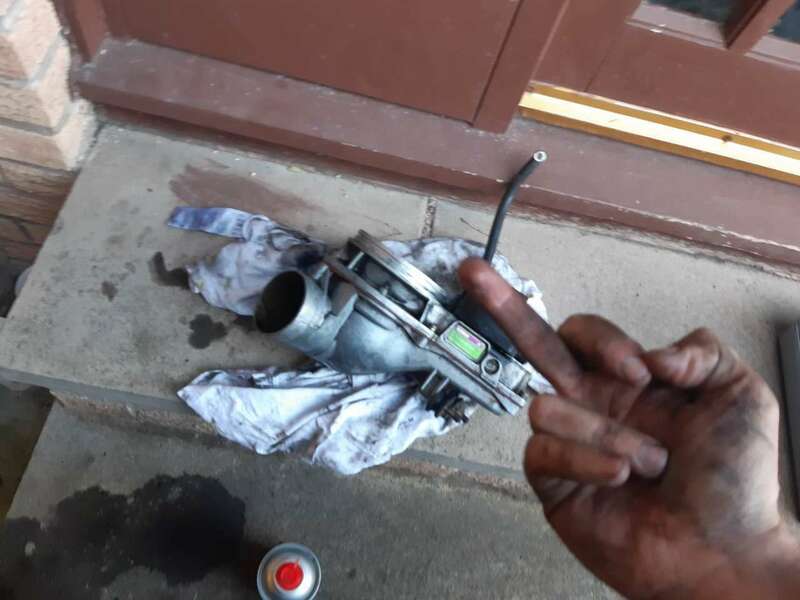

I cleaned it, pulled the flywheel off and cleaned the points. It generates enough electricity to zap me but not enough to spark. Feeler gauges were lost so I hastily reassembled to look at another day.
314911322_432010752479953_2130666472305039603_n.thumb.jpg.f68db81bac86b2fe2add74b8d1193e1e.jpg

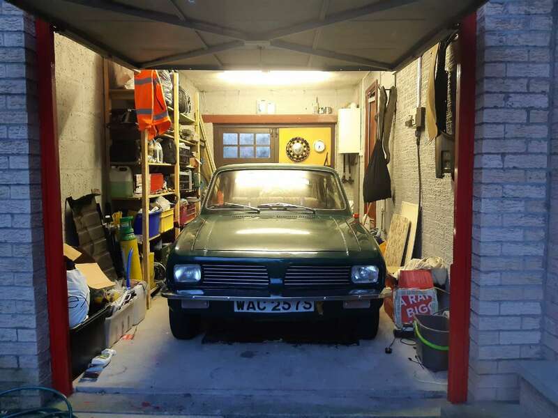

Most of my time lately has actually been spent prepping the garage as measuring suggested that the gap between the internal stairs and the shelving was 1cm wider than the Dolly...
312355885_1057798788108594_5817082541236081303_n.thumb.jpg.7a7e156fc3f0d32ad8eebe7340007c83.jpg
So it was removed.
312599186_1178505573024825_6191711408520225353_n.thumb.jpg.0e5d666b8d82d80348617d5b74adb2ff.jpg
The high value* contents carefully** stored in the back garden.
315175809_680705593488261_5354925300895475362_n.thumb.jpg.38296187af0707e428bd7984eaf39258.jpg

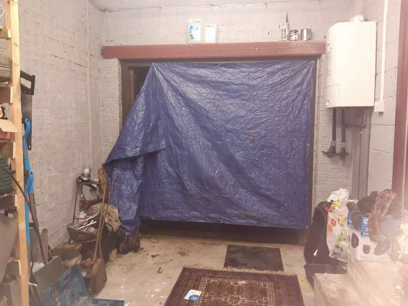

The shelves reduced in depth by half.
314420301_686422156075133_4486040983621621691_n.thumb.jpg.db857a07409bda481b46e0d3b8aa81e0.jpg
And reassembled.
315091661_1313170466116340_3391391592230746264_n.thumb.jpg.74592f59a167ab8a74ba9e0da0af0efc.jpg
Perfect.
315107106_455210896720386_3836397370775062713_n.thumb.jpg.bf97272bbc737d4ed15face4642b1085.jpg
I also tested the theory of putting the Dolly out the back to work on another car.
314527327_463267205684367_2120585827439026778_n.thumb.jpg.eba27c2da8f1a9bd460742704f0cf105.jpg
314786478_1142761519997516_4597167641901781286_n.thumb.jpg.86d5f12cd7c22a6bd27484bb01464d4e.jpg

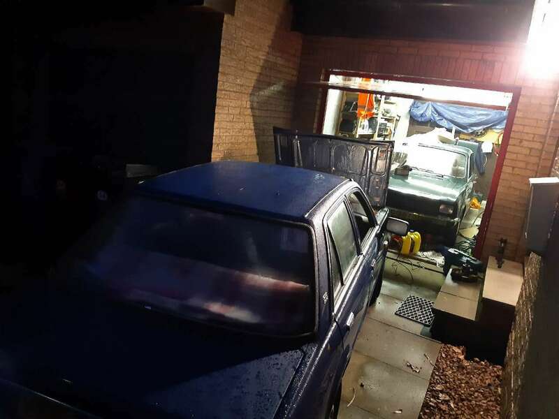

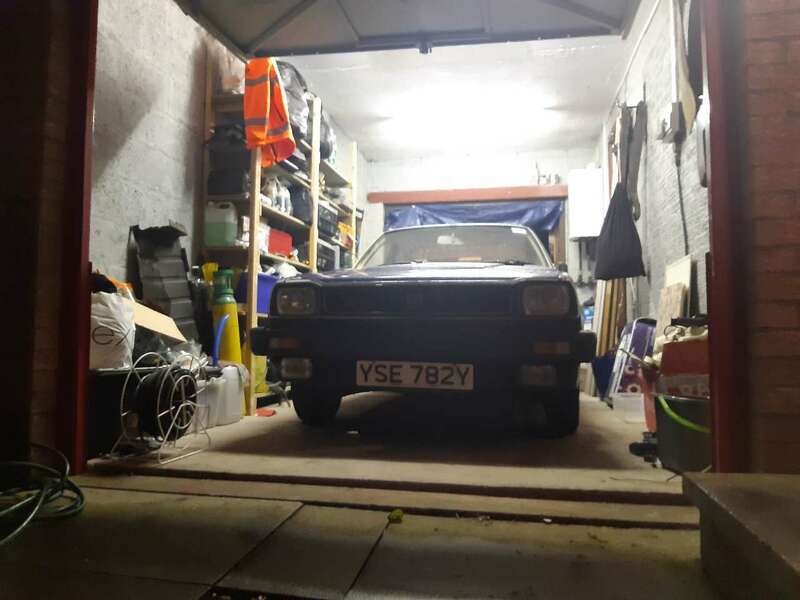

Closing the doors is thwarted by the patio ending and a sudden jump in height.
314903961_682685719831200_8248174657283284330_n.thumb.jpg.f074320f8fbee5d036b04dd9659aaab5.jpg
I am sort of considering putting in some ramps to allow the car back another few feet as the current windbreak method is a bit basic...
314660459_1474449736382781_1502989801012257041_n.thumb.jpg.be9a0271ac23a2ca2ed179447c66d665.jpg
It also means any car being worked on has to be mobile so the Dolly can go back in and the garage locked for the night. However I'd also quite like to shove a shed at the back of the patio for storing shit that is currently in the garage... Decisions, decisions. Sheds are silly money at the moment, as well as everything else.
It's actually crazy how much stuff I'd managed to squeeze in to a one bed flat. This place is now packed out...
Once parts start arriving I've got cars to fix. In this order: Acclaim, Volvo, Dolomite. Should keep me occupied over the winter.

Could the door be hinged the other way? I know it's a rental and all that.
Or put the back end up on car ramps would give an angle and give more room.
Beaten to it... But moving that planter and car ramps should help out.
Turning the Dolly and doing this would let you drop the sump there and have the Volvo in the garage so both will be done.....
Looks a cracking place though.
Looks a great space, I know you've had merry hell with space to work, so hopefully the garage will help - great to be able to just close the door and leave when you're fed up. And I'm sure there's a way of sorting the rear door issue so you can keep a car out the back, by hook or by crook...
Remove the hinge pin (or unscrew the hinge) when the doors are open. Then partially close, put the hinge pin back in and close the door.
If the Dolly goes in forwards, could you turn onto the grass enough to allow the doors to close, even if only one wheel on the turf?

The issue with ramps is that the height difference is considerable, the patio is 37cm lower than the slabs bordering the grass on all sides. Most ramps only seem to give 20cm or so of lift.
I actually had two sets of ramps at one point and I gave them away because they were too much of a pain to store, I can't even remember who to...
Removing/reinstalling the doors is a potential option in the pins come out, but they'll be heavy. Not entertaining the idea of unscrewing 36 year old screws in 36 year old wood...
Couldn't you put the shelving on the same wall as the steps?

I did consider it but the rearmost uprights are screwed into the wall and there is a electricity breaker box in the way. (And the roof leaks on that side in heavy rain...)

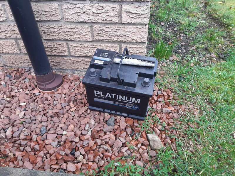

Volvo:
317924968_8416688388404019_9118647574047819530_n.thumb.jpg.38f0d3c548396f16fc02e5633ec7520b.jpg
The novelty of having to jump start it whenever I needed to move it got tiresome.
313014254_5943543989031514_8433980272061249373_n.thumb.jpg.a20e4793a5d119b5521c9a385870d3c5.jpg

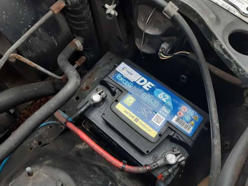

Goodbye old battery.
318012022_2062196813979794_19275976115702120_n.thumb.jpg.8cf0cf836c8052018d1f3c8f6cc47ac4.jpg
Hello new battery.

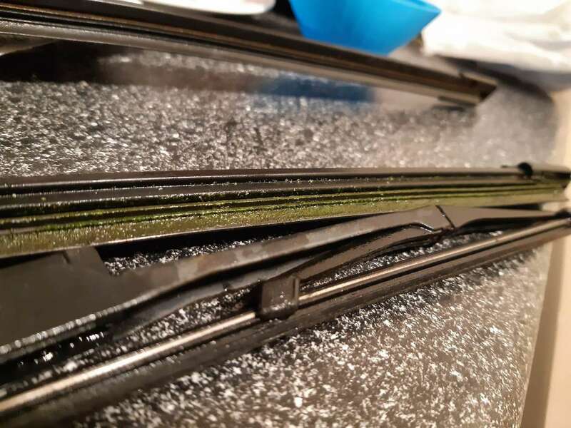

The rear wiper motor was also refitted (removed back when a lose earth connection was causing electrical senility), new wiper blades all round and replacement of some dead bulbs.
316945823_856903265356015_8651442066578341164_n.thumb.jpg.fc64b6a8076708cb1224ea5cc3321570.jpg

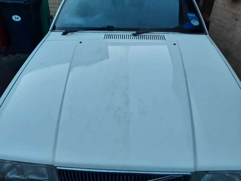

I also washed it, as it was quite green.

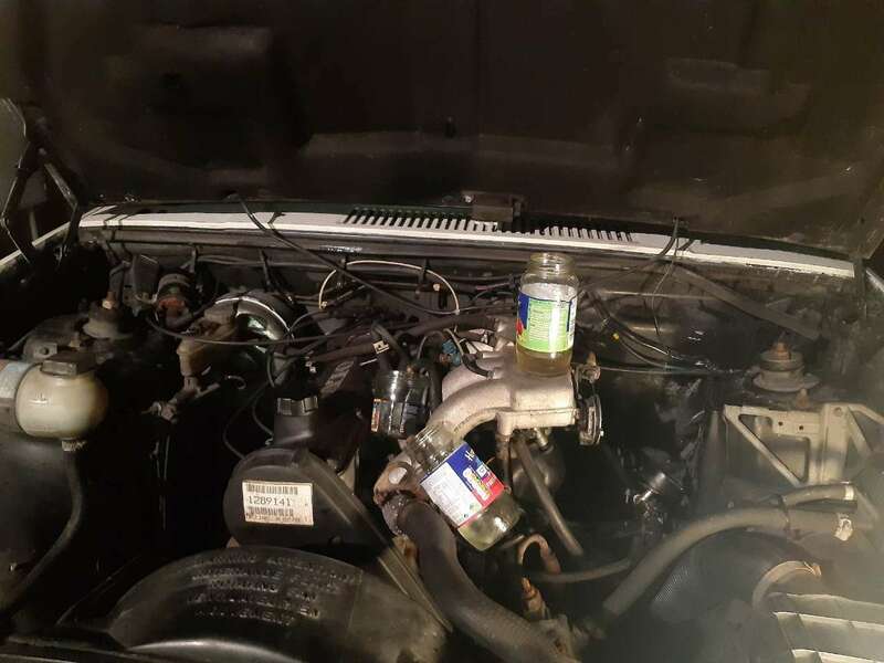

While the new battery freed it up for use while the Acclaim's (the jump starter of choice) rad was away it didn't cure the hot start issue which required me to faff about under the bonnet while Girlfriend_70's turned the key, making use of the car a 2 person operation...
316612433_667710671681359_975056982478090999_n.thumb.jpg.d10de9f3d83b13db89d696d8df5e4cc6.jpg

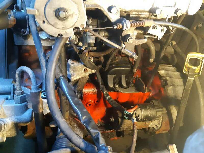

Discussion was had with @juular, the K Jet wizard, about potential causes.
First was the potential of the metering plate sticking.
317390669_863226574714471_4206580033177435103_n.thumb.jpg.4878b8bb971e0d3cc824b0c7fc332c9b.jpg
As can be seen it was immaculate, but I made marginal improvements.
316703913_2110117029183205_5730806465518420588_n.thumb.jpg.0a612ae1d6b661fb4bfa87a06431bb59.jpg
The plate was also off centre and catching on the surround causing it to stick.
So, that's the problem. Engine gets hot, plate expands a little, when it drops back down when the car is shut off it gets stuck. Sorted.
Nope. Made fuck all difference.
@juularthen attached his pressure measuring stuff to make sure the system was actually coming up to pressure.
316355330_407929298129328_3721868256021938895_n.thumb.jpg.4071163258185b8cecef44b4e437e4bf.jpg
This showed when running the pressure was fine but on shutoff it immediately dropped instead of holding, suggesting the either the non-return valve or accumulator has failed. However this would suggest if you ran the pump manually it'd eventually bring fuel up to start the car, even if it had to pump it all the way from the tank, but even with fuel up the lines it wouldn't fire. As a bonus the banjo bolt for the fuel return snapped when resembled. Thankfully the remains of the thread were spun out using a hex key, and a quick run to @juular's place in the 205 meant a spare* could be used to regain functionality.
*Deffo not stolen from his 240...

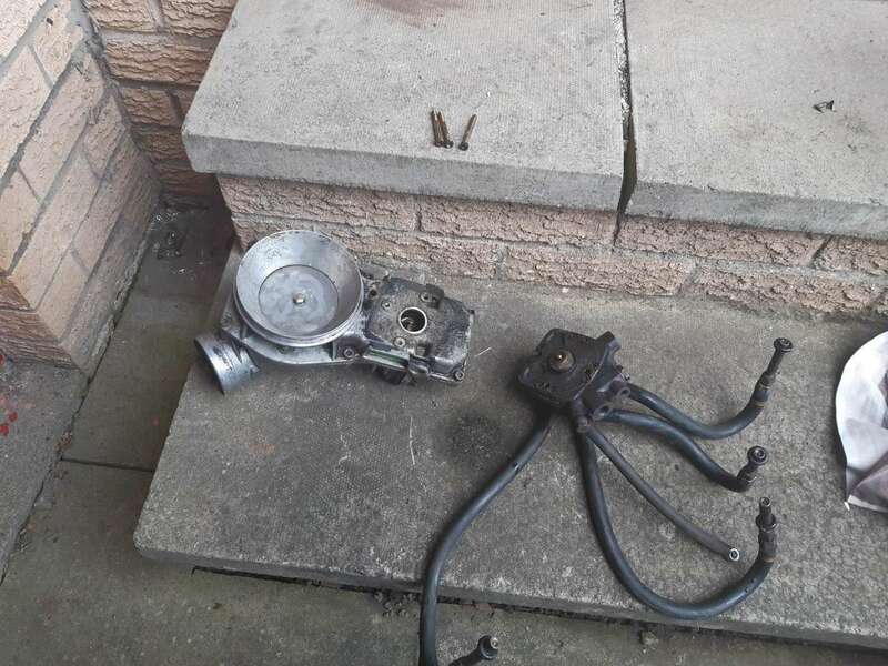

So the next potential culprit was the plunger in the metering head.
316575537_686166559751545_7545032482793539057_n.thumb.jpg.e4106f291dc6b13245bbfdeba9dfaee0.jpg
This meant it had to come apart.
318180152_1266391794216796_7469378244768864288_n.thumb.jpg.e9c09672052d1b7bf1e938e6acfb63d2.jpg

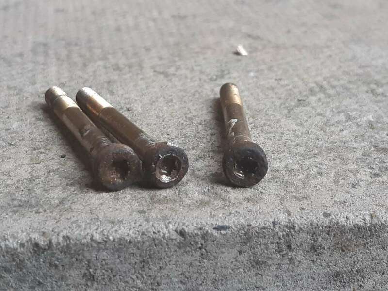

Obviously all the fixings were utterly fucked. So I ended up pulling the whole system out.
313014254_1596346940830811_3104822662919032598_n.thumb.jpg.83d51e34b37b6da4c1cda75cff55dbf9.jpg
Which at least let me clean 30 years worth of crap off the engine.
318196637_829641848302569_4823431069668574555_n.thumb.jpg.7a50cb9b48fd5e91251ee401747ea36f.jpg
So now it's been doused in carb cleaner, everything is moving freely and the O-rings for the primary pressure regulator are to be replaced once they arrive. The warm up regulator will also get a dousing in cleaning fluid.
The benefit of this system playing up is that I am at least learning how this new-fangled mechanical continuous fuel injection works, hopefully cars never get more complex...

Reassembled fuel system, wouldn't start, pissing fuel everywhere. Went to snug up the banjo bolts.
Fuck off.

With the various O rings, washers, bolts and shit replaced the injection system went back together, fired up and drove round the block. Parked it up and it wouldn't restart. Again.
@juular came over to test the system pressures and injectors and everything seemed fine.
330449469_531057832342531_4889184154472795401_n.thumb.jpg.a2f12c5c87045423e59b78a532096873.jpg
328678049_720036029564818_2784237995117113700_n.thumb.jpg.93052ffcb57939f26104ce735d9c1146.jpg
The best guess was the mixture adjustment piston was getting stuck near the top of it's travel when hot, causing the car to flood when trying to start it.
So it all came out for the third time.
330551774_757014132664362_2221147551128417438_n.thumb.jpg.9a8cb97c58c5691cee8822e6cf4f7806.jpg
To get at the piston I'd have to take the metering head off, using these fittings...
329973013_2890372637773768_7912363606442953295_n.thumb.jpg.c37b45fa09e4838d2a703f3b2a63b58e.jpg
330429527_3575804366075361_3557084957929032916_n.thumb.jpg.544dcb7cb15f51557542e299d2cd724c.jpg
Doused everything in various fluids, smacked the bolt heads horizontally with a hammer and screwdriver and poured boiling water over everything before leaning my body weight on to an battery impact gun I borrowed from @dome...
330276838_567207962120169_6076961570078867685_n.thumb.jpg.a0f41012ec75dcbff011d861ef27d576.jpg
330280286_577286160956761_8070012412351467684_n.thumb.jpg.6152493c19df8aa7b68c10ce05a88732.jpg
I was sure I was going to have to resort to drilling them out. Although @320touring lent me a spare he had from his Golf, just in case, and @derskine also offered one he had spare.
With that apart I could observe the piston (the end of which can be seen in the centre of the black bit above).
330395175_715304070302442_2146975480785856562_n.thumb.jpg.964c634d661f6418a3336fc016f677ed.jpg
It was a bit varnishy but with no noticeable damage. I gave it a good clean and put it back together but it was still getting stuck towards the top of it's travel. While shopping for new bolts to reassemble I noticed that there was a spring available from the same seller on eBay. On some applications this seems to sit above the piston so it always returns to the bottom of it's travel as it should. The 740 shouldn't have one but I bought one and chucked it in anyway as the spring force was so feeble there was no way the airflow through the system wouldn't be enough to overcome it.
So it was all cleaned and reassembled, again.
The car hasn't run since before Christmas so this was very much a cold start. Although I shorted out the fuel pump to test the system for leaks so it was primed before this starting attempt...
I then went inside for the night, deciding to end on a victory.
This morning I went out and made sure nothing was leaking and took it for a spin locally. Running and driving perfectly.
Got home, parked up and went in for a cup of tea. 20 mins later I went back out to a car that would turn over and not fire. Again.
So right back to square one.
Found that if you give the car a sniff of easy start then it fires and once running it's fine. So I ran it down to the tip with a boot full of shite as it is at least now usable, with workarounds. Unlike before when it just wouldn't run.
Not being used since November it'd also gone quite mouldy as the windscreen has resumed leaking and it's full of water...
330226129_552892486799605_7175227113385350652_n.thumb.jpg.7238aa1b7ae09d57885a883b25d49ce3.jpg
Highly irritated. Shall be back on it tomorrow to check the idle mix is correct and to see if disconnecting the cold start injector will stop it from starting when cold. As that may suggest only the cold start injector is fuelling it when it'll actually fire up normally when bone cold but shits the bed when it's warm.
