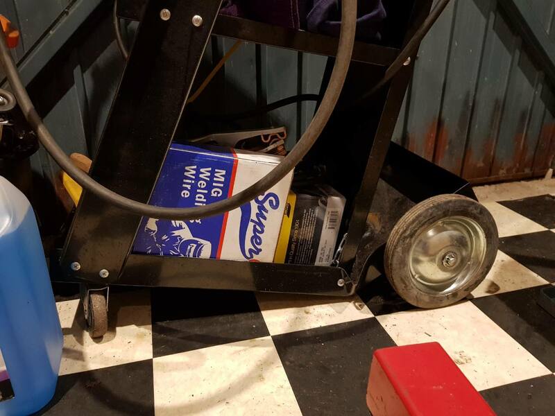

I think I worked out that the BOC cylinder is equivalent to 5 of those hobbyweld cylinder fills. The BOC bottle is a heavy fucker though and broke the back on welding trolley...
How it was supposed to be:
I'll probably move back to hobbyweld once I've done the Dolomite as I really don't intend to buy another car that requires a weldathon again. 😬

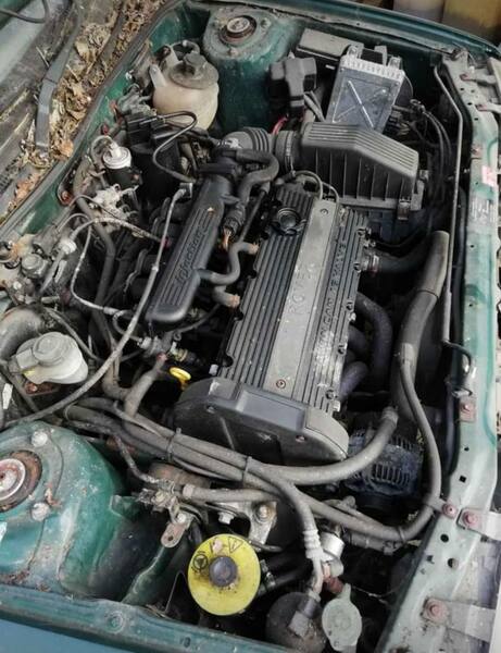

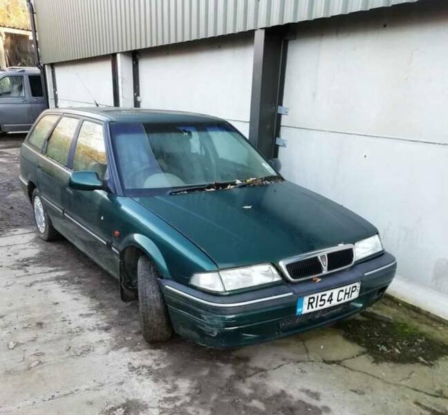

Rover 400 tourer. Yes I'll never find one, yes I can't afford one. They are quite funky though..
 Screenshot_20201126-220054_Facebook.thumb.jpg.e145381b43cf1664c647e218ee1b4c63.jpgJust so happens that I came across one of these on Facebook Today  £400 with a K series near Gatwick airport,  if I didn't have the Allegro on the drive I think I would have got it bought,
Needs a Head Gasket as it's doing a Kettle impression, it's the other end of the country from yourself but possible if you can afford the transport of it,

That's nuts, I've only ever seen one and that was in Holland! Sadly wrong place, time and condition for me - Still a cool motor though.

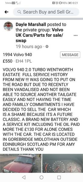

940s are pushing £2000 now.
Aye, now a decent 200 series will set you back £5k+ the later cars are following suit. Plenty of cheaper ones still crop up in the classifieds etc. I think prices are being artificially inflated slightly by the several minty low milers that are sat on eBay at £4-6k but never actually sell...
The folk asking £4-6k on Ebay for a grands worth of 940 have to be terminally optimistic, particularly as reasonably tidy examples can still be had for £500 if you're patient enough. Obviously they should be bought on condition and not mileage as the odometer is usually either broken or senile anyway.
940 prices are representative of the classic car market in general at the moment. Whenever you look, 7/10 off the 940's on eBay are dealers asking £4.5-5k for stuff that sits there for months and isn't actually selling. Then a private seller with a clean, late 2.3 LPT manual comes up for auction without reserve and sells at £1200.  I watch for 940's (too) often and still think a decent one can be had for £1500 max if you're patient and quick.

All the talk about Volvos... I'm planning on trying to move my 960 on (again) when I can get to it (in storage). It's a 3.0 Auto saloon, for your information...

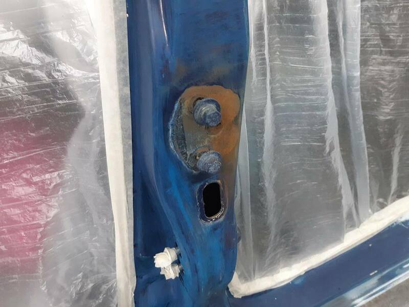

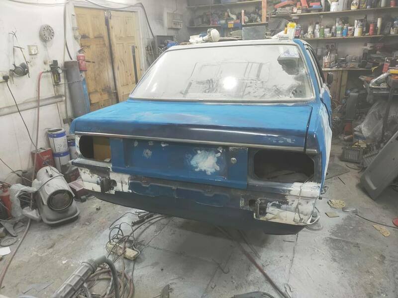

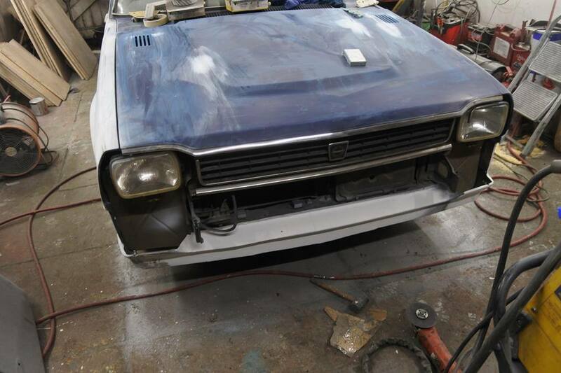

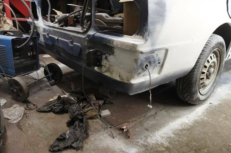

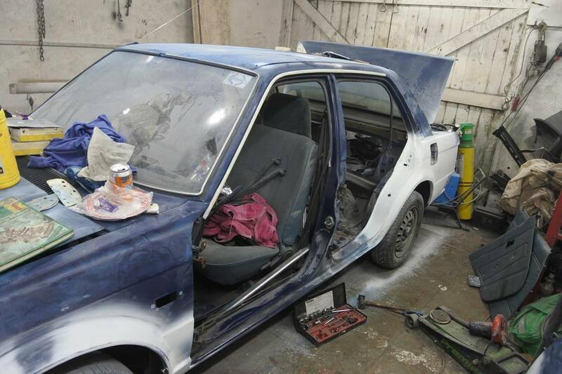

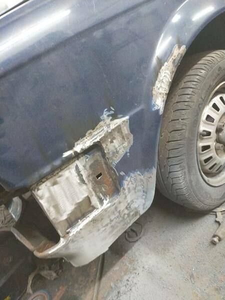

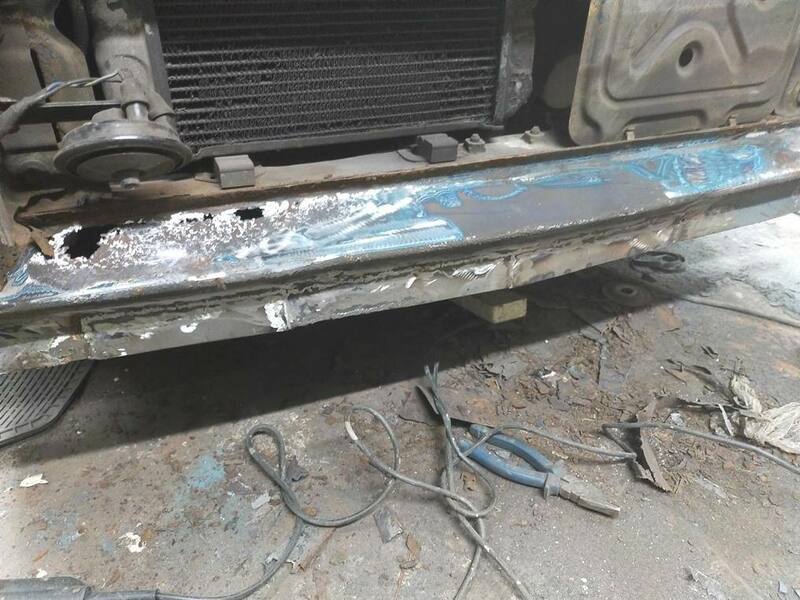

Work continues, mostly in my absence admittedly, @GingerNuttz did approx 98% of the work...
With the rear quarters reattached more rot was dug out in the front valance, boot lid and around the rear lights.
131207568_710358853190682_5927199629584750919_n.thumb.jpg.3743740e668f0e22c0ce7eab2591b381.jpg

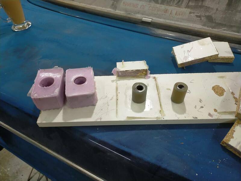

When finishing welding to the rear quarters it was found that the bushes for the strut were shot, and with parts being largely unavailable for these cars the only option was to cast custom poly ones...

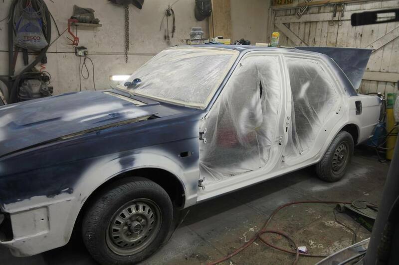

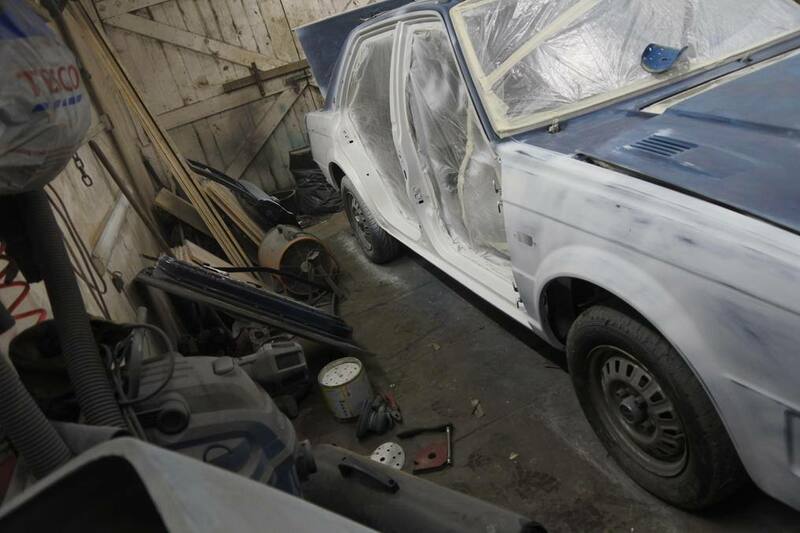

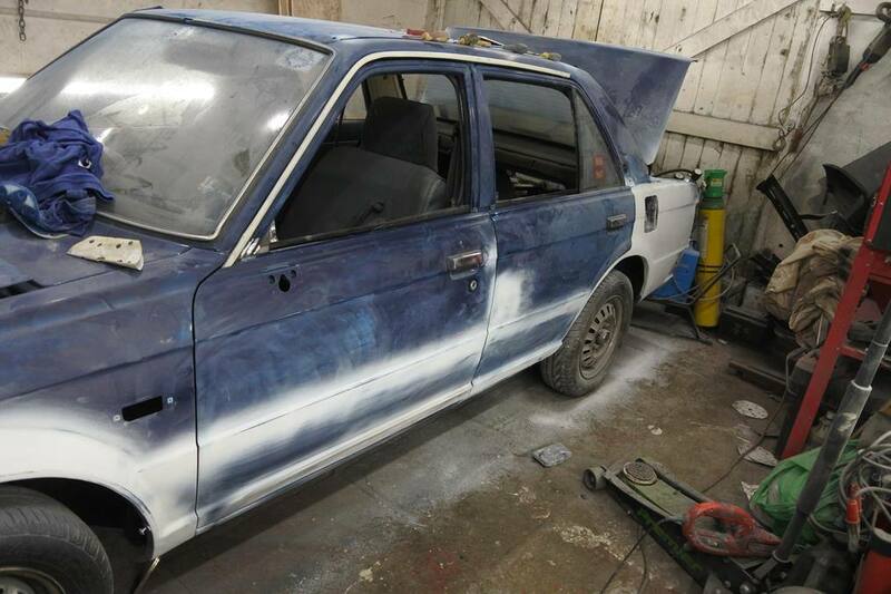

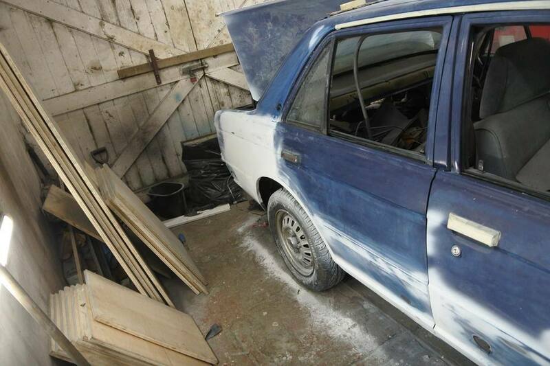

Due to the sheer amount of repairs the only viable option was to respray the whole car. Originally planned to be a quick blow over along the sides and polishing the existing paint on the roof and bonnet it soon became clear that it'd be not much more effort to paint the whole thing. Sanding back the roof found quite a few areas of surface rust that'd previously been painted over too...
So Saturday was mostly spent sanding, with a trip out to the paint shop to choose/buy a top coat. Over time the goals for the quality of the respray grew, so I took off all the doorcards to remove the locks and handles as to avoid harsh masking lines, then the doors were removed to allow painting of the jams.
Fun fact, the hinges must be fitted to the car before it's painted, as it's just bare metal underneath them.
131130480_708592840076828_3507398010224497551_n.thumb.jpg.7512ceea02053e4ddfd59ec3aff28e40.jpg
Over the next week @GingerNuttz is going to finish the primer stage, spray the door jams in blue and clear the garage ready for the top coat to be applied to the body on Saturday.
Oh, the latest colour was chosen from swatches at the local paint place. So the stock colour was Eclipse Blue:
But the car had been sprayed Mercedes Stahlblau:
And it's now getting sprayed Iveco Kolbatblau:
A bit more saturated and more depth to it I think.
