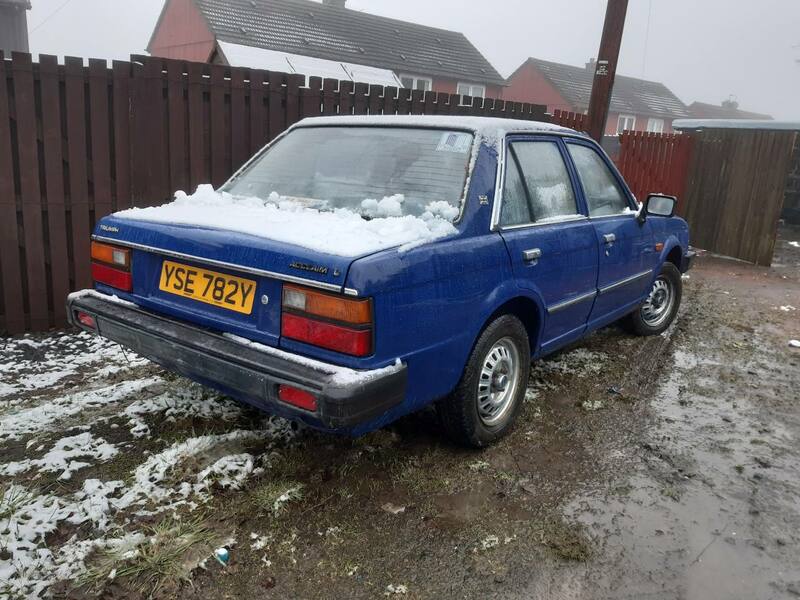

Naturally things didn't go entirely to plan. The handbrake cables are slack as buggery and even at max adjust aren't great, the auto adjusting drums also weren't keen on auto adjusting, or indeed adjusting reliably at all.
We also noticed a nut was missing for the rear suspension arm for the passenger side was missing. It must have been removed to facilitate moving suspension component during the rust repair and naturally we couldn't find the nut. Indeed, the only thing we found that'd fit was a wheel nut, so that was deployed a temp measure.
The world's most convoluted (5 fucking hoses to multiple pipes) fuel tank breather system was re-attached.
Fuck it, need to go now or I'll be late for work. About a mile down the road it was fairly obvious something wasn't right, the car wouldn't pull at anything under 3,000rpm, spluttering and misfiring like a bastard. Above that, smooth as silk.
Well, it's a Honda engine so that still left 4,000rpms to play with. Upped my gear change target from 3k to 4.5k and hit the motorway hoping a long blast would clear it's throat a bit.
Ran well once up to speed, bombing along at 70mph. The steering feels heavy/tight as fuck after having PAS for the last few months, took a while to re-adjust.
Coming up to my exit slip road on the M8 heading towards the Clyde Tunnel I ease of the throttle and go for the brake to give a lorry some space and the brake pedal goes straight to the floor and nothing happens.
Yes, complete brake failure. For the second time for this fucking car.
Thankfully the sliproad is long as fuck, has a hard shoulder and the handbrake was functional enough to stop me.
140616787_826375271277560_6078652065620461830_n.thumb.jpg.2a67a400942bf0d653a9154900070fe7.jpg
Went underneath and couldn't find much wrong aside from a brake pipe rubbing against the rear axle strut thing. This pipe felt quite hot to the touch when I bent it back to where it should have been. My first thought was that friction from it rubbing had heated it up, but I think it's more likely the drum on that side is binding and had boiled the brake fluid. The reservoir still had plenty left in it and after a few mins of me lying underneath the car the brakes pumped back into life.

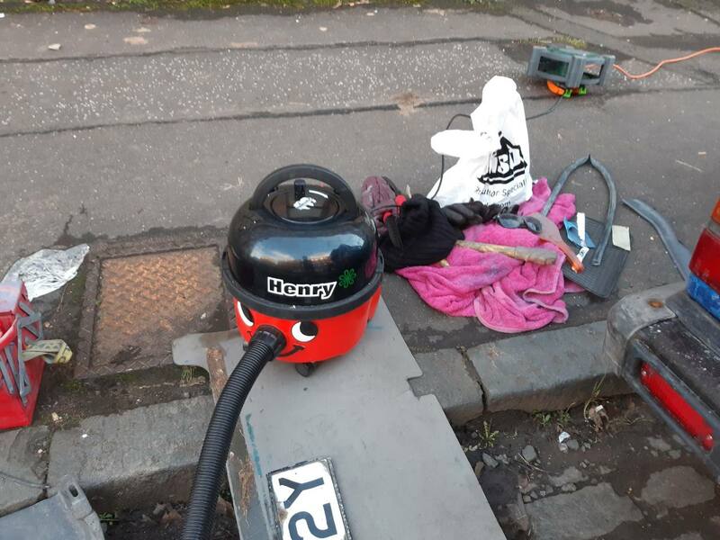

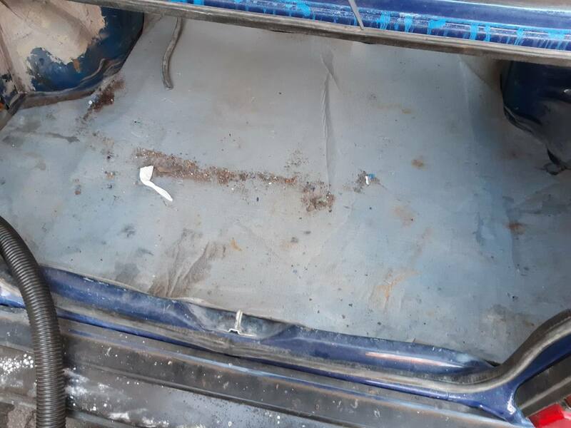

This morning I slept in, typical. Dashed out and hoovered out the interior 'cause it was bogging and emptied all my shit out of the thing, then put the rear seats back in.
141029802_432838237865994_77285872361163464_n.thumb.jpg.de1df3fc8157c10d5355a2622d0491a0.jpg
141243206_491411395586406_2272690420031197721_n.thumb.jpg.dafb0cb4773d3731a934c8e9b9c2f168.jpg
BRAEV SOLJER
141061919_1487733484759019_333683763526439284_n.thumb.jpg.25a72344138e20e3b2a81faacb079708.jpg
