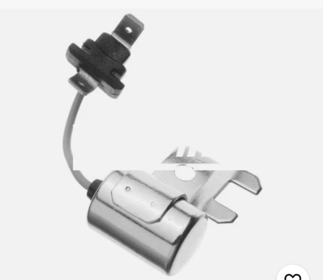

The quick lock was on the old condenser and I was confused as to why until a new (correct) condenser arrived. As it shouldn't require splicing.
The rubber insulating block which goes through the dizzy body is square, the hole in the dizzy is round! So whoever replaced the condenser last spliced the old (round) insulating block and new condenser together. These condensers also go on a variety of more popular classic German cars using similar Bosch dizzys which presumably have a square hole...
As I had the whole thing out and on the bench I trimmed the new condenser's insulating block to be round(ish) so it fits without splicing wires. The new condenser is probably still crap but fingers crossed it'll not be DOA and will serve for testing purposes...
I figured a Lucas dizzy of some variety would use a condenser of the correct value. I reckon the easiest long term solution would be a Distributor Doctor 22D condenser with the Bosch insulating block soldered on and a modified bracket...

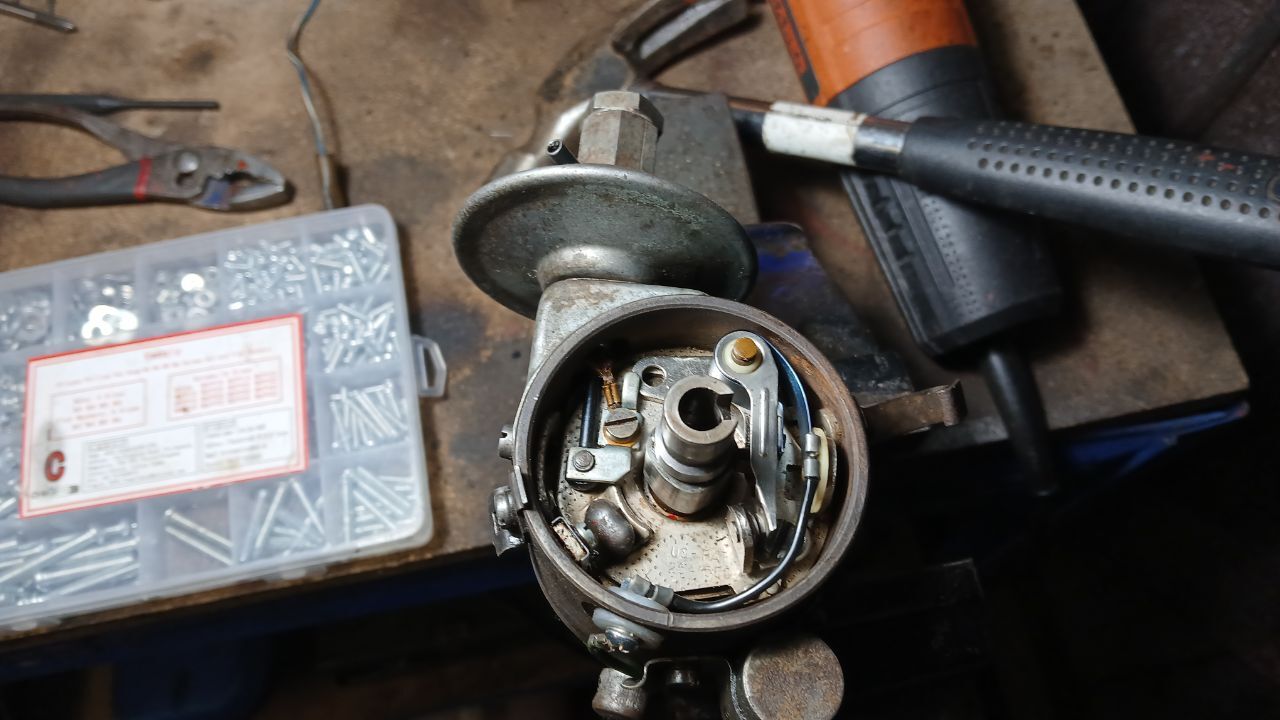

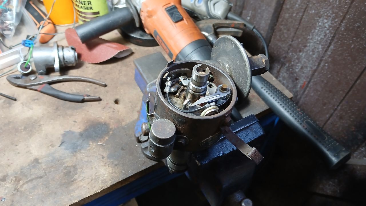

A quick clean of the Amazon dizzy kindly donated by @juular.
You'll note I've retained the old, slightly pitted, points and the condenser which looks like its been underwater for 40 years.
This is for a very good reason. Because I couldnt be arsed ordering the correct replacements...

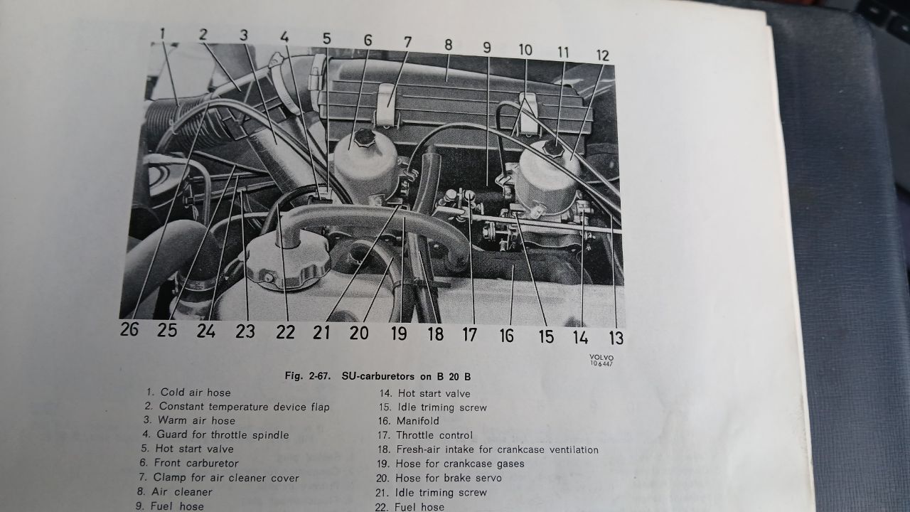

Some reading material also landed.

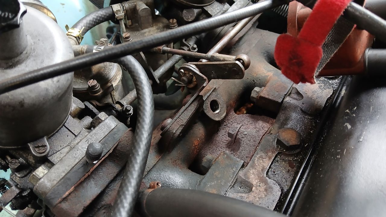

Reading this confirms that the factory twin carb cars got a higher compression ratio head, but also bigger valves and a hotter cam. So twin carbs on this car are probably achieving nothing but drinking more fuel...

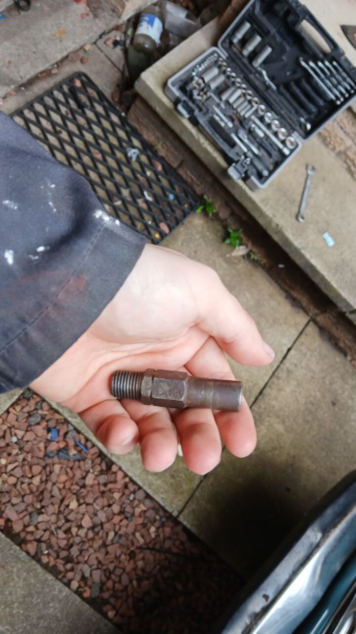

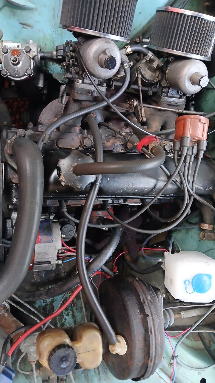

@juular was working on his custom airbox and breather system and pointed out to me that the breather system on the B20 has some quirks.

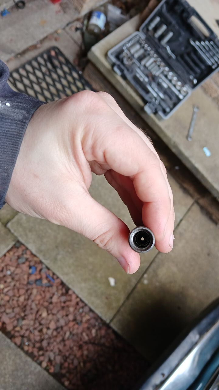

There is a hose from the top of the oil filler cap to a port on the inlet manifold to pull crankcase gasses back into combustion rather than dump them in the engine bay.
The port in the inlet has a very small opening, 1.5, 2.0 or 2.5mm depending on the engine. If the breather hose is mixed up with the brake servo hose, which is also plumbed into the inlet manifold, you get a car that runs badly, chews fuel and suffers brake problems...
Bugger. Mine is fine. Suppose that would be too easy...
Took the port apart and cleaned it up anyways. The hose was jammed over the hex and the clamp rattling around loose - So could have been a vac leak.
The "new" dizzy was fitted, car started and timing set to 10 degrees with the strobe light. A test drive revealed...
It's driving alright!
Well, it runs much better anyway. Although it certainly feels like a heavy car with 90hp and an autobox! The brakes are still binding which doesn't help, but the car now pulls smoothly through the rev range.
Vac advance is still disconnected and it could possibly be able to take a bit more of advance as well.

Whats the plan for the twin carbs if they’re not really doing much without the cam etc? Go back to a single carb or you just leaving them?
11 minutes ago, danthecapriman said:
Whats the plan for the twin turbos
14 minutes ago, danthecapriman said:
Well done @captain_70s
Probably swap back to the single Stromberg as and when I can be arsed. I think I have all the bits required...
Long term it'd be nice to find the correct cylinder head, cam etc. That'd bring us up from 90hp to around 115hp.
Although at that point I'd really want a manual overdrive gearbox, but if going to that expense I should probably also try to make it handle less like a cruise ship, and fix the rust, and, etc, etc.
Trying to follow the path of least resistance with this one given I have a perfectly good Cresta to pour energy into for no reward, and the Dolly also requires plenty of attention...

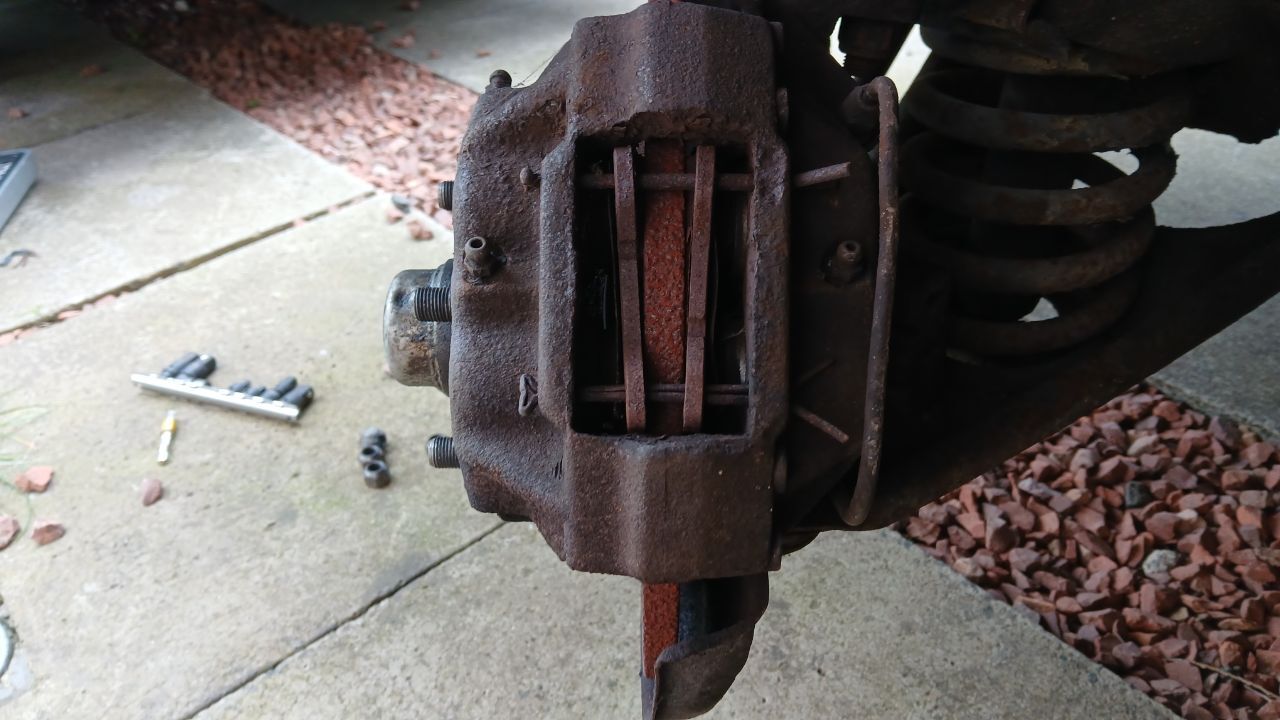

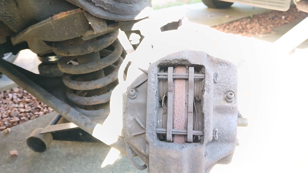

Brake time.
First. NSF.
Oof. I reckon I can see why it was getting quite hot...

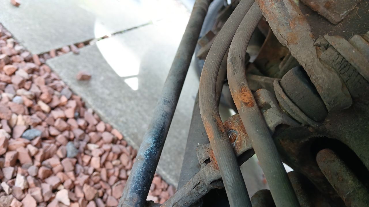

Flexis looked fine except...
Pretty badly chafed where they pass through a bracket on the ARB link rod...
OSF
Not as completely fucked, but well used.
The calipers themselves seems alright, all the fixings and bleed nippes came loose with no effort at all.

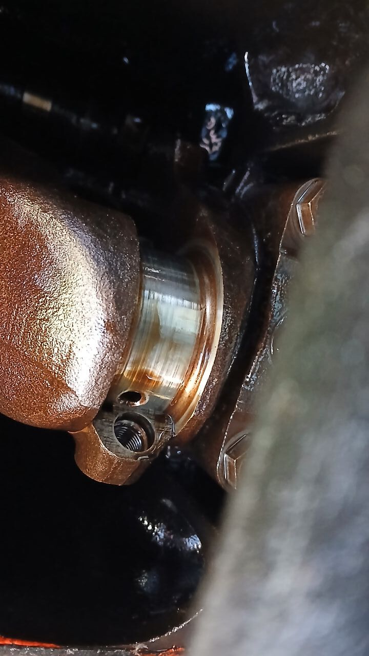

You will notice, however, the complete absence of any rubber boots or caps and the big split pins rather than normal pad retaining pins.
Discs have plenty of meat on them and aren't massively scored.
Now I need to decide whether I try and refurb these calipers (£55 a side) or get reconditioned ones (£150 a side). These days I'd be inclined to go for the easy option but I'm about to drop £1400 on a shed and then I uncovered some more expense...

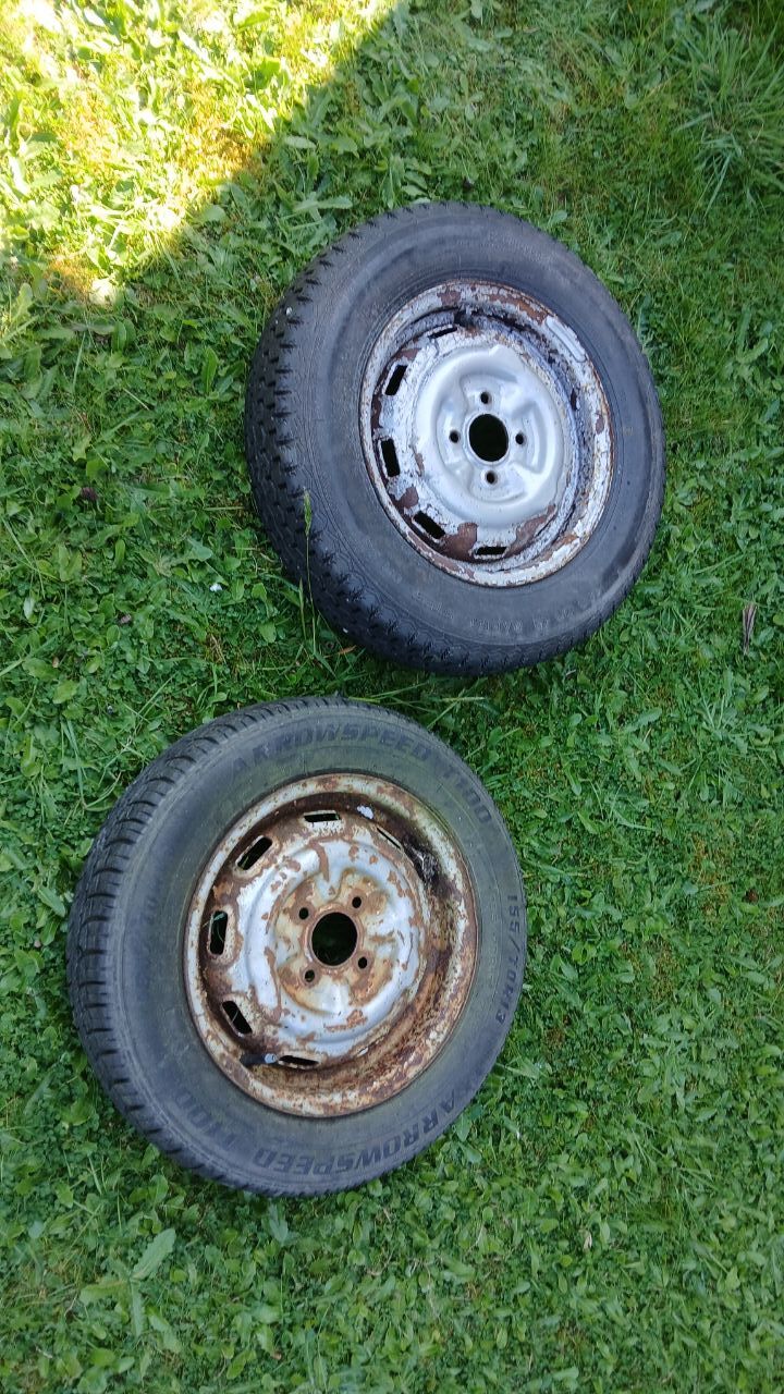

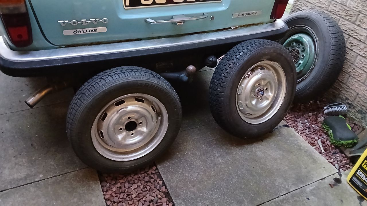

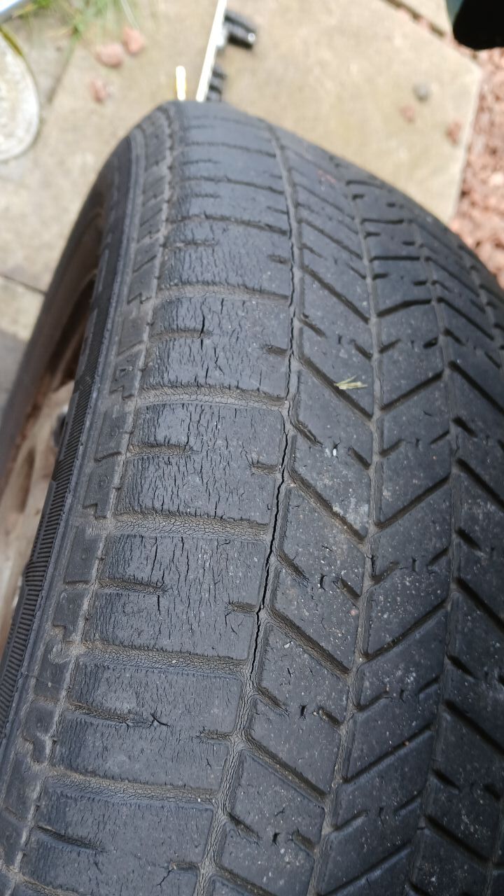

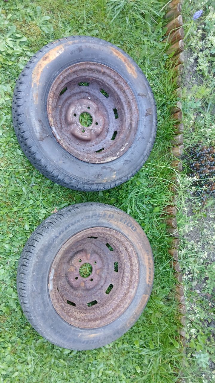

This was the first time I really had a good look at the tyres...
The two fronts are dated 2005, rears are 2009 and 2014... I suppose I'll add 4x tyres to the shopping list as well...

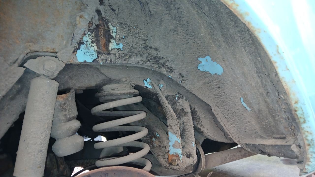

Then I moved to the rear and started scraping mud, you'd think it'd been in rural Alberta for the last 50 years...
Hm. That seems incorrect.

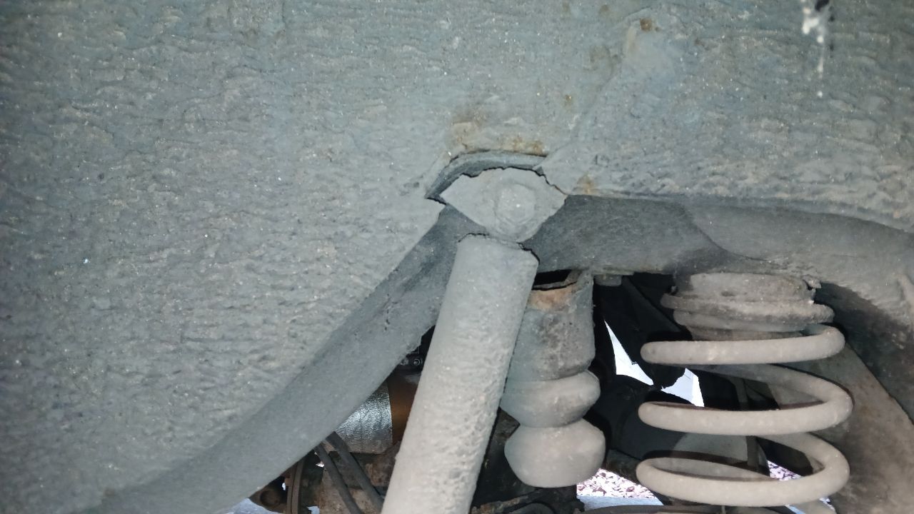

There is supposed to be a big fan shaped mounting panel which you can kind of see the outline of here...
Entirely missing. The shock mount does bolt through the chassis rail behind, and the outboard mounting plate is absent on 240s, so I'm not sure how much work it actually does.

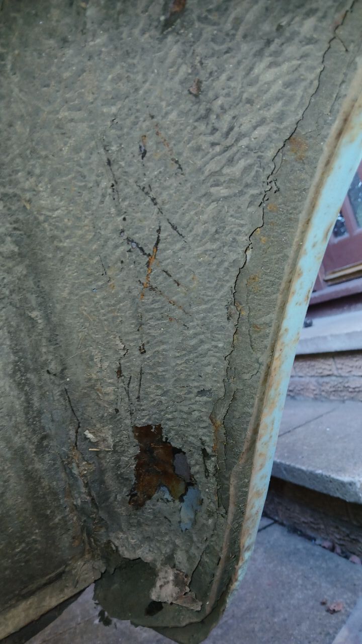

You'll note I also started removing the thick but cracking underseal.
Mostly good car underneath!
You can see here the inner arch is entirely rotted away at the lip and a repair panel layered on top of the original outer wheel arch.

I've gone poking quite intensively and not found anything too hellish. Certainly the chassis rails, outriggers and suspension mounting areas are all good.
Front floor pans, outer sills and a patch to an inner wheelarch are needed, but not dire for a 50 year old car.
The underseal is incredibly thick, and has done it's job, but where it has cracked and lifted it needs to go before it causes major headaches in a couple of winter's time...

Fucking Volvo brake calipers. Every Volvo I've bought has had seized calipers.
3 of these pistons actually rotate, all 4 move back with a G clamp. One moves forwards with tyre pump pressure.
You either got Girling (cheap and reproduced) or ATE (NLA and only avaliable refurb exchange) calipers on these. I have the ATEs, obviously.
They're also held together with massive torx fittings no normal person has, because bastard Germans.

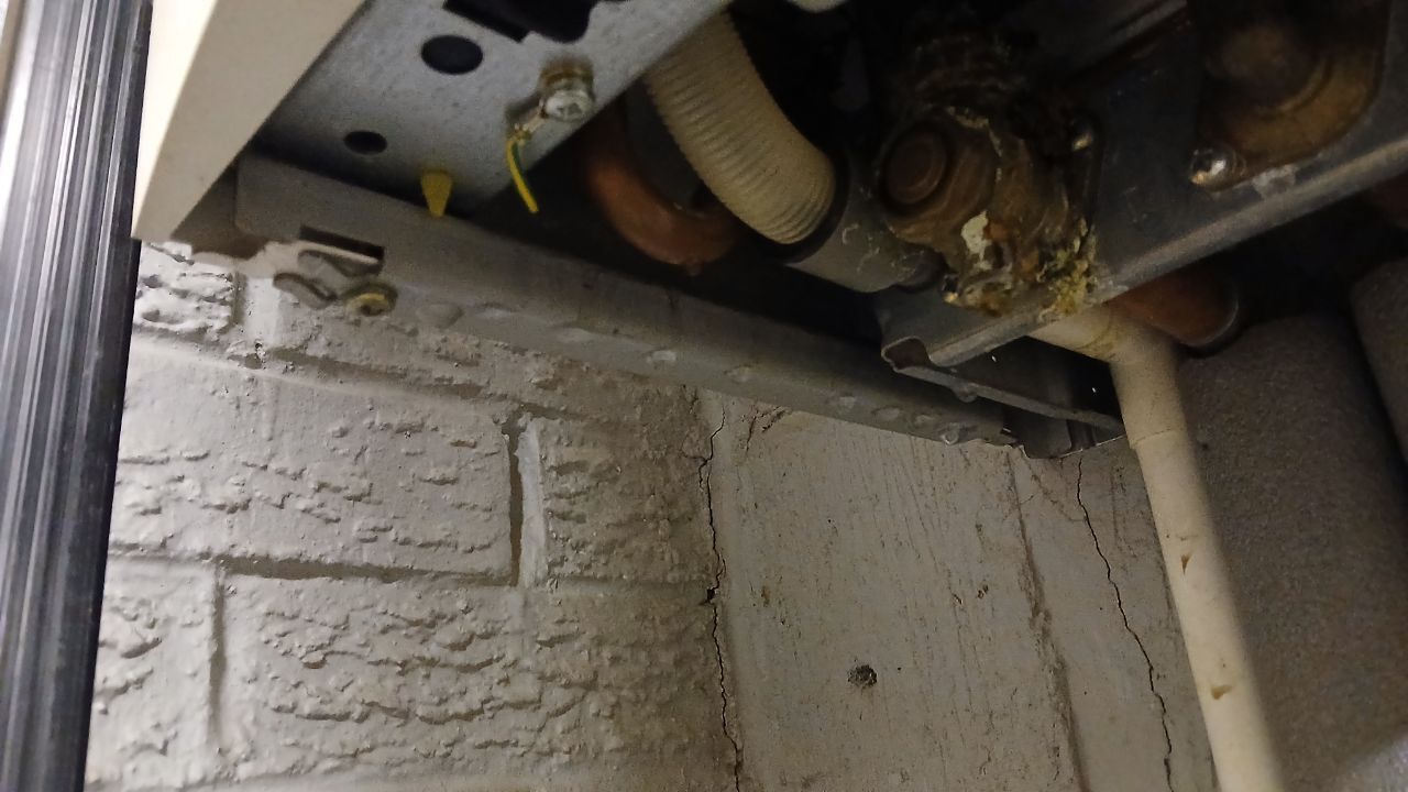

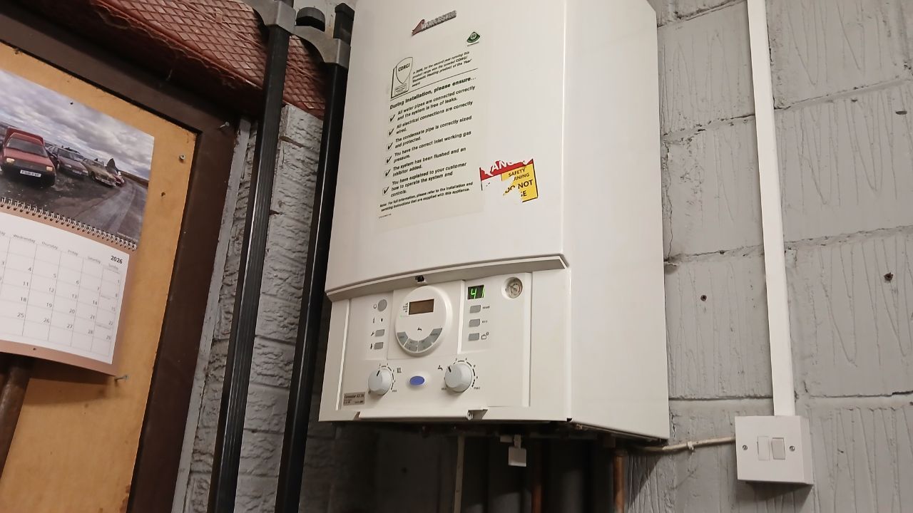

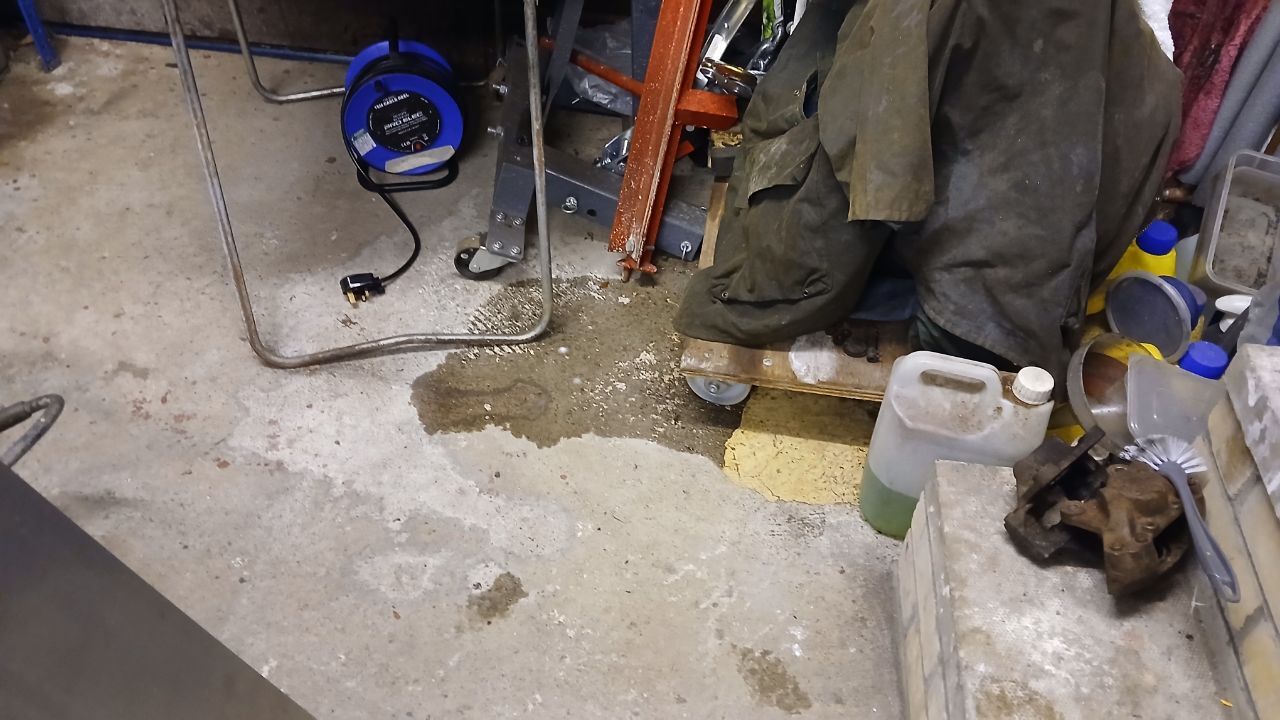

Went into the garage last night and...
Eh?
Fucksake.
More motivation to keep trying to salvage these calipers and save £200...
Hoping to have this thing safely drivable for under £1k expenditure...
  • captain_70s changed the title to Rusty Triumphs in Scotland - Being a miser - 21/04/26
That’s a bugger about the boiler pissing its pants.
Ive had similar issues with Volvo callipers in the past. Loads of different makes and systems and they aren’t necessarily the same front and back on some cars either. And yes, they seem to seize up and stick very easily.
Can you get replacement dust covers and fittings etc for your type? If the pistons are all moving fingers crossed you can get away with a good clean up and new seals/dust covers.
Im sure I had something similar on my old 244 and couldn’t get the parts or they had a very long delivery estimate or something. It was yonks ago though and I can’t remember. I do remember being pissed off though!
Everything easily avaliable, thankfully.
Just the fact you can still get new/refurb calipers is pretty impressive! Caliper carriers are extinct for my 740, despite being a much newer car.
